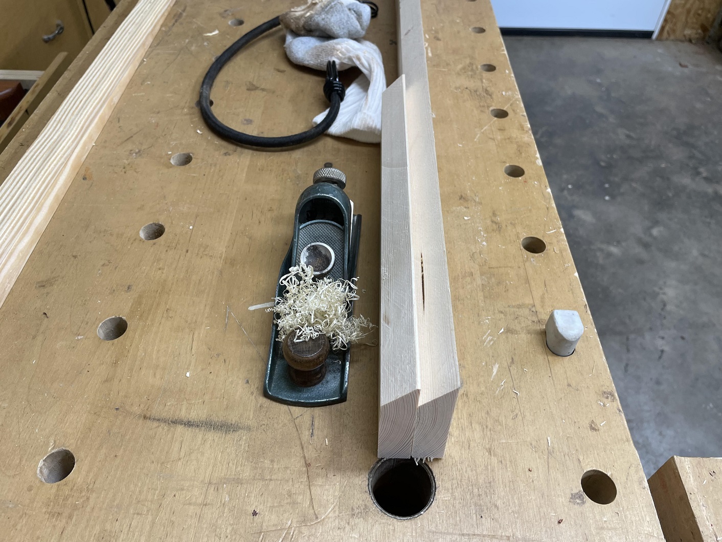

One last step before installation is an extra safety measure to insure the cleats stay engaged. Take a sharp plane and break the sharp edge on both halves of the cleats. As you see below.
119 last steps.jpg (495.83 KiB) Viewed 5986 times

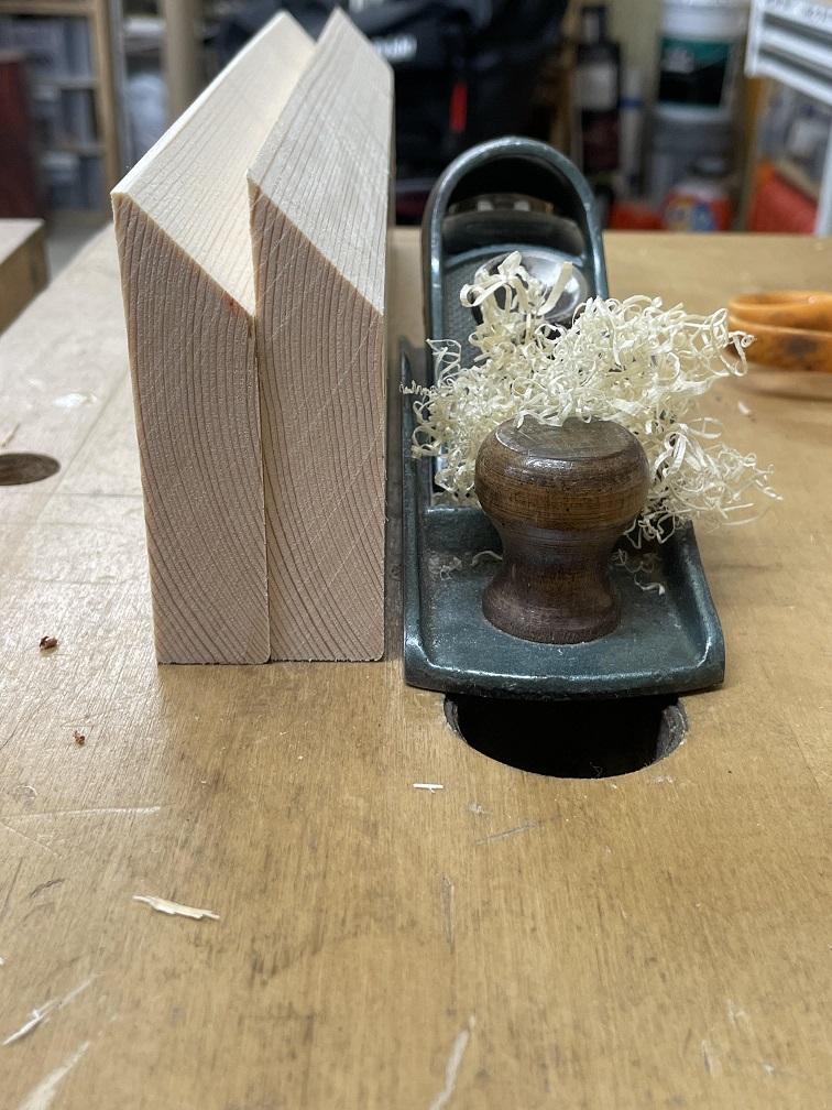

Look at the difference in the two halves here. A half dozen shaving passes with the sharp plane, and the difference is readily apparent. You can also tell how sharp that old plane is by the thin shavings it took.
120 take off the edge.jpg (290.77 KiB) Viewed 5986 times

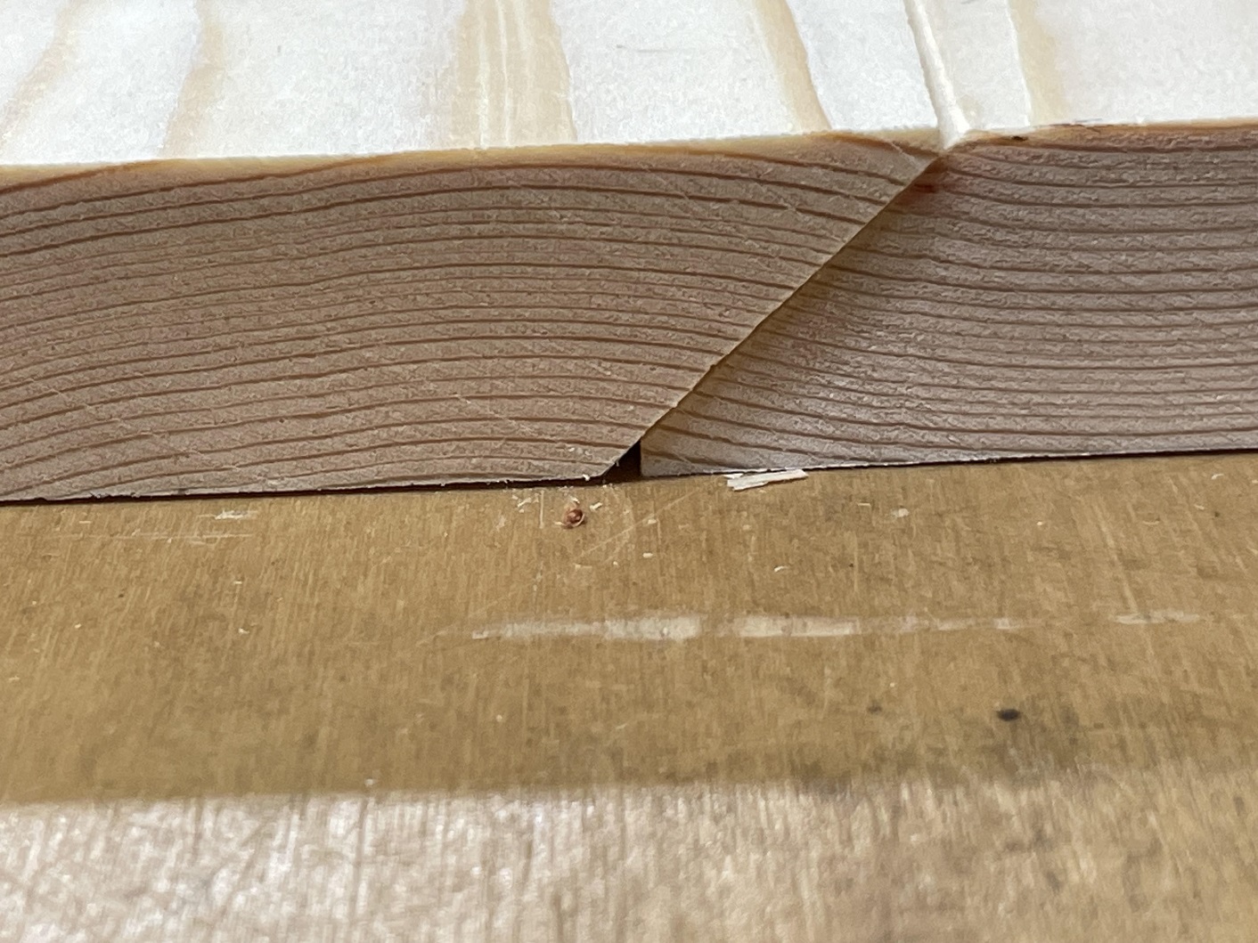

The purpose is simple. It allows the junction of the two halves to create this minor pocket at the bottom of the cleat in case there is a buildup of dust or dirt from airborne debris. This could eventually cause the cleat to sit higher and not as secure. MORE important in items that would be moved often, but I might take the case down to clean the glass or dust... not likely, but you never know.
121 creates that pocket.jpg (471.57 KiB) Viewed 5986 times

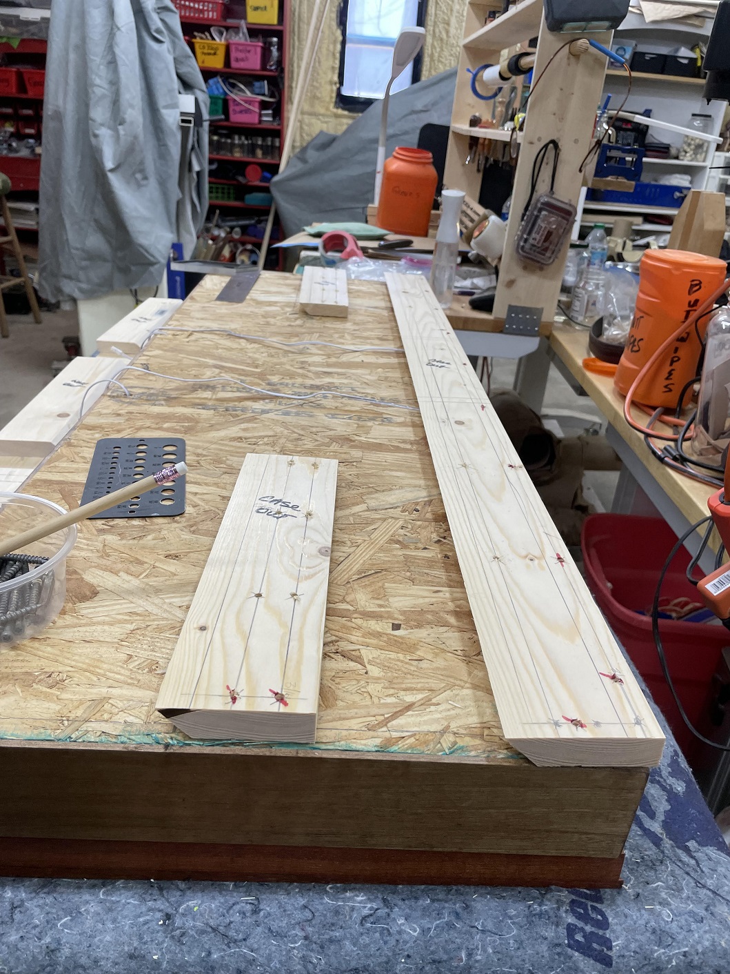

Careful layout prevents mistakes. I will be using two sizes of screws, the two inchers on the edges, and 1-1/4 where the leather is located. Important to get that right as I have to predrill. Wouldn't want to predrill thru the leather with the 2" depth set. Note the red marking for the 2" depth. As in real estate, location location location... important to know where you are.
122 two sizes.jpg (561.82 KiB) Viewed 5986 times

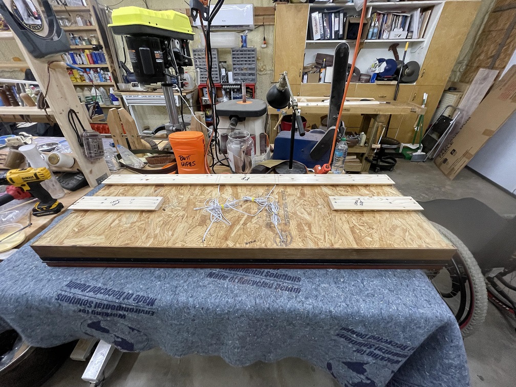

Careful planning, resulted in an almost error free installation. Here the case mounted cleats are screwed and glued. ONE screw got caught by the grain and turned and exited at the very end. I already made the beginning of the patch. It won't be noticeable by the general viewer, even I won't find it on casual glances. I only mention it because for YOU guys, I'll admit my mistakes. :roll:
