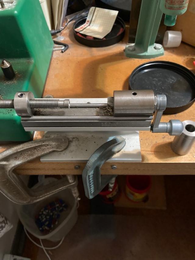

Most of my manuals show a maximum case length and a trim to length. The .30/06 for example is 2.494" max with a trim to length of 2.484". Back in my precision shooting days I bought a L.E. Wilson case trimmer. It requires a different case holder for each "family of cartridges" such as .243 Win, 260 Rem, 7/08 Rem and .308 Win can all use the same case holder. It will trim cases consistently within .001". I doubt if that sort of precise trimming is necessary in a factory production rifle and doubt if .003" variation would be noticeable on paper.
Case trimming is my least favorite part of handloading but when cases reach maximum I grit my teeth and start cranking. Case trimmers have progressed a lot since this 45 year old Wilson but someone else will have to chime in on the latest developements.
Case trimmer.jpg (55.77 KiB) Viewed 1405 times
