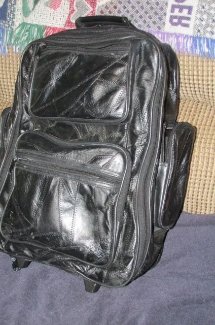

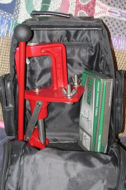

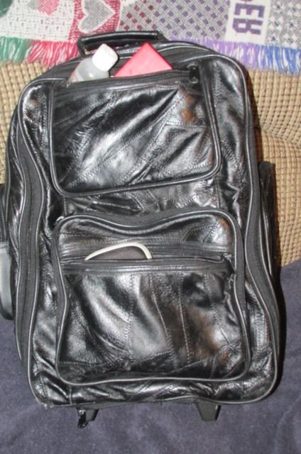

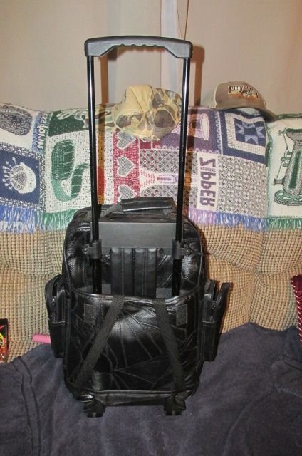

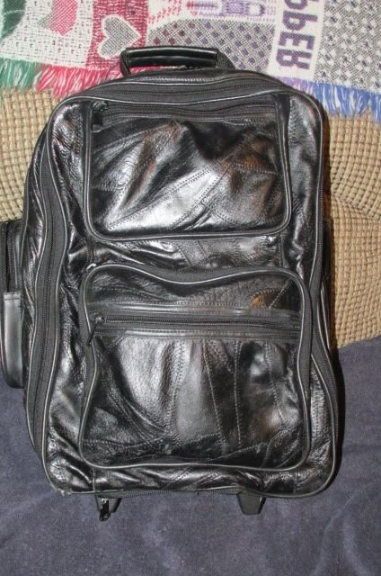

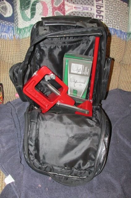

in my search for a container of some type to pack our portable loading equipment, I came across an old back pack/dolly/bag that has been in the camper for a while .... the hitch and board are stored in an area in our truck .... the electronic powder measure will be stored securely in our camper .... I believe that most of the rest of the equipment and supplies we will need to transport will go into the bag .... I'm unsure about where we will pack the gunpowder .... possibly in the bag with the press, possibly in a closet in the camper .... I tend to believe that our search will be ongoing and this bag should serve the purpose until something better comes along

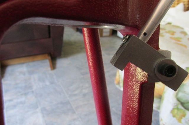

I did order an Automatic Primer Feed (mentioned above) for our press .... after it arrived, I disassembling our portable loading station and installed it .... simple enough, to be sure but there was a problem .... the wire spring that holds the primers in the tube is the key to the whole operation .... it is held by a single, small screw on the front of what they call the Primer Feeder Body and can be seen in the picture below .... in looking at the small spring it was easy to see that it was binding .... it was clear that when the screw was tightened, pressure and friction torqued the spring wire and bent it .... it took a while to delicately adjust that spring to get it working .... but I don't have much confidence that the fix is permanent .... now that I'm anticipating loading 50 300 WBY rounds within the next few days, I decided to call Hornady and talk with them about the spring .... as has been the case every time I've had to call them for assistance, the fellow I spoke with was great to work with .... after telling him about the spring, he immediately said he'd send a replacement right out ....
