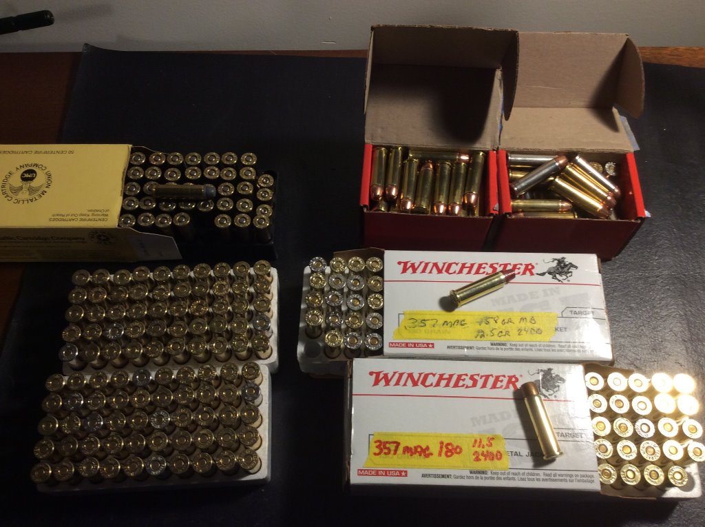

Finished up loading various .357 Mag loads for the new Henry to come!
357 Mag ammo.jpg (145.45 KiB) Viewed 2646 times
Nice! Maybe someday mine will look as good.
