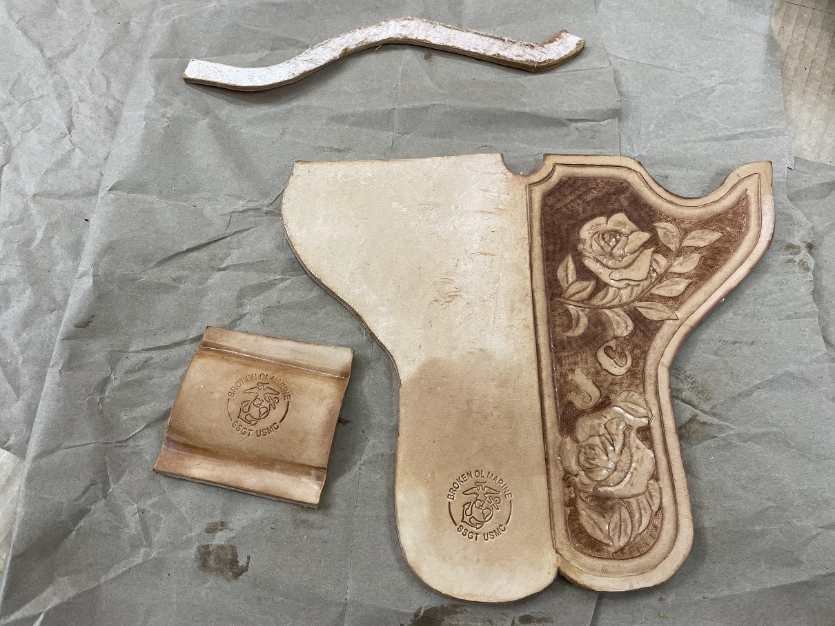

When I first cut out the holster for my December Gunbelt... I cut the dang thing out on the wrong side of the leather and I would have ended up with a rough side out holster... or a left handed holster, so I set aside that piece and recut the darn thing. I came back to the piece earlier this week and started on a left hand holster for my daughter's Frontier Single Action .22. Meh, practice makes perfect. I haven't mentioned it to her, and if it doesn't turn out, I'll toss it and just make her the pants belt I promised... without an accompanying holster. So far I have tooled the border and some roses...
03 leaves and background.jpg (456.58 KiB) Viewed 10267 times
I stamped her initials into the space between the roses, but don't like the balance. I'll probably background over them. Haven't decided for sure yet. I can always stamp them on a disc and add it... or put a concho there. I have some bejeweled ones. :lol:

I think it flows, but that's just me.

That's going to be a beauty.

Miss Tina agrees, so I'll leave it as is. I will be back out in the shop as soon as the replacement space heater comes in. I heat the main shop space with the mini split, set at 68 degrees, but in Winter, I use a space heater to heat the bench areas to a bit warmer dut to the arthritis in my hands, shoulders, knees.. um... joints. That died a couple days ago... :evil:
