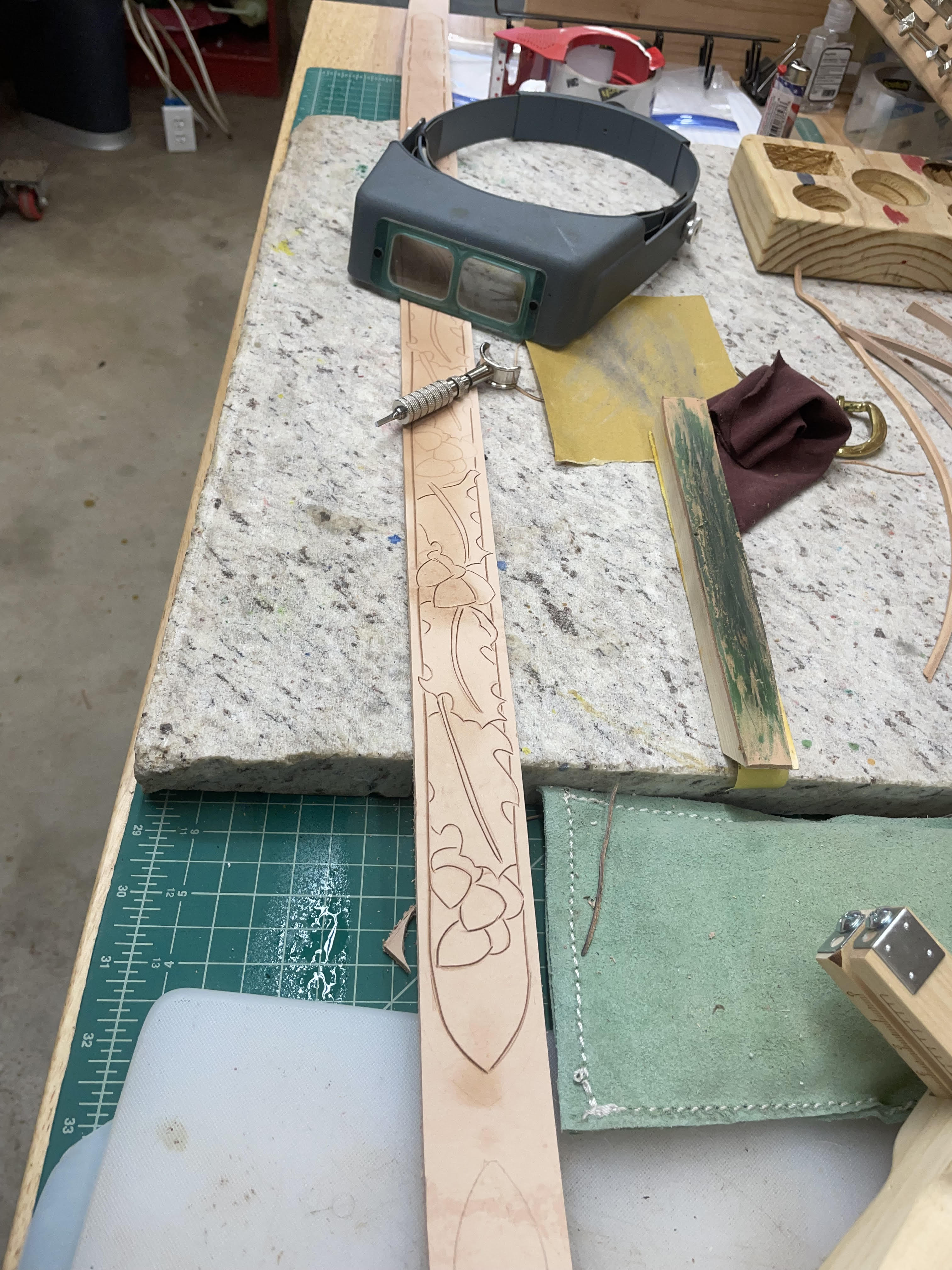

Post by BrokenolMarine » Wed Nov 13, 2024 11:13 pm
Dave said we should also post leather projects here, so I don't mean to bore you guys, but I need to practice my leather work, so here we go...
I cut a couple long 1-1/2 strips to make pants belts. I won't say exactly how long... (fatboy long) but long. I used a tool that makes cutting a consistent width easy. Then I traced an oak leaf and acorn pattern in preparation for transfer.

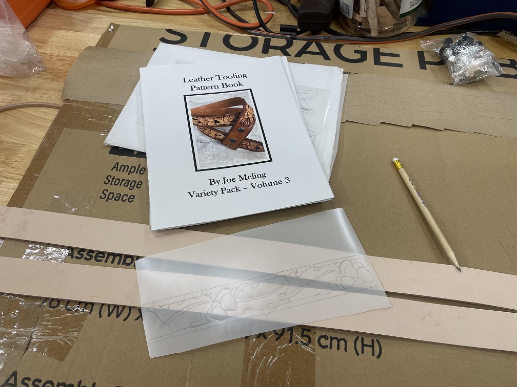

01 started on layout.jpg (253.53 KiB) Viewed 8735 times

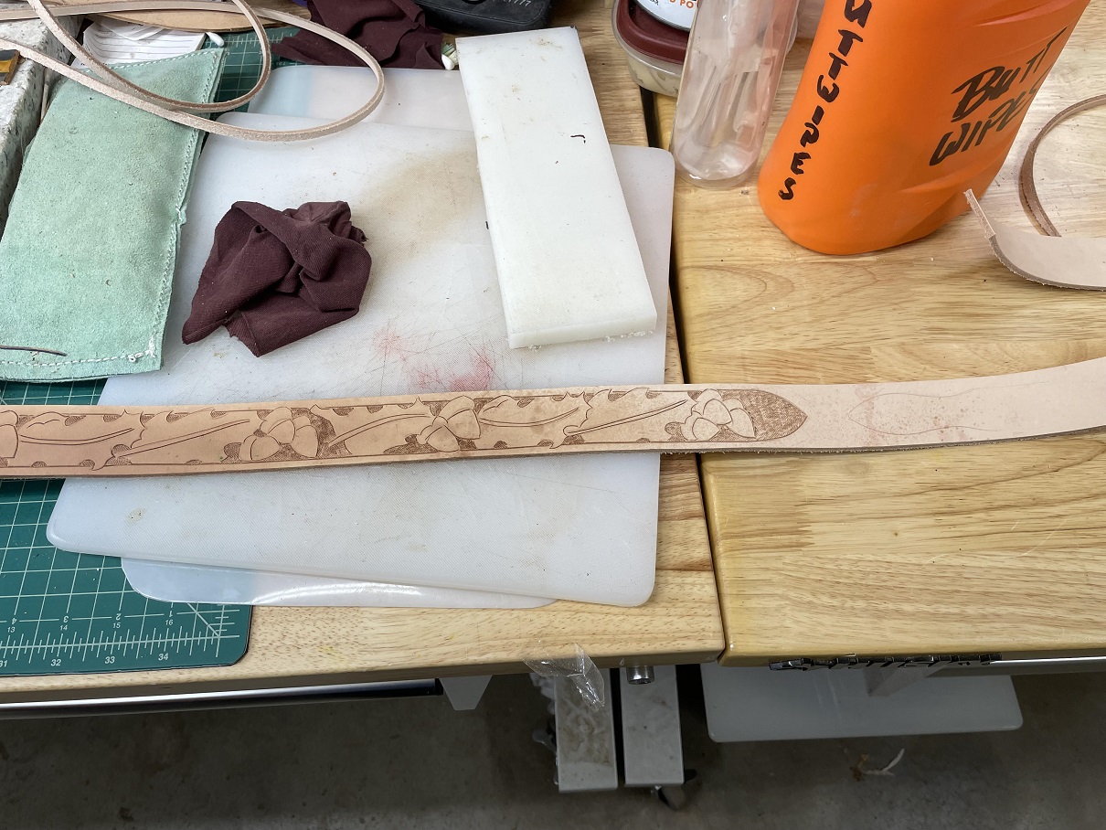

After casing (wetting) the leather to make it take the impression better, and determining the spacing at the ends for the sewn on connection for the buckle and the holes, I carefully transferred the pattern down the full length. This was done in steps as the pattern itself in the book is about ten inches long. It's meant to be a repeating pattern.
02 transfer to leather.jpg (1.02 MiB) Viewed 8726 times

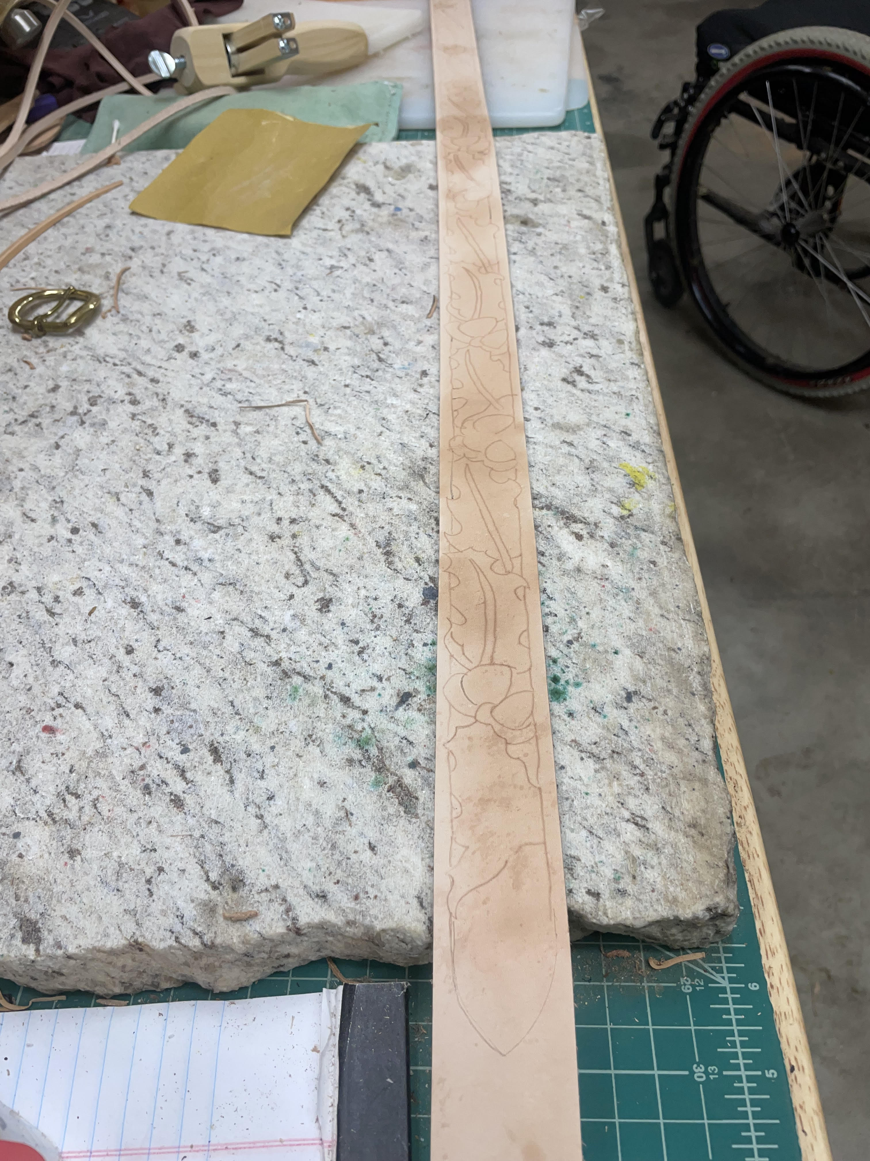

Next I sharpened two of my swivel knives, a bold bladed knife for cutting in the borders and the small tipped swivel knife for the finer cuts. This included 220 and 400 sandpaper and then rouge on leather and buffing on felt. Ready to start cutting in.
03 cutting in.jpg (1.25 MiB) Viewed 8726 times

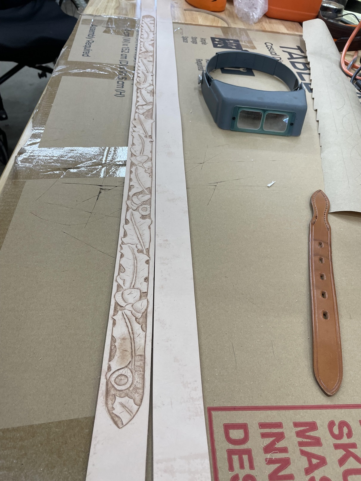

After the edges were done, I started on the center pattern, and had just gotten going when I was told by my friend arthur, that I was done for that session. In fact, I learned that my hands were done for the day. That was actually a lot of concentrated hand work.
04 beginning the details.jpg (1.04 MiB) Viewed 8726 times
Will be back at it tomorrow, and may even get to start on the tooling. Been a while, so I consider this belt a practice session. The second belt should turn out better. Because I don't have a butt, I'm considering D-rings to attach suspenders to. :o

Post by BrokenolMarine » Thu Nov 14, 2024 9:57 am
With this type pattern the center isn't really an issue. If I was going to do the name thing, then yes, I would have to figure out where the belt would center, NOT the center of the belt. I would lay out both ends, with the holes and the slot for the fold for the buckle, then simulate the belt on the waist, and find the actual center at the small of the back and mark that. Then work the pattern from the center. Same with a gun belt when I'd want to center the bullet loops in the back.

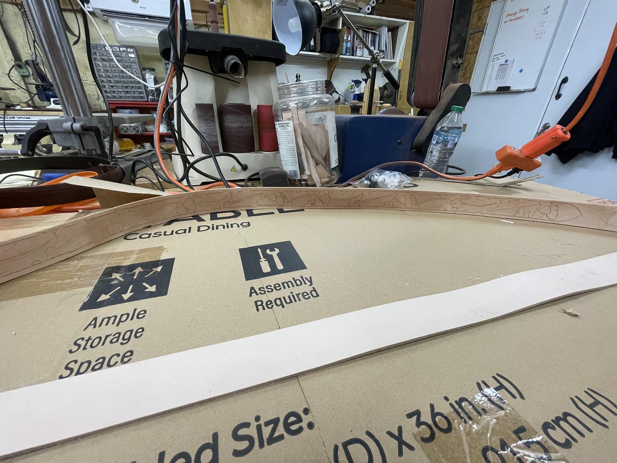

Post by BrokenolMarine » Thu Nov 14, 2024 12:15 pm

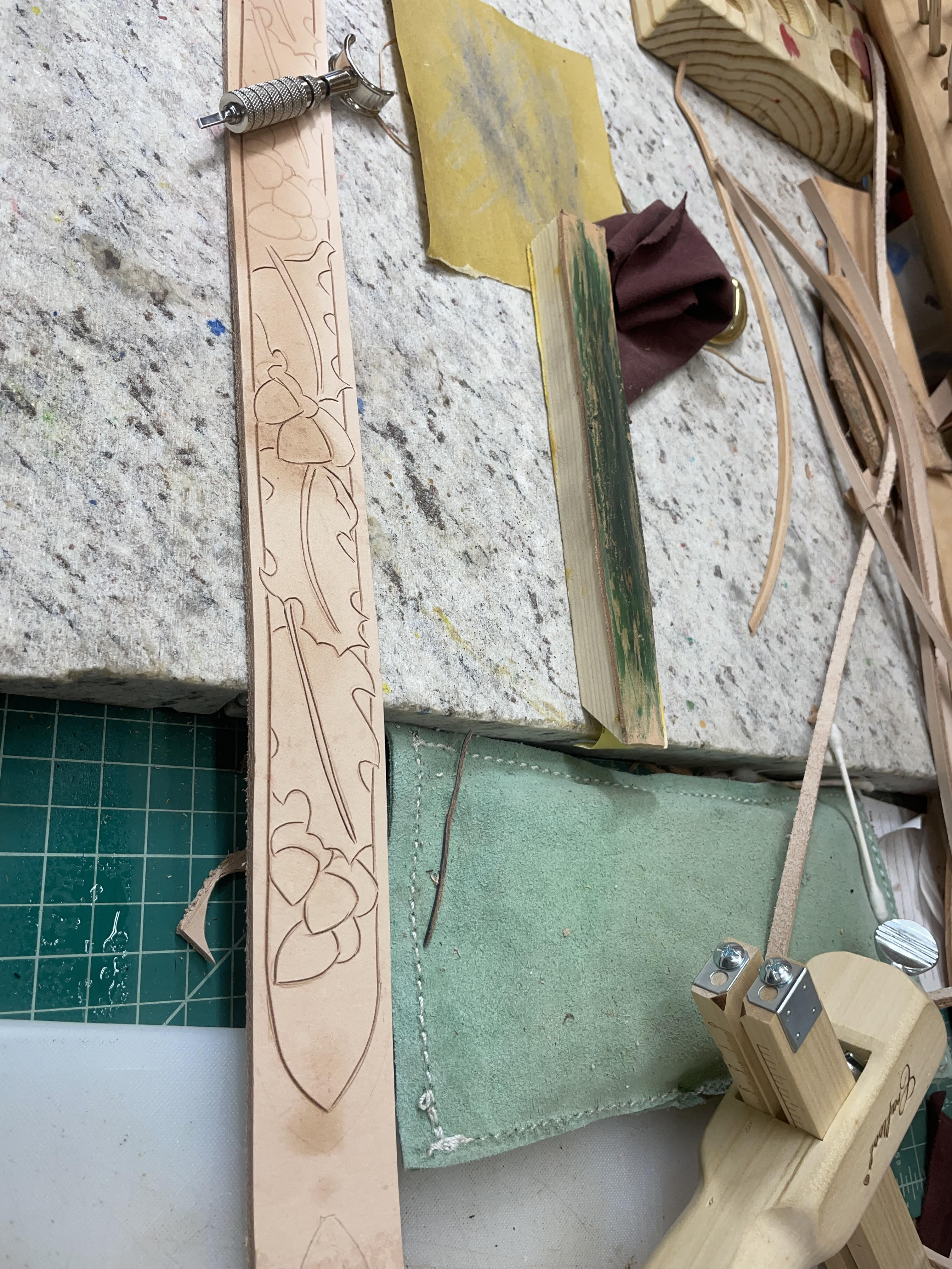

Got out this morning after coffee and a light breakfast, and got back to cutting in. That small swivel knife is quick, so I have to pay attention and I found I also have to resharpen often. After about an hour, I had finished cutting in. It was looking pretty good. (um... okay. :twisted: )
05 finished cutting in.jpg (474.11 KiB) Viewed 8719 times

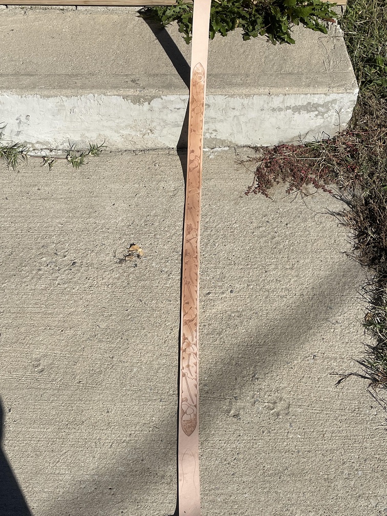

A long shot lets you see how the belt is already starting to pop, without ANY of the detail work started. I am a long way from completed, but it's already looking much better just with the backgrounding done. (This will be touched up later, but that will be no big deal.
07 Shaded background full length.jpg (503.81 KiB) Viewed 8719 times

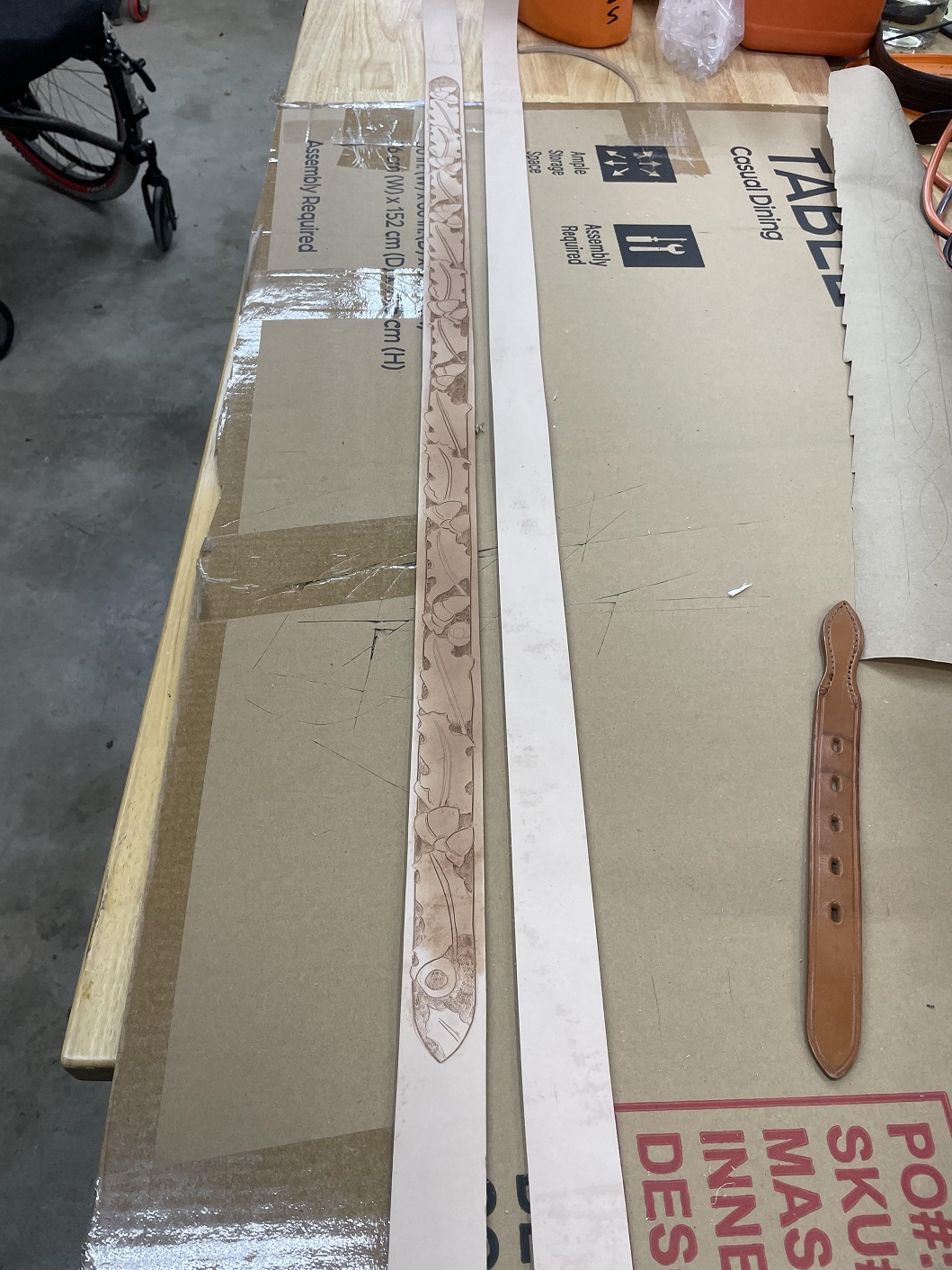

Here is a comparison shot of the tooled belt and the blank leather strap so far.
08 comparison shot.jpg (463.55 KiB) Viewed 8719 times

In that long shot, you can see the color change as the belt is beginning to dry from the tooling. You have to case (wet) the leather to tool it. I use a spray bottle. Some wet it with a sponge, and some run it thru a shallow pan of water. To each his own. I'll rest my hands and get back to it.

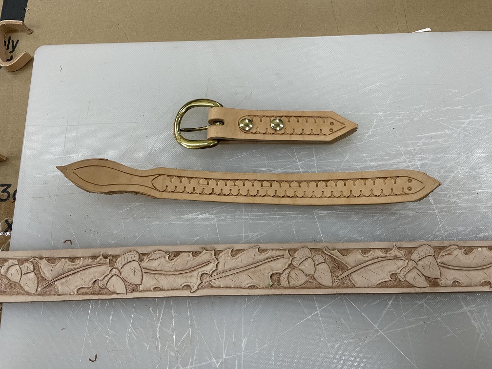

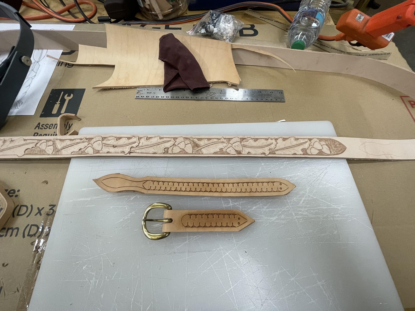

Back out this afternoon after Miss T got home with lunch. I spent some time on the belt working on the details, then worked on the buckle attachment and the strap that will have the holes in it. I'm sure those parts have names... but I don't know them. (Yet.)
After I cut them out... I (Of course) had to add some details. I went with the serpentine pattern since the straps were too narrow for much else. When I do the cartridge belt, I think I'll go with a barbed wire pattern. (Ever notice some folks think the wire was named after a guy named Bob?) :twisted: Usually it's folks who have never strung it, repaired it, or tried to get through it in a hurry (Being chased by an angry bull or an angry farmer, and met "Barbs". :lol:
10 getting close.jpg (593.89 KiB) Viewed 8258 times
We are so close. ;) I have to drill / punch holes for the buckle attachment chicago screws, and the holes where the buckle bar will go in that strap. I need to burnish ALL the edges after I have decided on stain, or natural oil... then after everything has had it's first coat, sew it all together. I also need to make two retention loops. One for the belt to slide into, then one for the buckle strap to slide into. All fun.
Still, close. 8-)

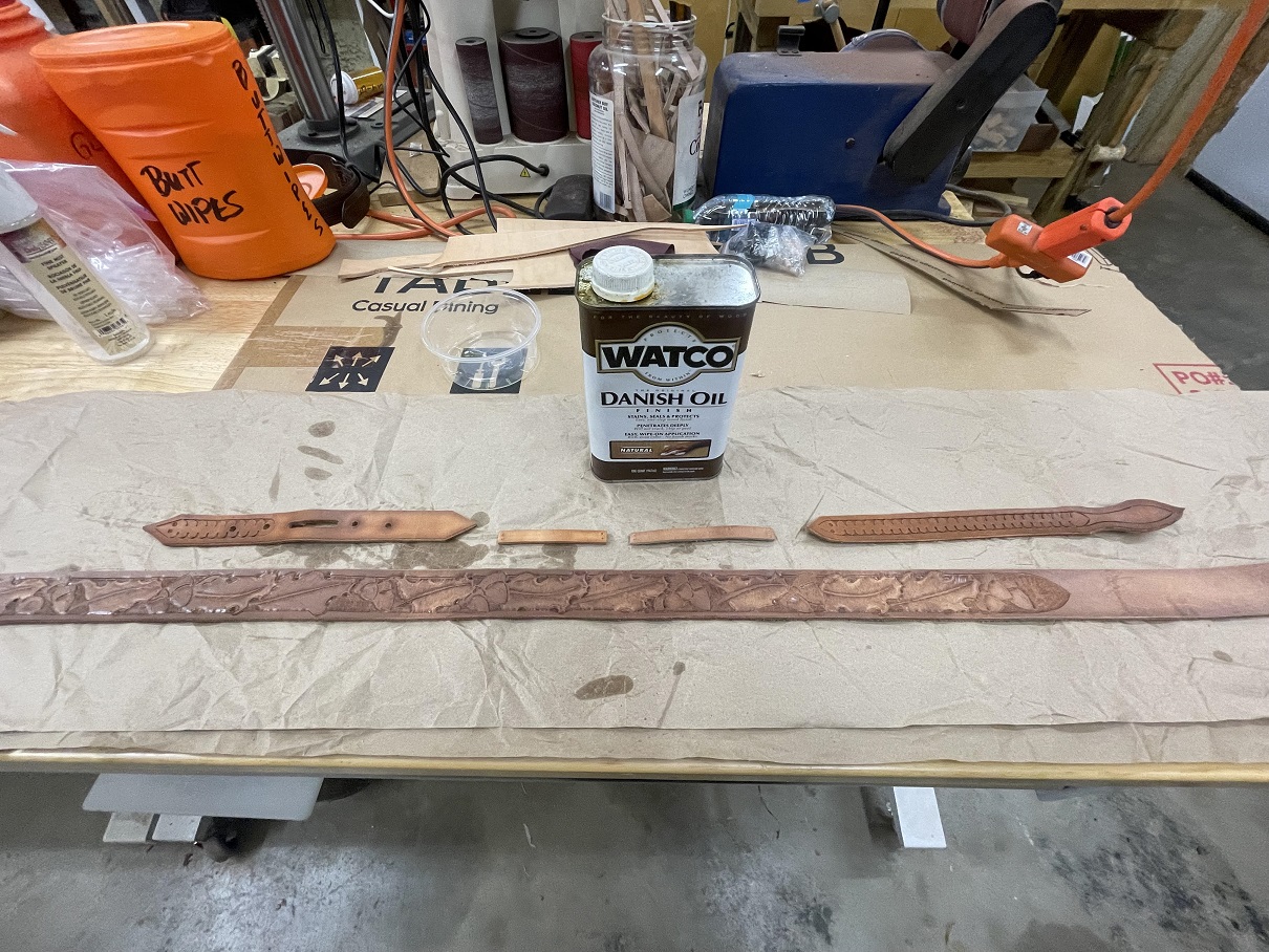

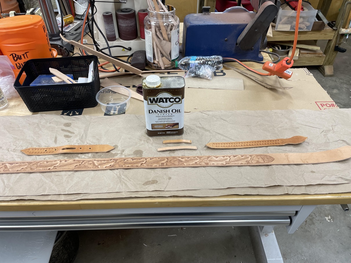

After some last trimming and neatening, I beveled the edges that required it, then applied coats of Watco Oil in the Natural color. I left the parts and pieces to dry overnight. Looking forward to seeing the color in the morning.
12 Natural Watco Oil.jpg (484.73 KiB) Viewed 8248 times

Out in the shop this morning and I like the way the pieces looked after the oil dried overnight. :) Natural was a good choice.
13 The oil after it dried.jpg (412.02 KiB) Viewed 8243 times

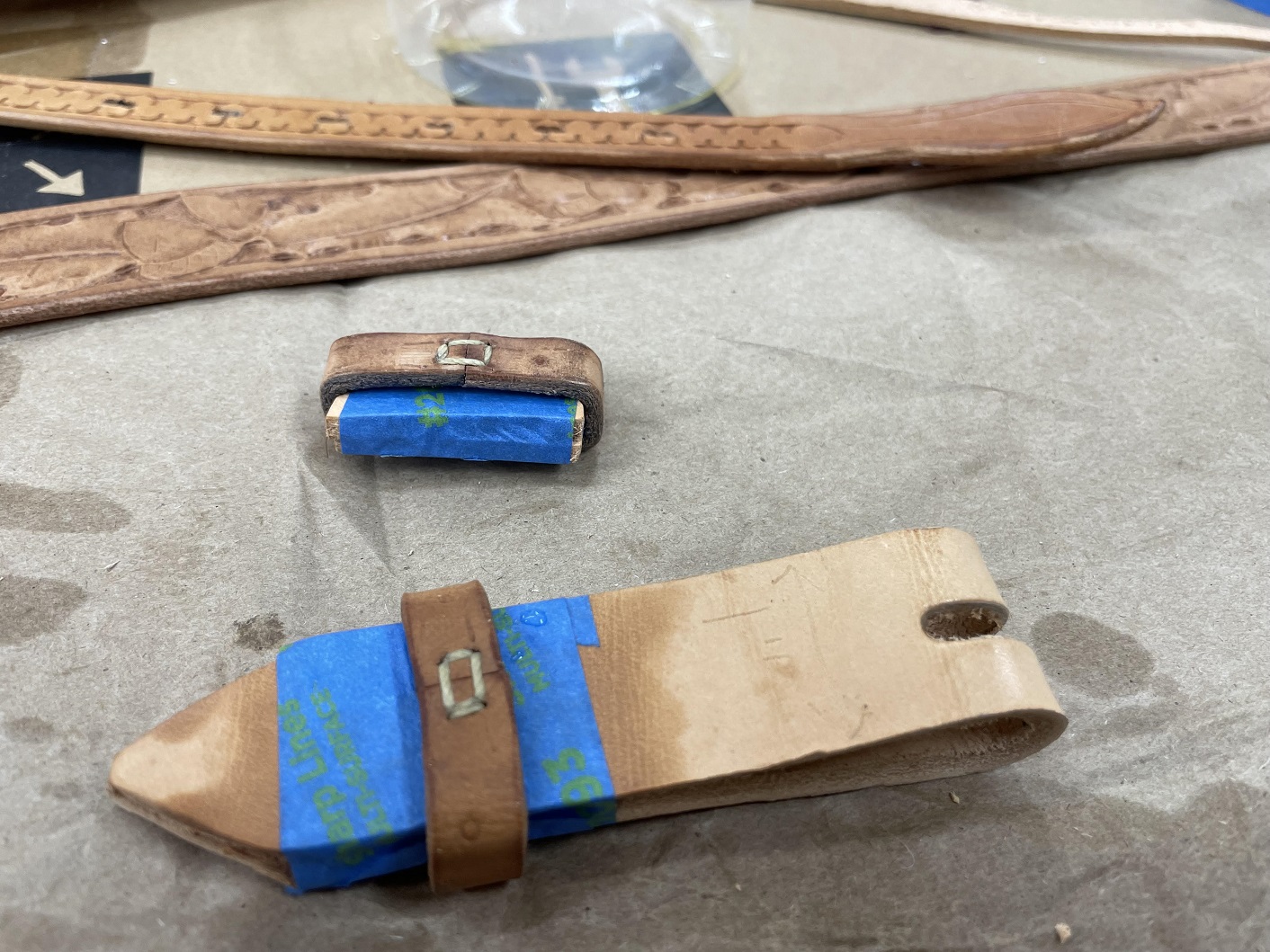

I set up the burnishing wheel on the drill press, wet each piece on it's edges and added some burnishing gum, and went to work. The key to burnishing is NOT pressure, which would deform the edges. This was a hard learned lesson for me. It's the friction, and for that you just let the hand burnisher or the powered burnishing wheel flow along the edge until the heat builds up. I knocked out each and every piece in time, NOT rushing and NOT pushing.
Then I marked and cut out the holes in the Billet that would have those. I drilled the proper hole in each end of the oval shape for the holes, then cut the sides to form those shapes. That done, I moved to making the belt loops I would need. I carefully checked the size one last time, and trimmed a 1/4" off the larger of the two. Then I taped the scraps that would simulate the location for the loops for wet forming with painter's tape. (I love that stuff, use it ALL the time.)

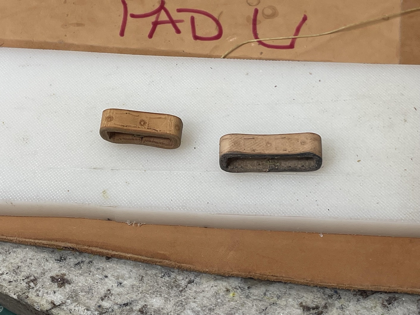

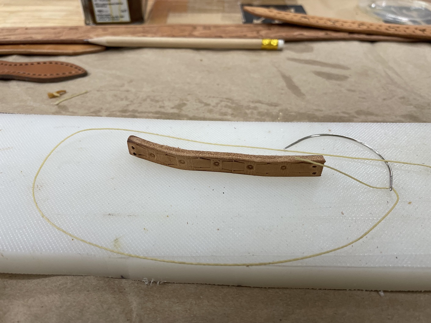

I drilled a small pair of pilot holes in both ends of each loop, and then punched them with my sewing awl to get the correct size for the needle. I would use a curved needle for this one. Pulled the thread thru the wax and ... We are set.
14 get ready to sew.jpg (394.22 KiB) Viewed 8243 times
I took my time, pulled the stitches nice and tight, and once I was done I wet down the loops and pulled them over their respective forms and burnished them flat on all four sides. I set them aaside to dry around the forms. (Wet forming them into the belt loop shape.)
15 belt loops sewn and wet formed.jpg (485.5 KiB) Viewed 8243 times

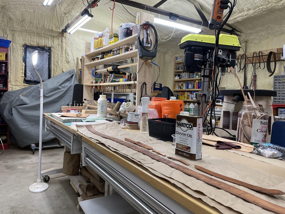

Here is a nice view of the tooling bench and the shelves and organizer for the punches and tooling that I made to keep things organized yet still at hand. I started just with the block for the punches, then added the shelves, then the dowel for thread and the paper towels, which I need to refill. :roll:
17 tooling bench.jpg (501.21 KiB) Viewed 8243 times
Back up a bit and you can see the cutting / work bench. I try to keep this bench free and clear as much as possible, so it has space to lay out sides of leather for cutting large templates or original designs. It's handy to the tooling bench and I can roll back and forth in the "Chair" between tooling and cutting additional sections of a project, such as holsters or sheaths... handy.
18 add cutting slash work bench.jpg (492.21 KiB) Viewed 8243 times

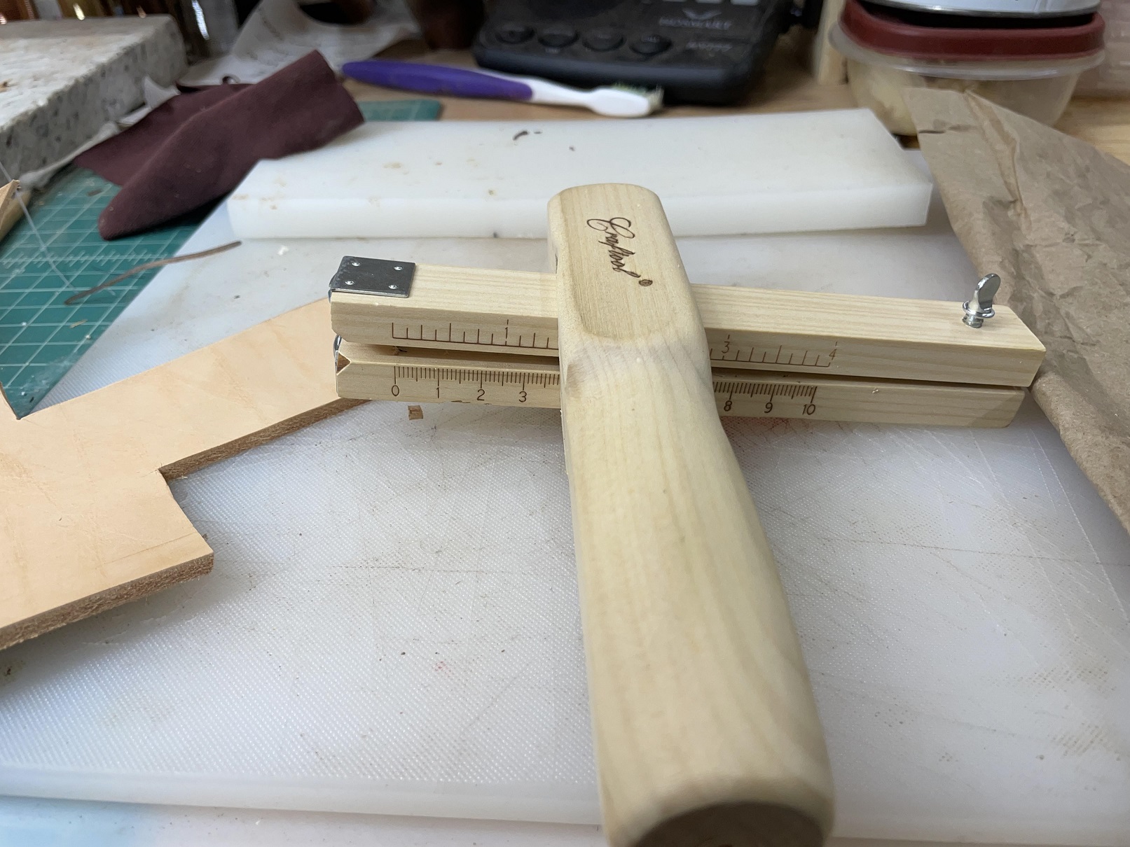

The last item on the mini tour is the Strap Cutter. Set the width you want and the thickness of the leather, then pull the leather thru this tool and it will cut a nice consistent strap (Belt, suspenders, retention strap) of whatever length you need. Perfect for the project I just started.
19 strap cutter.jpg (504.59 KiB) Viewed 8243 times
There are fancier ones, but this works fine for me.

Several Sessions today. I was anxious to see how the belt loops turned out. They turned out great, the wet forming worked well. Nice and squared off. Nicely formed.
20 loops formed.jpg (474.64 KiB) Viewed 8232 times

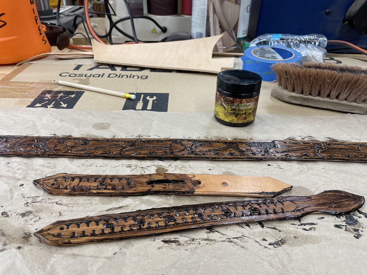

Before I began sewing and assembly, I applied the antiquing. I used medium brown. While I gave it a bit of time to set, I consolidated the OLD dark brown tub with the new one. Messy job, and I was glad I wore gloves. Nasty. I fiddled around cleaning up and getting the stuff together for sewing and laying out the stitch lines.
21 applied antiquiing.jpg (470.24 KiB) Viewed 8232 times
After the antiquing had set for a half hour or so, I first wiped away the excess with a dry cloth, then with more attention to detail with a damp cloth. Looked good.

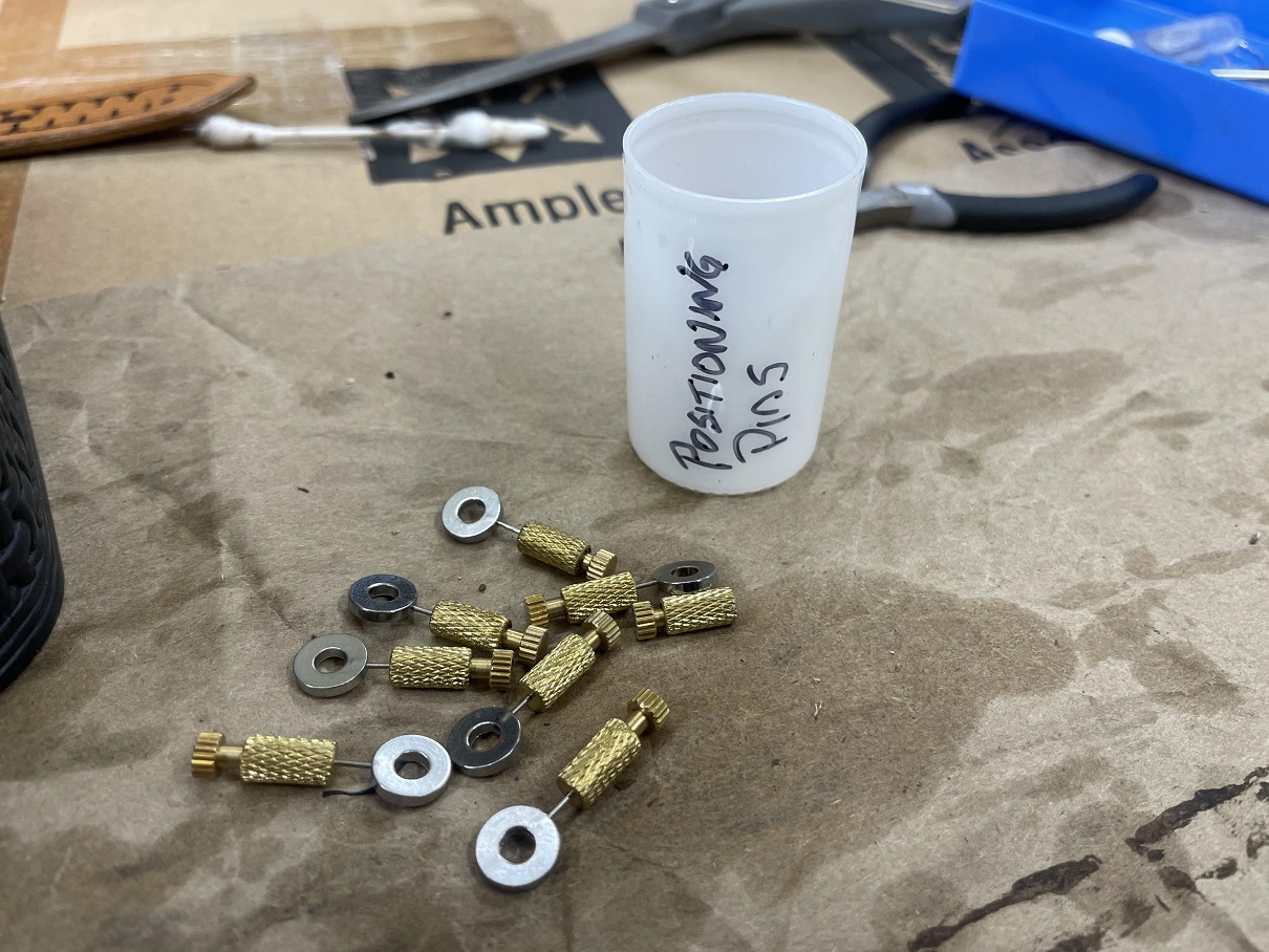

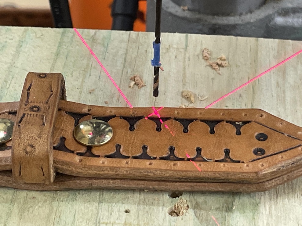

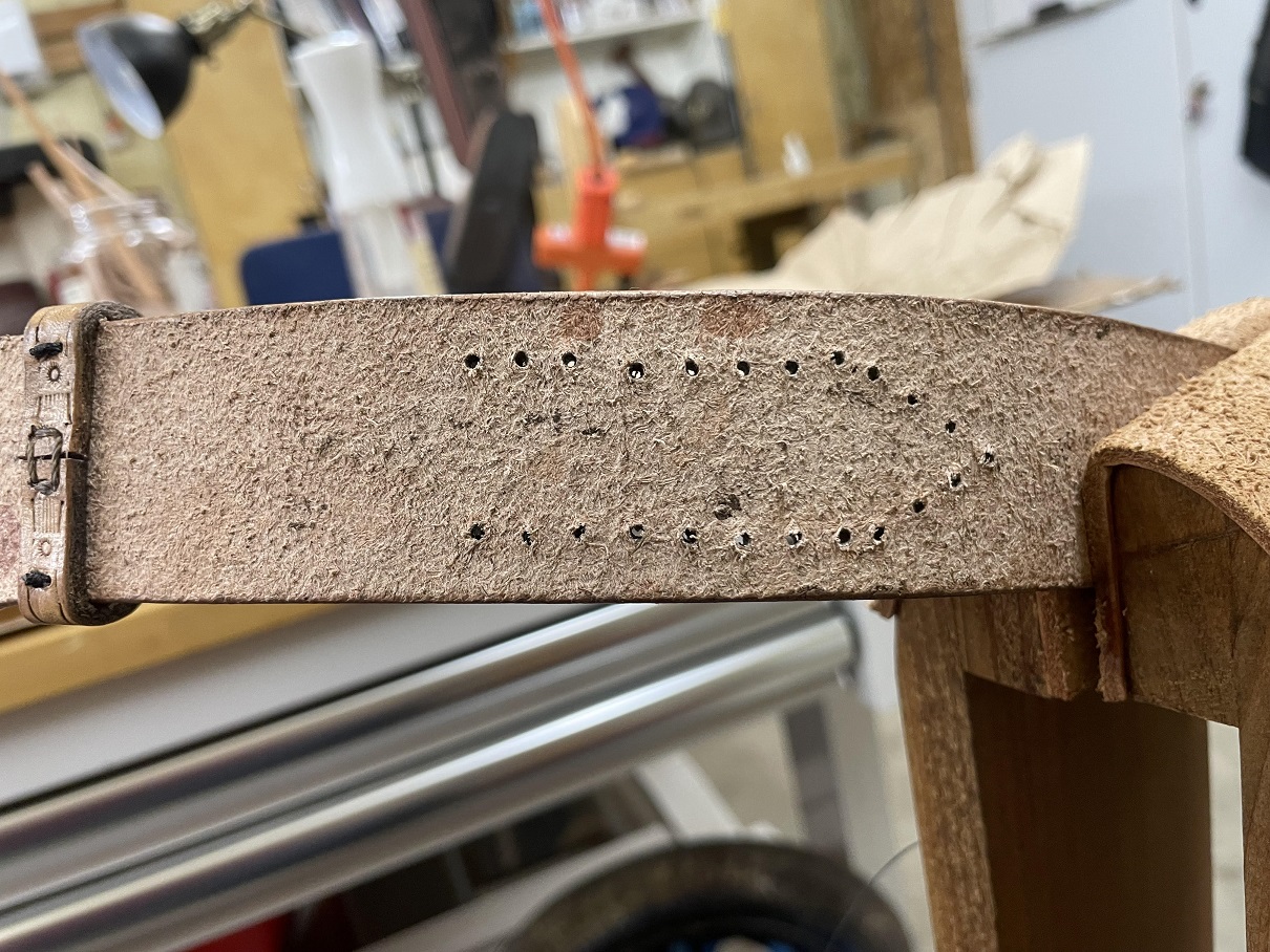

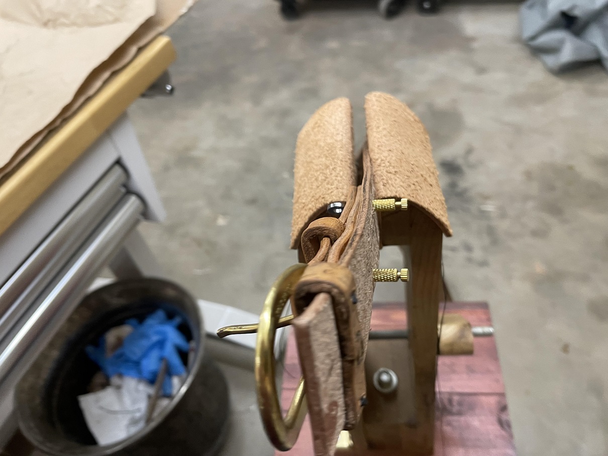

A couple tricks to make sewing the buckle assembly one, work well for all hand sewing. Since the holes are hard to see on the back of the leather... I take a sharpened pencil and spin it in both sides of the holes once they are drilled/punched into the leather. This accomplishes two things. It "countersinks the holes a bit, pushing down the leather so it's not puffed out. On the back side the pencil leaves a graphite ring around the hole marking it so it's easily seen for stitching.
25 trick for hand sewing.jpg (442.98 KiB) Viewed 8232 times

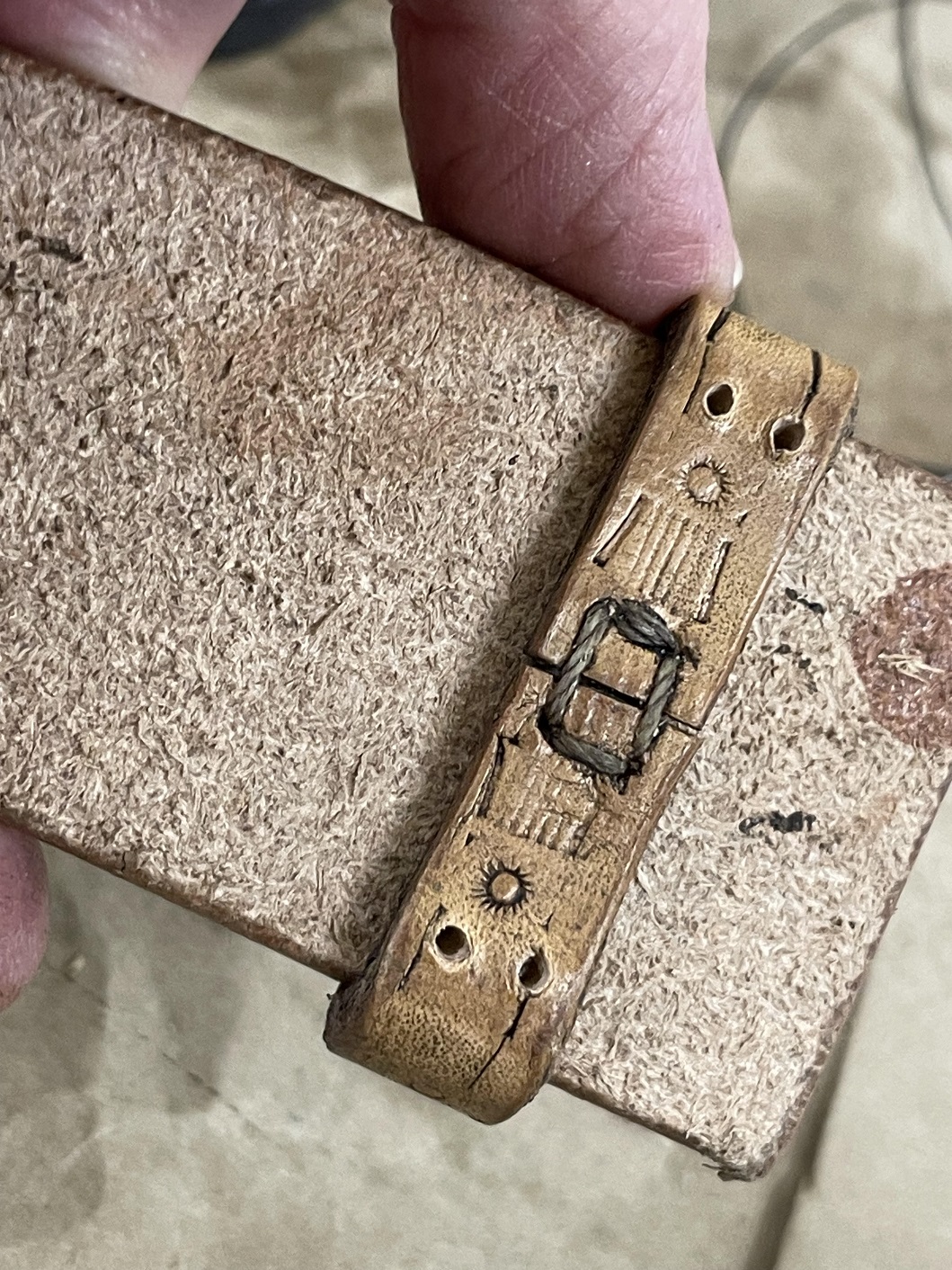

Another trick is using positioning pins to hold the parts in place.
26 positioning pins.jpg (360.62 KiB) Viewed 8232 times
You can see in the picture below with the piece clamped in the Stitching pony, the positioning pins hold the buckle assembly against the belt. Once you sew to the pin, you remove it and continue to sew.
27 Ready to sew.jpg (290.79 KiB) Viewed 8232 times

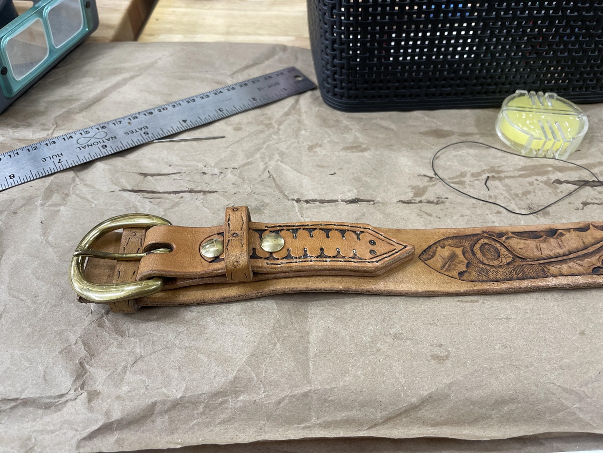

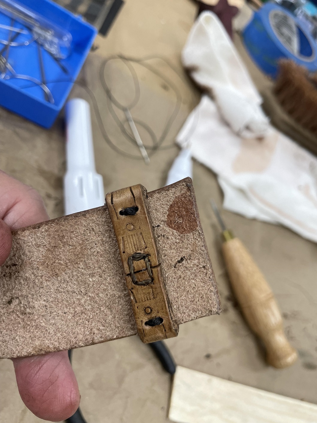

I got the buckle sewn on here and it looks good.
28 Buckle sewn on.jpg (461.83 KiB) Viewed 8232 times
