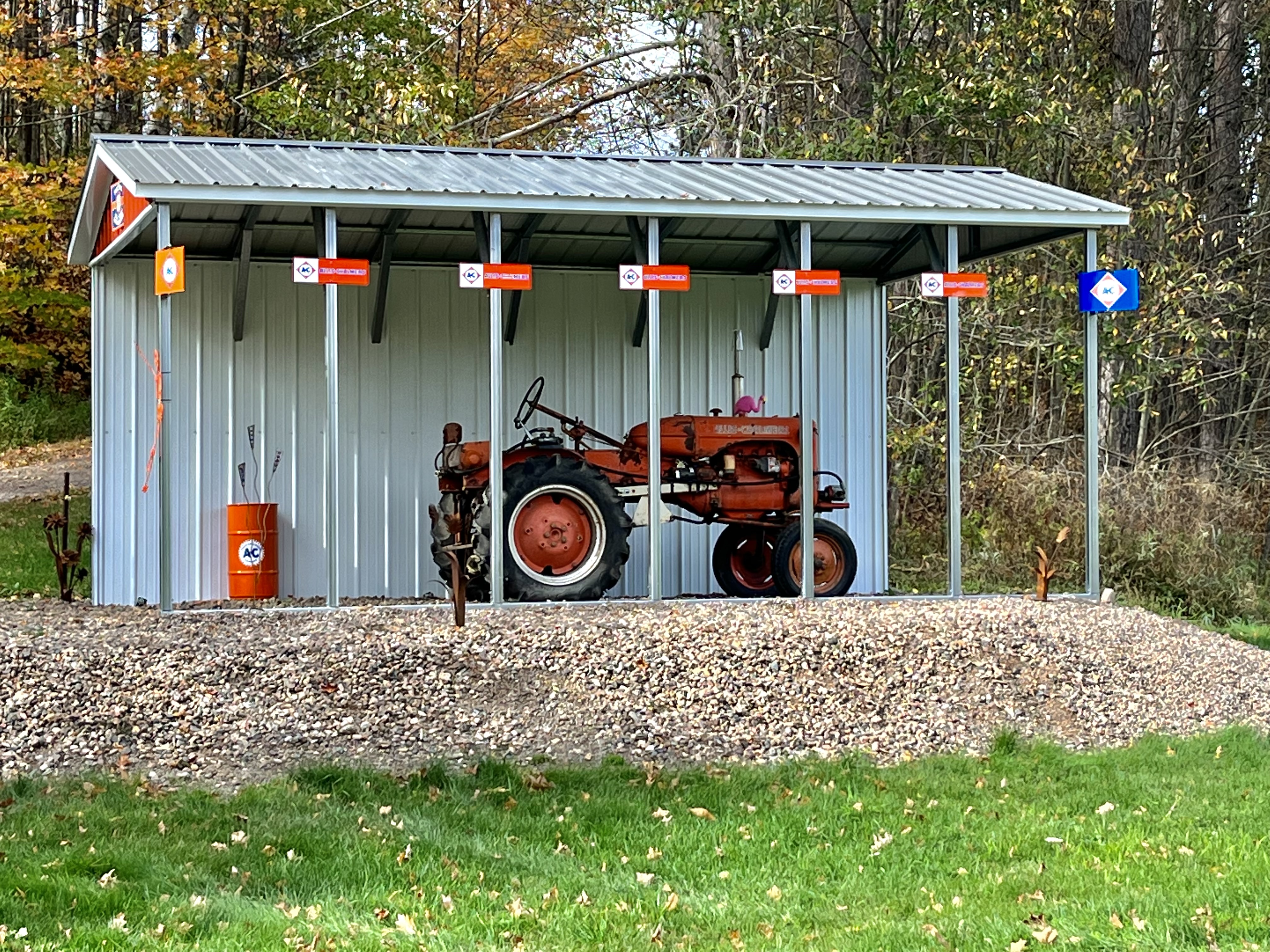

I’m getting an estimate for a 120v 20 amp underground feeder line to Alice.
And I’m getting a separate estimate for a 120v 30 amp feed up the hill for a future barn. The feeds will be 600 and 400 feet respectively and will need to be oversized to keep the voltage from dropping. I’ve shopped online for the wire and it may cost upwards of $3K. I may have to sell a kidney to be able to afford it.

The trencher is coming Saturday so I should have power to the tractor shed by next week. They will also trench to the top of the hill and lay the line. I’ve contacted a neighbor to bulldoze the road and it might also be done in a few days. Then everything will sit over the winter till it’s warm enough to pour concrete. A month later I’ll be having a metal garage that’s 30’x72’ and a lean-to that’s 12’ wide and 36’ long installed.

I hung some party lights down by Alice this morning. I’m still scheduled to have the trenching done Saturday and the wires hooked up on Monday. These party lights are the same as I have on the house and garage.
