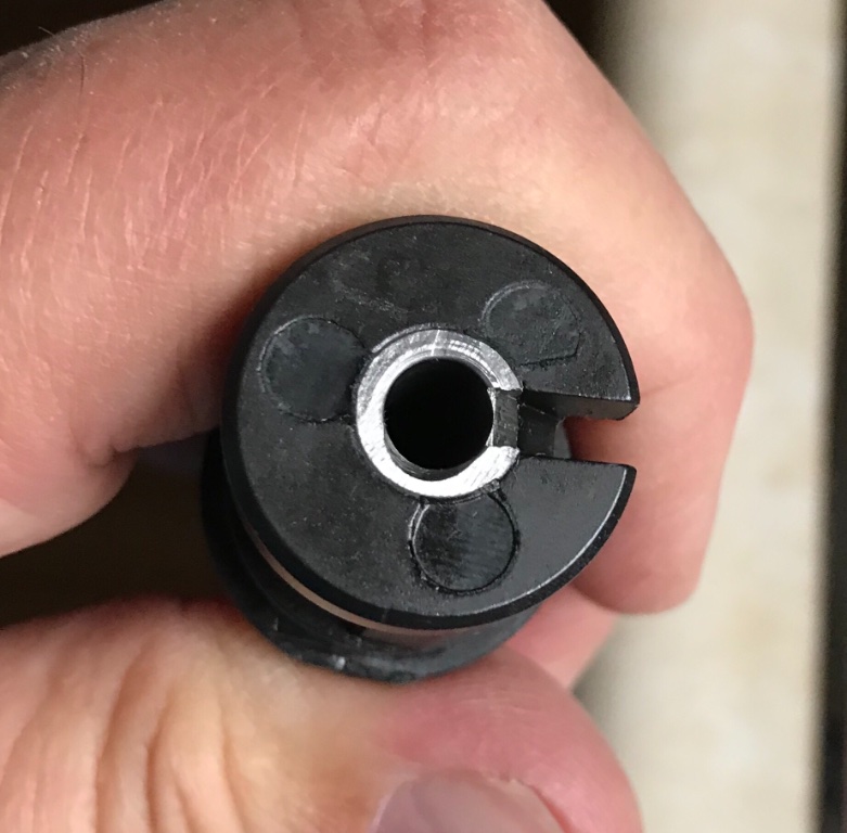

Post by Hobart » Wed Dec 04, 2019 3:04 pm
Here’s the breech face damage after one dry fire. Firing pin dent visible at the 12 o’clock position.
Still waiting for a shipping label from Henry.

Post by Mistered » Wed Dec 04, 2019 4:01 pm
The FP dent appears to be 'canted' off a few degrees - Is the FP at an angle in the bolt?
Also what is the 'smile' at the bottom? Is this considered the barrel 'ramp' ?
I think there are a few issues going on here.

Post by Hobart » Wed Dec 04, 2019 4:26 pm
The smile is there so the round will feed smoothly and not hang up on the edge of the chamber. At least that’s what I’ve been told. Can’t really check the angle of the firing pin because I have the rifle packed up for return.
Mistered
Re: Breech Face Damage
Post by Mistered » Wed Dec 04, 2019 4:29 pm
Ok, this is the 'ramp' then - kind of what I figured.
The FP dent appears to be off center and canted like I said but this could be very normal and due to how it is positioned in the bolt.
