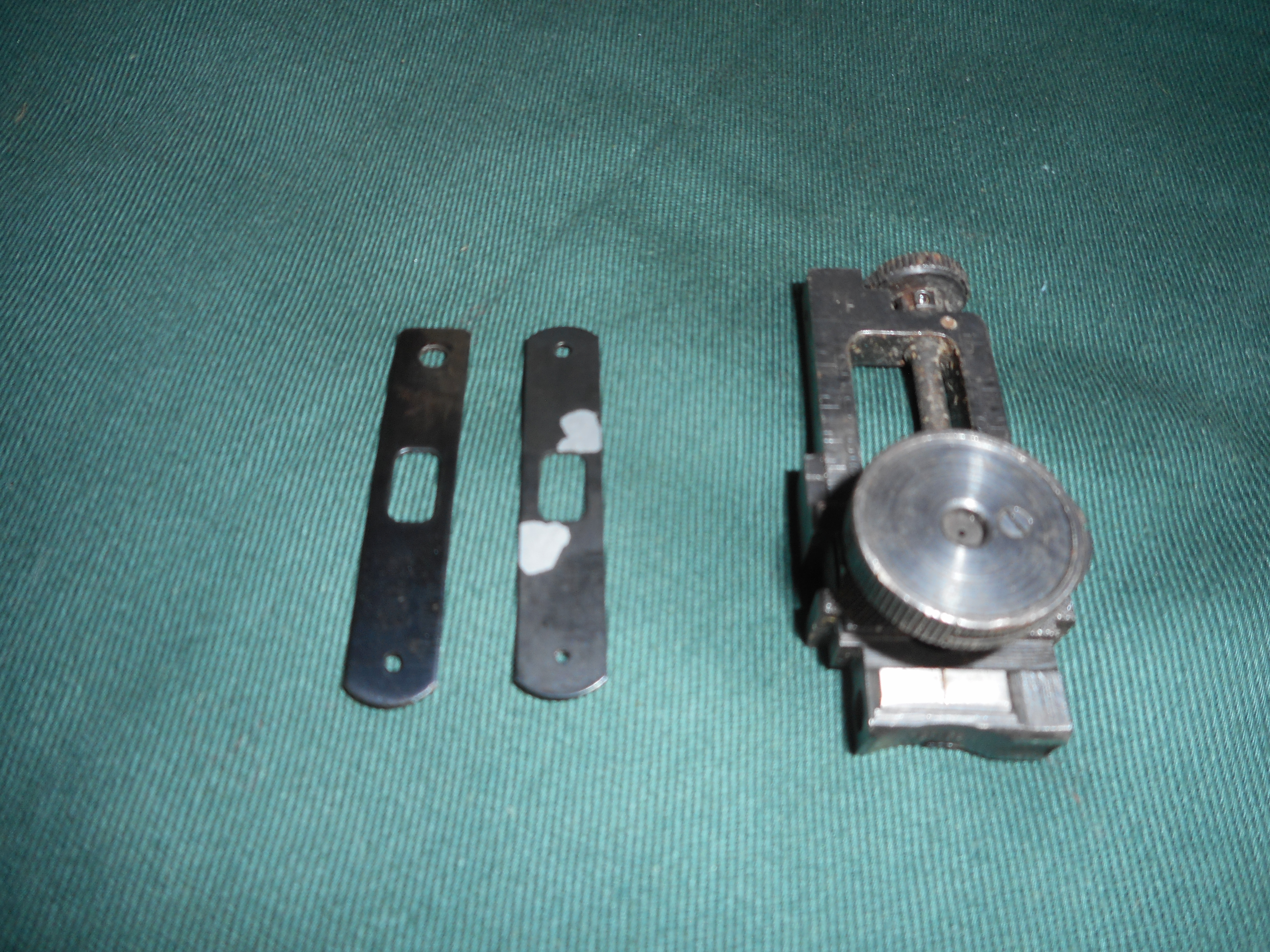

REAR SIGHT MODIFICATIONS
After viewing GunBlue490’s video, I hope that AR-7 shooters reading this have become convinced that, if not a Ghost Ring, at least a larger aperture in the rear sight of their rifle would be useful in terms of speed in acquiring their target, truly a benefit in low light situations and extremely helpful for those whose eyesight might be diminished. But what size aperture should it be?
A large number of hunters agree that .096” is about the best inside diameter for a ghost ring sight. They indicate accuracy and light transmission the reason for this choice. For the record, the larger aperture sight on the M16A2 rifle from back in 1970 measures about 3/16” or 5mm, which is a REALLY BIG HOLE! Without getting in the weeds, from what I remember, this sight is good out to about 300 yards. The other aperture on the M16A2 measures about 1/16” or 2mm and is good from 300 yards on out. I have the same Williams sights on my Ruger 10/22 that Gunblue490 has on his. The ghost ring on that rear sight measures 13/64”, another fairly large hole.
.096” falls in the middle of the 3/32 – 7/64 drill bits most of us have. Considering low light situations, I chose to drill a 1/8” aperture. You can go larger or smaller as you like.
Remember I mentioned earlier:
“Both the Charter Arms and the Henry have rear aperture sights made of stamped steel. They are interchangeable."
The difference is:
The Charter Arms rear sight has one hole of .125” in diameter.
The Henry rear sight has two holes, one of .075” diameter, the other is .0465” diameter.”
I own both a CA AND a Henry rear sight. This means, if I drill a 1/8” hole in my Charter Arms rear sight, giving it 2 holes, I will have two sights having 1 large aperture for general purposes, and 3 smaller Target Apertures, should I want them.
You would think this is the simplest modification you’ll ever do, but the devil is in the details. Because I was drilling a new hole in the CA rear sight, I had to very carefully locate my center punch not only left and right, but also locate it the same distance from the center of the sight blade as the hole on the opposite side. This was necessary so that the elevation and windage adjustment of the front sight would remain constant and not require re-zeroing every time I changed rear sights.
If you are modifying a Henry rear sight, just go ahead and drill through one of the existing holes. That hole will center the drill bit as you go. If you would like a set of sights with 4 apertures like I have, buy a rear sight from Henry Arms, drill the largest hole on one of them to 1/8” (or whatever) and drill the smaller hole to 1/16”.
As above, I used a silver Sharpie marker to create a silver spot on the sight blades to scratch in a witness mark. You should zero and put a witness mark on ALL of the apertures, that way you would be able to change apertures in the field should lighting conditions permit. I find it useful to zero my sights out to 100 yards and put on a smaller witness mark, so I can adjust my sight to deal with different distances, 25 yards and 100 yards. On the receiver, about ¾” from the top of the rear sight hood, using a modeler’s saw, I cut a datum line on the right side of the rear of the receiver for a more permanent mark.
Just to show how intricate aperture sights can be I've included this last bit of trivia. On the left is the modified Charter Arms rear sight. The one in the middle is an unmodified Henry rear sight. The one on the right is a Parker Hale target sight mounted with a Parker Hale eyepiece having 6 apertures on a rotating disc. The apertures range in size from .03 to .08.
