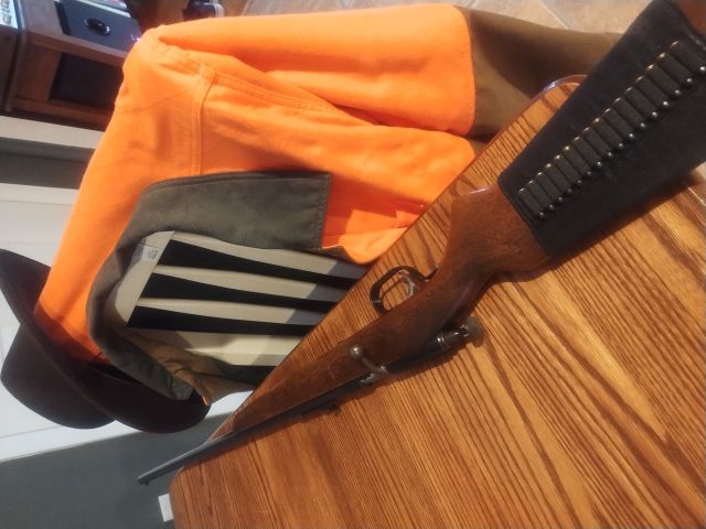

I stopped at Cabelas and spotted this in the used guns. No rust or cracks in the stock but the bolt was so gummed up and caked full of old oil and firing residue it was difficult to open. The store policy is not to remove the trigger lock which prevents removing the bolt. The tag said $59 and I thought what the heck. With military discount $56 is not high stakes gambling. :lol:
So...after a good session of "gun scrubber" along with a lotta Kroil and picking and brushing....she shoots and functions just fine. I don't know about accuracy yet but with my old eyes and those crude irons I think we can rule out minute of angle. :lol: :lol:
Pulling the bolt knob back to cock the old .22 sure brings back memories. :D

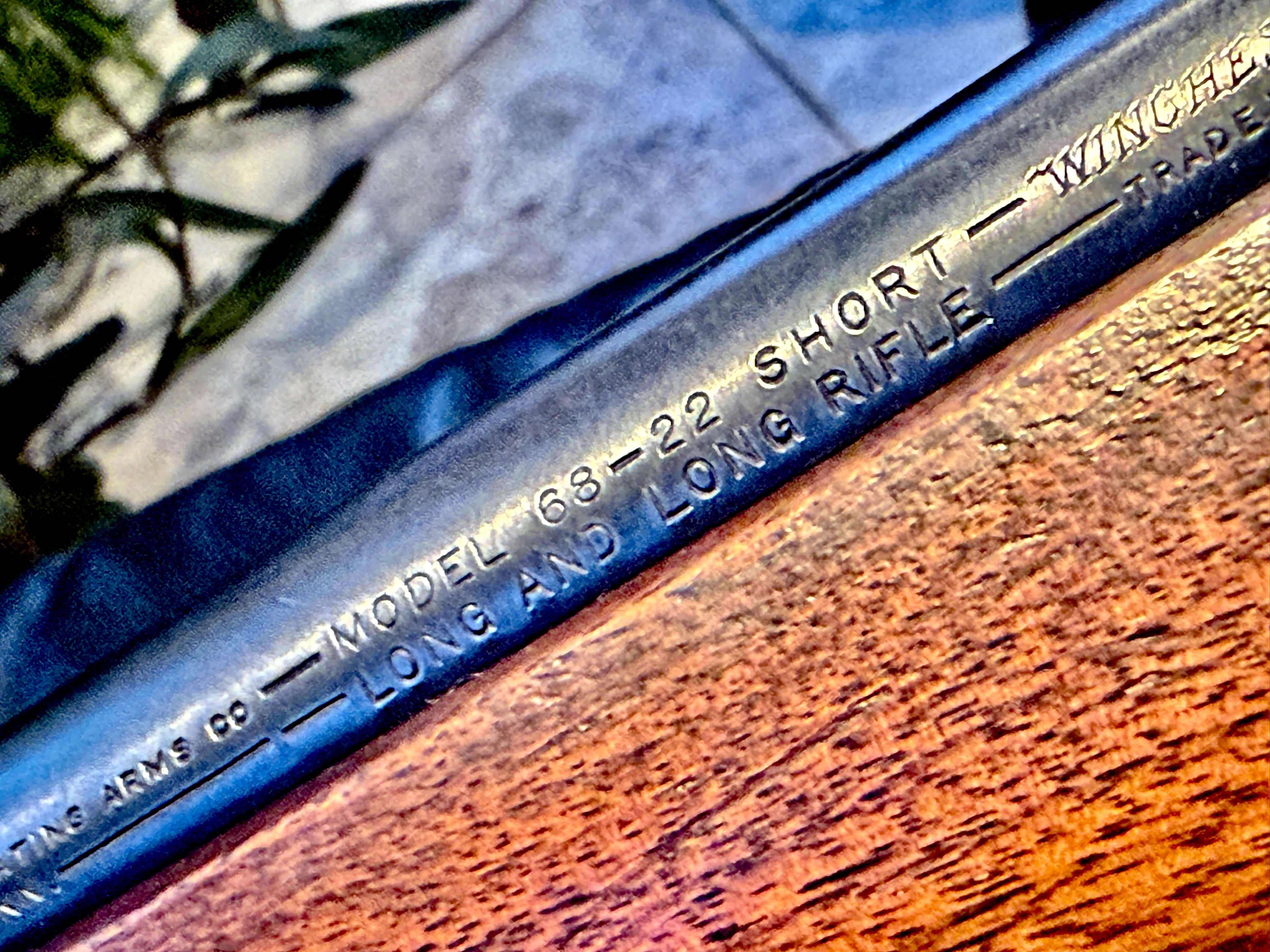

I bet it will be a great shooter. I have a Winchester Model 68 which is similar and loves standard velocity.
Working the bolt, inserting a round and then cocking it is slow and the slow rhythm naturally sets you up for a good aim and trigger management. Mine has the optional factory peeps.

I got to the range to sight in. Wind was 20 -30 mph with 20 something temps. It quickly became obvious why there wasn't an elevation ladder in the rear sight. Even in the lowest notch the POI was 2" high at 25 yards so I removed it. Windage was next and I used a Wyoming inertia sight drifter and found center. It was hitting the 3" 50 yard .22 swingers consistently with CCI standard velocity but the plan is to use this for varmints around the homestead without getting the housing developement west of my property stirred up. The two shots in the center are CB shorts and the other 3 are CCI Quiet .22 long rifles. The rifle will group better with the LR but I was half frozen at that point.
I'm pleasantly surprised by how well the old gal shoots. Especially with the CB caps.
Bottom line is that starlings, chipmunks and red squirrels best be careful. :D
