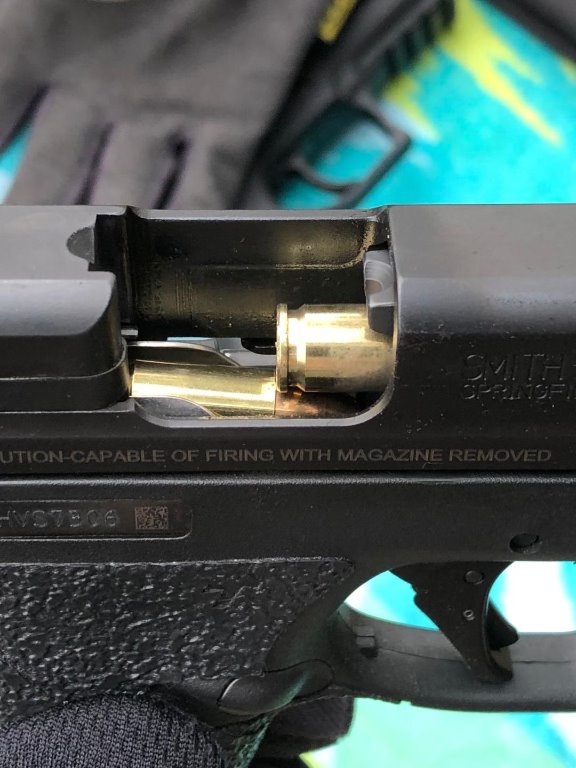

The first was several months ago in my S&W Shield. It looks like the case may not have been crimped tight enough to the bullet allowing the rim of the empty case to catch on it.
Armscorp stovepipe with Shield
Shield 1.jpg (62.52 KiB) Viewed 4279 times
A different angle of Shield malfunction
Shield 2.jpg (75.59 KiB) Viewed 4279 times

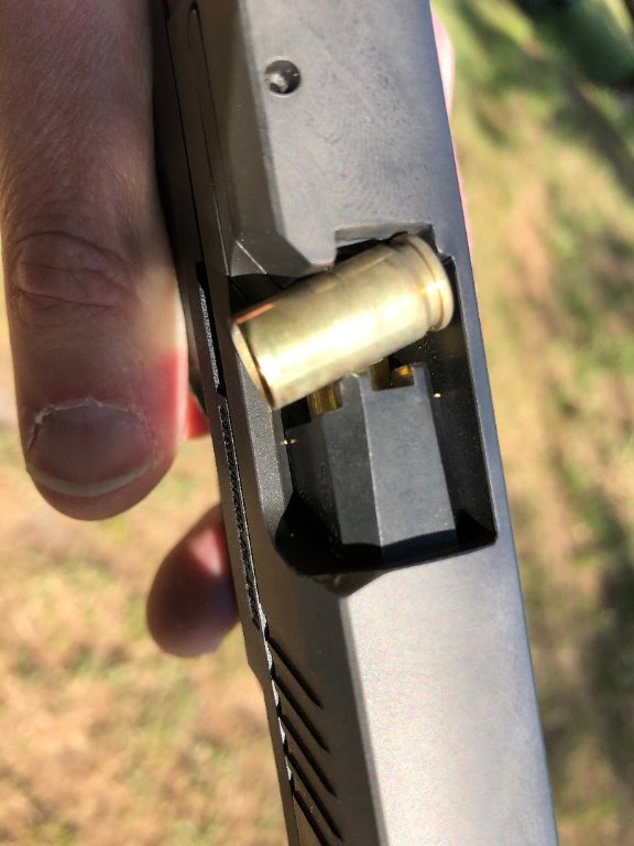

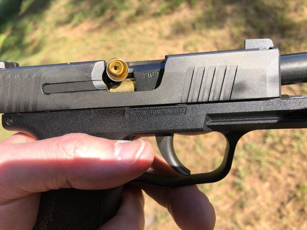

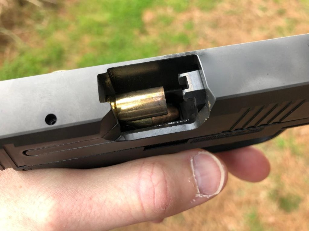

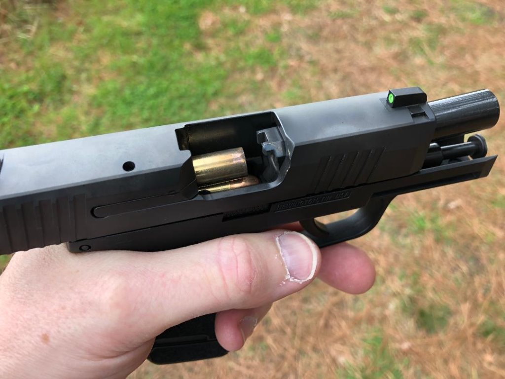

This past Friday I took my Sig Sauer P365 9mm out to the range to practice. It's a tiny pistol and rather difficult to shoot well (at least it is for me). I fired 100 rounds of the Monarch and had one failure. I am certain this was not limp wristing because I was very focused on using a strong two handed grip and working on my trigger control.
P365 Armscorp malfuction
P365 failure 2a.jpg (144.5 KiB) Viewed 4279 times
P365 different angle
P365 failure 2b.jpg (64.22 KiB) Viewed 4279 times
I remembered having another failure with the P365 several months ago and found in my notes that I was using the same ammo then. I now have 850 rounds through this pistol with only the two malfunctions. Both are with the Monarch ammo. I've had no malfunctions with my carry ammo or other brands of FMJ.

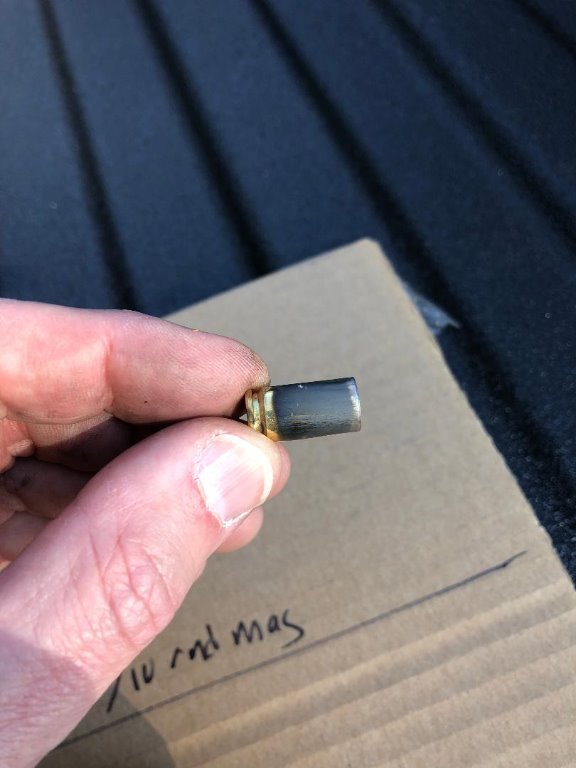

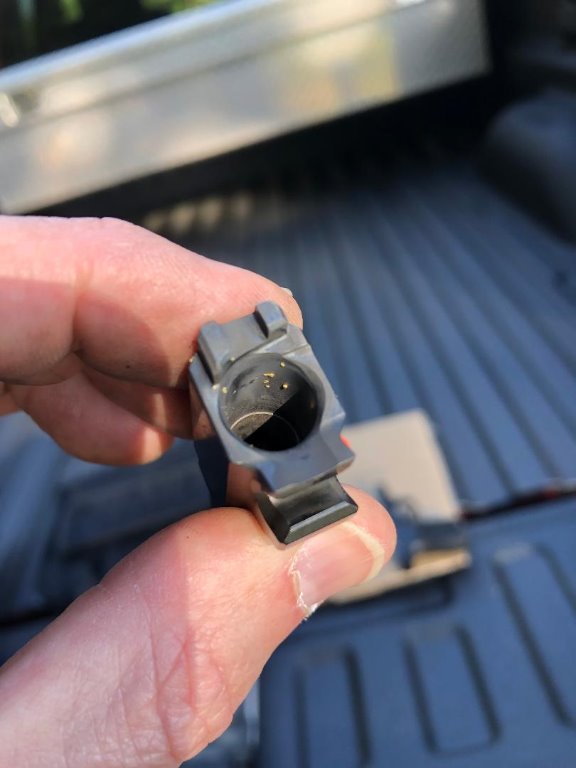

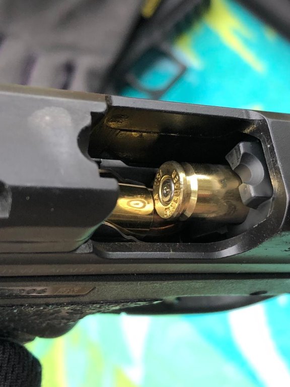

Take a look at pics of the failure from Friday. The case was covered in soot on one side and it appears there is unburned powder left in the chamber.
Soot on case
Soot on case
P365 failure 2c.jpg (51.22 KiB) Viewed 4279 times
Powder in chamber
Powder in chamber
P365 failure 2i.jpg (46.84 KiB) Viewed 4279 times

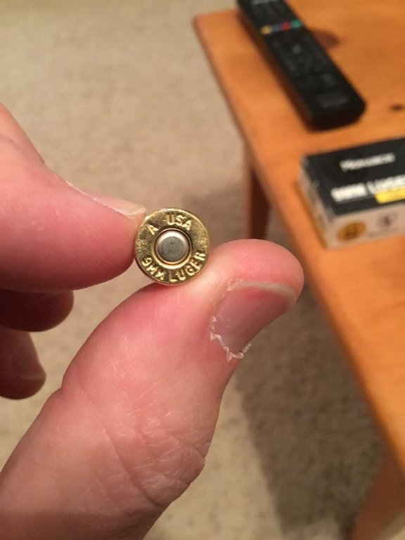

What do you guys think caused the failures? Not enough powder in the cases? I thought the most recent failed round might not have been properly crimped. What would cause the scorching and the leftover power? I bought this ammo because it was on sale at the time for $8/box. I won't buy anymore unless that's all I can find. I am relived to know the malfunctions in my concealed carry pistols are all or mostly related to one brand of ammo.
Head stamp
Head stamp
P365 failure 2j.jpg (44.37 KiB) Viewed 4279 times

I guess one thing to be thankful for is that it is obviously a failure of the ammunition and not a failure of your firearms. I have never seen 'sooting' like that before. How much of the Monarch stuff do you have left?

Could be the powder they are using. Ive experience that with the Priv Partisan ammo. The powder they use is dirty. Some of the powders we get here will do that also. XMP5744 tends to leave particles in the chamber when I have shot it. There is some others also. I cant think of another one right now.

Just an observation: In the third pic, that sideways stovepipe case looks awfully clean inside. Odd. When ammo is mass produced at the factory, guessing a couple will "slip thru the cracks", as in a light powder charge. That light/no crimp is concerning also. As you mentioned, shoot the rest in another gun and be done with that ammo. Best thing is, you have ammo that you know works. Good luck.
I thought that empty case looked too clean, also. At any rate, I’m going to take your advice, Rifle Tom. I have plenty of 9mm ammo by other manufacturers that I can use. I’ll use up that Armscor in my Glock 19 and not buy anymore. Thanks.

As a rule, most case sooting is created by under-powered rounds.
The case is not obturating (swelling to seal case to chamber) which allows burnt powders to escape the action.
When this happens with handloads, it generally means you need to up the powder charge slightly to create a good seal.
Under-powered rounds could also be the culprit in the failure to fully eject the empty cases, which, in turn, causes the stovepipes, or failure to feed.
Can't talk to the unburned powder issue, but the rest of your problems seem to stem from under-powered rounds.
Not really that uncommon with mass produced ammunition.

That’s what I suspected, Mgderf. Thanks for the input,
