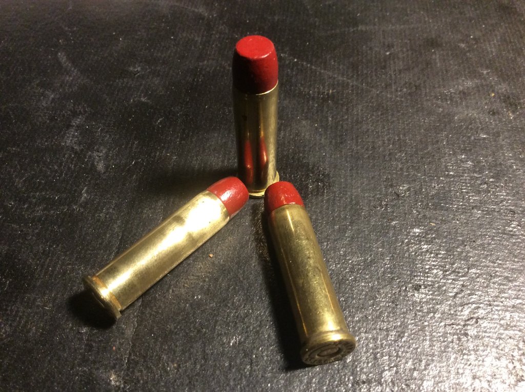

beaverislander wrote:
Mon Dec 14, 2020 8:52 am
Mon Dec 14, 2020 8:38 am
If they feed and bullet is of a hard cast type they should shoot well. All I shoot in now in 38/357 is cast lead bullets.
I'm glad to hear that, these are 1.57". What OAL do you use?
My 180 gr. cast Magnum load measures 1.585 and feed fine with the flat nose. Those little cherry bombs pack a punch!
357 180 gr. target destroyers.jpg (190.85 KiB) Viewed 2508 times
