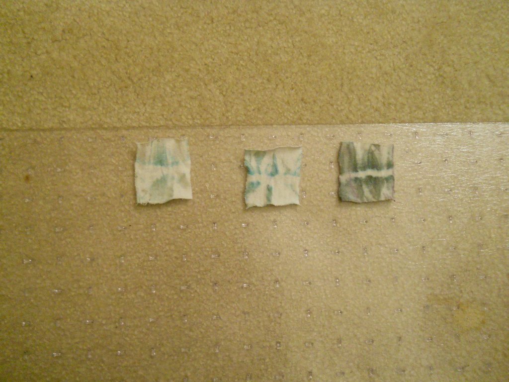

Yes, I just happened on seeing the present of copper doing a cleaning with Hoppe's as well. I was getting a bluish green tint also. I used Tetra because that what the LGS had and recommended. From what I understand, Sweet's 7.62 Solvent does a great job (link below). I plan to try it next. It is my understanding also that there should be less copper residue after the barrel has been shot for awhile. I have only shot about 100 rounds through it so far. So, time will tell.

Before and after pictures using Tertra:
P.S. x 2
Note: Patches are after cleaning with Hoppe's No. 9 (i.e. before and after using Tetra).

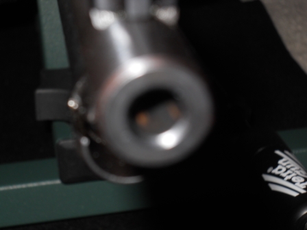

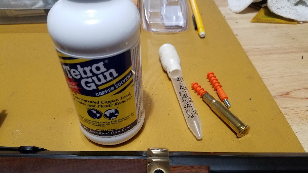

Found it! Was at the LGS yesterday and buried among all the other products was a couple bottles of TetraGun Copper Solvent.
I read, once upon a time here in a older post I can't remember who shared, about plugging both ends of the bore and leaving it to soak for several minutes with solvent inside. I've ordered a couple of .30 caliber bore squeeg-es to use as plugs. But now thinking I should have ordered a larger caliber one for use as a chamber plug. Or maybe not with my receiver being brass. I foresee being very careful not to expose brass to Tetra.

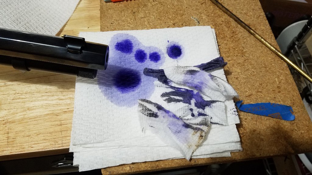

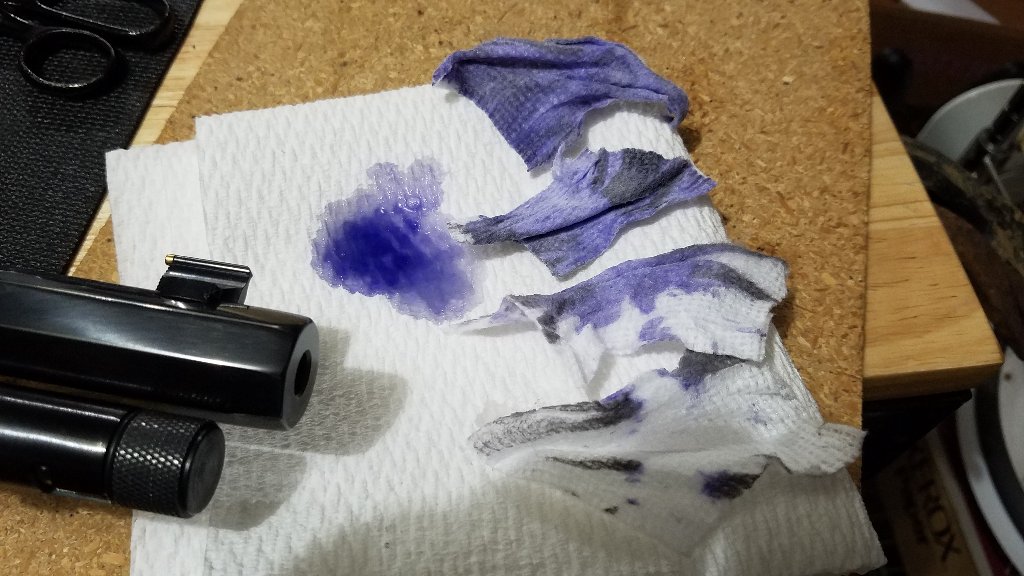

The bore squeeg-e's came today. I put one in a brass casing and fed this one into the breech to plug the barrel at the receiver end. Using the medicine dropper squirted 1/2 tsp of Tetra Gun into the muzzle followed by the other squeeg-e to plug the muzzle. I then rotated the Henry in various orientations to distribute the Tetra Gun throughout the bore. Let it soak for 20 minutes. Then with dry swabs cleaned it all out and repeated the process a 2nd time.GFK wrote:Glad you found it. I have not tried the plug method.
I got a lot of purple. I was not expecting purple. I don't know what to make of the purple. What is purple, I was expecting bluish green.

Re: Dirty Firing Ammo?
what color is the solvent
if not purple, could it be a chemical reaction with the last cleaner/lubricant you used
The squeegee is very interesting. I may have to try one. I typically get a purplish tint as well. I just keep cleaning until it is pretty much gone. I also used a brass brush and tornado brush as well. As I recall, I spent a couple of days initially on the process. I worked on it a few hours each day. Now, I may spend a couple of hours one day (soak time mostly), and an hour or do the next day. I seem to get a purple color patch (like yours) on the next day as well. But, the next few patches are clean. Then, I check the barrel with a bore light. Once I see no more copper, I am a happy camper. I would just keep cleaning and use a bore light to check my progress. It seem like you are making progress. Just may have been a lot of copper fouling in the barrel.
