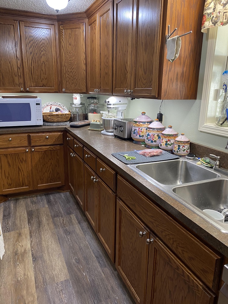

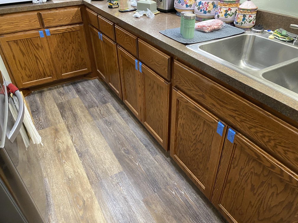

This morning, I set about the task of mounting them. My first though was to make a template... but then I realized it would be easier to use Blue Tape when she explained where she wanted them mounted. Let's take a tour. First, Here is a long view of the kitchen... As you can see, LOTS of cabinets and drawers, and not a knob or pull in sight.

The lower cabinets and drawers
02 lower cabinets and drawers.jpg (372.85 KiB) Viewed 13539 times

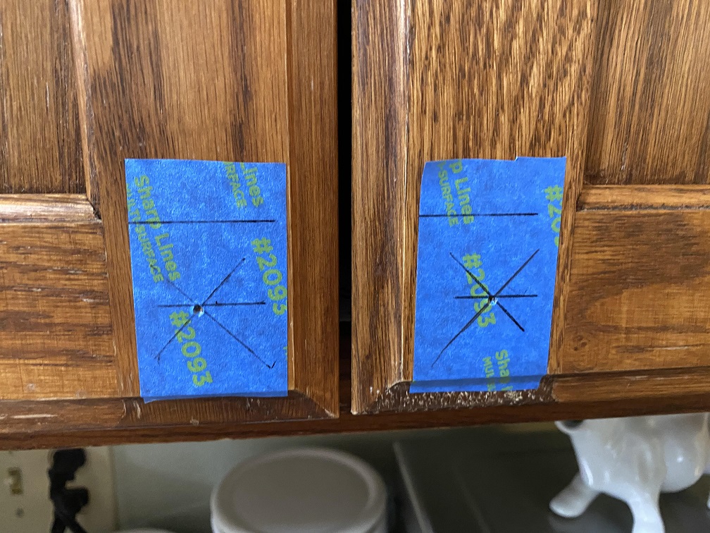

Getting started, we marked the first few and installed a few knobs. It was a little more complicated that expected for just one reason. In installing the first few knobs, I discovered I had to countersink the back of the cabinet doors, as the screws were too short. Eh, no matter, just an extra step. The marking with the blue tape and then center punching with a spring loaded punch worked well.
04 mark and center punch.jpg (319.05 KiB) Viewed 13538 times

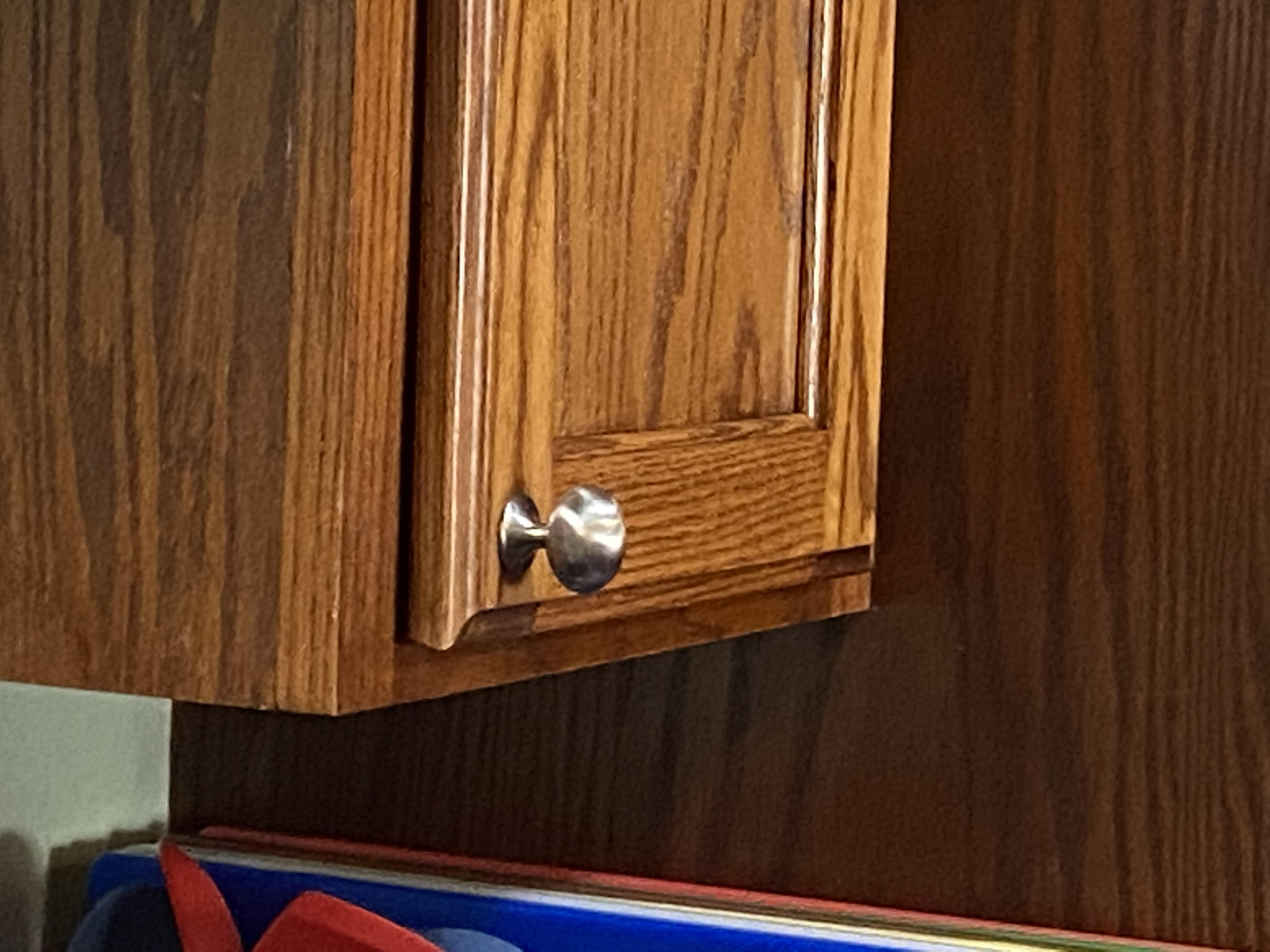

I installed the first knob on a single door.
05 one installed.jpg (628.93 KiB) Viewed 13538 times

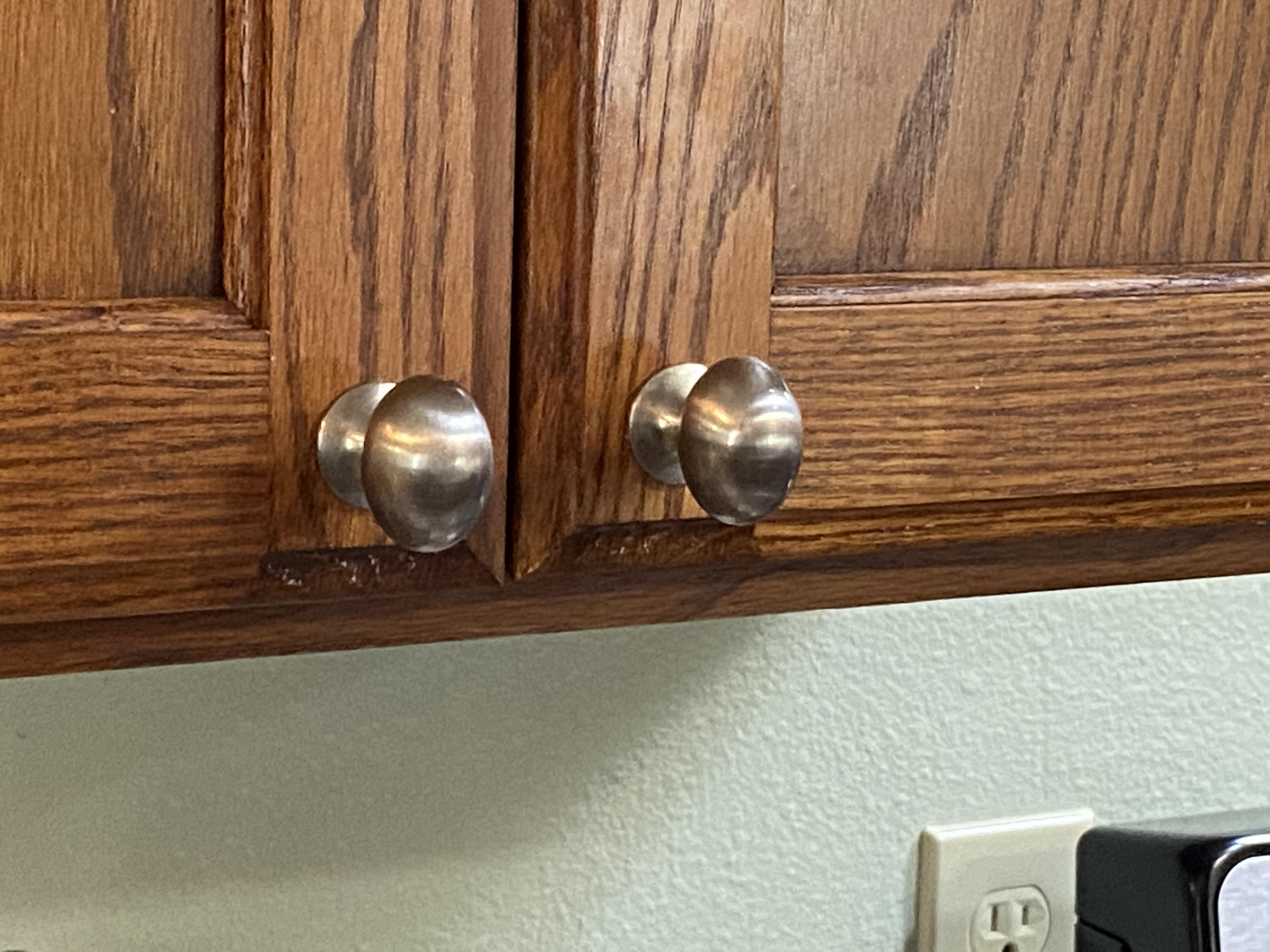

Marking a pair of doors, we noted that the doors didn't line up exactly, and decided to line up the pairs of knobs. I was NOT going to move the doors on every cabinet to try and align them. My back and knees wouldn't take the strain. We marked the centers and adjusted one, none were that far off.
06 pair installed.jpg (808.13 KiB) Viewed 13538 times

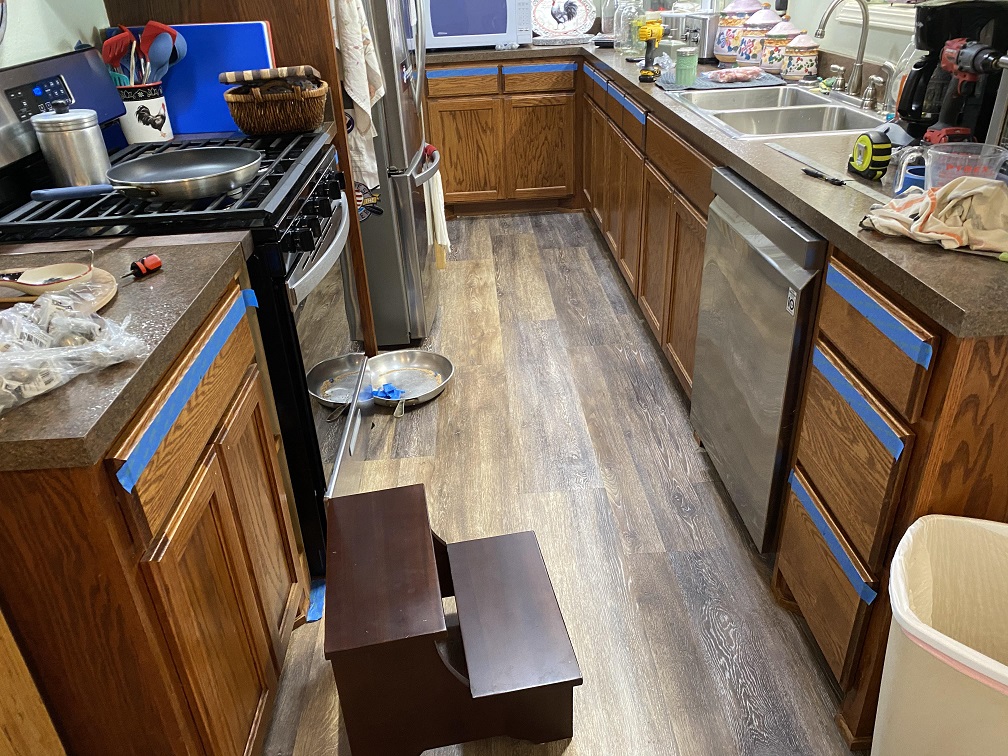

Next I put a piece of tape across the top edge of each drawer, then Miss T measured to the center of each and marked that on the bottom edge of the tape. That was the location for the knob.
08 drawrers marked.jpg (364.96 KiB) Viewed 13538 times
