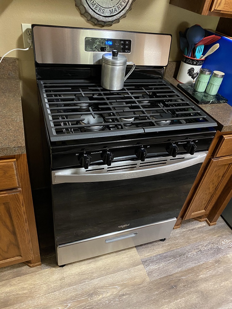

With the Biden Admin thinking about banning Gas Stoves, we decided to replace the aging 36" gas stove in our kitchen while we still could. Miss T started to do her research and decided to replace it with a 30" wide model instead of splurging with the 36" for simple financial reasons. We didn't need the gas stove in the kitchen to do miracles, just cook, bake, broil. She didn't want Air Fry, Convection this and built in that. Didn't even have to be self cleaning. We are pretty neat in our kitchen habits anyway. The problem with the 36" models is that pretty much start with a bunch of extras and go UP from there. :evil:
After a week or so of research, she found a name brand she liked and it was in stock at Home Depot. Price point? $700. Now I had a new kitchen project, design filler to take up the 3+ inches on either side of the new stove. Rather than dead space, I came up with a pull out slider on one side to hold spices; and a fixed thin cabinet on the other to hold the huge cookie sheets and muffin tin. SHE approved the idea, now up to me to make it happen. Here is the new range, it's NOT centered in this pic. :roll: We were in the middle of leveling the legs.

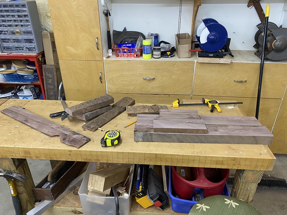

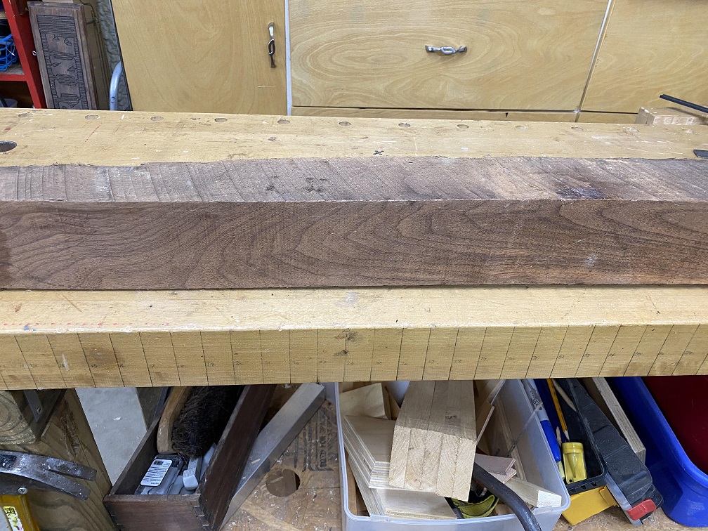

She looked online, and tried to find matching countertop material. No joy, the counters are a couple decades old. If we did find the same material it probably wouldn't match anyway, ours have probably faded significantly over the last twenty years. Looking into replacing all the counters? Nope, rather expensive. I suggested cutting board design shoulders on the edges to butt up to the stove to fill the space. A thumbs up from the boss.
The thin filler cabinets will be made from poplar with oak faces, and I found a slab of black walnut large enough to make the two cutting board countertops and back splashes. I started on the rough sketches to work out the two cabinet layouts and measurements and their bases. The storage cabinet will be fairly simple, but the pull out spice rack will be a tad more complicated, requiring drawer pulls and accommodating the gas line at the rear.
The walnut slab:
walnut slab.jpg (355.55 KiB) Viewed 12666 times
I set up the table saw and dust collection for turning the rough slab into the pieces I needed. Before beginning on the table saw, I cut the slab into two 26" long pieces.
saw setup.jpg (266.35 KiB) Viewed 12666 times
I didn't try and cut it in large passes. I made cuts no more than 1" per pass, and flipped the slab on each pass, then raised the blade another 1" after two passes. The first piece I only had to cut once as it had one flat edge. The second piece had to have two sides squared up and was more complicated. But both were eventually done. From the leftovers, I chopped two 6" to 7" pieces and set the saw up for 1" thick pieces for backsplash and repeated the process to get those done.
The rough work was done and once we are close on both cabinets I can begin to finish the cutting board counter top inserts.
slab rough cut.jpg (362.55 KiB) Viewed 12666 times

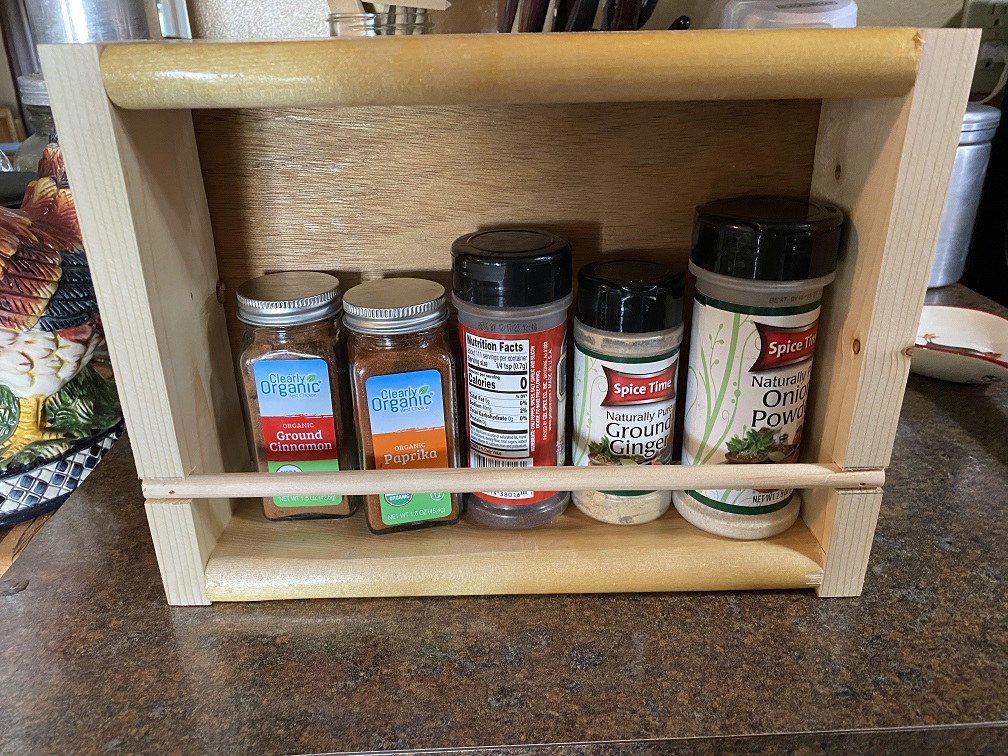

I have worked up the rough drawing and then a mock up from scraps to insure the spices will fit. Miss T said when I build the spice pullout to leave the back off, and use a second dowel, that way she can access the spices from either side of the pullout in case she is working from another counter instead of the stove. Makes sense to me.
working sketch.jpg (176.78 KiB) Viewed 12665 times
test mockup.jpg (366.61 KiB) Viewed 12665 times
Have already made changes to the sketch and adjustments to the design.
Ways to go, but we'll get there. I enjoy the challenge. I bought top of the line drawer pulls, with steel construction and steel bearings. Should outlast us.
Watch this space. 8-)

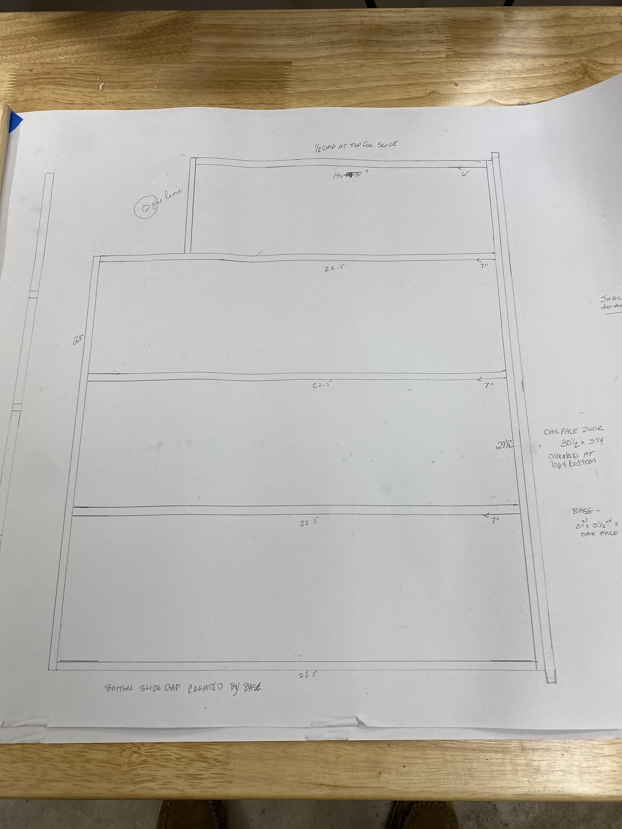

Re: Kitchen Range Project
Posted: Sat Sep 30, 2023 3:57 pm
by BrokenolMarine
A peek at one of the updated sketches for the pullout spice rack.
updated sketch.jpg (453.27 KiB) Viewed 12653 times
There will be a base that is 3 inches wide, 3-1/2" tall, and 23" long, extending back nearly to the wall, behind the rack for stability. It will have an Oak face to match the oak Kick Plate trim of the existing cabinets and the Oak Faux Door on the pull out will meet with it. I continue to review the numbers and design until I start the build, modifying and correcting as needed. The walnut cutting board top will be mounted to the existing counter above the pullout with the drawer slide anchored to the underside, and the other drawer pull mounted on top of the base. Miss T wants the Cutting board counter top on the right side to be 1/4" proud to keep the contents of that side from sliding off of the counter toward the stovetop. (A kosher cutting board set) She asks and she receives. ;)
Posted: Sat Sep 30, 2023 5:52 pm
by Mags
BrokenolMarine wrote:
Sat Sep 30, 2023 8:42 am
I'm guessing from the context and the picture the new stove is propane. Good choice if so.
Posted: Sat Sep 30, 2023 6:53 pm
by BrokenolMarine
It's natural gas, as is the hot water heater and the furnace.
Posted: Sat Sep 30, 2023 8:14 pm
by RetiredSeabee
It appears that you have an electrical outlet to move as well.
Posted: Sat Sep 30, 2023 11:39 pm
by BrokenolMarine
The outlet works okay there, the range has to sit forward enough due to the plumbing for the gas that the electric can opener power cord isn't affected. The plug for the range is down behind the range about two feet off the floor.

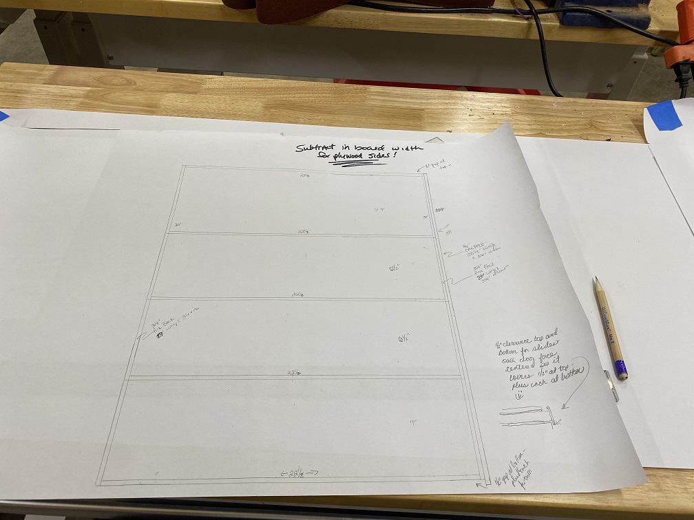

Posted: Tue Oct 03, 2023 4:02 pm
by BrokenolMarine
Working from the sketch, I made each cut, measuring carefully and cutting to, but leaving the fine pencil mark to insure accurate length. Once all the pieces were cut, I began a rough assembly to check the fit and length of the pieces. I didn't worry about spacing of the interior shelves at this point, just that the layout was square to check for the measurements. The drawn concept has become physical reality.
13 concept becoming reality.jpg (351.75 KiB) Viewed 10117 times
Look carefully inside the shelving, what are those silver things? Oh, yeah... the 123 blocks have once again made their appearance. They are heavy, so they stay in place. They are machined to perfect 90 degree corners, so I can use them to assure the layout is square. No going corner to corner with the tri-square and trying to move one corner and pulling another out. This is just a test, no glue, no fasteners in place.
14 123 blocks in use again.jpg (307.23 KiB) Viewed 10117 times
I will come back out and run each component across the table saw to rip them to width. Once done, I'll reassemble them and began spacing the shelves and marking the sides. Once done, the holes for assembly can be drilled, and the notches for the dowels can be cut. We will make progress. The base and the walnut counter top will be next for this side. I'll cut the oak face last.
