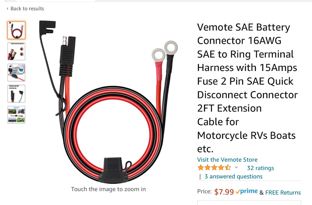

It’s bigger than you need for one tractor battery, but it is a high quality part and will work fine with any small panel. The controller is what is important, any junky Amazon panel will work, or look for a used one locally in Craigslist. They are simple to connect, two wires from the panel go to the controller, two wires from the controller to some alligator clips (with an inline fuse), or better yet, an SAE 2 wire connector or similar.
