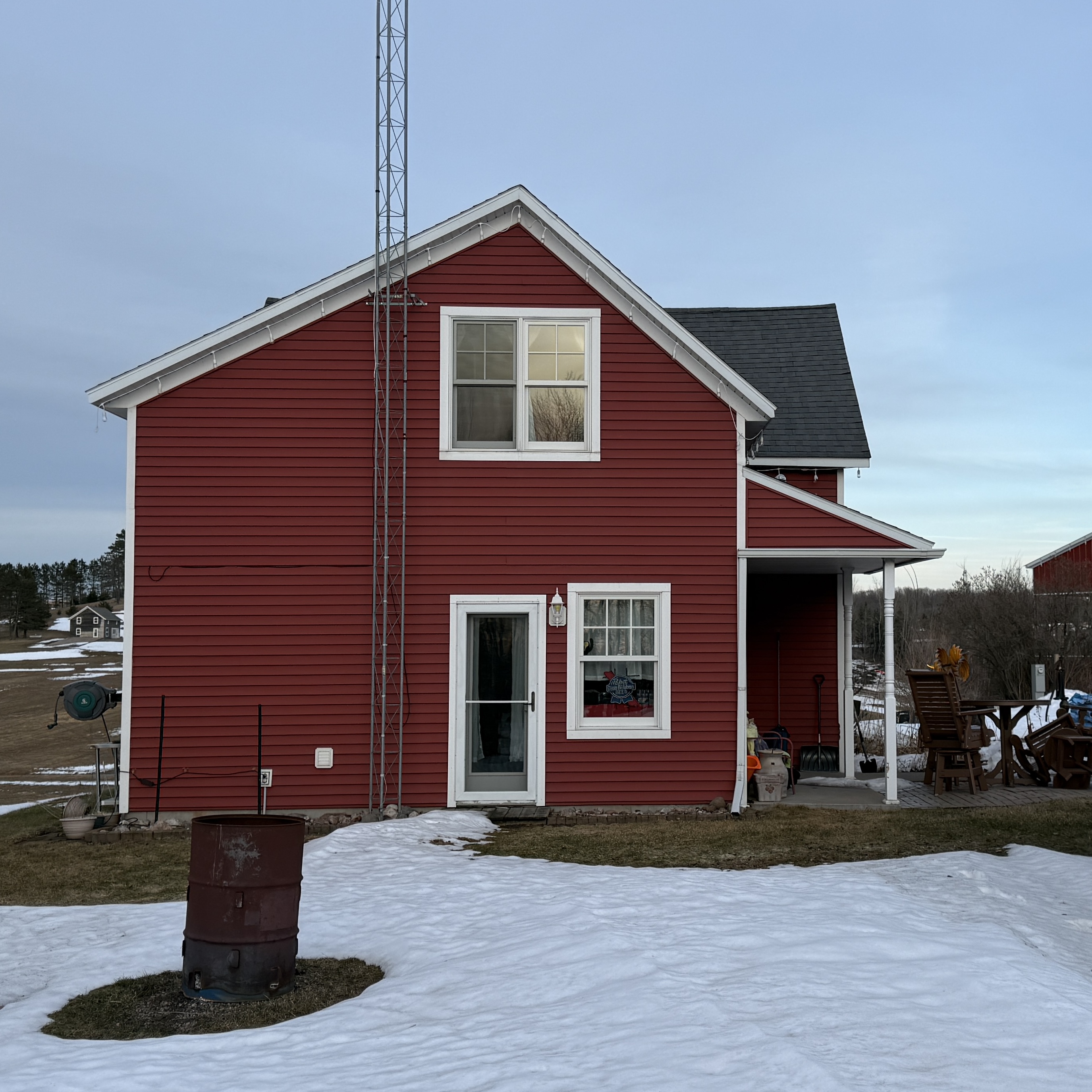

The woman that designed the remodeling really took advantage of the home’s view to the east and west. I’ve posted the east view many times. This was the view to the west.
This is the view now. Someone bought the house before me and put the septic tank and drain field in the way. They owned the house for about two months and sold it to me.
The view of the house from the west.

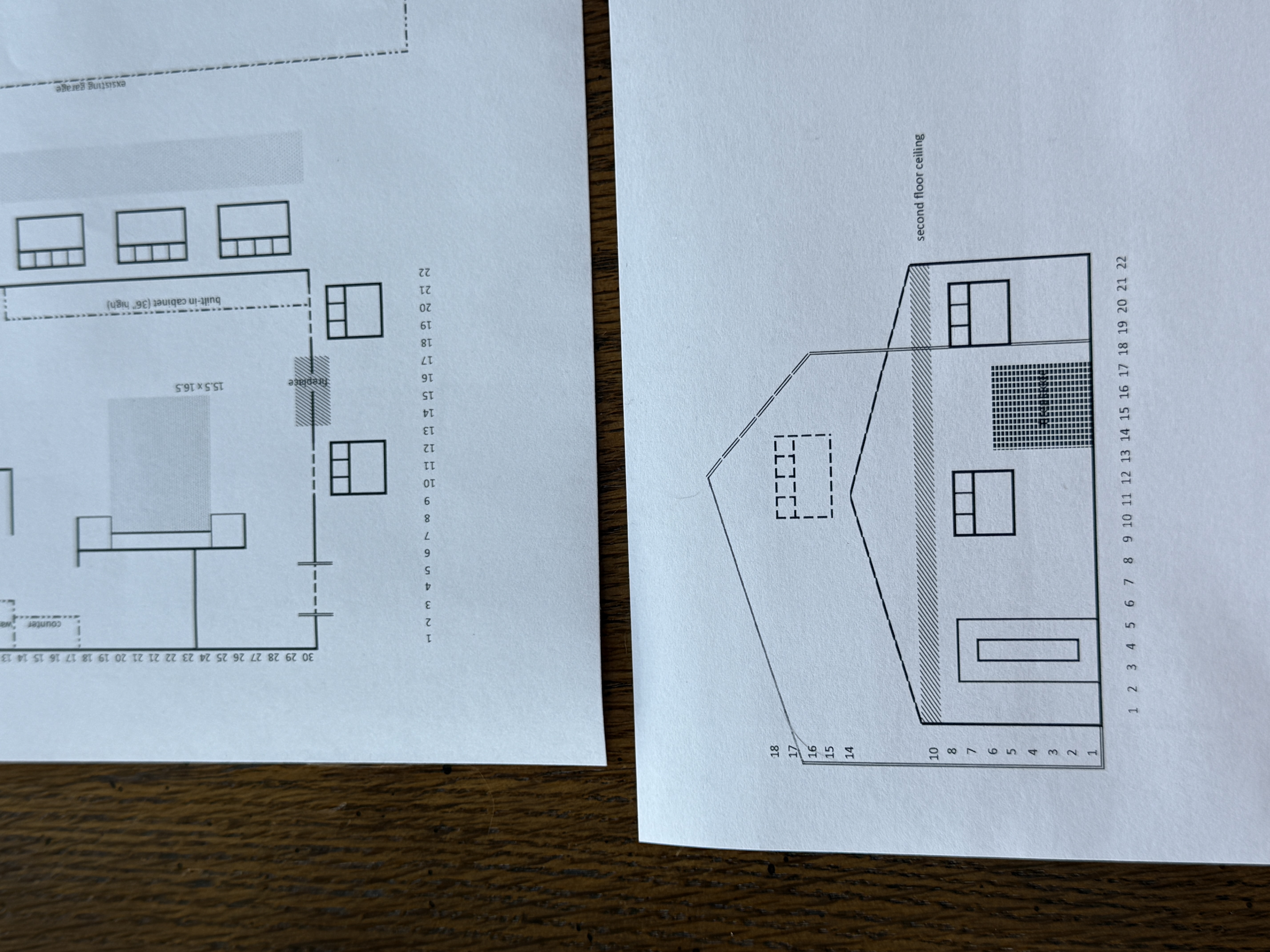

This is the upper bedroom window. I put a headboard in front of the lower window so I don’t have to look at the drain field.
And this is how I’ll cutoff the bottom of the window to make room for the new lower roof. I need at least a 4/12 pitch and I want at least an 8’6” ceiling. To get both I have to eliminate the bottom of the window.
I may put in a scissors truss to get even higher ceilings.

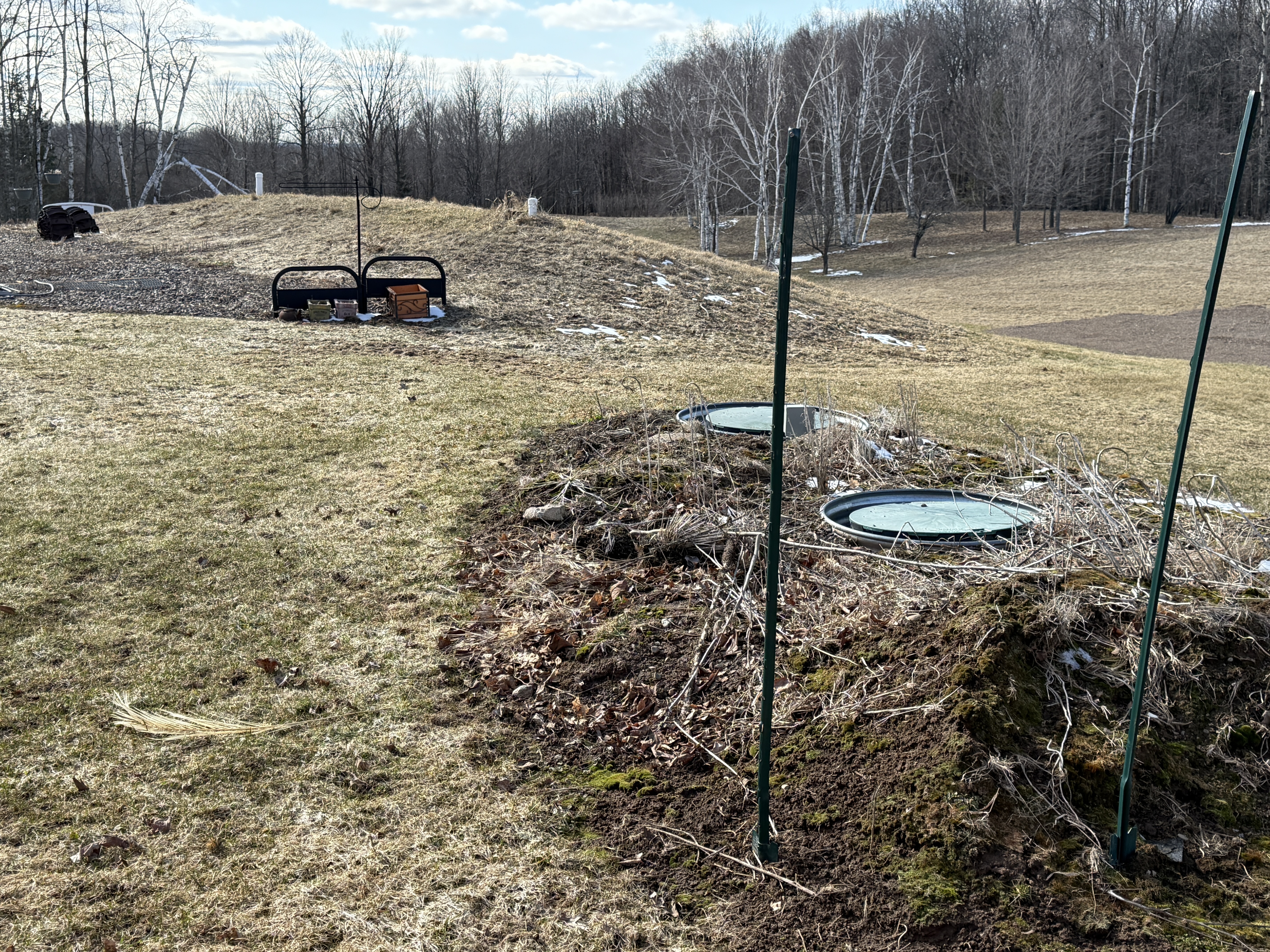

I went to the Land Use Office at the county courthouse and picked up the septic As-Built. It told me vaguely where the tanks and drain fields were. I can clearly see the top caps so I knew where they were. What I didn’t know was what was below the surface. The tank drawings and measurements told me everything I needed to know.
It enabled me to enlarge the plan for the addition by several feet. The outside dims are now 24’x34’. That’s 816 sf for a bedroom, bathroom, laundry room and kitchenette.

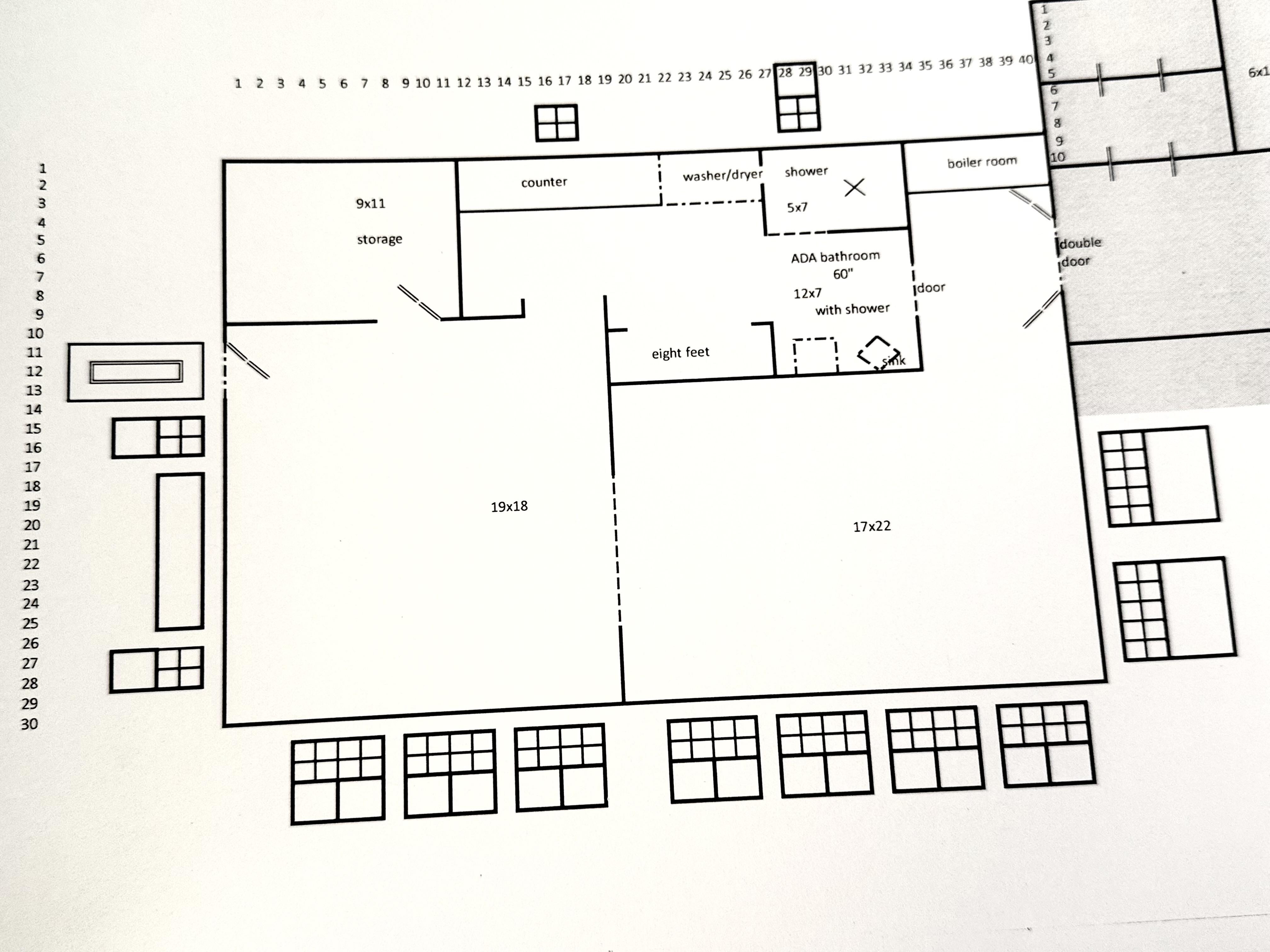

I don’t even need that. Or for plumbing. This is the latest and greatest. It’s now 30x42. That’s 1,260 sf added to 1,750. I’ll be just over 3,000 sf.
The bathroom will be completely ADA. Doors will all be 32” minimum with three double doors much wider. Halls will be five and six feet wide.

I keep going bigger and bigger then going smaller and smaller. My recent trip to Florida was a wake-up call. Yes I love the winters here but only to a certain point. The falls are short and beautiful then comes the annual ice age which can last up to six months. I can handle it up to maybe February but then I start to get tired of it. So my current plan is to scale back my new addition to 25x25 or 625 sf. I can afford that plus being able to escape south for three months in the motor home. All I really need is a bedroom and en suite bathroom with its own laundry room. And of course a walk-in closet. The dark area is the existing house.
Those are windows on the bottom (south) as I fight depression and PTSD with bright rooms.
