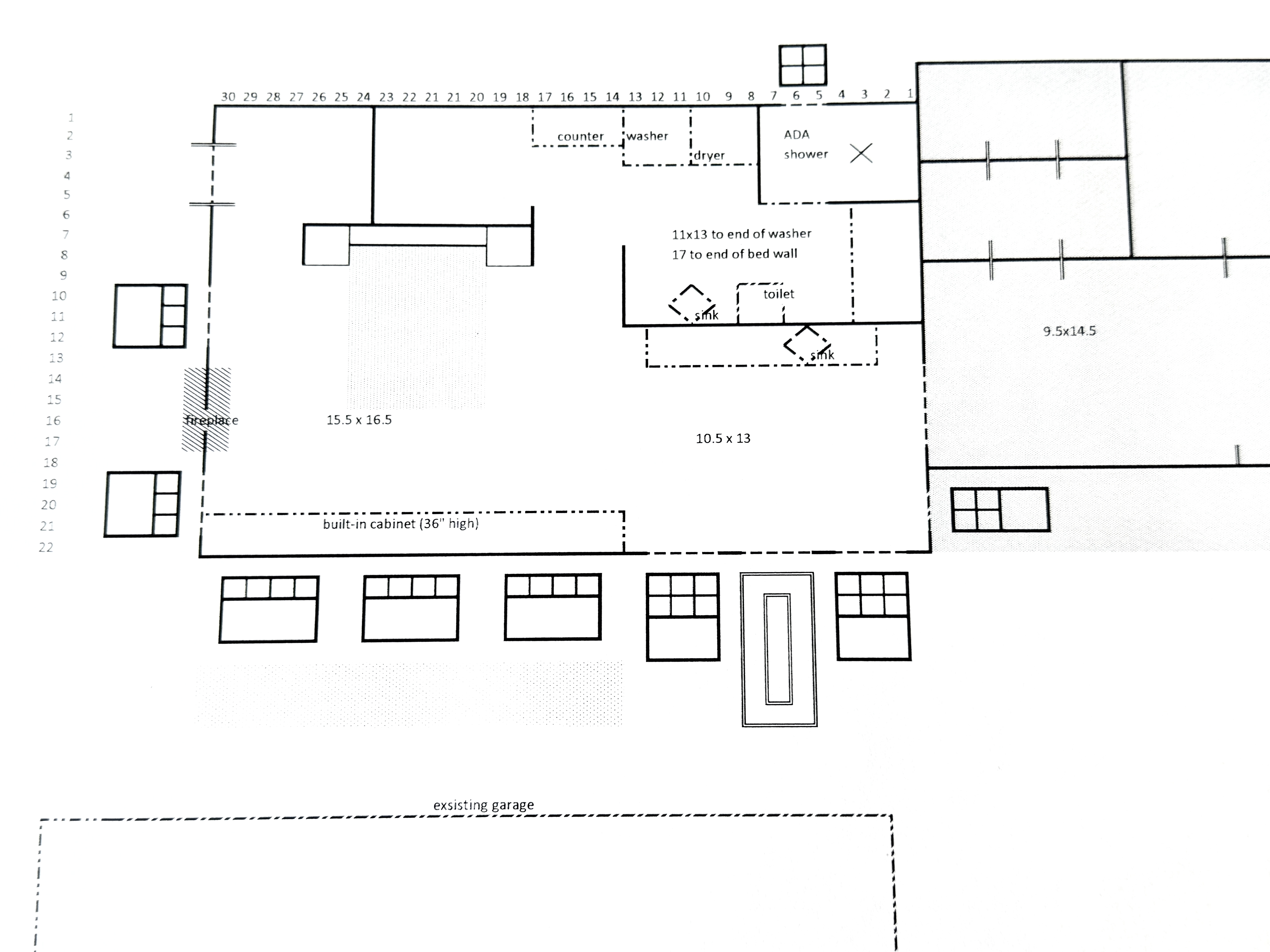

I’ve now downgraded my project to one floor. A grand remodel would be nice but then it would reduce the charm of my home. Instead I’m thinking of this more modest addition of just a master bedroom with en suite bathroom , laundry room and walk-in closet plus a kitchenette. It’s 660 sf of space that gives me everything I need without being too much.
Notice all those windows to the south. Let the sunshine in!

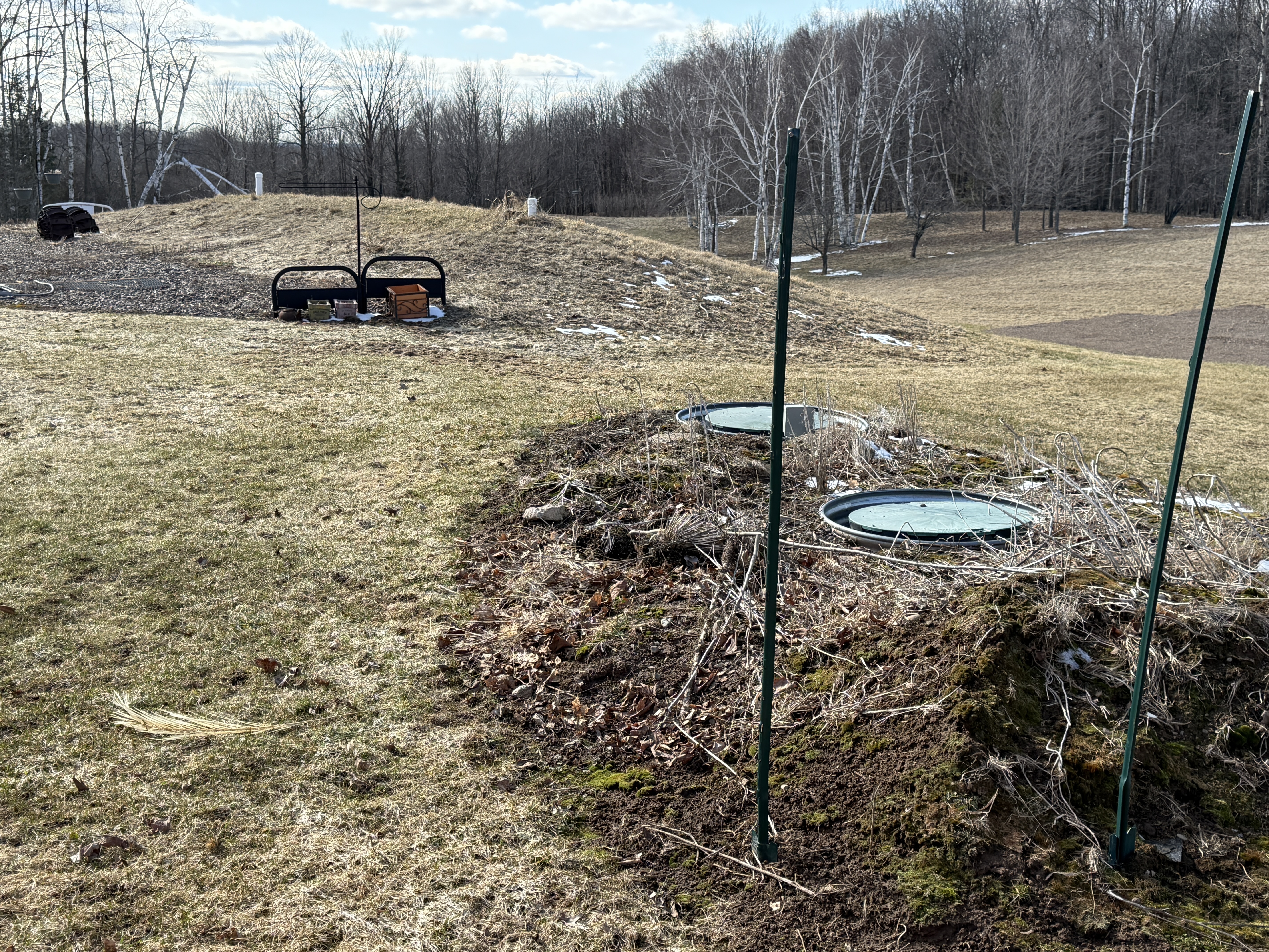

This is the view now. Someone bought the house before me and put the septic tank and drain field in the way. They owned the house for about two months and sold it to me.

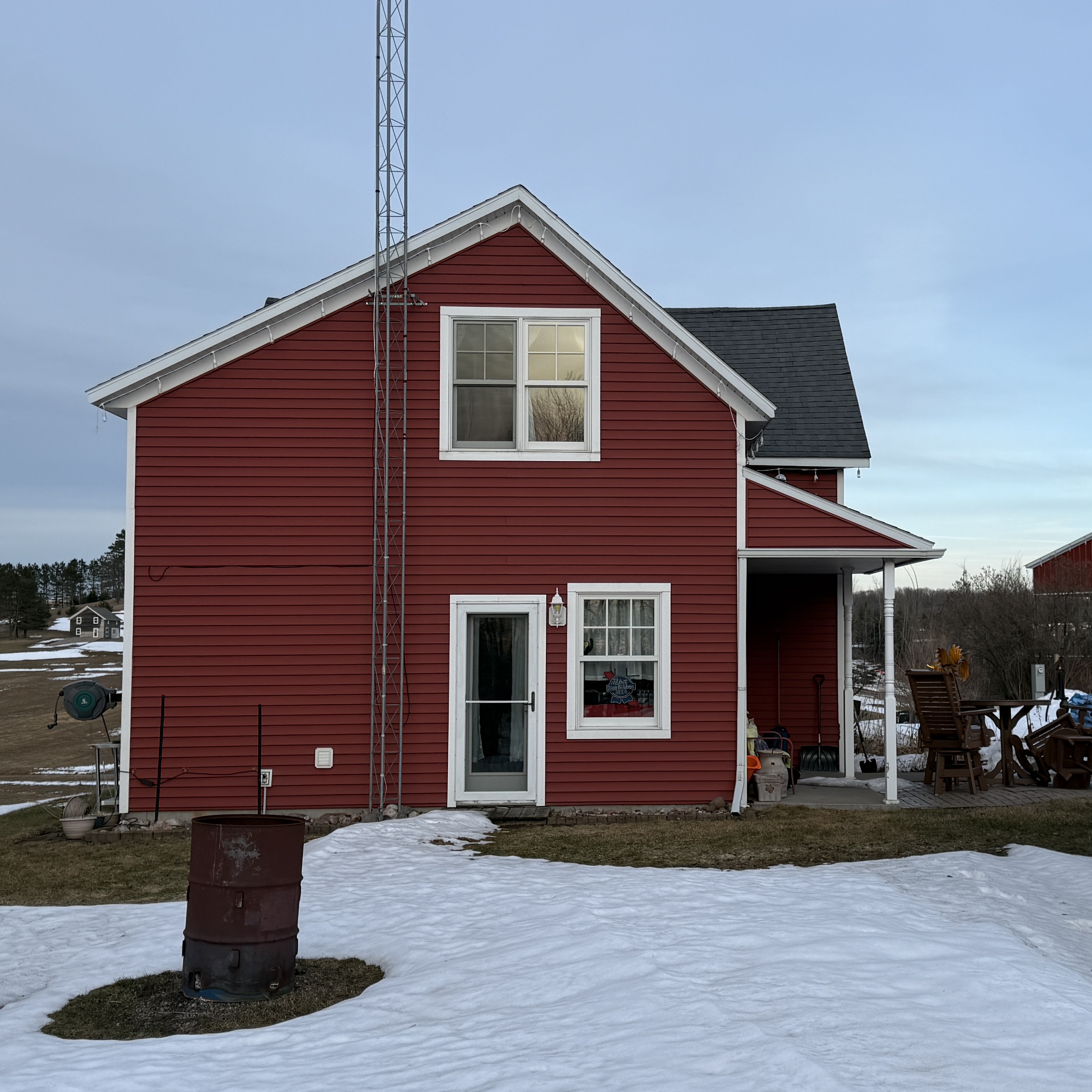

The view of the house from the west.

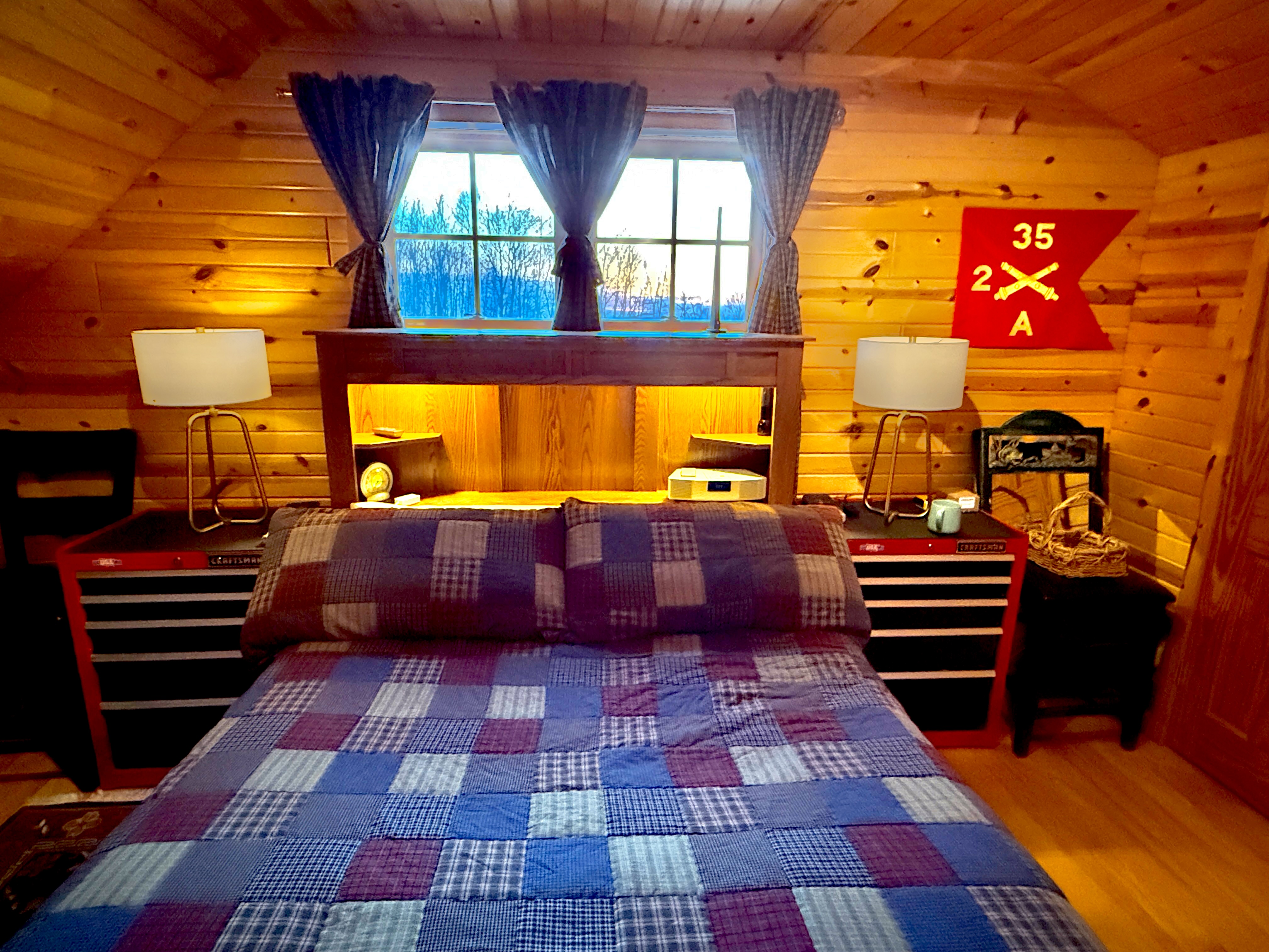

This is the upper bedroom window. I put a headboard in front of the lower window so I don’t have to look at the drain field.

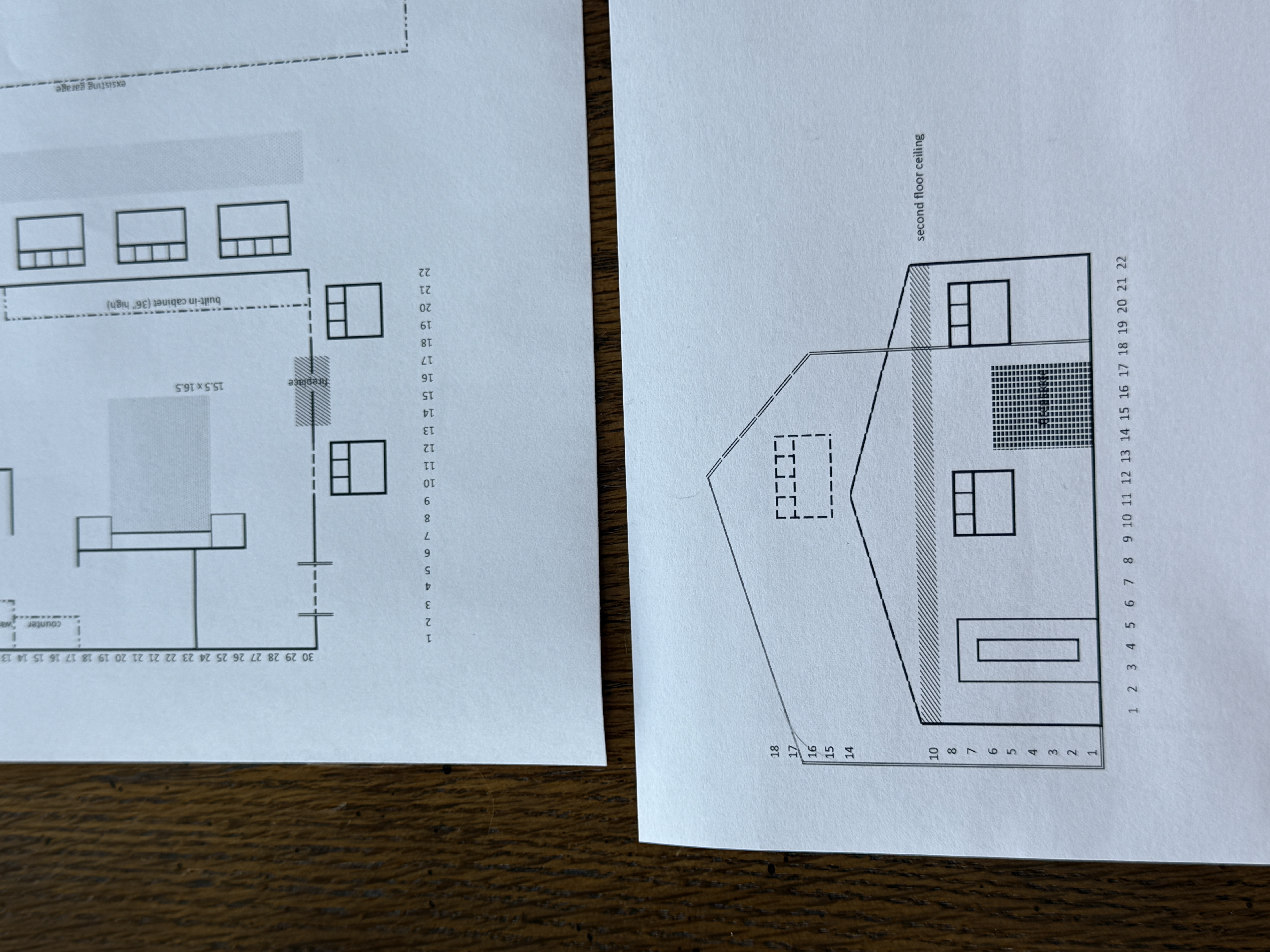

And this is how I’ll cutoff the bottom of the window to make room for the new lower roof. I need at least a 4/12 pitch and I want at least an 8’6” ceiling. To get both I have to eliminate the bottom of the window.
I may put in a scissors truss to get even higher ceilings.
