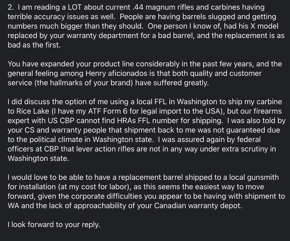

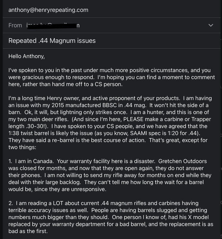

I sent Anthony an email, posted below along with the instant reply I got. Not good…
The reply:
I don’t see this as a good omen…
But at least I can get a free catalog :roll:

Redthies wrote:
Tue Feb 27, 2024 11:04 am
Try messaging via LinkedIn or Gmail.
