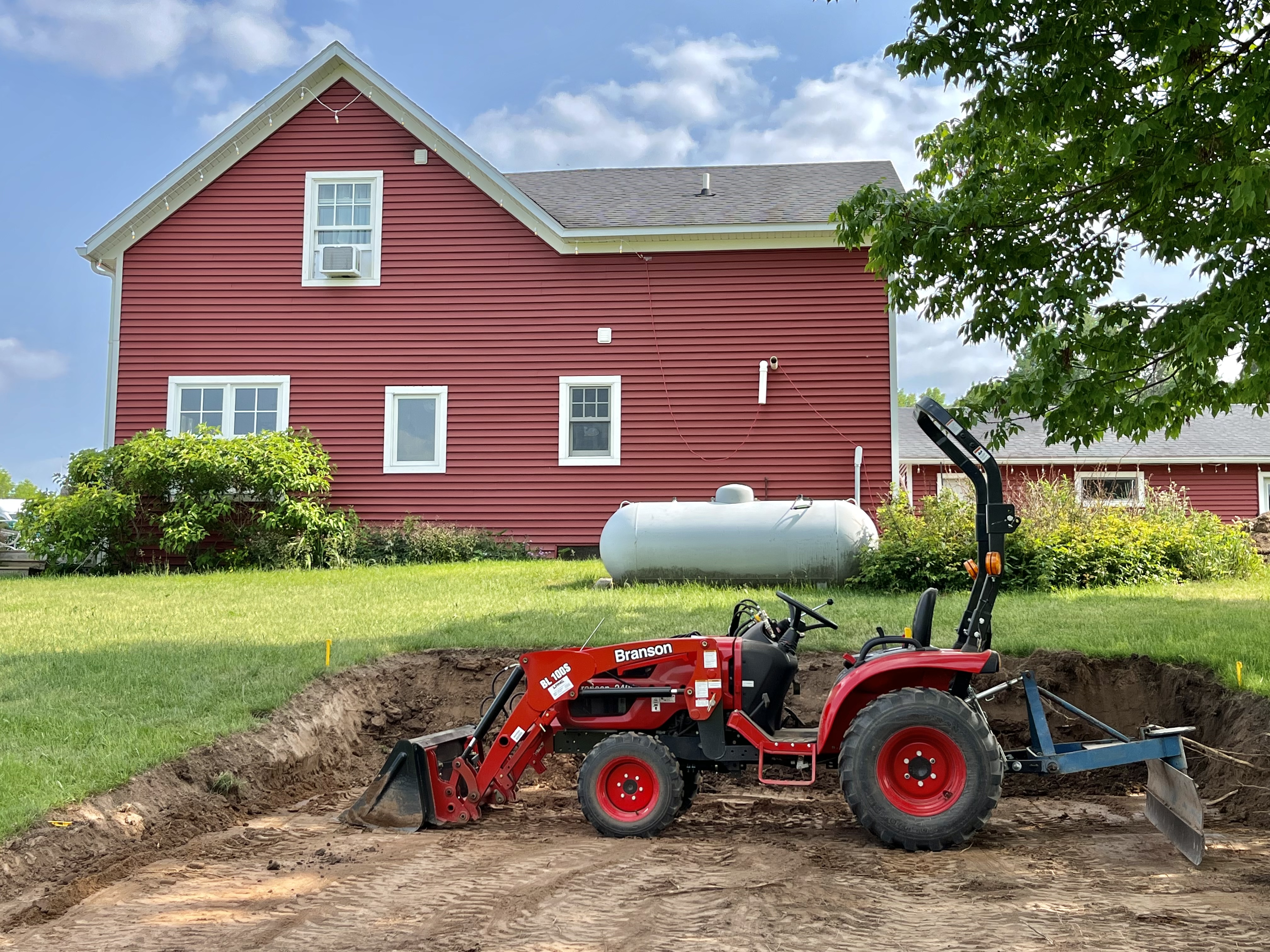

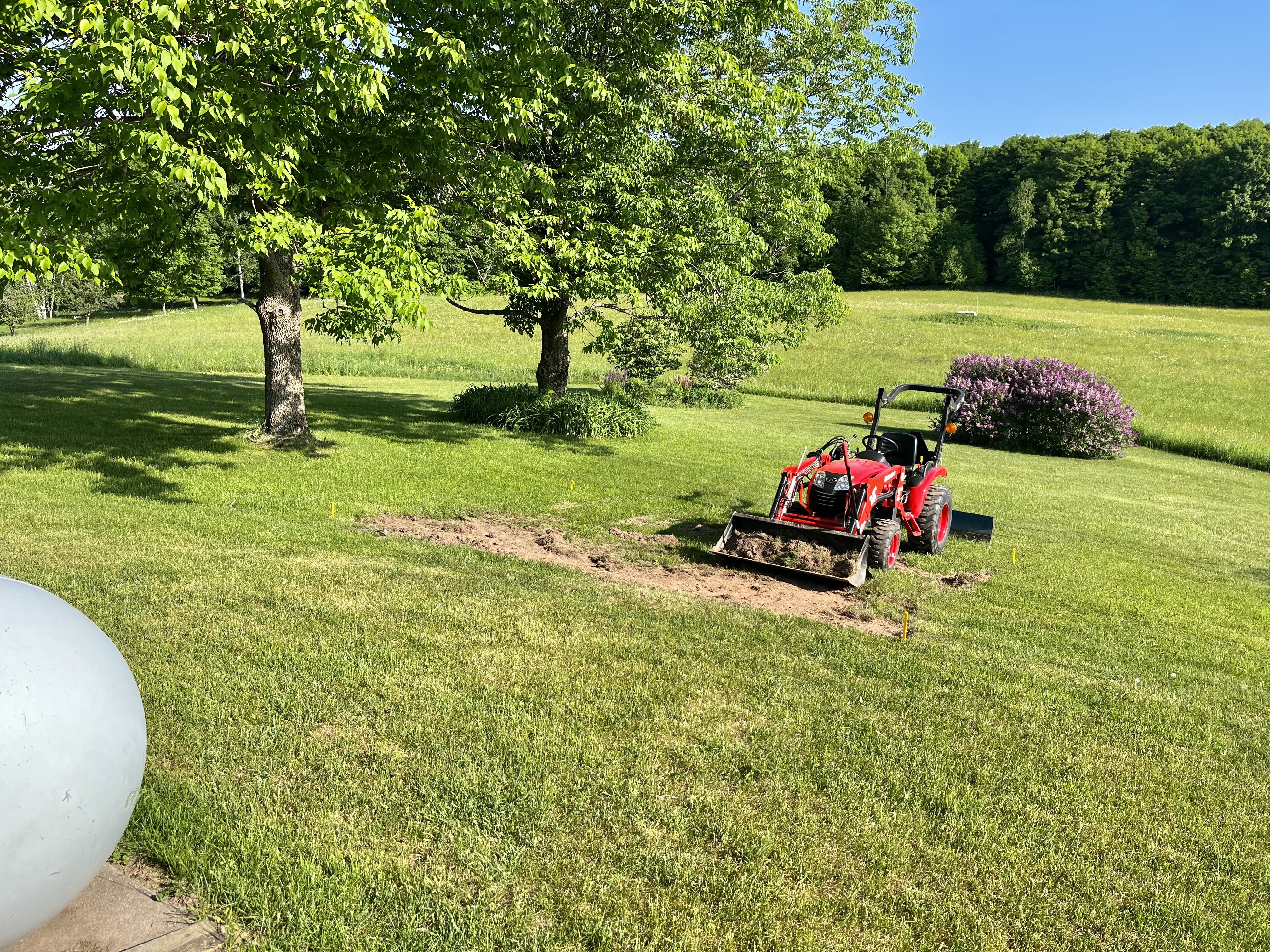

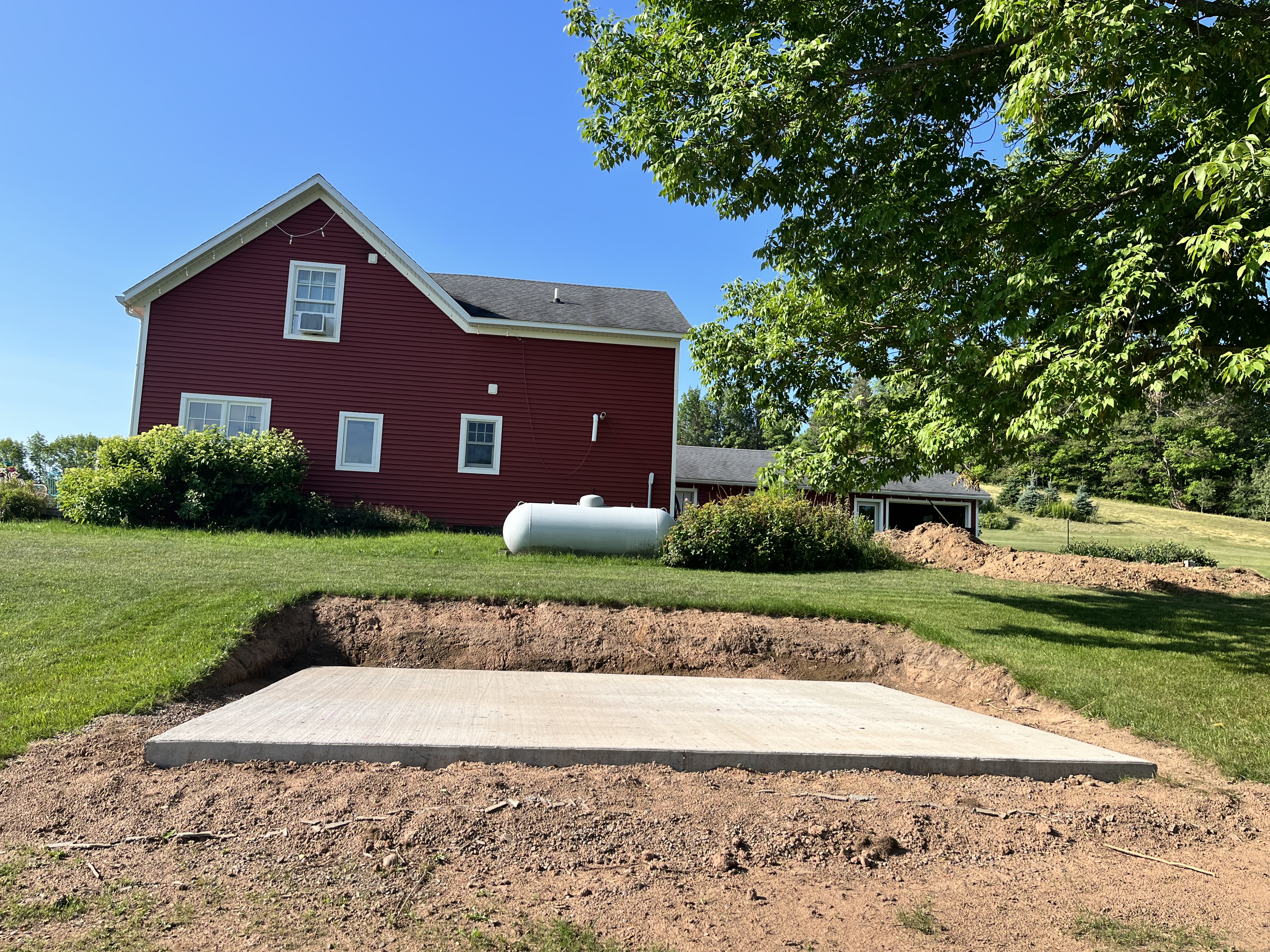

I broke ground on two of the tank platforms yesterday.
The tank on the left is an existing 500 gallon tank that is 10 feet from the house. I have to place the 1,000 gallon tanks 25 feet away.

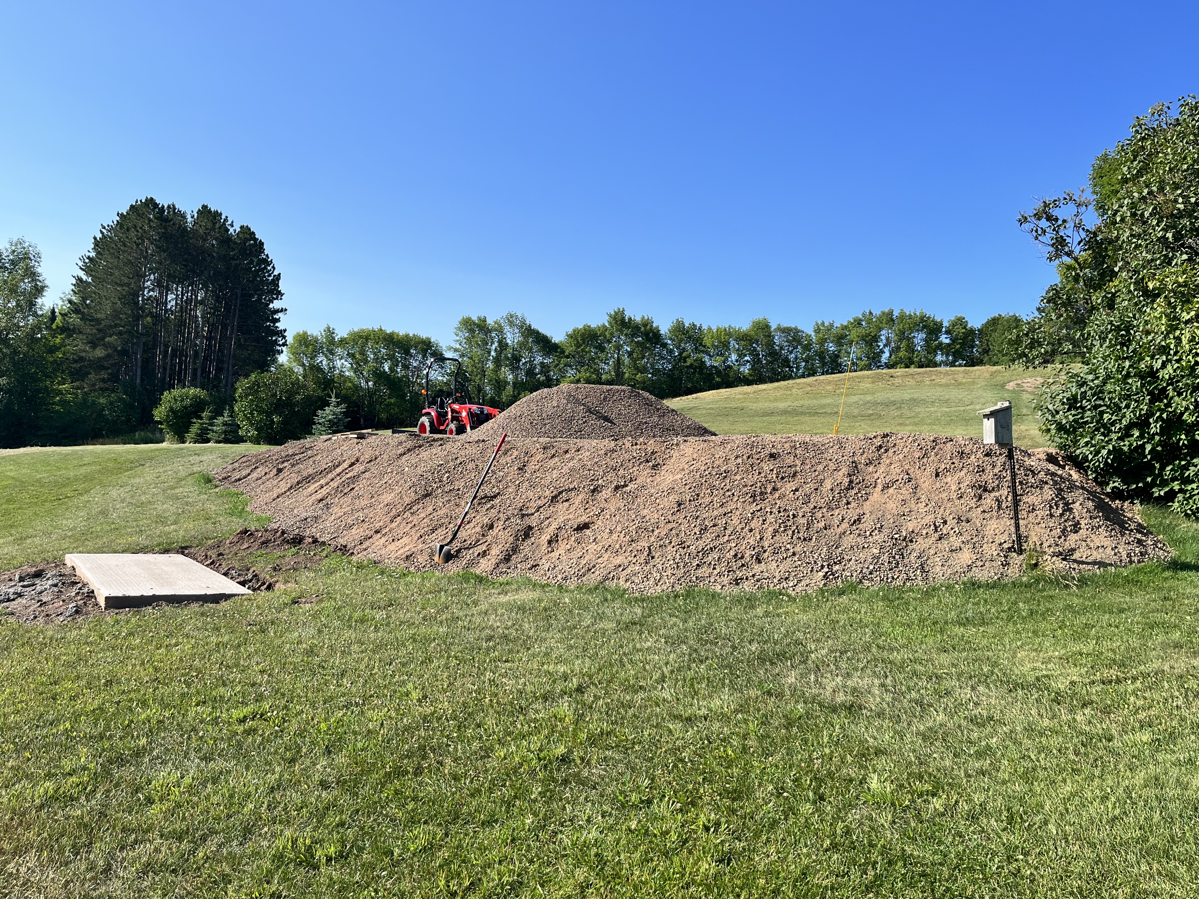

Post by Sir Henry » Thu Jun 15, 2023 1:35 pm
I made a lot of progress today. I need to make it a few feet longer. It will fit in the dugout but I need to allow for erosion.

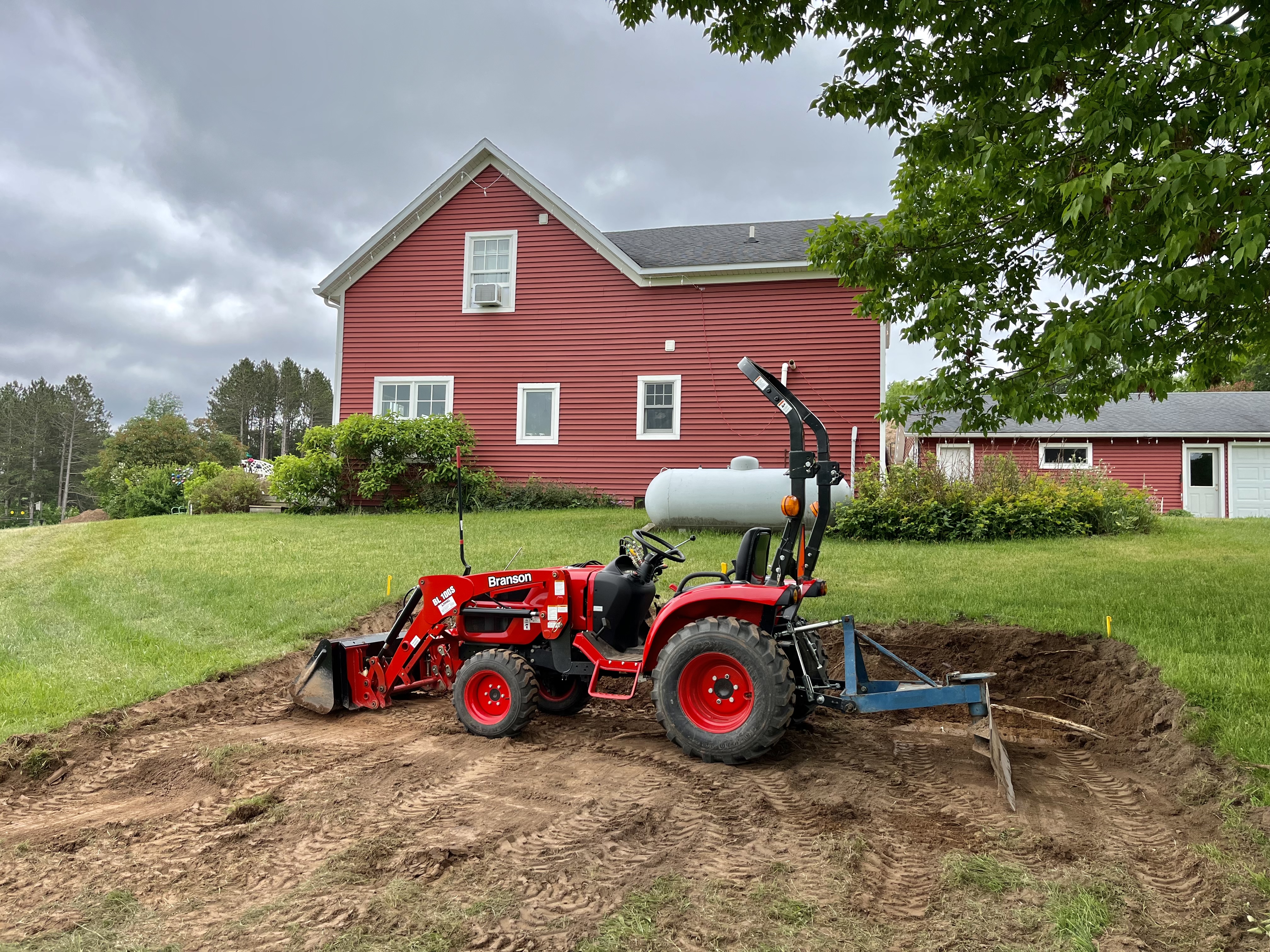

Post by Sir Henry » Sun Jun 18, 2023 10:24 am
I’m about 95% done digging. The level space is 18’ wide and 16’ long and 3’ deep tapering to near level. The walls are about at a 45 degree angle.
Compare this picture to the one above.

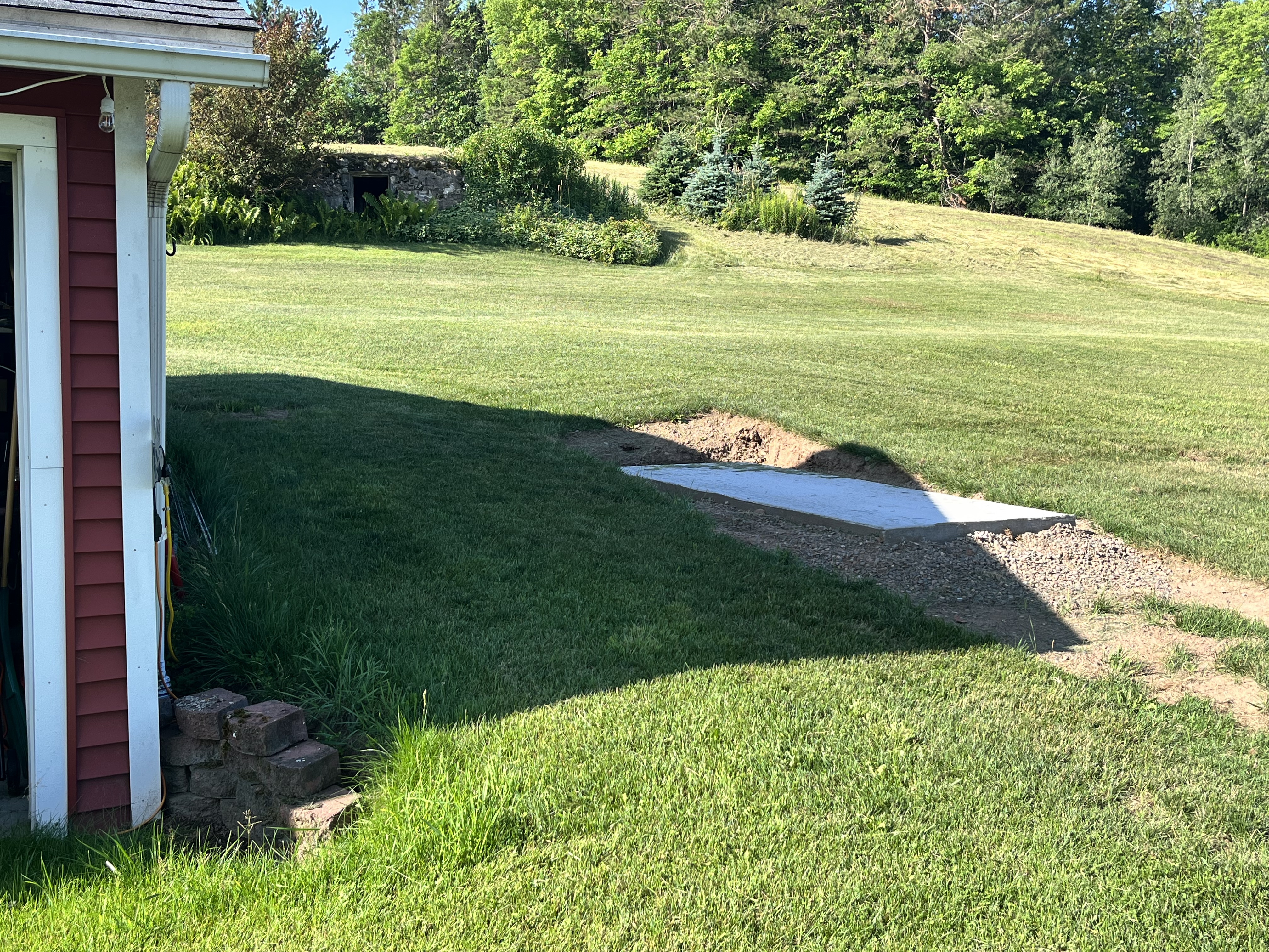

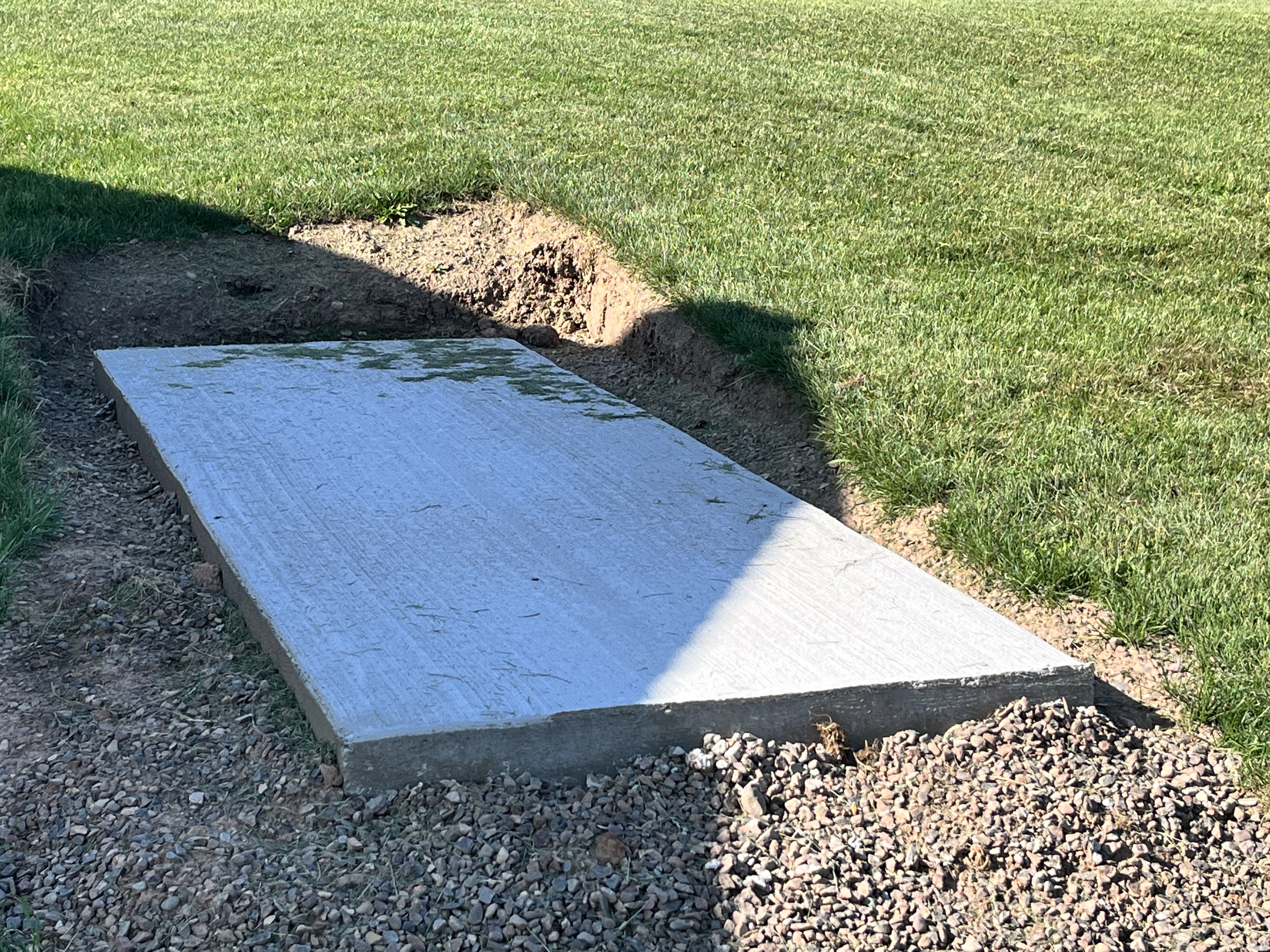

The concrete pads were poured while I was in Alaska. They look great. Three 1,000 gallon tanks will go here for the house.
One 500 gallon tank will go here and will supply my motor home.
Another 500 gallon tank will go here and supply the garage and an outdoor kitchen when I build it.
A closer view of the garage tank.
