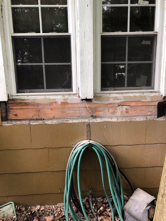

Post by Ernie » Sun Jun 23, 2019 5:54 pm
Put the final skim coat of epoxy putty on and called it a day. Will give it a last sand and cut out the sill replacement to glue and screw into place next time it is not raining. Scrape, sand and prime the remainder of the window before moving on to the next one. Pretty impressed with the epoxy but think I will try another brand to save some cost. The JB wood hardener worked well and I may get the Jamestown epoxy wood conditioner to further seal the rest of the wood before priming. Used Jamestown products on both boats and like their products.

Post by Travlin » Mon Jun 24, 2019 12:36 am
Don't forget to cut a drip groove on the underside of the sill about one inch in from the bottom edge.

Post by Ernie » Sun Aug 25, 2019 5:53 pm
Finished repairing the damaged windows today, ordered fibre cement siding from Home Depot to replace cracked and broken shingles, and have to round up all the stuff for the paint sprayer. Took me 4 days to roll and brush last time so I am hoping to cut that in half with the sprayer this time. Hard to say, it takes me a lot longer to do anything these days.

Post by Ernie » Sun Aug 25, 2019 8:02 pm
I enjoy figuring things out but I have to think it out before I tackle it, read about it and learn as much as I can. It was with some trepidation that I grabbed the recipicating saw and cut out the old sills. But once out it was just a matter of fashioning new ones and glue, screw and foam in place. Of course the first one was wrong but learned from that one and the rest when pretty well. I get satisfaction from accomplishing these projects. Patience I have, it is time that is hard to come by. If I was retired I could get my chores caught up but if I was retired I could not afford to do my projects so more patience.
