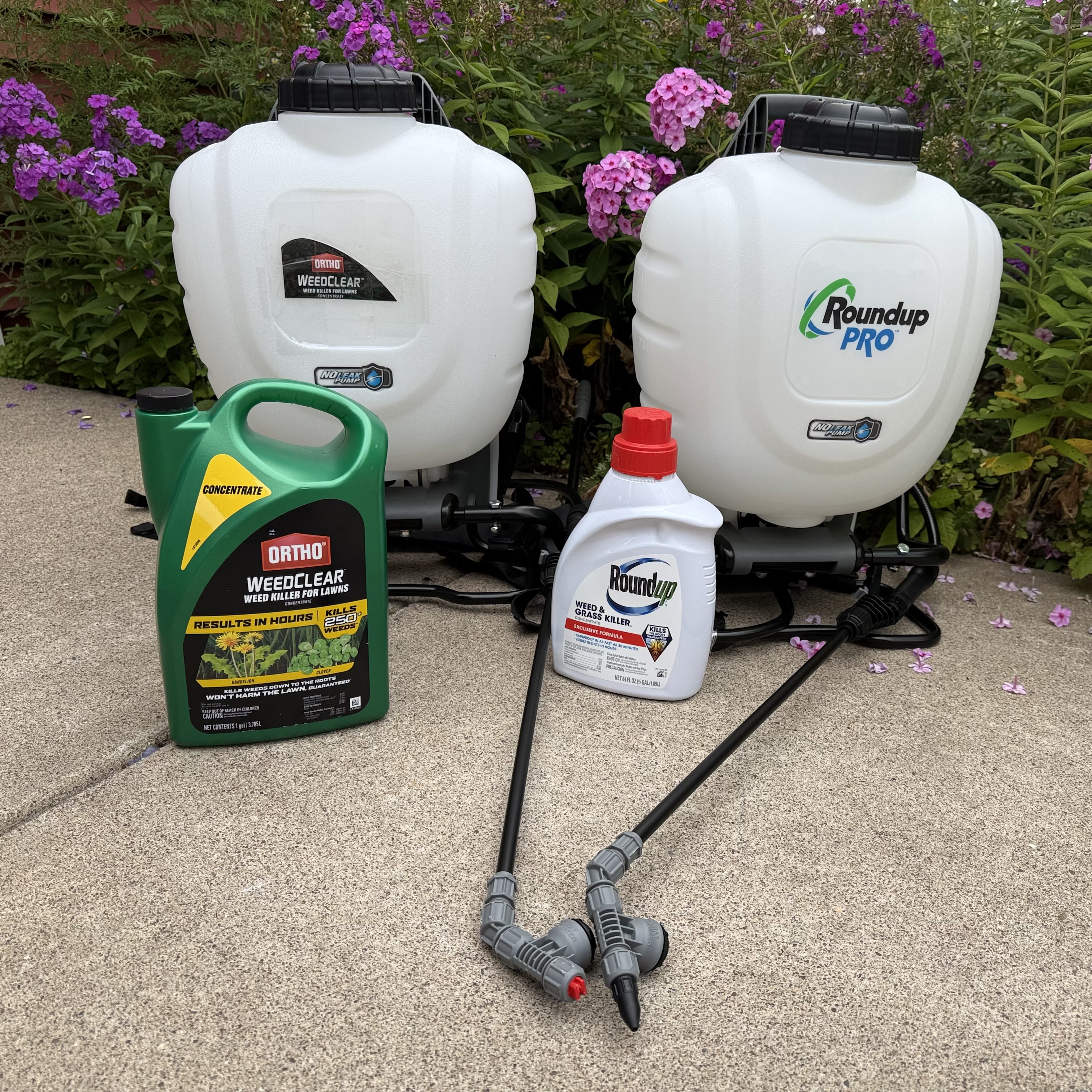

Posts: 14663
Re: 2-4-D Question
Post by Sir Henry » Thu Aug 13, 2026 12:40 pm
I bought two new 4-gallon sprayers. I had one older one with a broken strap and I had to remember what I sprayed last. Now I have a dedicated one for the two products I use.
Posts: 14663
Re: 2-4-D Question
Post by Sir Henry » Fri Aug 14, 2026 9:10 am
It was a very calm day yesterday and glad I sprayed because its back to being windy. Hopefully in a week it will be calm again so I can spray again and get the places I missed. I have between 5-8 acres of grass I mow and need to keep the weeds down. Some of the grass was mostly weeds and now the weeds aren’t looking too good. I use mainly Weedclear even on areas without grass. The Roundup is used sparingly.
