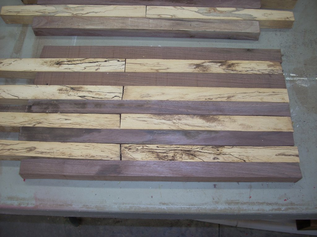

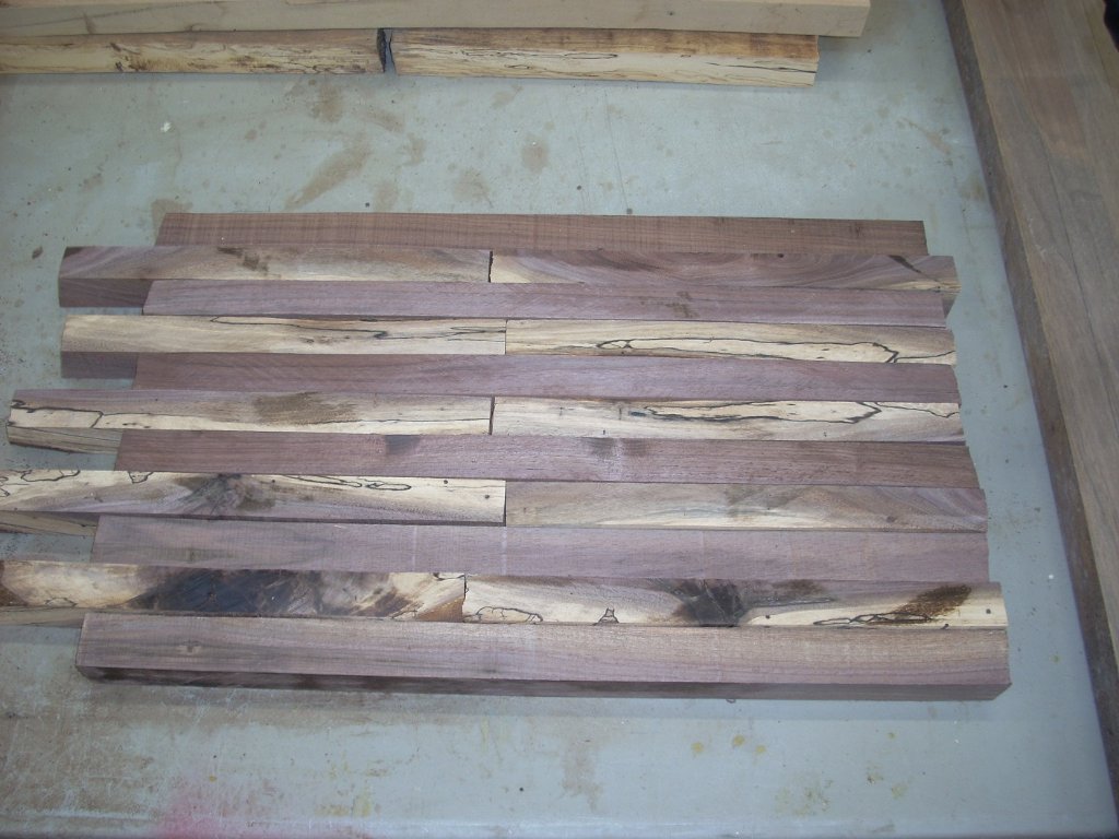

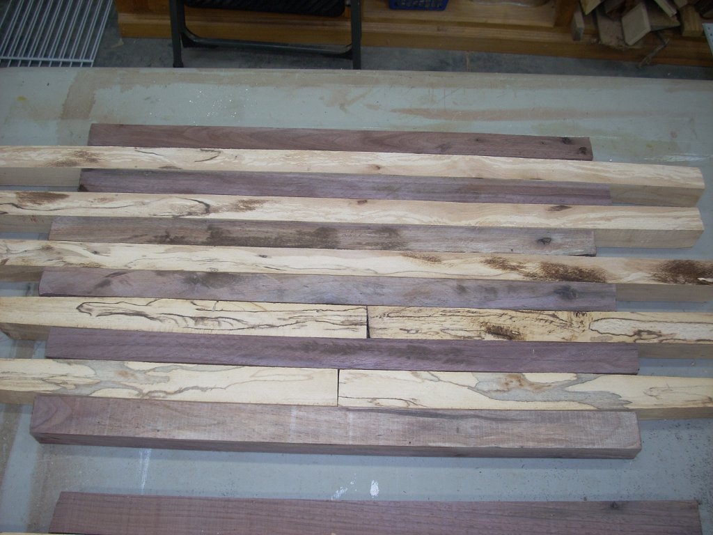

Just getting started, and the first step was to cut the strips of maple and walnut to begin the layout. I have to decide if I am going to try and blend the colors and highlight the spalted grains by laying them out in strips, or cut them into cubes and glue them up with the end grains exposed, then plane them all smooth and get the checker board effect with just the contrasting colors showing.
Here is a temporary layout, with the grain contrasts showing. That maple grain will really pop once the burn marks are gone and the finish is applied, in this case just a mineral oil finish with some wax. Remember, this is a ROUGH layout, no fitting or sizing has been done at this point to close any gaps. :roll: Geez, I know everything doesn't fit perfect and the ends aren't even, and I would move pieces around to better match the grains... :P
Input?

To my taste; I think I would go with the horizontal layout as shown in your pics. Unless they are to have a dual use; Checkers/Chess and cutting boards. Whole lot less work, yet would still have the traditional cutting board look.
Just my opinion Jim.☺

I think it'll look great in strips. When I blur my vision, I can see past the temporary roughness and get a glimpse of what it will look like finished. FANTASTIC!

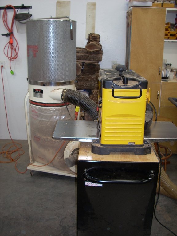

Back out in the shop for an hour or two. I set up the dust collector and the planer and ran all three layouts thru about a dozen passes, plus all the extra materials. (Always a smart move.) If I don't need the extras for these boards, I'll make a couple extras... you never know. Miss Tina will claim them or I'll have them on hand for donations to a charity or someone will need one. :D
My dust collector is set up to attach to each of my pieces of Dust Making Equipment, here it's hooked up to the planer...

It makes a HUGE difference. I ran all the pieces and parts thru the planer about a dozen times, taking just a couple 32nds of an inch off on each pass.

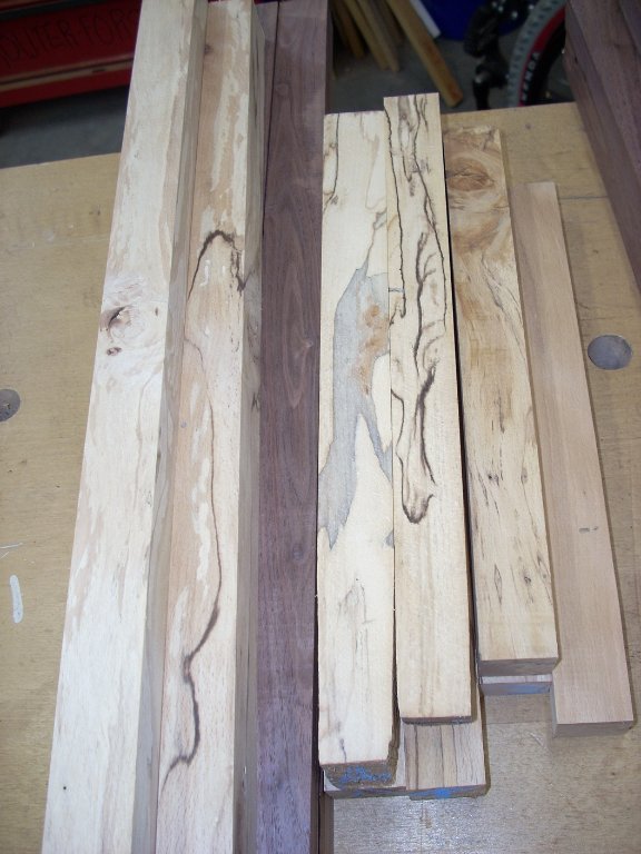

05 three plus spare.jpg (189.42 KiB) Viewed 5499 times
The titebond III glue is due in tomorrow, but today, after some rest, I can start fitting the boards, and cutting them down to size. I am going with 11 x 18 to 20ish. Mainly because the flat rate boxes are 11-3/4 x 23ish x 3" thick. :D

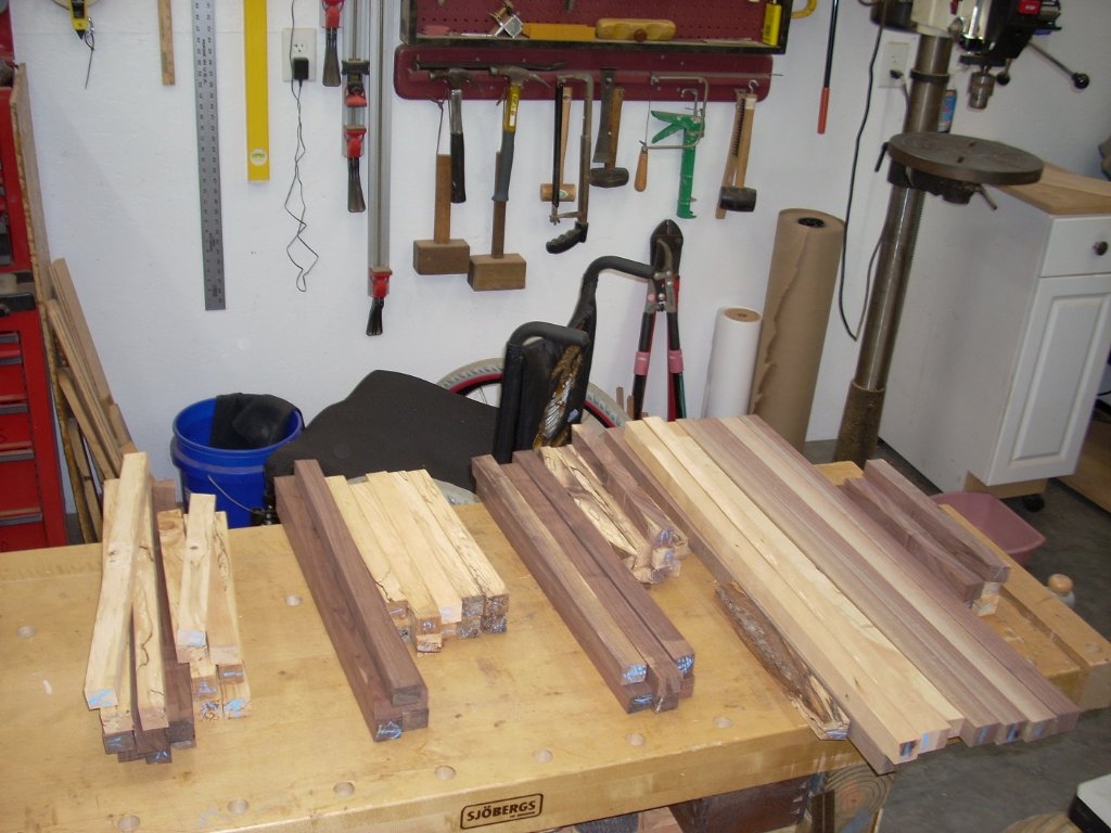

Pics from the Jointing session. Didn't get back out until this morning to work on the layout.

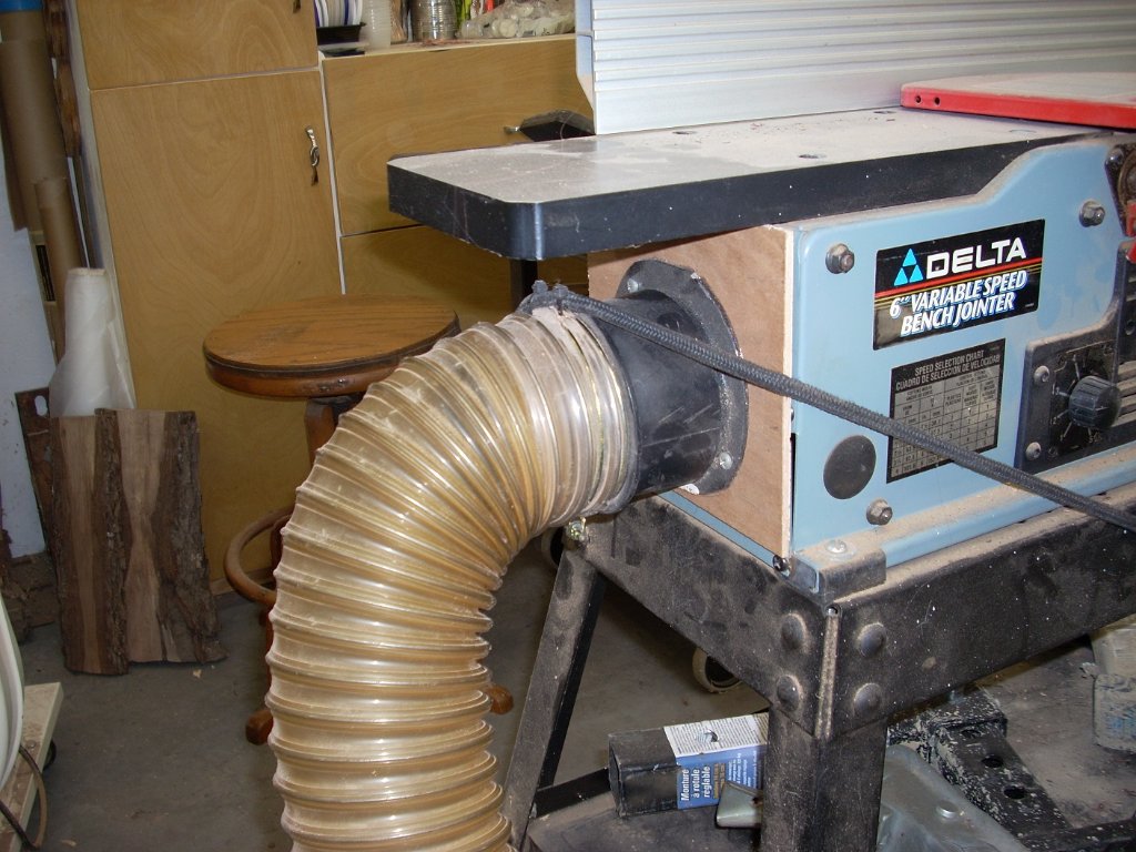

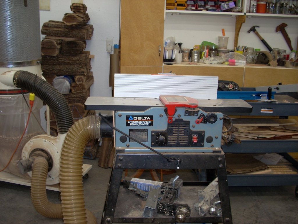

To make the jointing LESS messy, I had to make a custom connection for the dust collection. I attached a male hookup to a piece of luane with a half moon cutout that fit the small rectangular discharge port on the jointer. Prior to that, I had bungee'd the dust collector hose to a work stand, and stood that next to the discharge port, to catch about 75% of the discharge.
06 custom connection.jpg (193.69 KiB) Viewed 4580 times
With the dust collector hooked to the jointer, I got busy yesterday and knocked out the work. With this hookup, the only shavings that escape are the few that are tossed free at the blades.
07 jointer setup.jpg (178.19 KiB) Viewed 4580 times
All that work had me ready to go this morning....

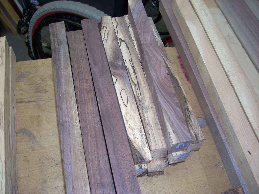

Jointing after the work on the planer, gave me four clean sides. Now the grain was exposed on all four sides. I had a lot to work with as I started working on the layout this morning. The grain in the two stacks was beautiful. The third had a lot to offer as well.
09 grain showing.jpg (189.02 KiB) Viewed 4579 times
10 grain 2.jpg (113.97 KiB) Viewed 4579 times

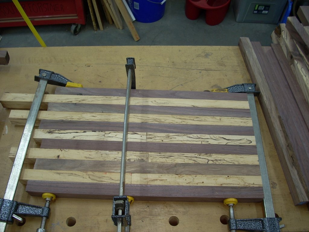

I got the first layout done pretty quickly, as everything seemed to fall into place. I used a large carpenter's square as a guide, and cut the ends of each piece square on the chop saw as I worked. The boards will be approximately 10x16 when they are done. I tried to match the grain patterns and color in each section as much as I could. They wouldn't match perfect, but ... you do the best you can.
11 layout fitting 1.jpg (167.12 KiB) Viewed 4579 times

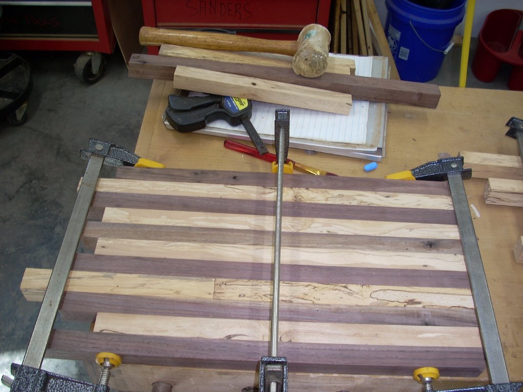

The second layout was more of an issue as there was some fluctuation in the thickness (width) of the pieces. Finally, I gave up and ran all the pieces thru the table saw to trim them to a consistent width. Then it was easy as pie, just matching the grain and color again, finding the best combinations. I had to take a break before beginning the third.
12 layout fitting 2.jpg (172.15 KiB) Viewed 4579 times
These are NOT glued up yet, just test fitted and clamped to insure no gaps and a nice color and fit.
I'm happy and Miss T gave her grin of approval.

I got out into the shop for a couple hours this evening... Got two of the boards glued up. Only enough of the right clamps to safely glue up the two of the three. I will glue up the third will I deal with the first two tomorrow.
