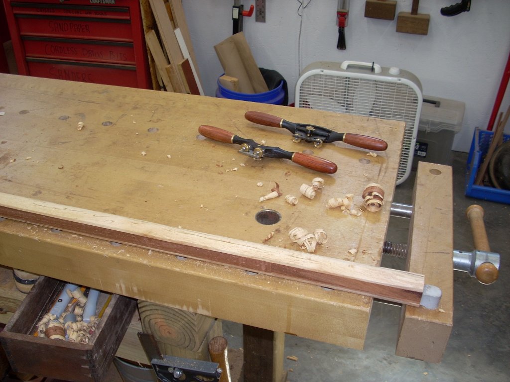

Out of the clamps the next morning, you can see why it's a bit of a challenge with no lathe. The shaping will be done with the spokeshaves. I love working with them, but it's a challenge with the shoulder surgery pending. Work a bit, rest a bit, work a bit, rest a bit. I trued the edges on the table saw, and got started.
05 no lathe.jpg (188.97 KiB) Viewed 4239 times
The spokeshaves get the work done if you keep them sharp. I got to 4,000 on the waterstones, then touch them up as needed.
06 spokeshaves.jpg (170.01 KiB) Viewed 4239 times
