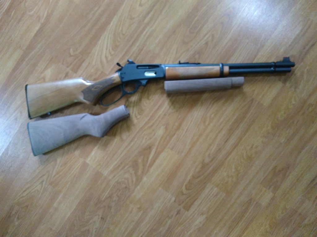

I am thinking of trying to replace these stock forearm and stock on this youth edition 336 marlin with this walnut stock made for a regular 336.as you can see the forearm in longer than the existing (ad is the buttstock. How many issues do you old home rifle fixers see with me trying to fit that forearm...I don't mind it being longer if I can move the band forward...have also considered cutting off back end.. though would have to redo the existing lip on the back if I do that ....ideas... suggestions? I just like walnut much better than what's on it
None! Go for it - but take it low and slow, fit, check refit - and measure THREE times and cut once!!
Seriously - it should fit fine with little modification and leave the forestock the length it is as it appears it will fit with no issues.
You may have a little scratch on the top of the barrel where the band currently sets but that is an easy touch up with cold blue!

That's going to look very cool, I'd say! Keep us posted on what looks like a great project!

Ya I like the walnut better too. Go for it.

That wood should look good on there. It has some good figure in it
