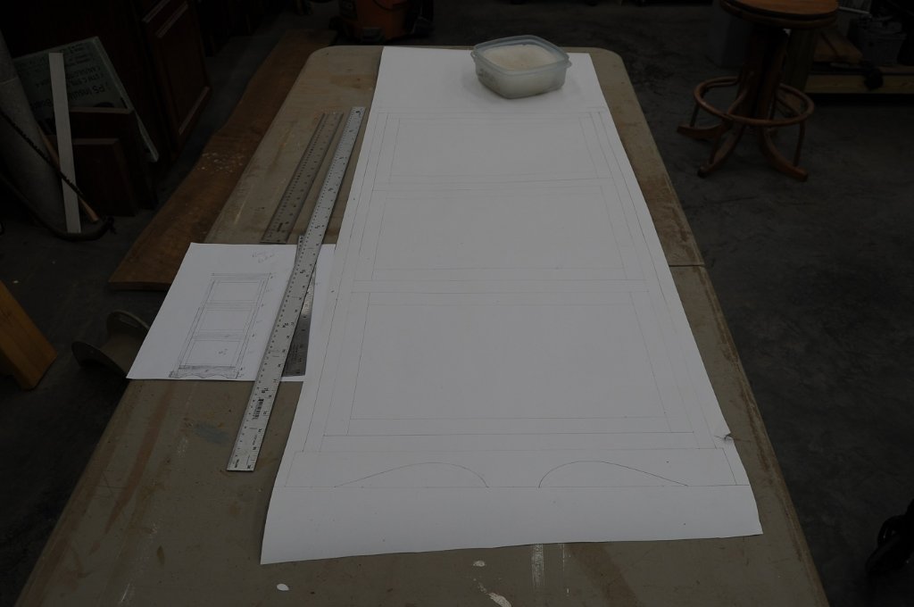

I have gotten busy in the shop over the last week or so... Well, busy for me. :) I work when I can, and rest when I have to. The first step was to take measurements and make the first rough sketches on typing paper sitting in the recliner and ask the boss what she thought. She liked them. Then I went out in the shop and got the butcher's paper and made the sketches actual size. Got that done.
01 full size sketch.jpg (91.59 KiB) Viewed 5550 times

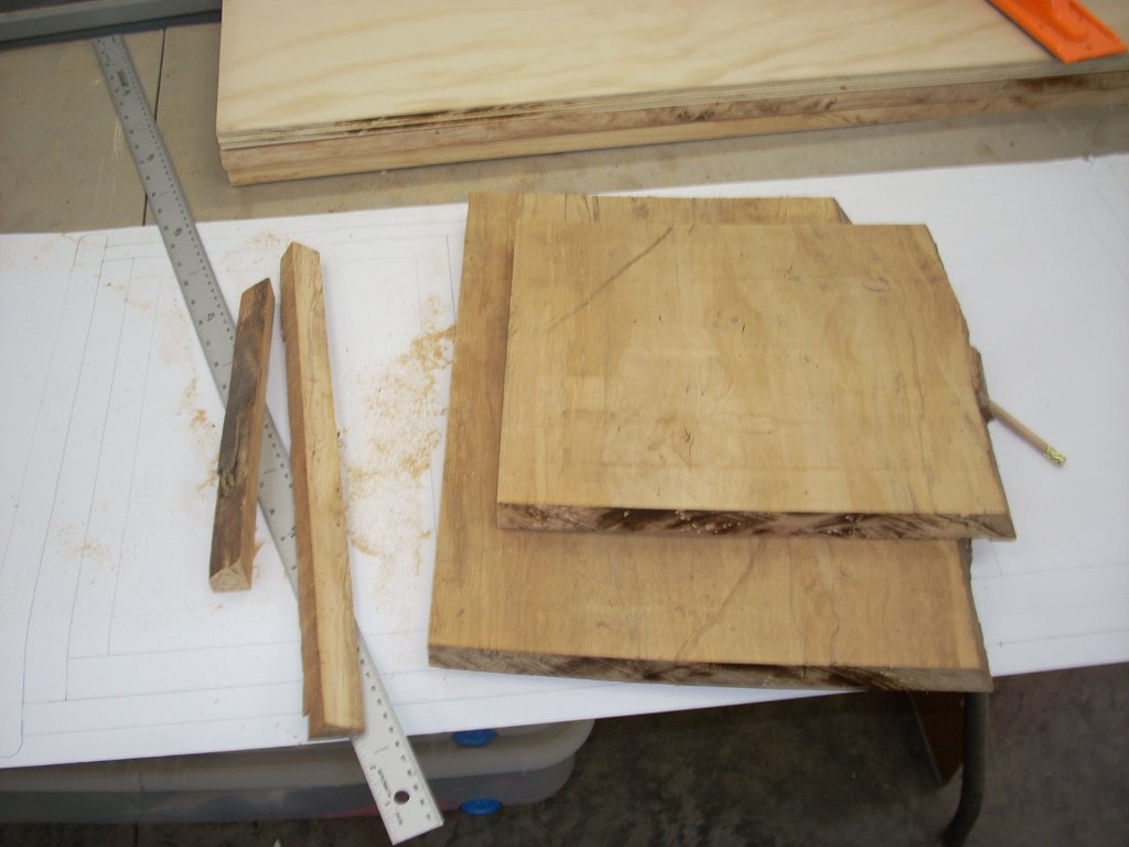

I often make several pages of these, showing front, back, and side views, but in this case, it's a fairly simple project, construction wise. I can operate off the front view, and work from this knowing the plan. (In my hollow head.) :roll: I took measurements and had an idea what I needed. Trip to the woodshed, to find wood. Came back with this... think it's maple. Will see what we have for grain patterns once it's brushed and vacuumed. :P
02 first boards.jpg (110.15 KiB) Viewed 5550 times

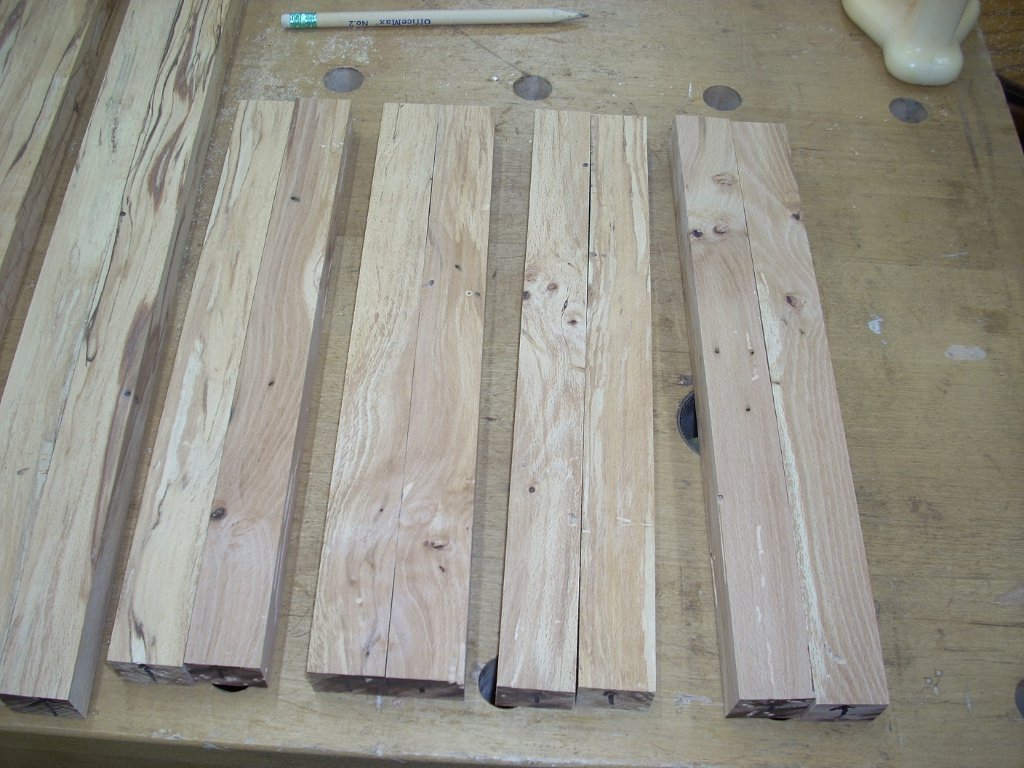

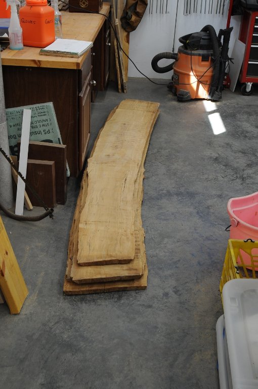

Got it all cleaned up and vacuumed, then started to lay out the side panels. :cry: Then I realized this would be nowhere near enough wood. The day was gone and I hauled it back to the woodshed and pulled out a matched foursome. THAT should do 'er. Stacked it in the shop and left it for the day.
03 better selection.jpg (111.71 KiB) Viewed 5550 times

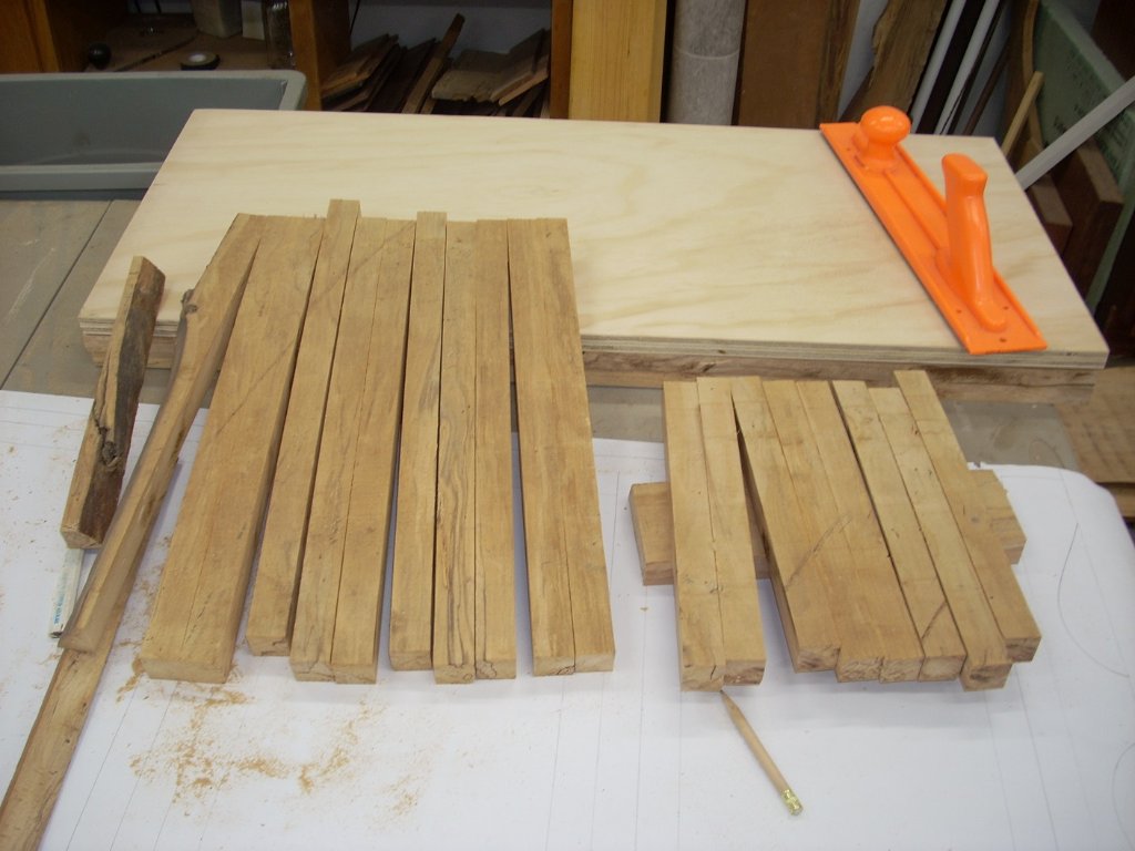

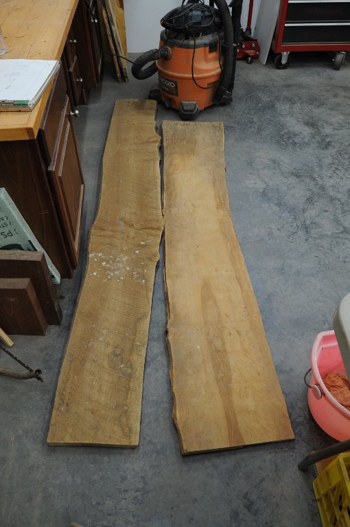

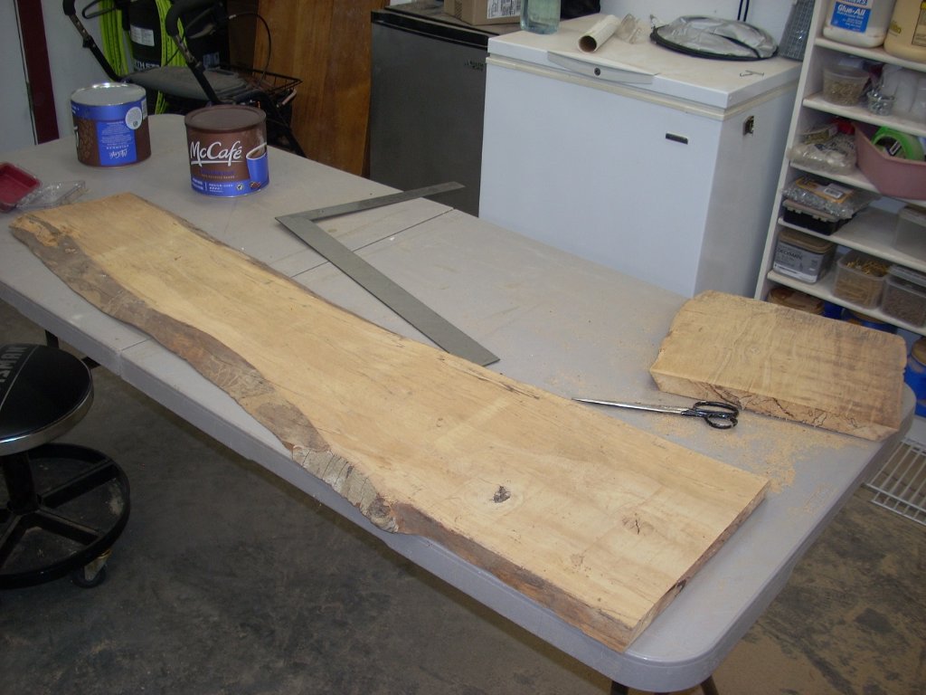

Working on the layouts and getting the boards ready the next day, I was able to carefully lay out the side panels and make the cuts. The grain looks amazing, and the two side panels took one entire slice from the log. :o Good thing I have four.
04 rough sized.jpg (125.46 KiB) Viewed 5550 times

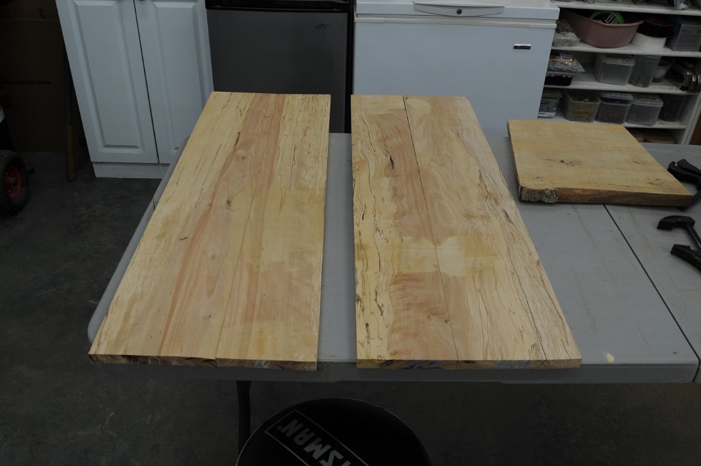

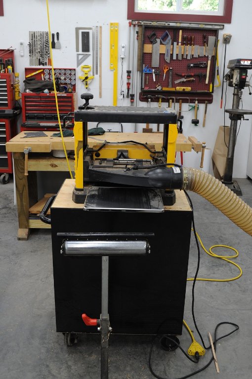

I have set up the planer for the side panels, and will run these through. I ripped them as the planer will handle 12.5 inches which is the exact width of the panels... but these are bowed. I learned a long time ago, when trying to flatten bowed panels you lose less wood if you rip them in the middle of the bow, planes the two halves flat, and then rejoin the panels. Time to get to work.
05 planer.jpg (124.46 KiB) Viewed 5550 times

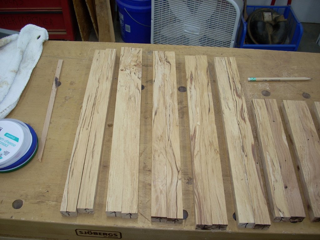

After planing you can see the results. There are still some low spots with a bit of roughness, but they will be taken out by the card scraper. The grain is amazing in my opinion, and I think this is more spalted maple.
06 the sides.jpg (116.75 KiB) Viewed 5550 times
I will put biscuits in these and join them during glue up. These are two of the largest pieces in the Cabinet and I want them strong. I may just use cabinet grade ply for the back of the cabinet since it won't be seen. The rest will be easier to process. (Hopefully.) After cutting the slots and inserting the biscuits, ever effort is made to keep things flat and level.

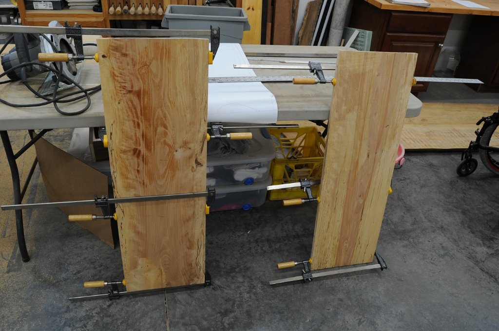

Here are the sides... rejoined with their mates.
07 rejoined.jpg (173.94 KiB) Viewed 5550 times

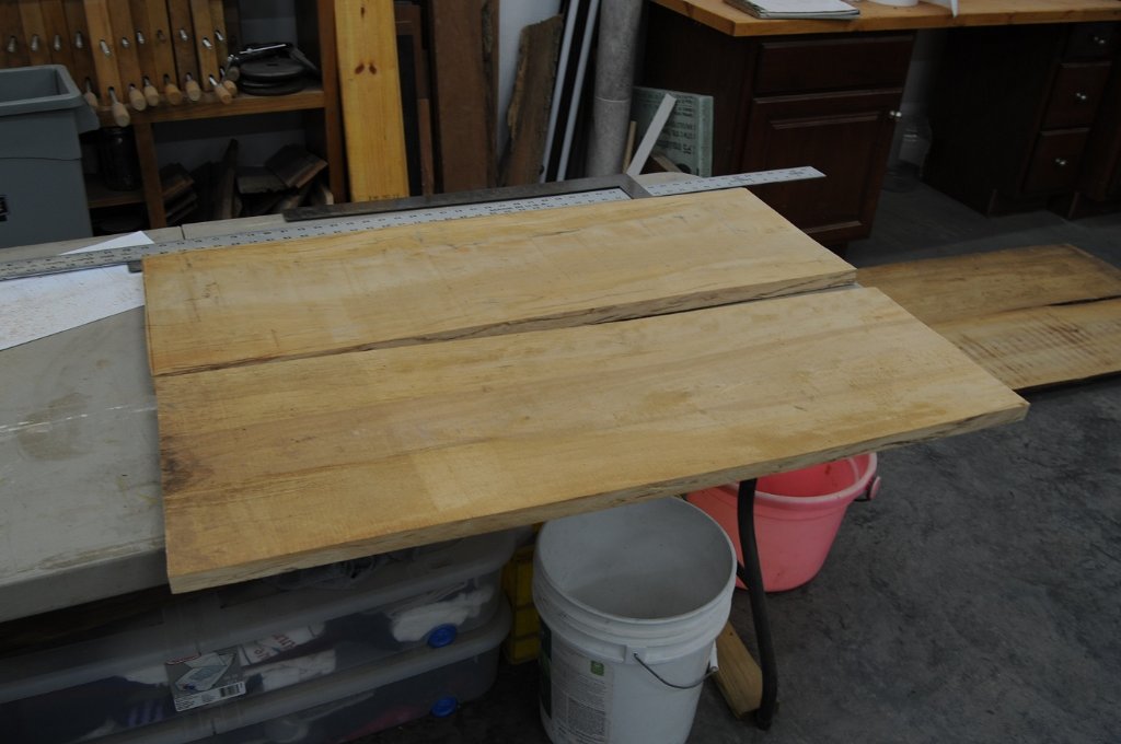

As Promised! :D Here are some pics from the last few days of work in the shop.
Here is the slab AFTER I cut the two pieces out, the small end tab I cut off first because it was a bit discolored. I won't throw it out, as it's probably fine for some other use, but I wouldn't risk a color difference in the larger project.
08 slabs cut.jpg (150.49 KiB) Viewed 3644 times

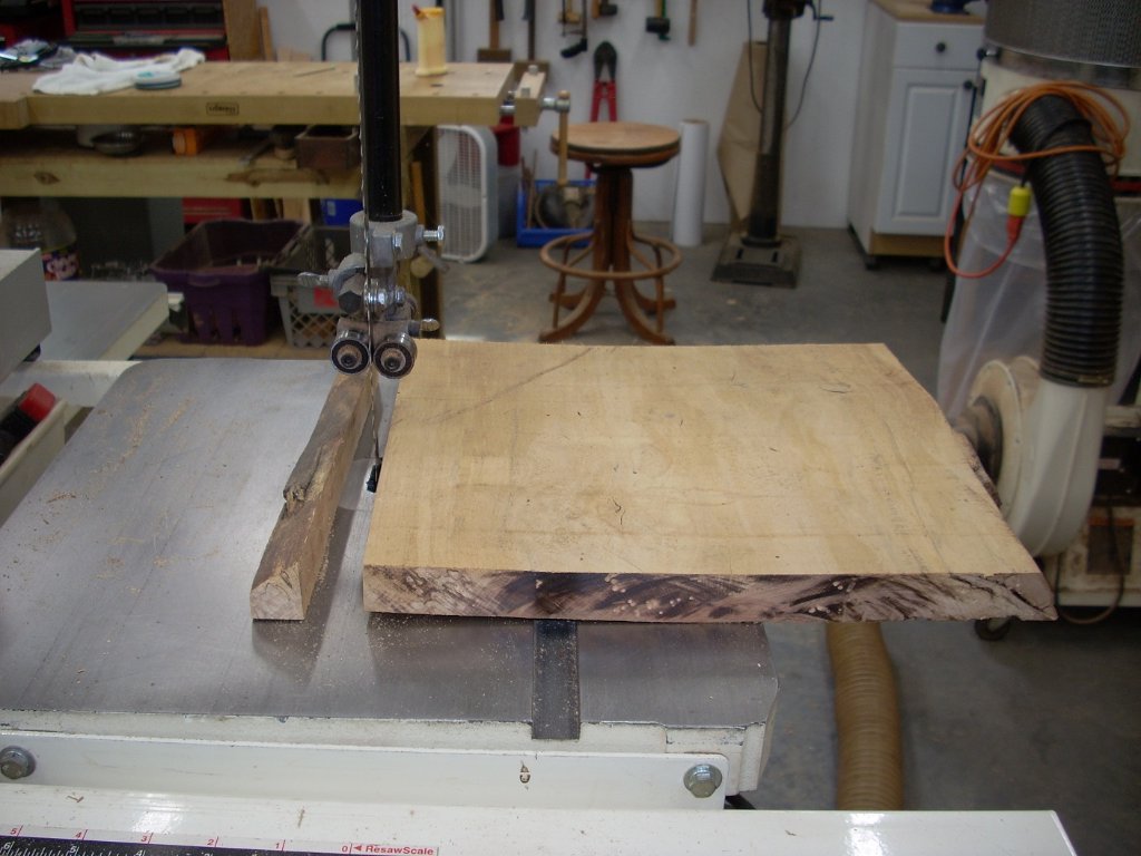

Here is where I edged the two cut chunks on the band saw to give me a straight edge to use as a guide on the table saw fence. Slow and steady rules the day.
09 edged on band saw.jpg (148.35 KiB) Viewed 3644 times
As you can see, the two pieces are bowed all to Christmas... but since I am cutting 1-1/8" wide pieces, I can work with that easily.

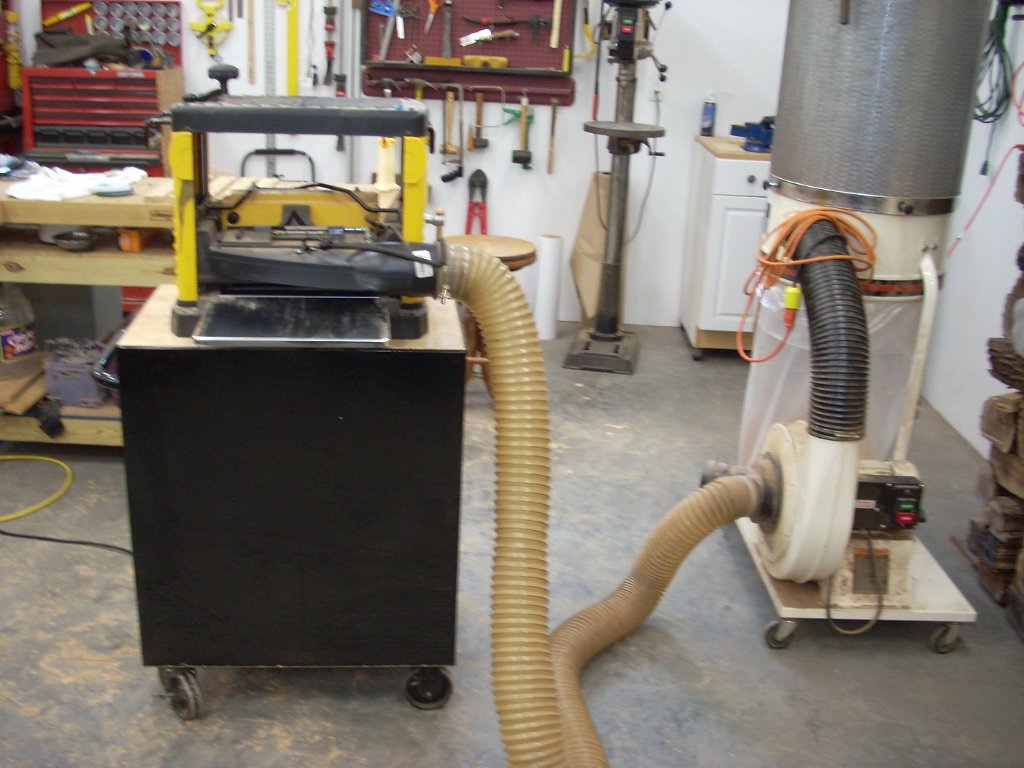

I set up the planer and dust collector and got ready to rock.
12 planer setup.jpg (158.85 KiB) Viewed 3644 times
