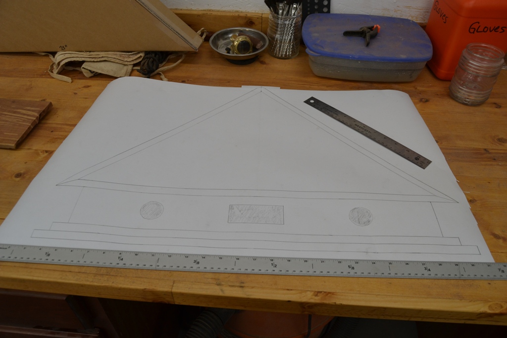

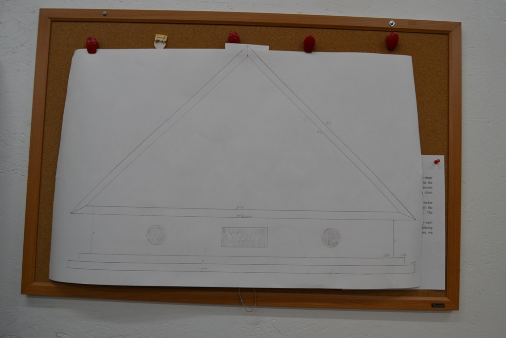

I started the Flag Box project yesterday, by working on the formal layout. I don't usually do a full size drawing, unless it's for a special project like this one.
01 formal sketch.jpg (244.12 KiB) Viewed 5609 times

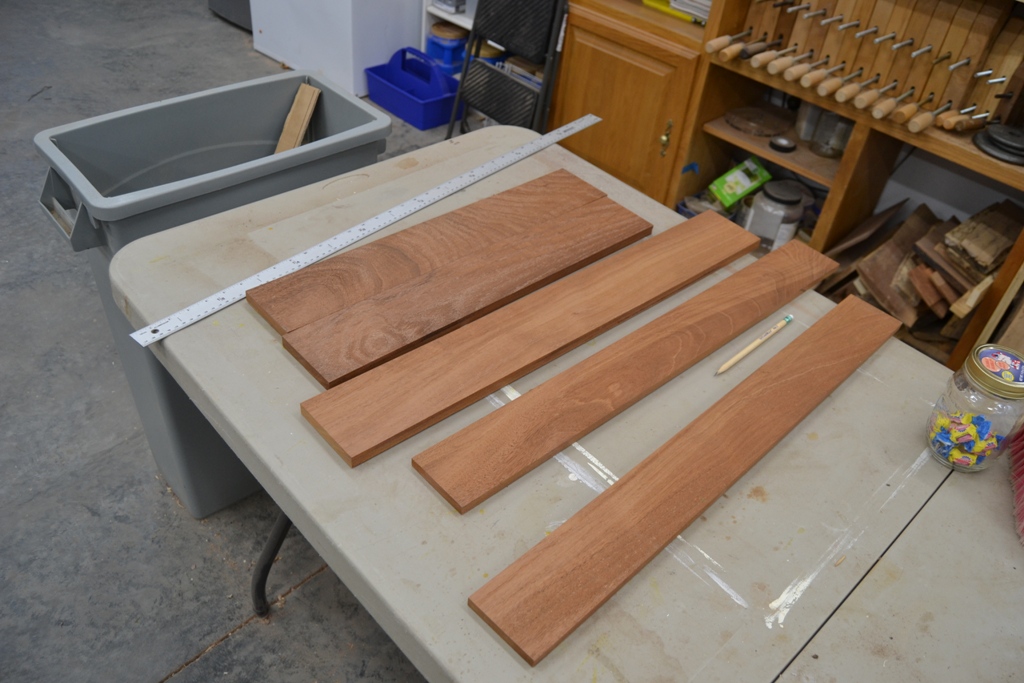

I got out into the shop this morning and went through the mahogany pile and chose the various boards I needed, after going over the drawing and taking careful measurements to determine which boards I'd need in which lengths. I have two widths available, 3" and 3-3/4. Unfortunately, I needed two of the wider ones in the longer lengths, and wasn't going to have but one at that length... so it required some work.
First I chose the ones I did have in the proper lengths based on color and grain patterns.
02 choosing wood.jpg (299.03 KiB) Viewed 5609 times

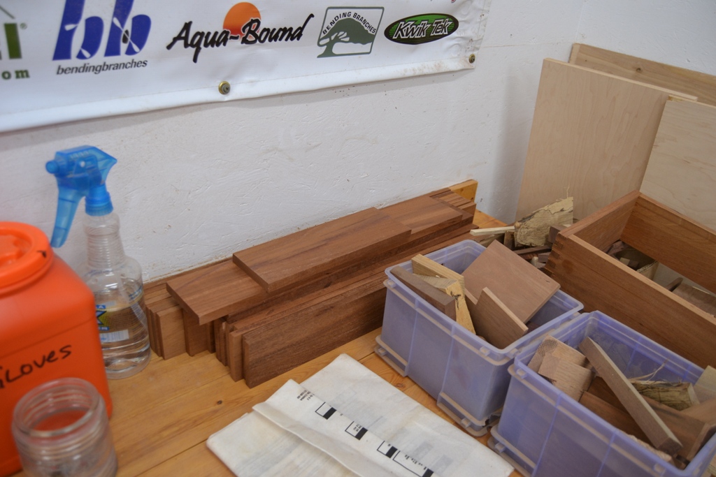

There is plenty of wood left if I make a mistake or three.
05 some left.jpg (286.65 KiB) Viewed 5609 times

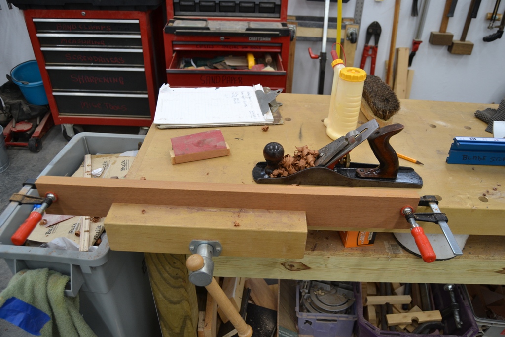

To get the second longer wide board, I first matched a couple of the longer 3" boards for color, then jointed the edges.
03 jointing edges.jpg (323.37 KiB) Viewed 5609 times

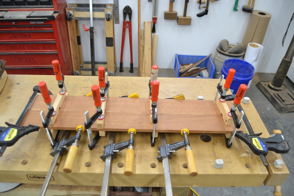

Once I got a good match, I test clamped them to insure a gap free joint, then glued and clamped them to insure a good bond.
This will be the bottom panel of the two panel base.
04 clamped up.jpg (333.27 KiB) Viewed 5609 times

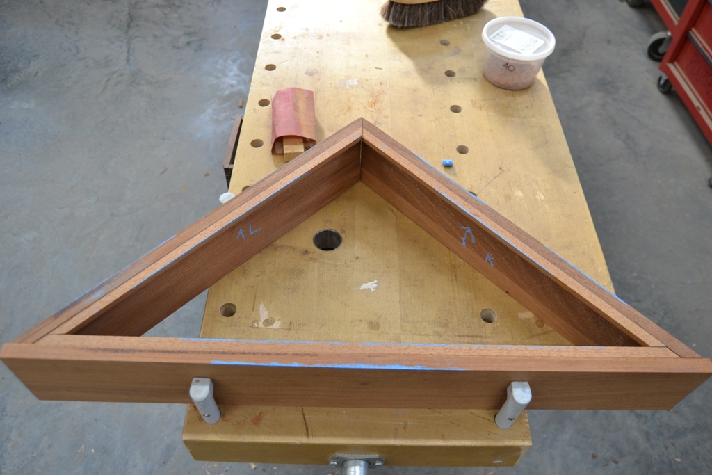

The upper "flag box" was cut yesterday. Turned out okay.
01 flag section.jpg (309.5 KiB) Viewed 5581 times

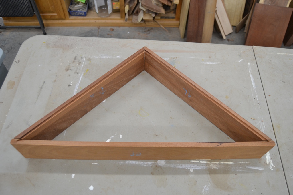

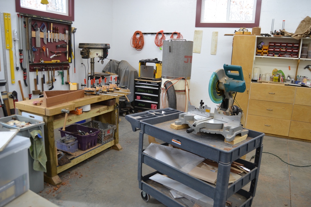

I set up the miter saw on the mobile cart so it's right in the work area. Makes things much easier.
03 work areas.jpg (350.62 KiB) Viewed 5581 times

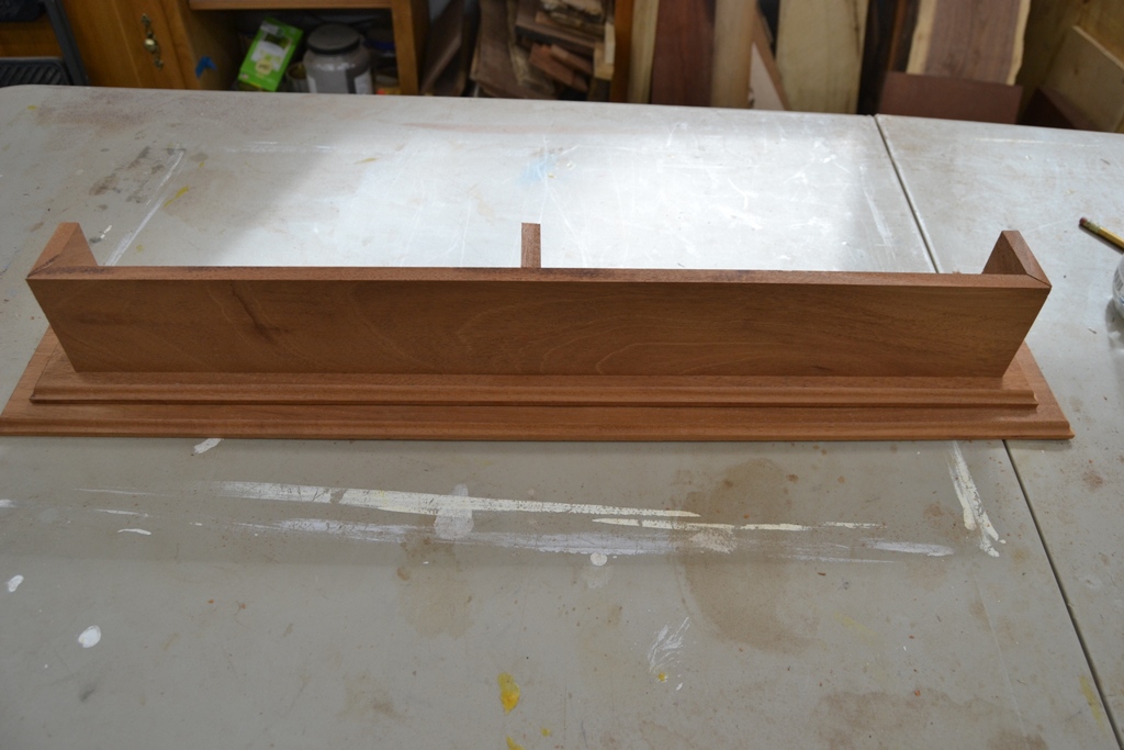

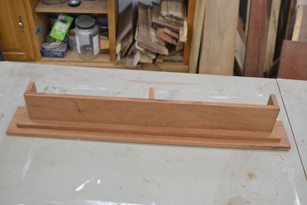

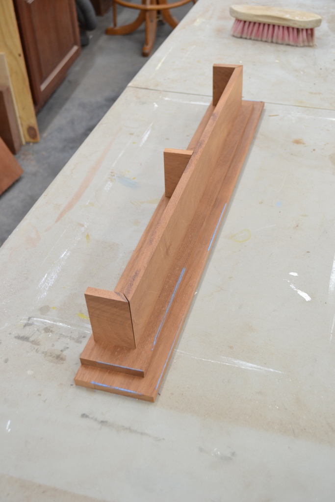

I started by cutting out the basic components of the base. The face and sides, and the first level of the bottom.
02 base.jpg (242.56 KiB) Viewed 5576 times
All the accents will be routed before assembly. I haven't used the router table in about five years, but I think I will use it here for consistency in this project.

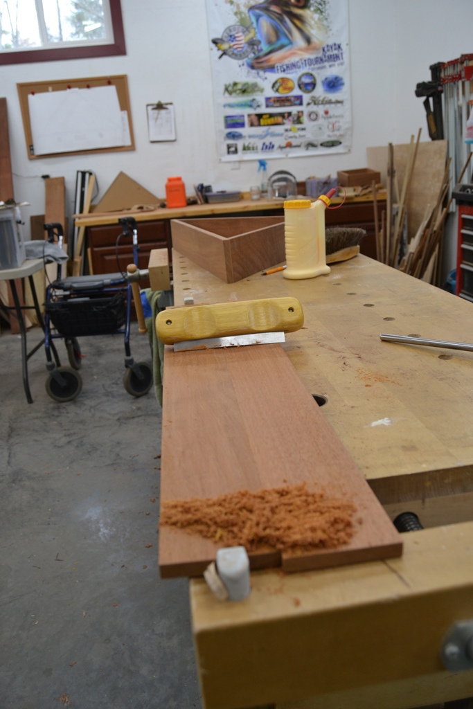

Next I took the clamps off the lower wide glue up jointed base panel and trimmed it to size. First I had to use one of the cabinet scrapers to remove the glue lines and smooth the surface.
03 scraping jointed base.jpg (266.43 KiB) Viewed 5576 times
I saved the scapings to fill in any needed holes or gaps down the road. Assures a good match. ;)

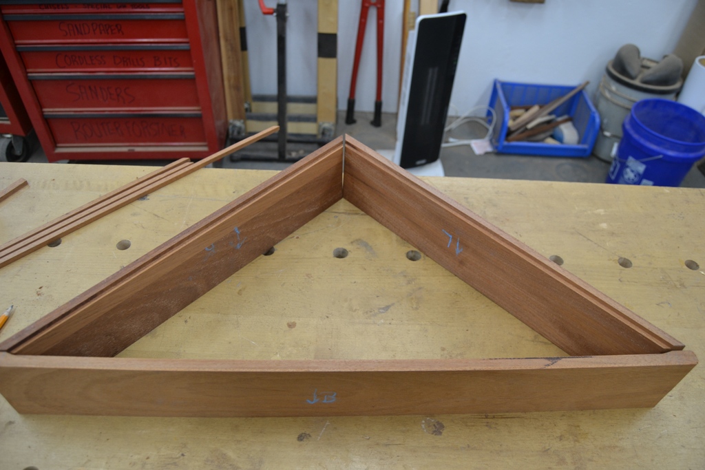

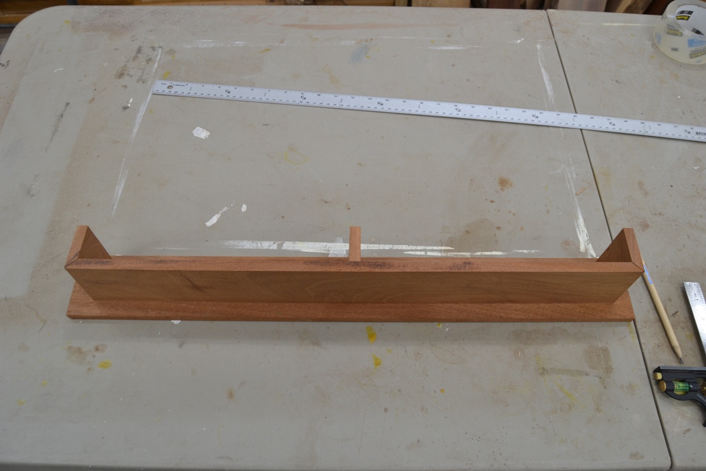

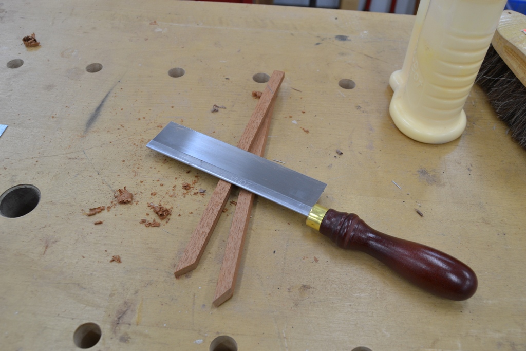

Next task was using the strips I cut from the Off Cuts from the base to cut the trim that will hold the glass in the flag compartment. I used the Veritas trim saw and free hand cut the angles after carefully marking them using the flag compartment as my guide.
05 veritas saw.jpg (281.37 KiB) Viewed 5576 times
I cut the bottom trim first, then clamped IT in place, cut the right side angled trim, clamped it in place.... and then fit the last trim piece ... NOT perfect, but saw dust will fill the small gaps nicely. 8-)
06 glass trim.jpg (290.92 KiB) Viewed 5576 times

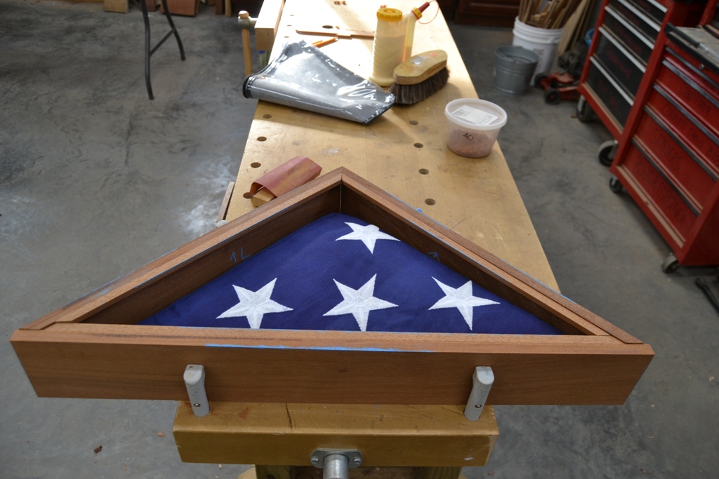

The Flag was brought by this morning, and checked for fit prior to my routing anything. It fits. ;) Keep in mind that there will be glass in the frame, the trim pieces will be set back 1/4 to 3/8" and there will be a back plate behind the flag... it will fit nicely right up against the glass when all is said and done. Also, this is a rough fit for testing, the edges WILL line up during final assembly. :oops:
04 flag fits.jpg (291.37 KiB) Viewed 5559 times

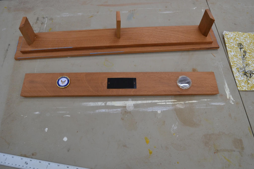

I showed the daughter of the vet what the layout of the face would look like with the coins and the engraved plate. Out of respect I have blacked out the engraving on the plate as it had name and DOB on it. Note that the coins will be inlaid in the face.
03 layout.jpg (189.67 KiB) Viewed 5559 times

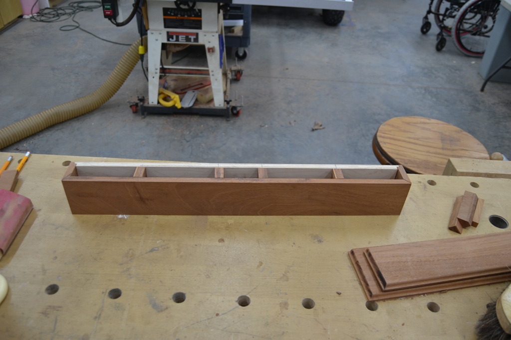

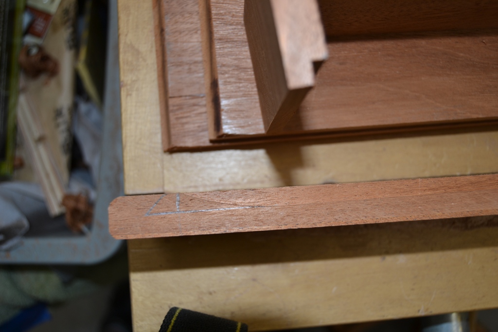

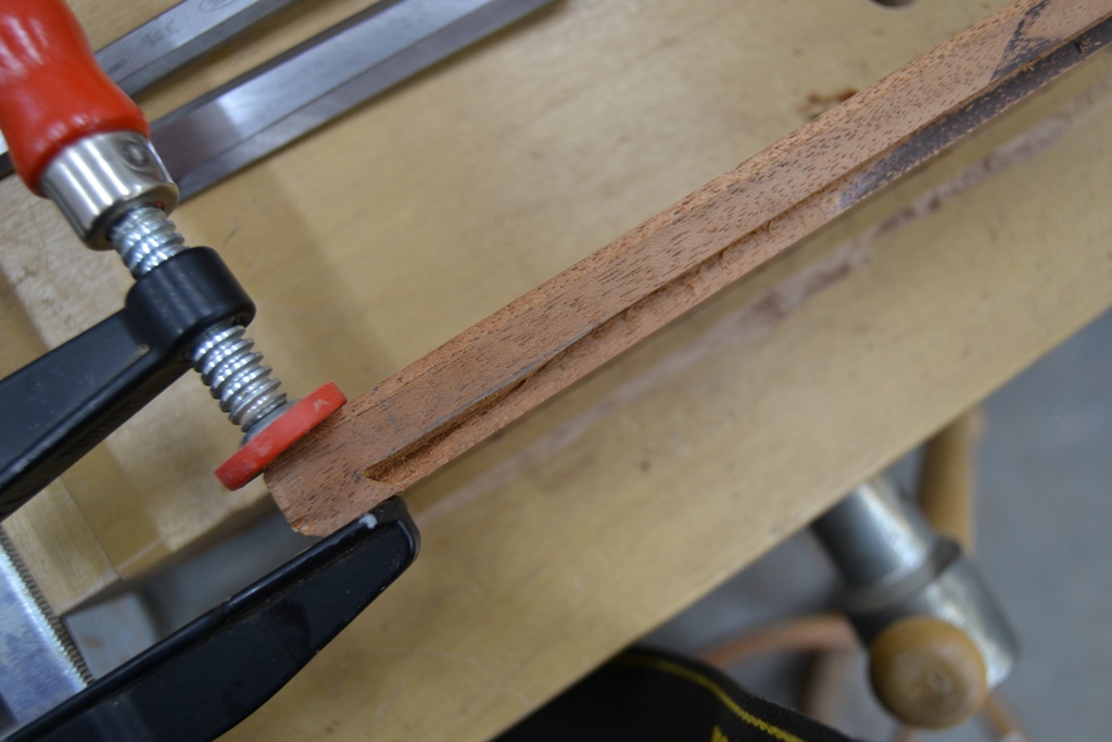

Back at it this morning... and decided to knock out some of the detail work. First up... cutting the chisel work on the flag box dadoes for the back panel.
Marked the proper angles after carefully measuring where they needed to be... and got busy.
01 marked.jpg (230.29 KiB) Viewed 5533 times
I used two sharp chisels and the mallet, and had to use the Optvisor to see well enough to get the job done. ;) Old eyes.
02 detail work.jpg (331.59 KiB) Viewed 5533 times
After about an hour of prep work and chisels, it looks pretty good. A little trimming.... and we'll be there.

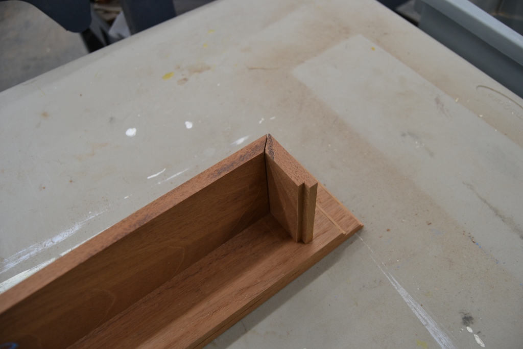

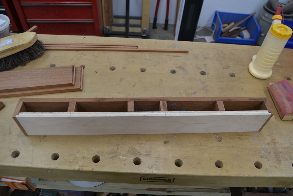

Next, I made up the back for the pedestal. I used some maple ply rather than the thin backer I plan to use for the flag compartment, for strength. I also added some "mini studs." ;) Overkill? Nah, they are placed where I'll be seating the coins, and nailing in the tacks for the faceplate. Okay... overkill. But they were made from scraps and they will help insure the strength of the pedestal and keep it square during glue up. 8-) At least that's the plan... and I have plenty of time.
04 pedestal backing.jpg (280.48 KiB) Viewed 5533 times
05 pedestal front.jpg (264.04 KiB) Viewed 5533 times
I'll get this glued up after lunch, maybe. :roll:

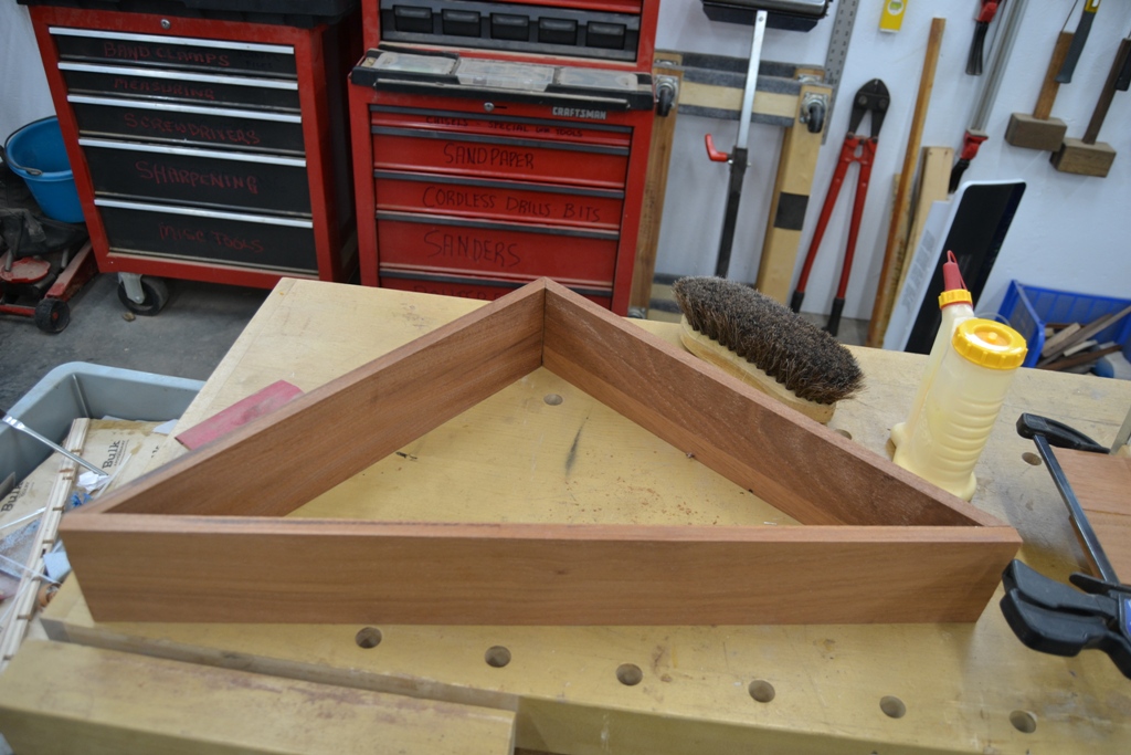

Short late evening session yesterday. I got the pedestal glued and clamped up and shot a few pins in to insure stability. They won't show at all once the sanding is done. That's why you save sawdust. LOL.
01 glue up.jpg (288.64 KiB) Viewed 6236 times
I also did the final detail work on the rear dadoes for the flag compartment. Sloooow careful work with the chisel to get the edges just so... ;) I think we are ready.
02 trimmed and checked.jpg (258.73 KiB) Viewed 6236 times

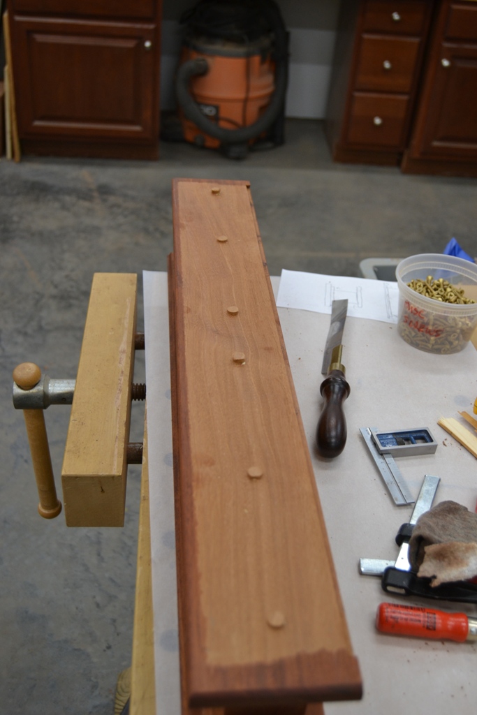

Spent a couple hours getting covered in fine mahogany sawdust, measuring, remeasuring, then marking, drilling, and countersinking, the assembly holes.
Then ... with baited breath, measuring... remeasuring, and finally drilling the holes in the face plate for the coins. The test board I drilled showed the forstner bit for the coins would be too tight, so I used the next size up and they will have a "Framed" cubby inset. They will still look good. I will seat them just below the surface. Next up is another bout of sanding with 220 and 400 grit, then applying finish. You get a good idea of what the thing will look like now.
The holes you see on top of the bottom plate of the flag compartment will fully disappear. For one, I made mahogany plugs to fill them once the pedestal is glued and screwed. Secondly, that area will get flocked, and the plugs will be covered, AND the flag will sit directly over that area. Why bother? Because when they take the flag out for any reason, I want it to look like I actually care. :)

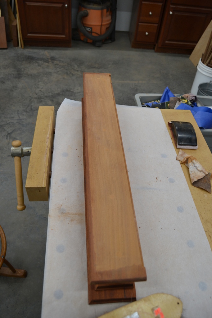

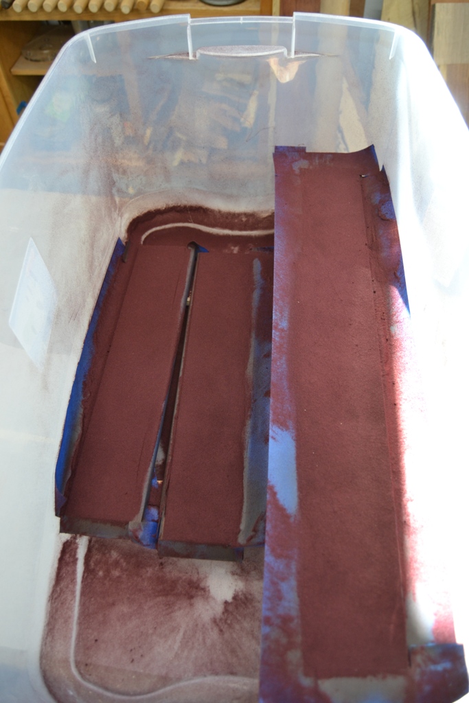

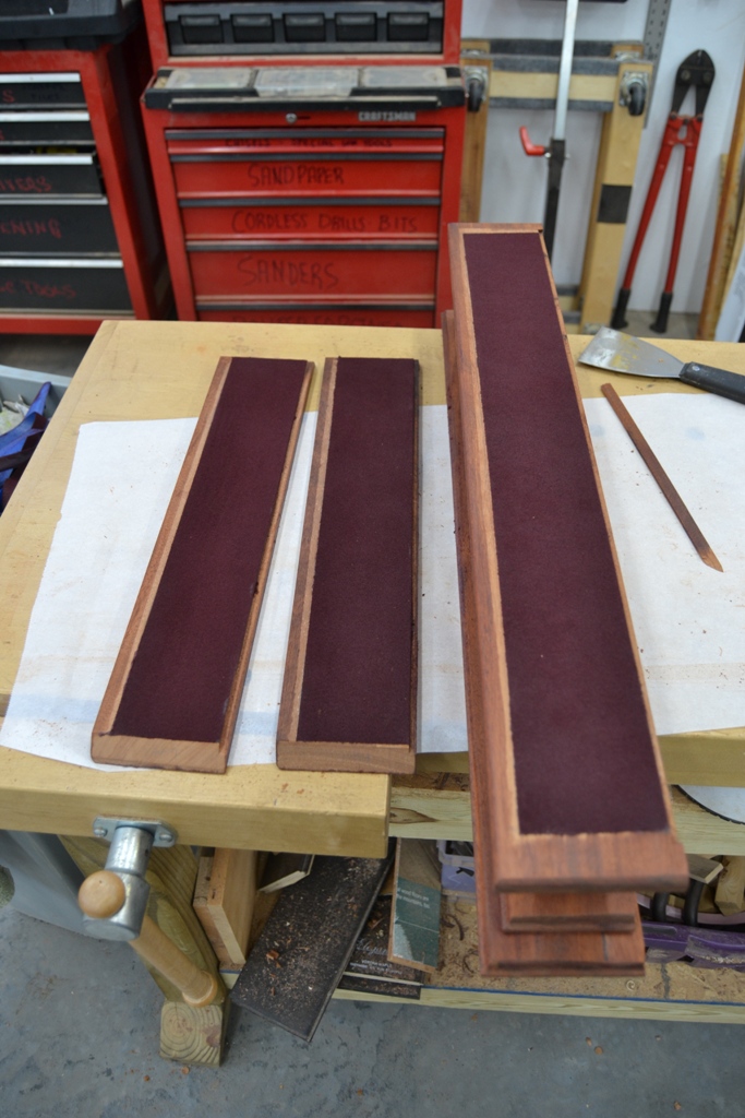

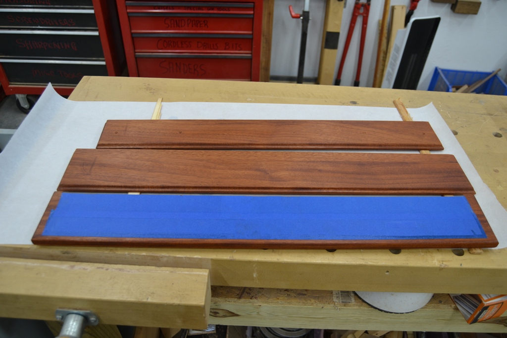

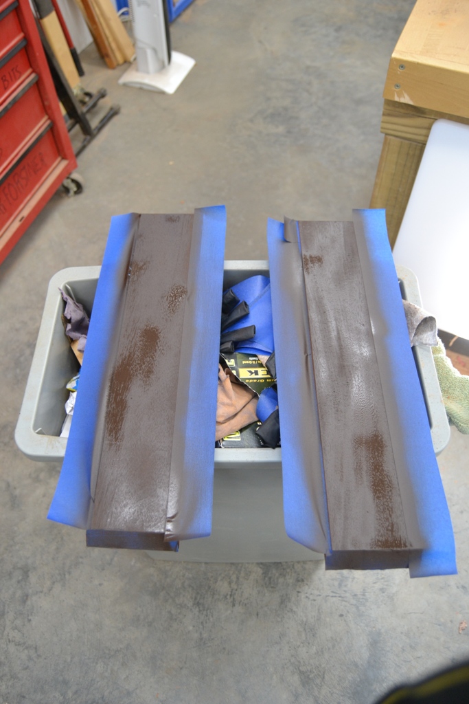

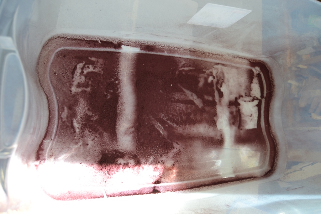

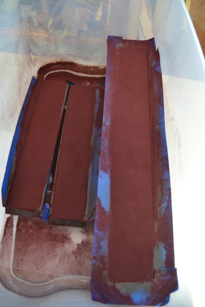

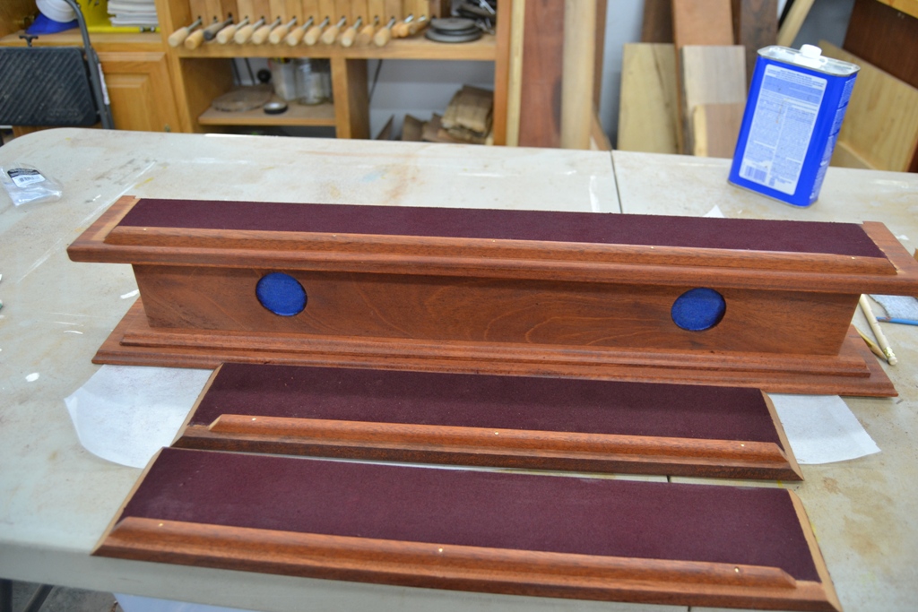

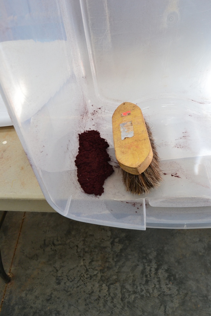

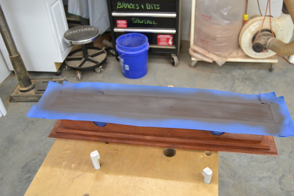

First step in the stain phase, tape off the areas that will be glued, or flocked. Measure, measure, mark. Tape. :P Geez... lots of measuring.. and double measuring here. :?
The first areas I taped off were the inside of the flag compartment. They will be flocked and the flocking base won't stick to the stain very well. Plus it will have to be painted with a flat black paint to seal it anyway. I also taped off the angled ends, where the glue will go, since that will hold the compartment together. Kind of important. ;)
01 flocking.jpg (270.57 KiB) Viewed 6209 times

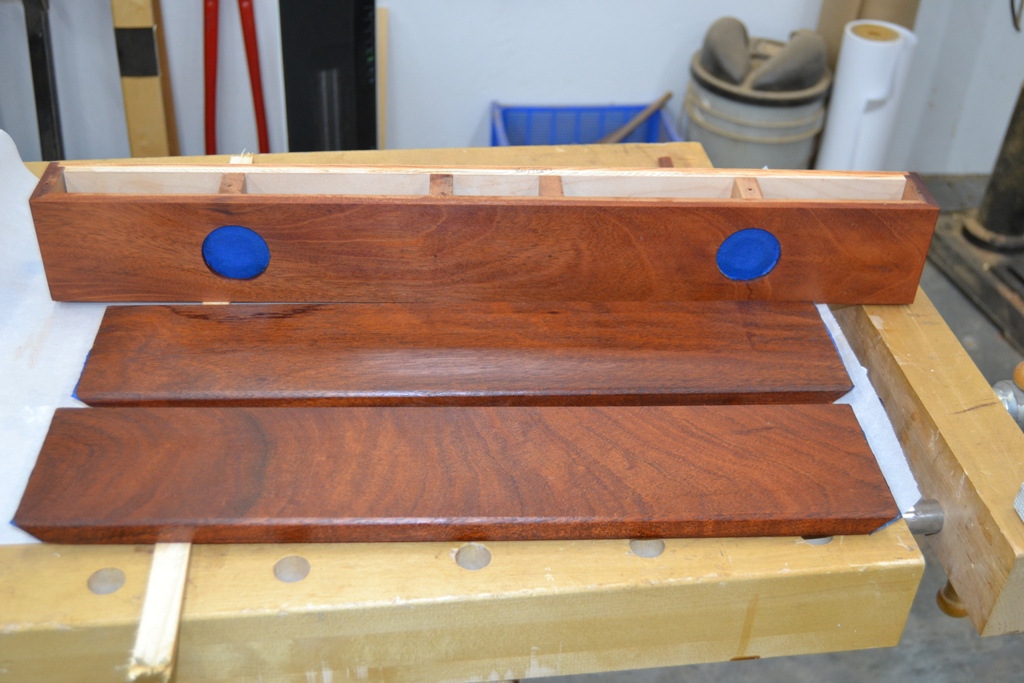

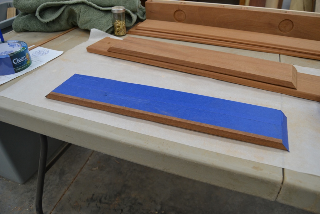

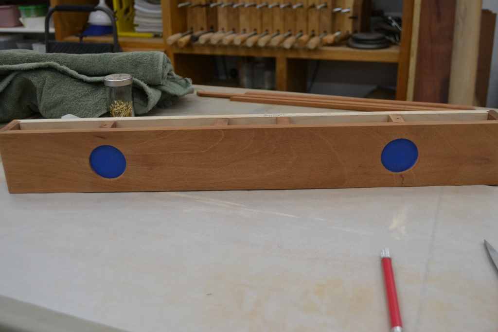

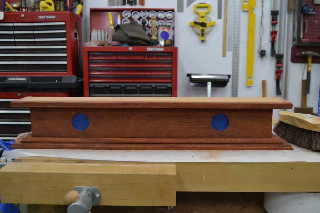

Next, I taped off the coin slots so the epoxy that will hold the coins in, will hold properly.
02 coin.jpg (236.46 KiB) Viewed 6209 times

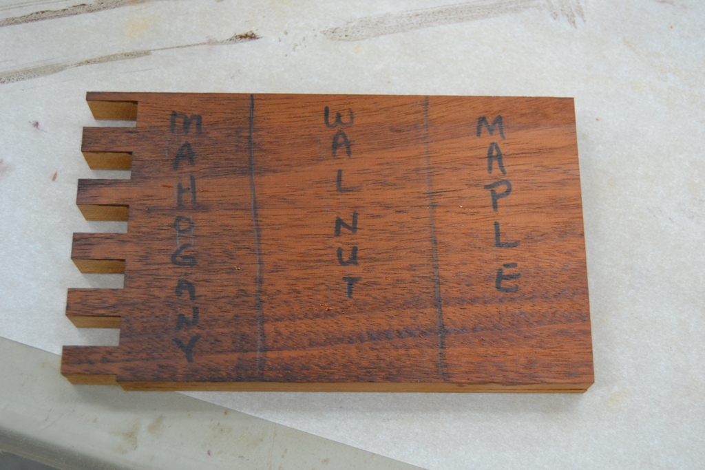

We are ever so close to staining, but ... we need to decide what stain. I make a test stain board, using a scrap of mahogany. Miss T and I liked the Colonial Maple the best, but we sent a pic to the Daughter of the Vet and she and her boss also liked the maple the best so it's unanimous. Maple it is. Always good to have a solid vote.
03 stain sample.jpg (312.95 KiB) Viewed 6209 times

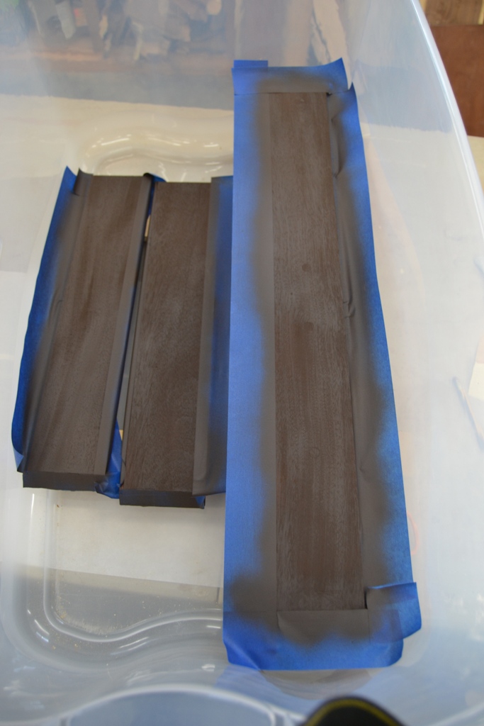

I got busy and carefully stained all the pieces. I would normally have left open areas on the bases, but I didn't want any gaps in the coverage. I'll sand contact areas lightly when I assemble. You'll note if you can see them, that I rolled a little stain over the edges on the pedestal, even though the top and bottom of that piece will be in contact with the base and underside of the flag compartment. I didn't want faint unstained wood peeking to ruin the piece. :roll:
04 stained 1.jpg (280.06 KiB) Viewed 6209 times
05 stained 2.jpg (298.36 KiB) Viewed 6209 times

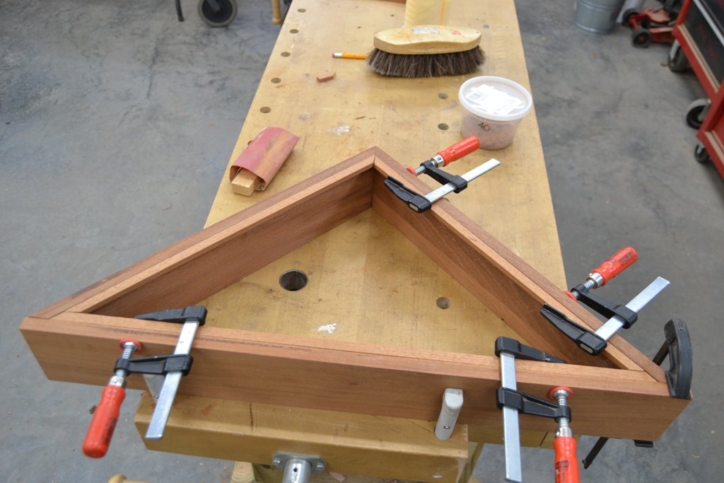

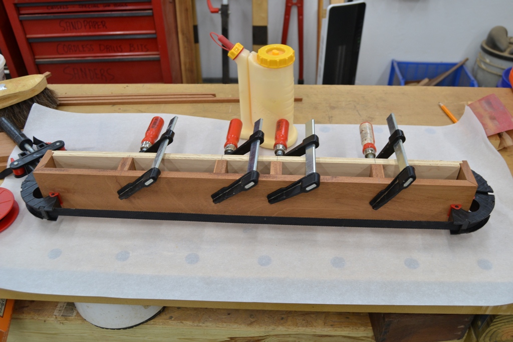

I'll let this dry, then assemble the pedestal, then flock the three pieces that are to be flocked.
We are almost there. :D

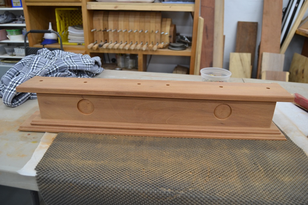

Post by BrokenolMarine » Thu Mar 01, 2018 3:51 pm
Late afternoon work session. A lot more went into the session than I will write about, but.... the pedestal is glued and screwed, and it's just as I had hoped.
I even got the plugs installed and trimmed. Here are the mahogany plugs in place... awaiting shearing.
01 plugs.jpg (237.36 KiB) Viewed 6205 times
Oh wait, did I say plugs? :? What plugs.
02 what plugs.jpg (245.06 KiB) Viewed 6205 times

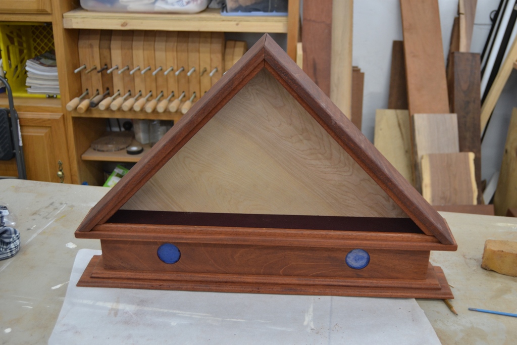

The base is done...
03 Assembled.jpg (282.82 KiB) Viewed 6205 times
I may go out later this evening and carefully apply another coat of stain, just to make sure it's even all over.... then let it dry overnight. ;) Or not.

Out this morning and removed the tape from the sections that will be flocked. Then, carefully rechecked the measurements and remarked the borders that needed it. Then, retaped the sections to be flocked and insured that there wouldn't be any overspray of primer on the wooden surfaces where it wasn't needed. Once the base was taped, I primed that and set it aside to dry while I taped the upper sections.
02 primed too.jpg (271.84 KiB) Viewed 6190 times
I taped both upper sections then primed them at the same time, and set them aside to dry.
01 primed.jpg (279.34 KiB) Viewed 6190 times
Hmmm... I normally use a low sided smaller rubbermaid tub to flock inside of to catch excess flocking. The pedestal base is too large to fit in there. :) The wife went out into the storage building and found me a full sized rubbermaid tub to use for this session. Got the primed pieces laid out and ready for the base coating.
03 ready for the base.jpg (219.38 KiB) Viewed 6190 times
After painting the base coat on the pedestal, I flocked that... then painted both the top pieces and flocked those.... I insured all three pieces had good coverage, OVER flocked is what we shoot for.
04 flocked.jpg (278 KiB) Viewed 6190 times
I'll leave them overnight to dry in the covered rubbermaid tub. I'll dust the excess flocking off and recover it tomorrow, it can be used in future projects. :P Then I can attach the glass retention trim pieces and assemble the flag compartment and measure for the back panel. We are nearly done.

The hardest part is the waiting.... :? I really wanted to work on the box last night, but I had to wait to let the flocking dry... it's really the hardest part. 8-)
Went out this morning, and it was good and dry.
01 dry and ready.jpg (263.5 KiB) Viewed 6157 times
That meant I could move forward. First step is to tilt each piece and give it a hard whack on the bottom, prior to doing anything else, knock off as much of the flocking as you can. Then, with a VERY soft bristled brush, brush off the excess. I use a fine hair shoe buffing brush that I don't use for anything else. It's part of the flocking kit. :) This lets you recover as much of the excess as you can.
02 excess flocking.jpg (291.55 KiB) Viewed 6157 times
04 recovery.jpg (270.71 KiB) Viewed 6157 times
Here are the flocked pieces, ready to work with. They turned out well, but there were some areas where there was a bit of bleed thru of the paint used as a base. I used an exacto knife to scrape that away. Good to go. Those "bald" areas with no stain and no flocking? For glue adhesion. :)
03 tape removed.jpg (306.25 KiB) Viewed 6157 times
I spent the next hour, measuring, marking, drilling pilot holes using a small gold finish nail as a drill, and a 7/64 bit as a countersink. Prep work. Then I remeasured, as I installed each piece of trim on the individual components. There wouldn't be room to drill pilot holes or countersink if they were installed after assembly. Hopefully careful installation will result in a good result. If not, tricks will bring them into line. :roll: 8-)
05 trim installed.jpg (311.28 KiB) Viewed 6157 times
After a break, I'll get out to the shop and assemble the flag box section, then measure for the back. :P

Post by BrokenolMarine » Sat Mar 03, 2018 5:42 pm
Got out this morning and assembled the box. It's not absolutely perfect, but I think I can touch up the things that are annoying me. :twisted: I got the back on. I guess I'll flock the inside of the back. :? You won't see it, because the flag will be in front of it. But, if the box is empty, it's glaring. :roll: It will just look nicer. Renee is coming with the glass and flag tomorrow. :)
01 assembled.jpg (275.79 KiB) Viewed 6150 times
I need to soften a couple edges, and fill a gap here and there. I have to apply the finish, then buff that and wax. Mount the coins and name plate. Then... wait, then I'm done. :shock:
