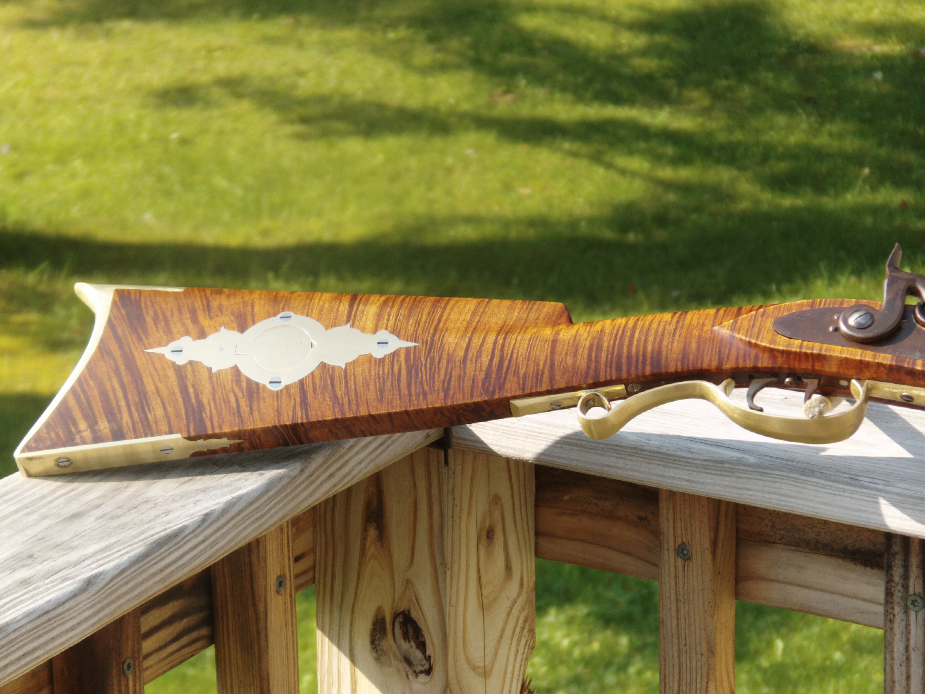

First don't use a oil based stain on maple. It will only let a small amount of stain in and even putting on more coats won't gain much in the way of color. Use a water or alcohol based stain. Much better results. You could even use an acid stain aqua fortis. It will make the stripes just pop. This is one I made a few years ago with aqua fortis.
Jim

mlrifleNY wrote:First don't use a oil based stain on maple. It will only let a small amount of stain in and even putting on more coats won't gain much in the way of color. Use a water or alcohol based stain. Much better results. You could even use an acid stain aqua fortis. It will make the stripes just pop. This is one I made a few years ago with aqua fortis.
Jim
Thank you. That's exactly the kind of effect I'm looking to achieve. :D
I just did some quick looking on the Aqua Fortis. That's what I'm going to do to this. Thanks again you got me looking in the right direction.

That looks a lot like the vintage stocks I've seen.
