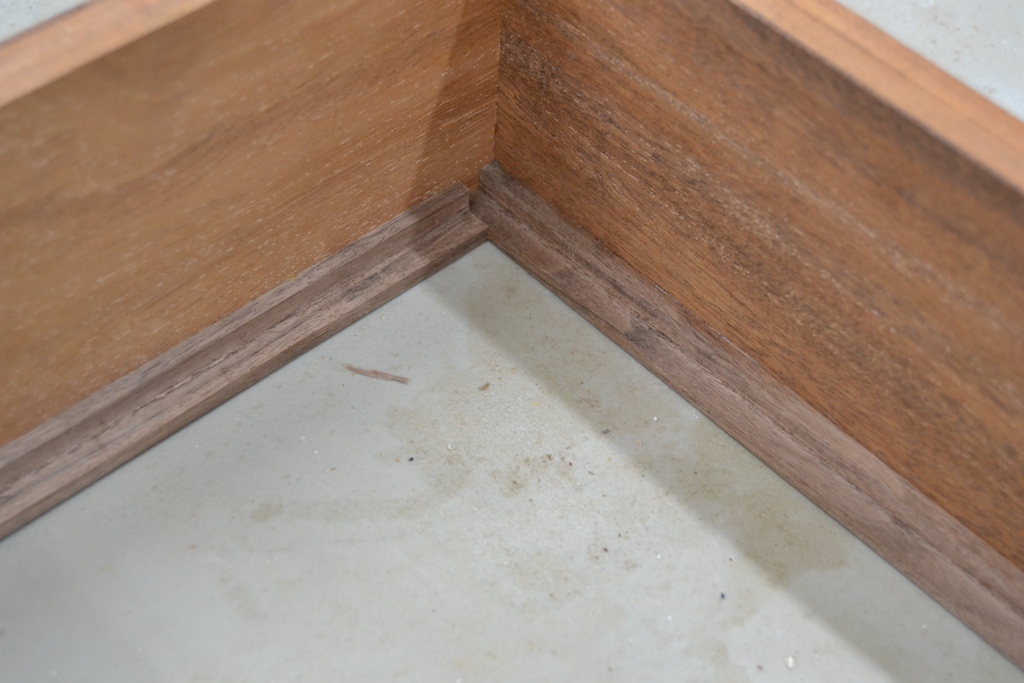

The underside of the framed top...
02 Top Underside.jpg (312.6 KiB) Viewed 5808 times

A look at the Rabbits where the flocked bottom panel will fit.
02 rabbits.jpg (264.28 KiB) Viewed 5832 times
I can't just throw anything together... I could have cut a panel, cut a square and nailed it to the bottom, but... no, not me.
