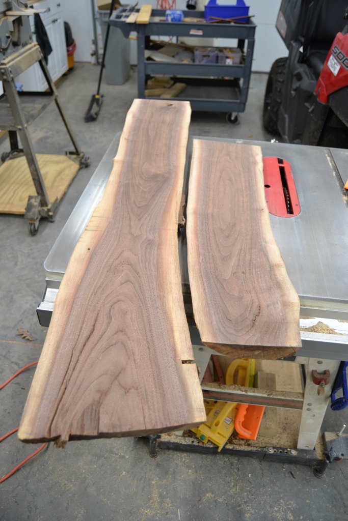

I worked for a while yesterday afternoon, after searching thru the boathouse barn converted to my wood storage. I found several treasures. I did find a couple nice pieces to make the frame pieces out of, and set up the power planer for the initial run, as this was a rough plank with bark still on the sides and one end about seven and a half feet long.
As I planed off the milling marks from the huge saw blade, and some remnants of bark on the end, the oddest thing occurred. Never seen it before. It appears that the bark has dyed the wood below in a very unique pattern. I cut off that end piece and will make a top for a box from it. I'll probably keep that box for myself. I'll be very careful in finishing the box, wouldn't want to cut thru this pattern while shaping...
unique cutoff.jpg (268.61 KiB) Viewed 4925 times
Anyway, processing the board was a long process, and required a number of passes thru the planer. In addition, there was a slight bend in the board toward the end, so I had to cut the long board and process it in two pieces to straighten it, without losing a lot of thickness. I will run this through the bandsaw and cut it into two or three boards then again to bookmatch those boards, as they frames are for aesthetics. They don't have to be really thick.
one board cut.jpg (319.98 KiB) Viewed 4925 times

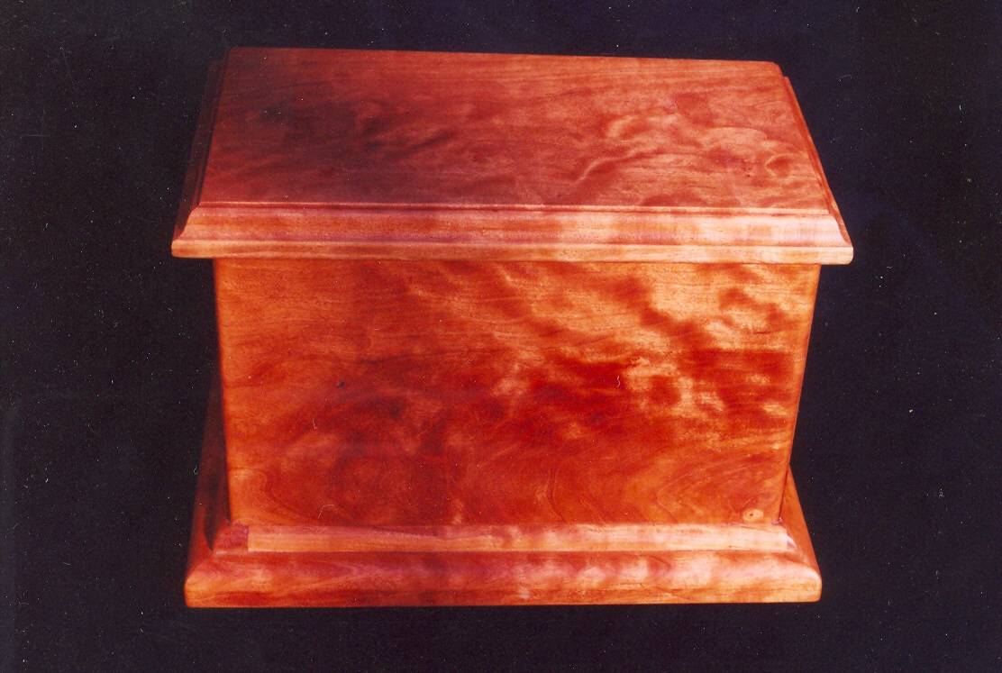

BTW... this is Miss Tina's Curly Cherry Jewelry Box I made for her years ago. The entire box is hand made, including all the trim. Took me weeks, as my job left me only a few hours each day to work on it.
curly cherry jewelry box 1.jpg (486.02 KiB) Viewed 4925 times

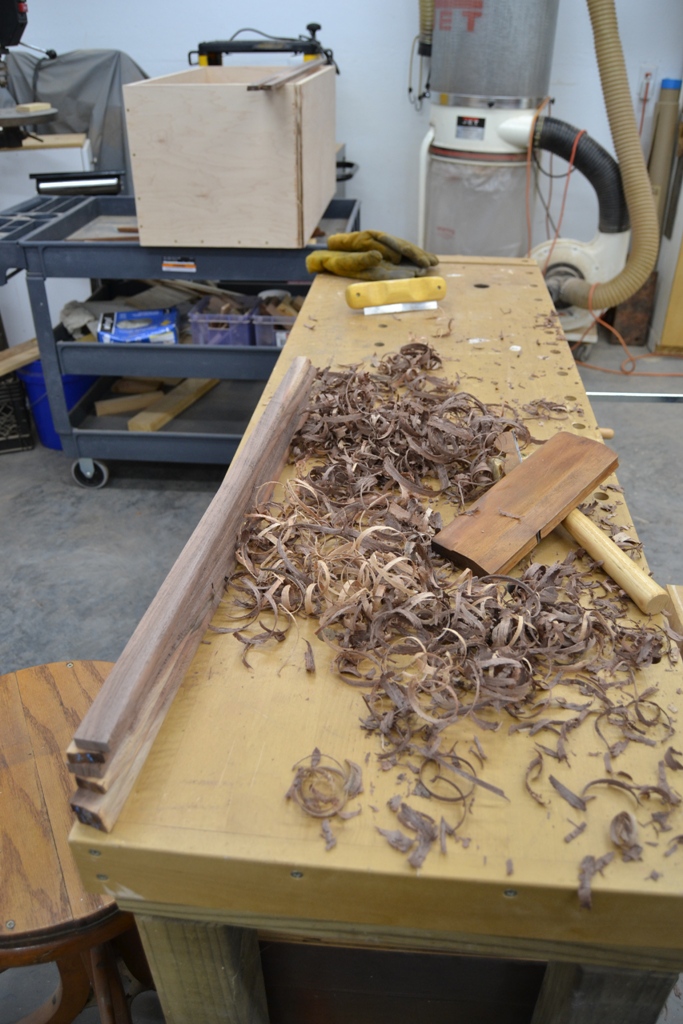

Before I could start the "actual" work, I chose my molding plane, pulled the iron and got out the diamond and water stones and got to sharpening. It was a touch up, but I spent about 45 minutes getting it just so. It is my Granddaughter's Toy Box after all. ;)
I put the first frame piece full length in the vice, clamped the loose end to the table for stability, and off we go.
02 working it.jpg (321.42 KiB) Viewed 4906 times
More cheating, see the chalked notes on the back of the long board on the work bench. There is actually a good bit on info here for me. The location of the chalk itself denotes the back of the board, the bad side. The arrow points to the Inside of the frame, and I know this long piece will become the top of the frame for the front of the box. The R stands for right side of the box as I look at it. The slash beside the R reminds me to square the end before making any measurements. The exact same notes appear on the board for the bottom of the frame section.
The molding plane does a nice job reworking the profile of the little boards, turning them into the frame material. It took me a while to figure them out, but even that journey was interesting and a pleasure. :lol:
03 love it.jpg (217.58 KiB) Viewed 4906 times
I use this classic molding plane more than any of the others, and usually in this format, just rolling the edge. However, if I roll it more into the cut, it will add a beaded edge, as we saw on the White Oak and Spalted Maple box I did earlier.
04 classic molding plane.jpg (275.21 KiB) Viewed 4906 times

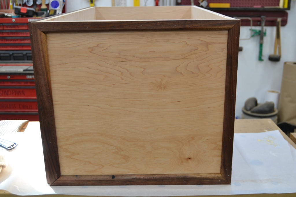

I began this morning's session by staining the "background" areas of the main box with Watco Natural oil.
But before that, as always, I took two scraps, a walnut and Maple Ply and made two test stain pieces, staining both with the Natural, Golden Oak, and Meduim Walnut Stains. My hope was that the Maple Ply would look GREAT with Medium Walnut, or that the Walnut would look Rich and Deep with the Golden Oak. :P No such luck. The Walnut, as expected, looked best with ... Medium Walnut Stain.
The Maple ply looked best with the Natural.
So, I marked the location of the framing pieces and stained inside the markings with a little overlap. I didn't want the oil where I needed to glue. Not a good idea. ;)
Watco Natural for the background.jpg (304.04 KiB) Viewed 4899 times
The next hour and a half was spent measuring, cutting, test fitting, trimming, test fitting, trimming, and then attaching - the framing for the front of the box. It turned out fairly well. The next session will be framing the sides.
framed with Watco Medium Walnut Stain.jpg (300.59 KiB) Viewed 4899 times

Then I took the plane, cut off the sharp edge of the corner sticking out and proceeded to round off the edges to make a rounded corner of both the added pieces, and then sanded all the frames as best I could.
Once this was done, I touched up all the stain and stood back to admire my work.
Next up is to work the enhancements and the top and hinges, and we'll be done. ;)
Another week?
Then it hit me...
Posted: Sat Dec 02, 2017 7:12 pm
by BrokenolMarine
I was tossing idea around in my head about what to put in that front panel, what would convey the message we wanted, but let Izzy know that Grumpy built her toybox all these years to come...? Then it hit me.
front enhancement.jpg (200.93 KiB) Viewed 4875 times
Yup, that should do it. I'll work on the high relief carving over the next few days or so. If it turns out okay, this will certainly do the job. :lol:
"Grumpy Says"
