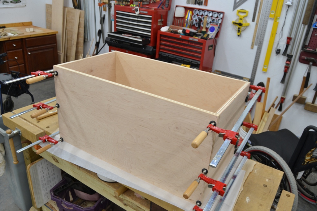

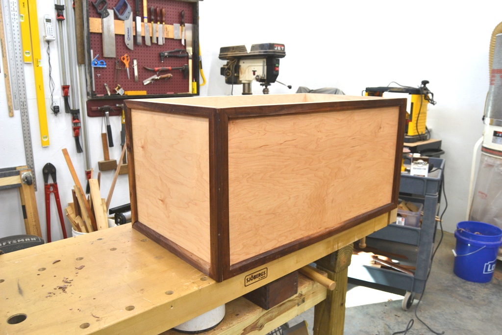

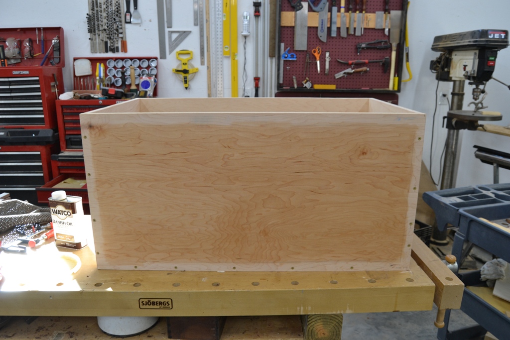

The pieces that Tina and I cut this morning, were all cut about 1/4" oversized, so that I could go back and run them across the tablesaw in the more manageable size and trim them to final size, then assemble the box. First, I put the box together on a dry run as a test fit.
basic box.jpg (313 KiB) Viewed 4950 times
Everything fit very well except I needed to shave about a 32nd of an inch off the bottom of the box so the right side would close up tight. Meh, ;) no matter. The bottom for this toy box fits inside the box, and is also made from 3/4 ply, mainly for weight. I want the box to be heavy and stable so I don't have to worry it will turn over on the "Little Princess" as it will also act as a bench seat in her room.
After final checks for fit and minor adjustments, I still went ahead while it was all clamped together and drilled positioning pins, two for each of the contact points, and put finishing nails in the holes ... :) The trimming of the bottom would have NO effect on the alignment, so the holes would still line up. Trimming would just allow the right side to pull in just a little tighter.
Each side was marked to match the corners and orientation, and then the pieces were pulled apart by pulling the nails, and I put down paper and waxed paper, and applied glue in the proper locations. (AFTER trimming the end of the bottom panel.) Then, one by one, each panel was reassembled, slipping the finishing nails back in the alignment holes and applying the clamps to draw the box up tight. I'll leave it overnight to dry, and then drill and countersink the necessary holes and screw the box together for additional strength. After all, a two year old will take possession at Christmas and once done, I'm hoping she will want to keep it a long time. :P
Glue Up.jpg (317.95 KiB) Viewed 4950 times
If you look below the top clamps, or above the bottom clamps on the front panel, you can see the alignment pins sticking out along the right and left edges... ;) Once I start screwing the box together, I'll pull the pins, countersink the holes and put screws in these holes as well. No worries.
The top of the box won't come into play again until the very end, as it was cut WELL oversized to allow it to be cut down to match the trim, and I'll add the backrest and side rails to the top AFTER the trim and accents are added to the box. 8-)

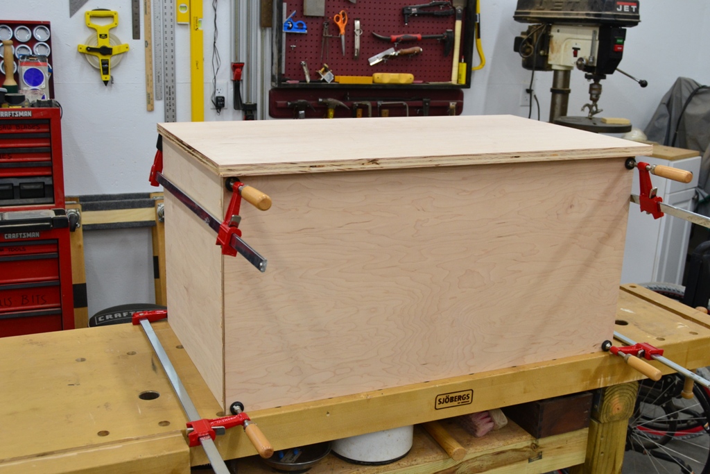

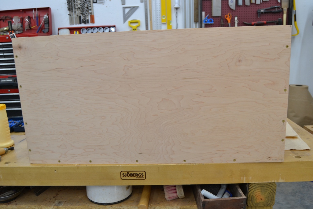

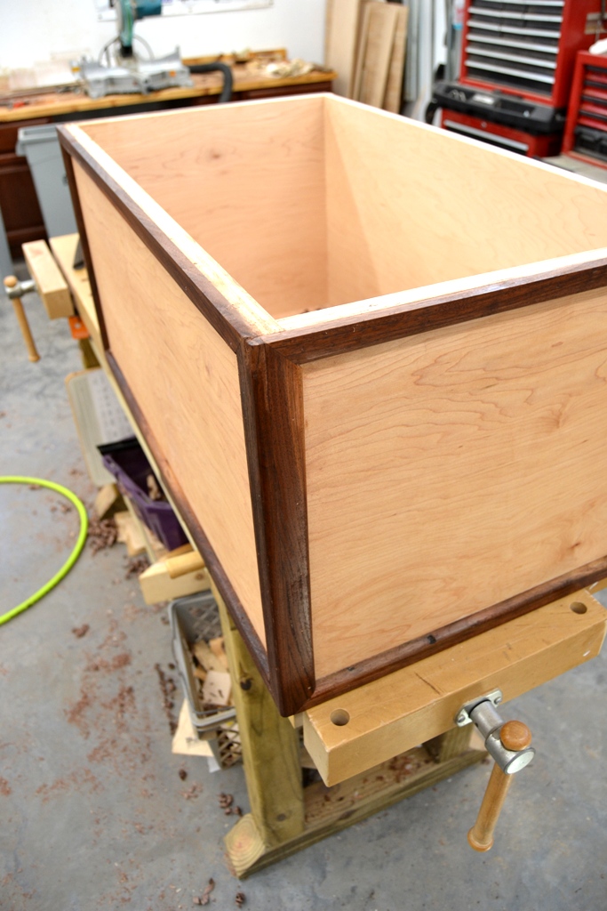

Got out in the shop this morning and back to work. Took off all the clamps and put them back where they belonged. Then drilled, countersunk and screwed the various holes so the box will be extra strong. Careful measuring using the pocket square made sure that none of the screws would break thru due to misalignment. :? Been there, done that. Extra work to patch the mistake and if you can't cover it up, you have to remake the piece or start over. :cry:
drilled and countersunk.jpg (261.96 KiB) Viewed 4929 times
If I wasn't going to hide the screws with the picture frame trim, I would have drilled counter sunk holes and used contrasting plugs for accent as I did in this project. The knotty pine cradle is beautifully accented with the walnut plugs which hide the screws giving the doll cradle strength enough to allow granddaughter number 3 to play with her heirloom cradle.

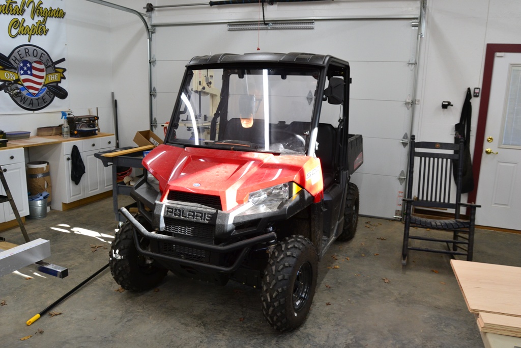

There is a visitor in the shop for the next few months. The Polaris Ranger will live there for a bit, it's gotten hard to start in the colder weather, but starts on the first turn of the key in the climate controlled shop. :) Like it's brokenolmarine pop, it hates the cold. Mostly, it's not in the way, if it is, I back 'er out and do what I have to, and pull it back in.
shop visitor.jpg (268.61 KiB) Viewed 4929 times
I put the remote for the garage door on the Ranger's Key ring, so it's not a problem to come and go to check the mail or run and check the property line if need be. The Ranger is my "farm" wheel chair. :lol:

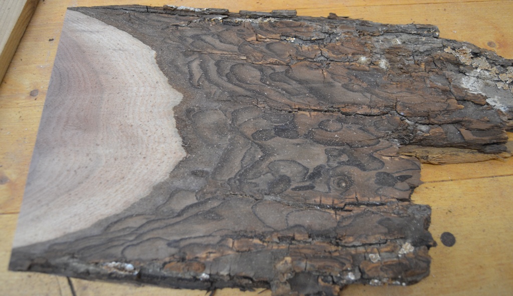

I worked for a while yesterday afternoon, after searching thru the boathouse barn converted to my wood storage. I found several treasures. I did find a couple nice pieces to make the frame pieces out of, and set up the power planer for the initial run, as this was a rough plank with bark still on the sides and one end about seven and a half feet long.
As I planed off the milling marks from the huge saw blade, and some remnants of bark on the end, the oddest thing occurred. Never seen it before. It appears that the bark has dyed the wood below in a very unique pattern. I cut off that end piece and will make a top for a box from it. I'll probably keep that box for myself. I'll be very careful in finishing the box, wouldn't want to cut thru this pattern while shaping...
unique cutoff.jpg (268.61 KiB) Viewed 4908 times

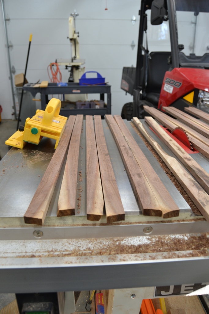

Anyway, processing the board was a long process, and required a number of passes thru the planer. In addition, there was a slight bend in the board toward the end, so I had to cut the long board and process it in two pieces to straighten it, without losing a lot of thickness. I will run this through the bandsaw and cut it into two or three boards then again to bookmatch those boards, as they frames are for aesthetics. They don't have to be really thick.
one board cut.jpg (319.98 KiB) Viewed 4908 times

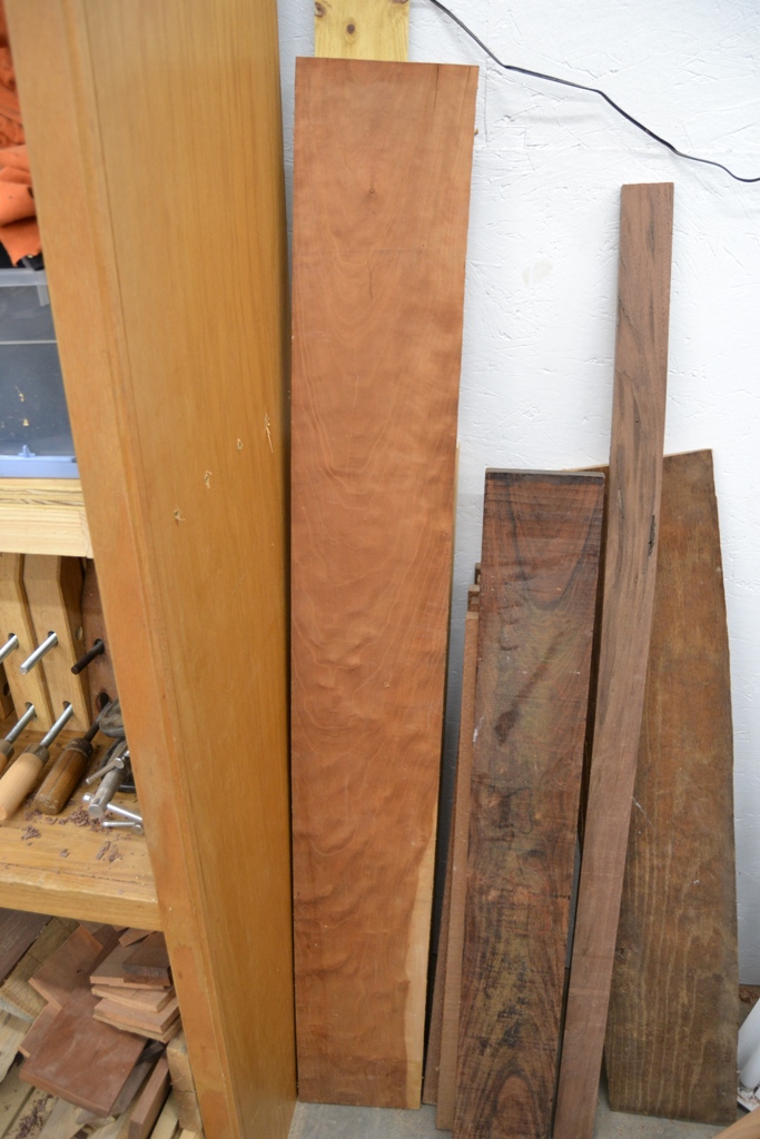

I did find two other beautiful treasures hiding in the wood storage. (three actually.)
A piece gorgeous Curly Cherry, 4' x 6" one inch thick... (on the far left)
and a piece of Cocobolo 3' x 5-1/2" one in thick. cocobolo is highly prized for gun stocks, pistol grips, and knife scales. This piece is highly figured.
(to the right of the curly cherry board)
curly cherry 4x6.jpg (296.8 KiB) Viewed 4908 times

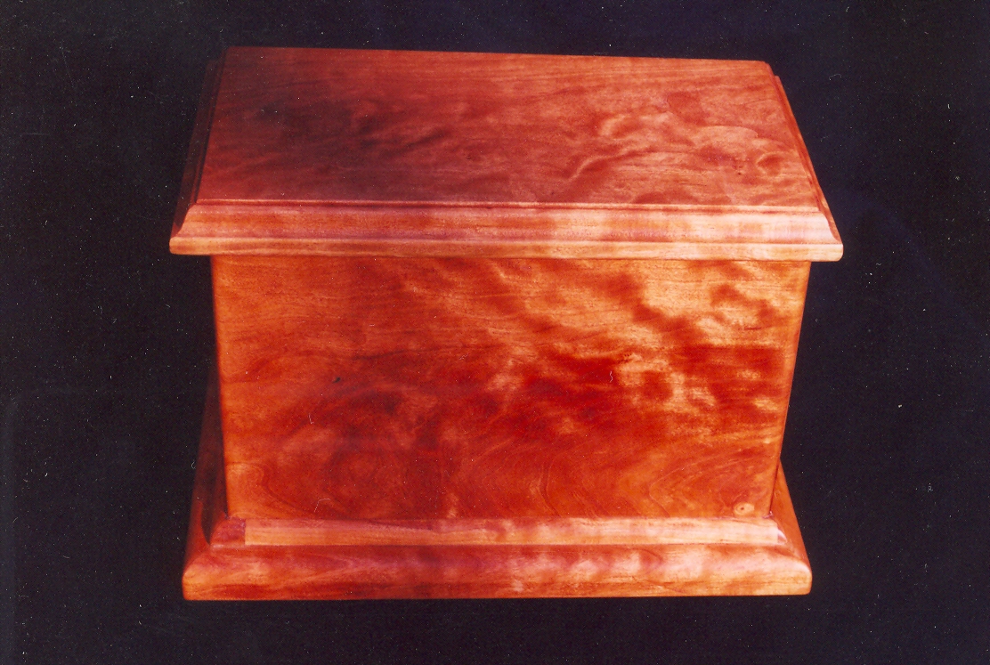

BTW... this is Miss Tina's Curly Cherry Jewelry Box I made for her years ago. The entire box is hand made, including all the trim. Took me weeks, as my job left me only a few hours each day to work on it.
curly cherry jewelry box 1.jpg (486.02 KiB) Viewed 4908 times

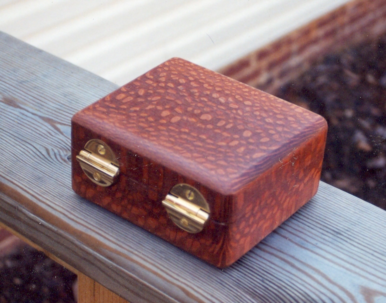

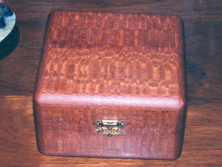

She didn't order that box, but she did order one of these made from Australian Lacewood. It wasn't cheap, but I priced it very fair for her.
She wanted it to keep her recently deceased Father's personal items in.
lacewood box front.jpg (241.94 KiB) Viewed 4908 times
lacewood box rear.jpg (268.94 KiB) Viewed 4908 times

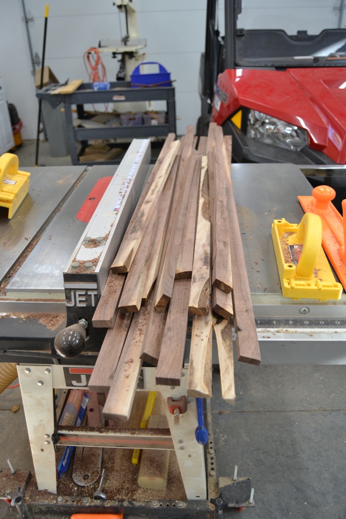

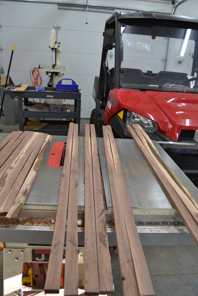

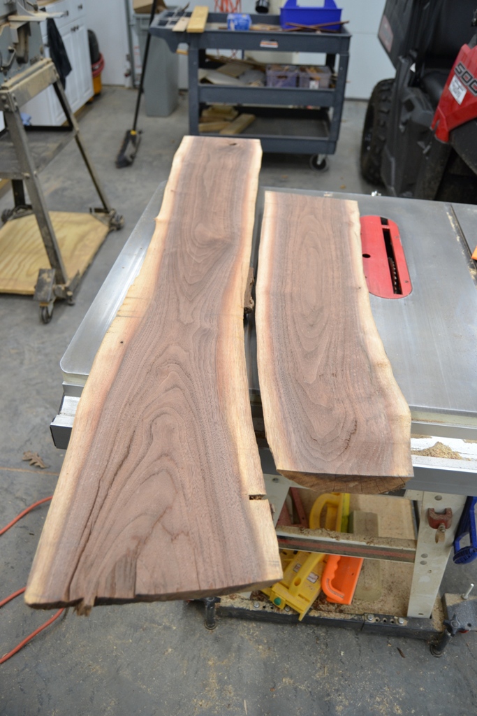

Spent a couple hours in the shop this morning, working my way thru the two boards I planned to use as framing on the toy box. Once I got out there, I rethought my plan, and drew a line down the side of each board to give me a straight edge, and then ran both across the table saw until I had a collection of 1/2 inch thick boards.
Here is the pile of processed boards.
01 processed.jpg (331.48 KiB) Viewed 4903 times

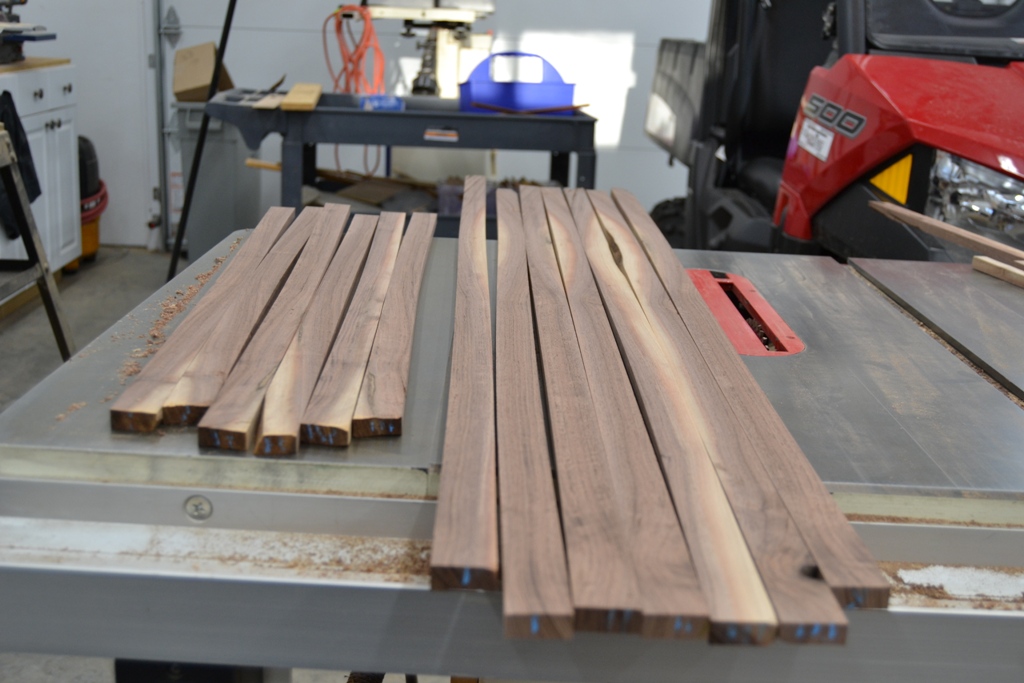

I sorted through them and tried to match the book matched boards, matching the long boards and the shorter boards so I had good pairs.
02 front.jpg (319.27 KiB) Viewed 4903 times
03 side.jpg (294.63 KiB) Viewed 4903 times
Yup, there is some bend in those puppies, but when I attach them, they will be flexible enough to pull into alignment and POW, tack into place til the glue dries. :) We adapt and overcome. :twisted:
Next session I will run these thru the planer to take off the roughness.

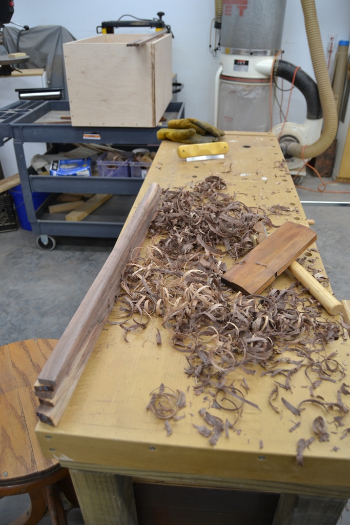

Went out and got busy again. Waiting for me was the work from yesterday, all lined up on the table saw table, all shined up, sorted and ready to go.
01 dressed and ready.jpg (266.18 KiB) Viewed 4889 times
Note the cheat marks at the bottom of the pairs. The chalk marks tell me a couple things. The matched pairs and the orientation. They are only on ONE end, so I know which ends go together with the pairs.

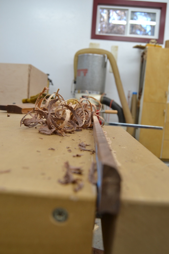

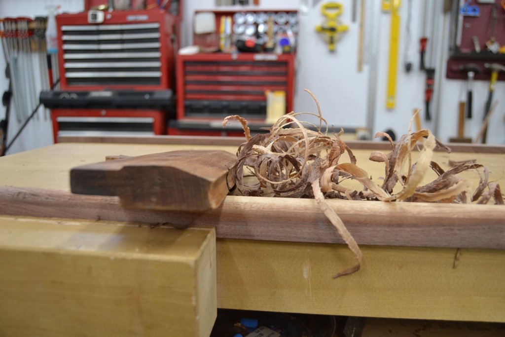

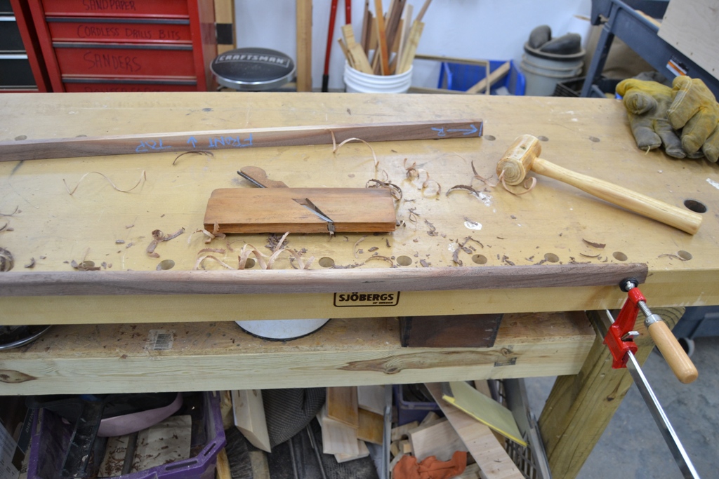

Before I could start the "actual" work, I chose my molding plane, pulled the iron and got out the diamond and water stones and got to sharpening. It was a touch up, but I spent about 45 minutes getting it just so. It is my Granddaughter's Toy Box after all. ;)
I put the first frame piece full length in the vice, clamped the loose end to the table for stability, and off we go.
02 working it.jpg (321.42 KiB) Viewed 4889 times
More cheating, see the chalked notes on the back of the long board on the work bench. There is actually a good bit on info here for me. The location of the chalk itself denotes the back of the board, the bad side. The arrow points to the Inside of the frame, and I know this long piece will become the top of the frame for the front of the box. The R stands for right side of the box as I look at it. The slash beside the R reminds me to square the end before making any measurements. The exact same notes appear on the board for the bottom of the frame section.
The molding plane does a nice job reworking the profile of the little boards, turning them into the frame material. It took me a while to figure them out, but even that journey was interesting and a pleasure. :lol:
03 love it.jpg (217.58 KiB) Viewed 4889 times
I use this classic molding plane more than any of the others, and usually in this format, just rolling the edge. However, if I roll it more into the cut, it will add a beaded edge, as we saw on the White Oak and Spalted Maple box I did earlier.
04 classic molding plane.jpg (275.21 KiB) Viewed 4889 times
After about two hours in the shop, I was done with this phase, and for the day. I think I'll be cutting and fitting tomorrow. We'll get a better idea of the complimentary woods together and a good look as the box is really starting to take shape. (Hopefully.... :roll: ;) ) Knock on wood.... get it.. .wood. :oops:

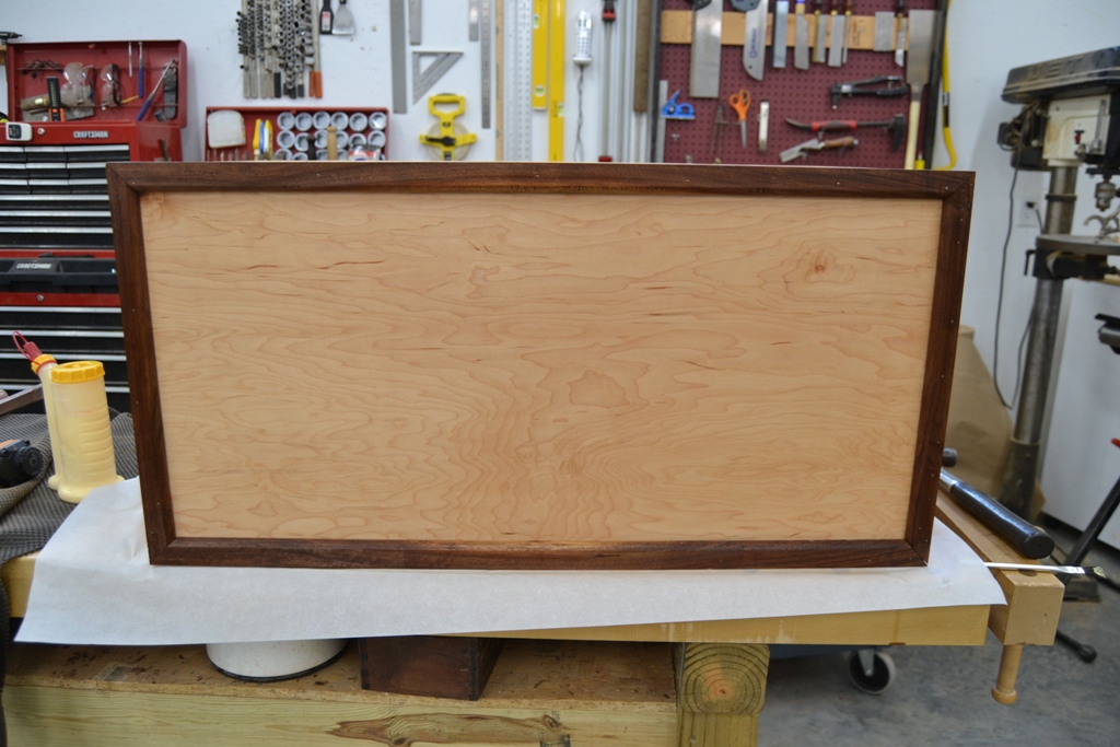

The next hour and a half was spent measuring, cutting, test fitting, trimming, test fitting, trimming, and then attaching - the framing for the front of the box. It turned out fairly well. The next session will be framing the sides.
framed with Watco Medium Walnut Stain.jpg (300.59 KiB) Viewed 4882 times

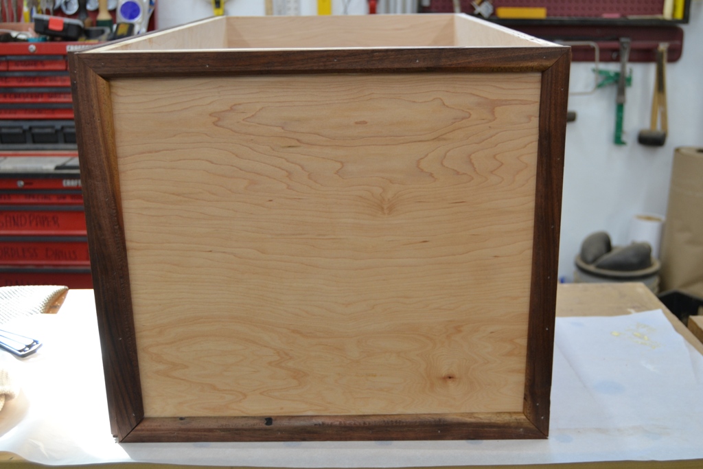

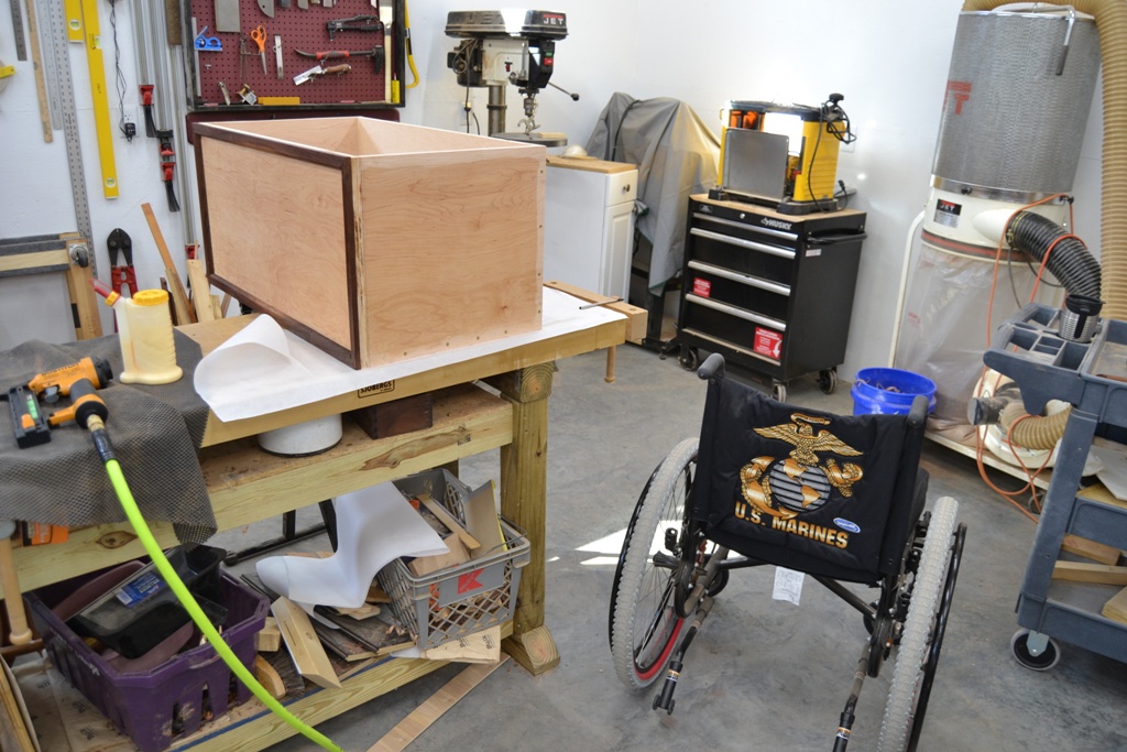

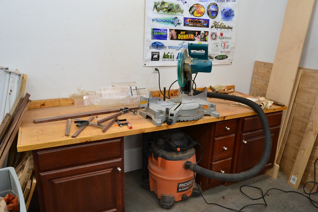

I do a lot of my work with hand tools, but ... I still use some of the power tools as the weather has aggravated ARTHUR and he is not friendly. :evil:
This process used the Chop saw a lot. Measure, Cut, trim and test fit, trim and test fit. :lol:
03 chop saw table.jpg (266.51 KiB) Viewed 4876 times

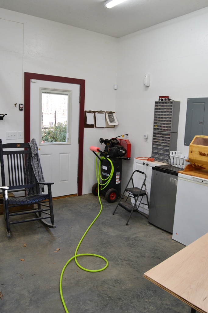

I used the Dewalt Brad Nailer to reinforce the glue til it set and powered it with the oil cooled large compressor in the corner... larger capacity and a LOT quieter than the pancake compressor I used to use in the old shop.
04 Air source.jpg (282.97 KiB) Viewed 4876 times

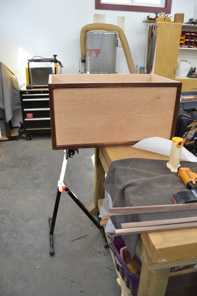

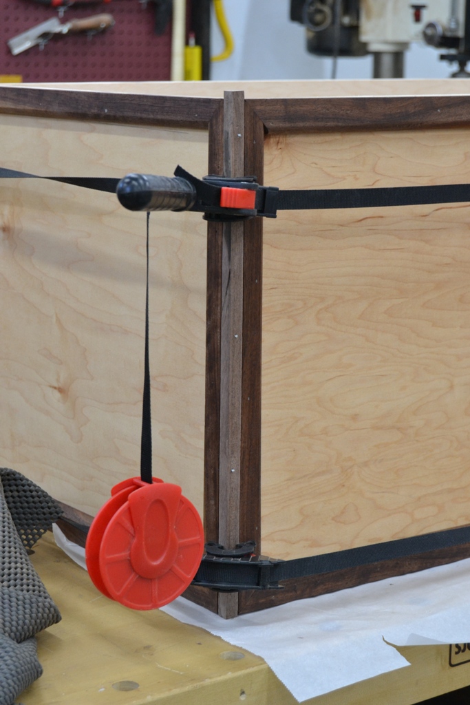

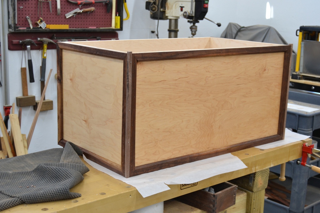

After a couple hours rolling back and forth between my stations, staining EACH piece before installation.... they are pretty much done.
05 framing done.jpg (249.05 KiB) Viewed 4876 times

When I said it had put the pieces in to round the corners, it probably didn't mean much... but maybe this picture will help.
Since I didn't make some of the framing material overly wide to overlap an edge, there was a gap at the front corners, a half inch or so. After it was all finished, I put a square piece of walnut in the two corners, glued and shot it them place, put a couple band clamps around it and left them til morning to set.
Came out this morning and took the clamps off, and got ready to work 'em.
There was work to do. First the nail sets drove the brads deeper, didn't want to ruin my iron in the plane.
Then I took the plane, cut off the sharp edge of the corner sticking out and proceeded to round off the edges to make a rounded corner of both the added pieces, and then sanded all the frames as best I could.
Once this was done, I touched up all the stain and stood back to admire my work.
Next up is to work the enhancements and the top and hinges, and we'll be done. ;)
