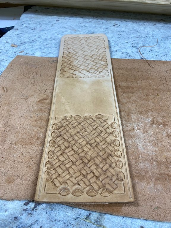

A bit of work on the new pouch on Monday. I tooled the front panel area and then cut the stitching grooves down both sides of the main panel. That is always a pucker factor for me and I go slow and steady, but a slip... :? ... and you are starting over. To determine where to cut the grooves you wrap the main panel around the side panel and mark the end point. I'll add accents in the corners later. Still need to burnish the sides.

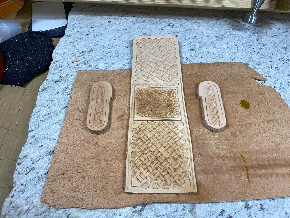

Have a new stamp and used it to add accents. Not perfect, but these are the side panels, and after I do the backgrounding, they won't look too bad. ;) Antiquing and the rest will blend my errors out. :roll: We can only hope. It's an ammo pouch, not a Bespoke Wallet. Sigh. (I keep telling myself that.)

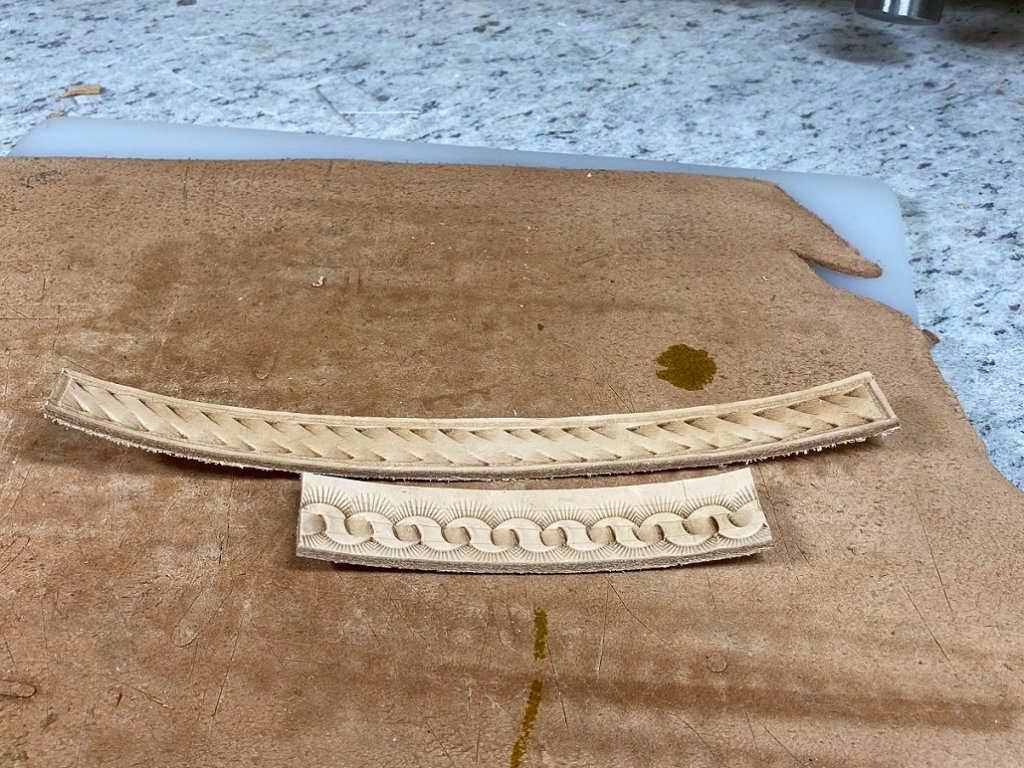

While the dye was drying, I took a couple pieces of scrap and practiced some border patterns. Not perfect by a long shot, but getting there. The top one is a ROPE pattern, and the bottom is the Ribbon pattern.

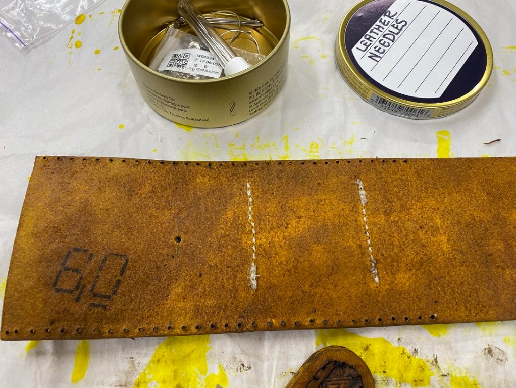

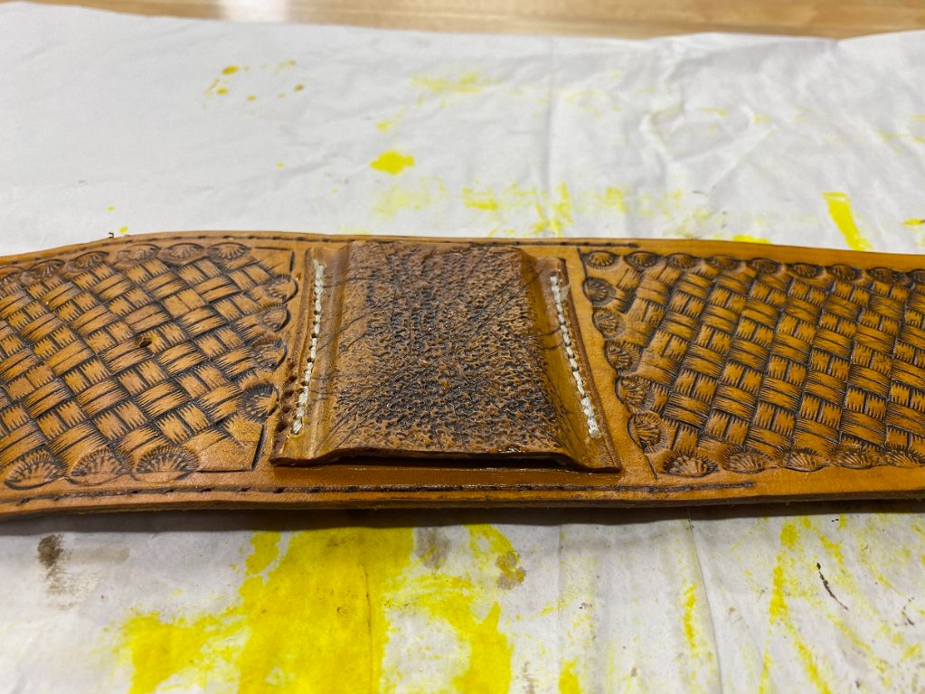

Finally time to break out the Cowboy and sew down the belt loop. Before I started sewing, I checked the bobbin. :evil: Nearly empty. I am new to sewing and this new machine, so I had to read the procedure for loading up bobbins. Then I figured, if I was loading up one, might as well load up them all. ;)
There were eight. I filled five with the white thread and three with as most of my projects will be sewn in white. After that delay, it was time to sew down the belt loop. I used a scrap of belt in the slot to make sure I got it tight up against it, and sewed 'er down. Not bad for an amateur.

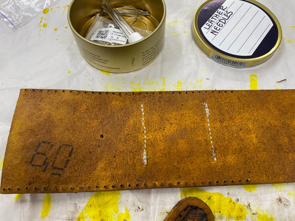

Next on the agenda was to punch the hole for the post for the closure strap. I had to remark the location, as the dye had obscured the first mark. No problem, recalculated the location and make a pencil mark to locate the hole, punched it. I didn't install the post yet, waiting a bit.

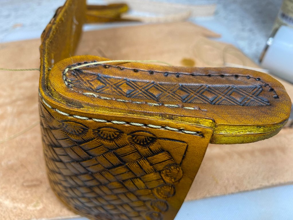

The time had come to begin sewing and I had purchased curved needles, sure they would make the task easier. I threaded a pair of large curved needles and started. :evil: Ah, nope, what a pain. Went to the smaller pair thinking they would be perfect. ;) What a disappointment. Didn't work any better. Threaded back the original short straight needles and got to work. For the most part, the project went well. The curves... sucked.
:twisted:
18 strain.jpg (150.28 KiB) Viewed 11588 times
I got about halfway thru the sewing and had to take a break, my back, neck, and shoulders were whining like six year olds who missed their naps.
I got back to it late in the afternoon and picked back up, knocked out more sewing but forgot my phone. More pics and an update to follow.

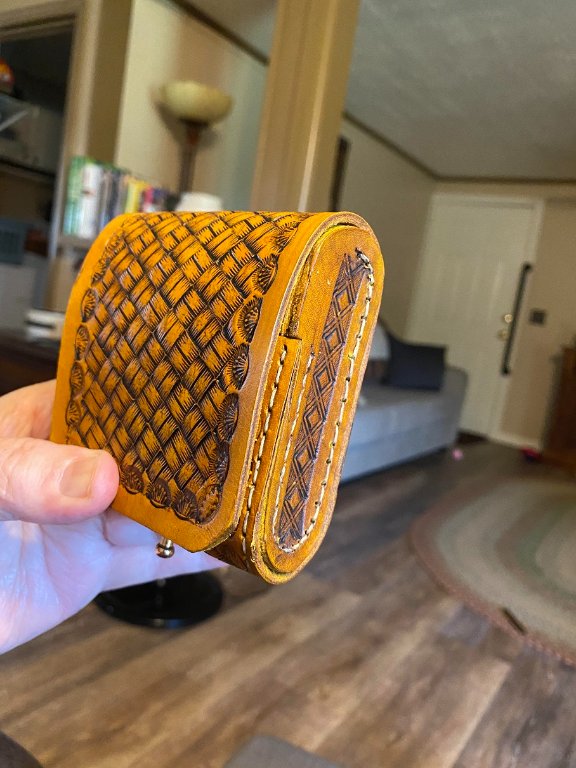

Waiting for a return call from the VA so I had to stay inside. The metal building where the shop is blocks the cell phone and the house phone signals. I brought the pouch inside and finished the hand sewing in my recliner. The closure strap and the minor cosmetics will have to wait, but this gives you an idea of the finished project. I am pretty happy with 'er. :P
A quarter view. You can see the post for the closure centered on the bottom. ;) :

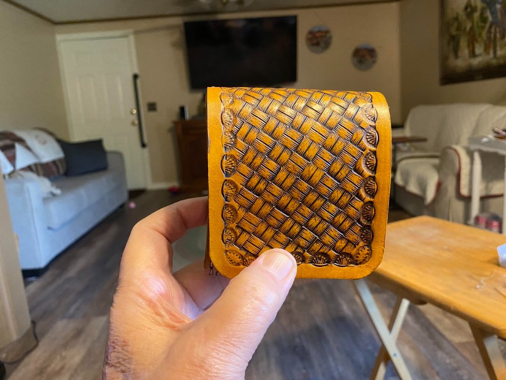

A nice front view.
