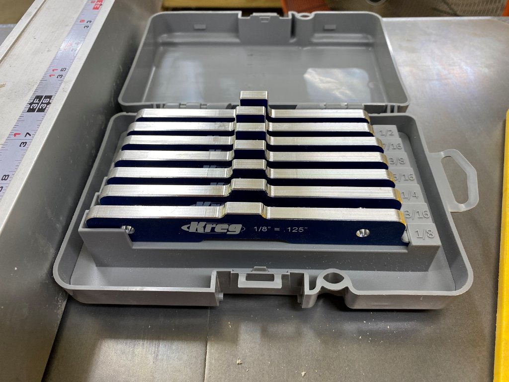

I would have a rabbit on the back of the board for the back panel, come in a bit for the mid panel where Miss T would quilt the padded background where the uniform shirt, pants, and socks would be displayed, and then off set from the front, would be the glass. I would use the Dado blade to cut the dados for the rabbit and the mid dado for the quarter inch luan back and mid panels, then the table saw 3/32" blade to cut the dado for the glass. I will cut these on both sides of the two boards I have cut to the 30 and 36 inch lengths, then rip them up the middle as it's safer to work with the wider boards.
I will make two passes for each pair of dados on each board, one pass at 1/4" depth and another at the final depth at 3/8 inch. That makes for a cleaner cut and it's easier to cut the dados in the harder woods this way. Oak counts as a harder wood. To set the depth for the pass I use the Kreg setup bars.
03 kreg setup bars.jpg (130.71 KiB) Viewed 5695 times
These are really helpful tools in the shop and useful three ways. You can measure the height of the router bit, saw blades etc, the depth of a cut, or the distance off a fence by the thickness of the bar.
04 set depth.jpg (125.94 KiB) Viewed 5695 times

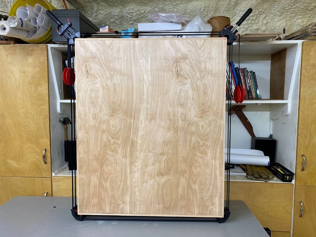

I test fit the frame using band clamps. (Not Band Camp, that's another story...and a great movie.) A front view shows the mid panel in the shadow box.
08 front view.jpg (160.67 KiB) Viewed 5695 times
Rear view shows the rear panel in it's place.
09 back view.jpg (163.2 KiB) Viewed 5695 times

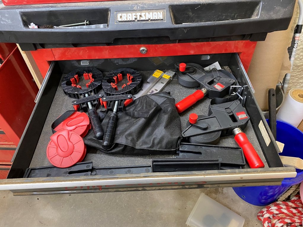

Got back out in the shop today, and back at it. The first step was to disassemble the temporary test fit. First I removed the two band clamps and recoiled them for storage. I like to keep all my tools neat, so they are ready for the next use.
01 band clamps.jpg (158.12 KiB) Viewed 5068 times
Next, they go back in their home in the Band Clamp drawer.... if I put things away, I know where they are the next time I need them. When I had that Tiny shop, 12x20 Amish wooden building, it was doubly important, or I spent great amounts of my shop time looking for items in the clutter.

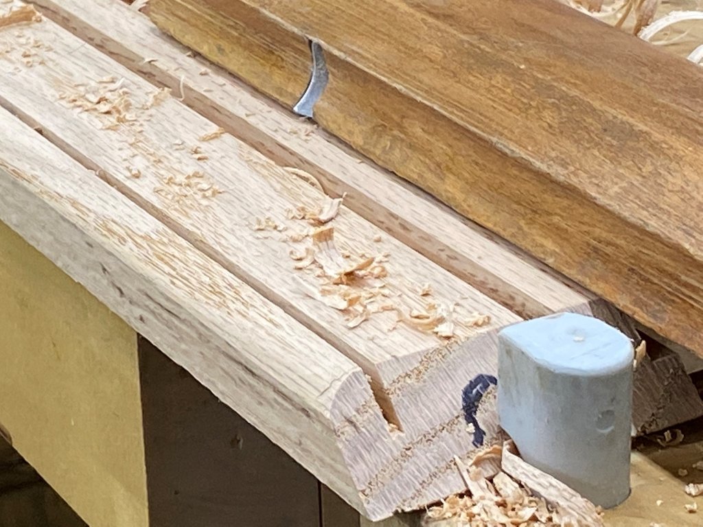

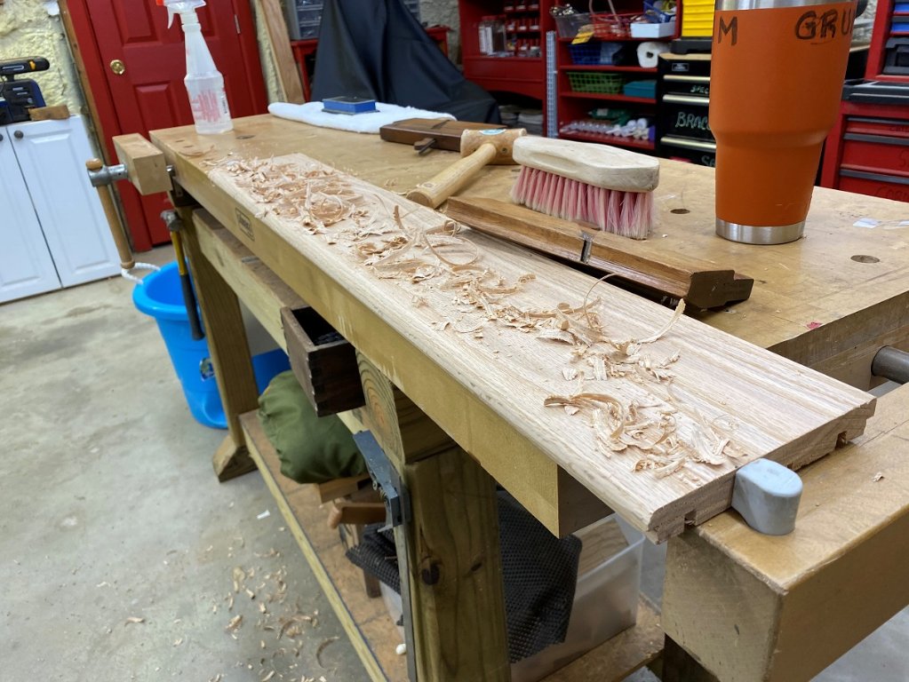

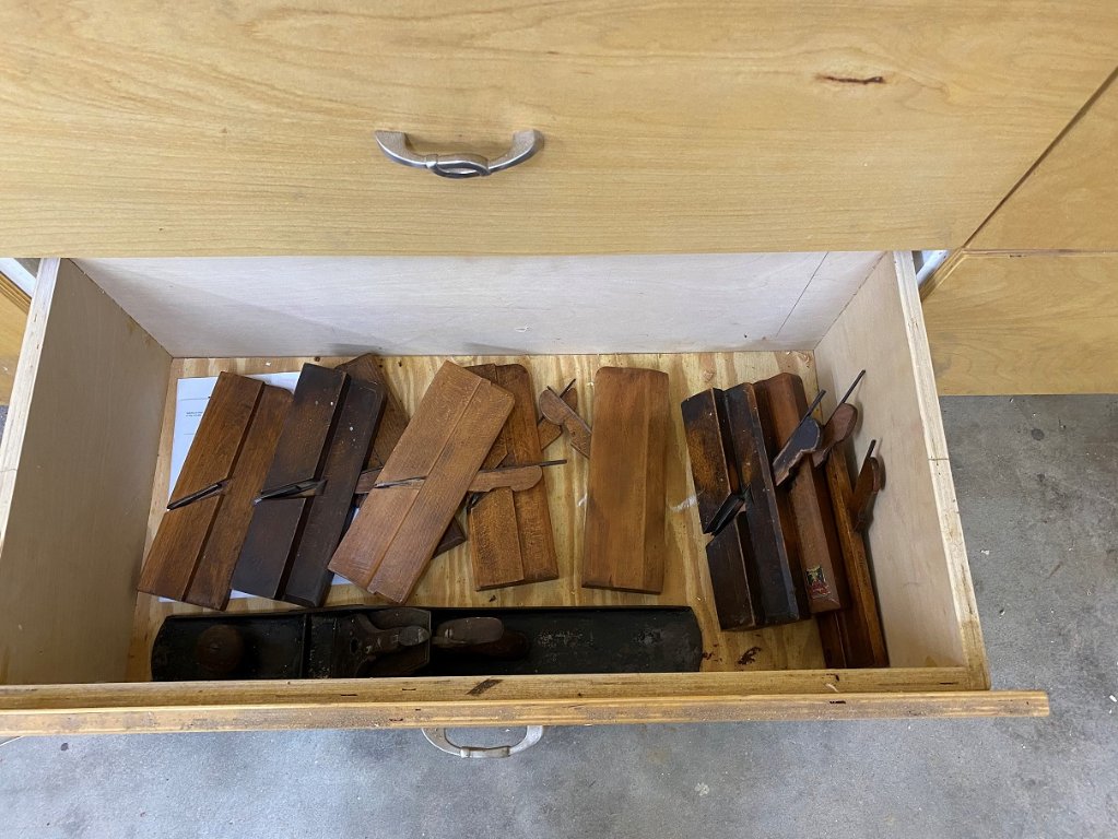

The next thing to do is prepare to use the molding planes. I have a drawer with a dozen or so antique molding planes I got from Lee Valley. I love these things, and use them whenever I can instead of a router. Less noise, less mess, and pride in using the hand tools ... Plus I love the sound they make when properly set up.... a soft whisk.
04 molding planes.jpg (151.07 KiB) Viewed 5067 times
The first step is to sharpen the old iron in the plane you have chosen... I just sharpen the flat side. As long as you haven't dinged up the off side, that's all it takes. I don't have to use the waterstones like I would on the regular planes and chisels, the diamond stone and leather strop gets the job done.
05 before you start.jpg (104.31 KiB) Viewed 5067 times
What? My Yeti Cup? A gift from my Wife and Daughter for the shop.... it says, "This is my Happy Face." My Grandkids call me "Grumpy."
06 grumpy yeti.jpg (80.14 KiB) Viewed 5067 times
Once the plane was tuned, I make a few passes on a scrap of the same wood the frame is made from, made some adjustments, then made a few more passes. Stropped the iron, and we were ready to go.
07 testing.jpg (155.16 KiB) Viewed 5067 times

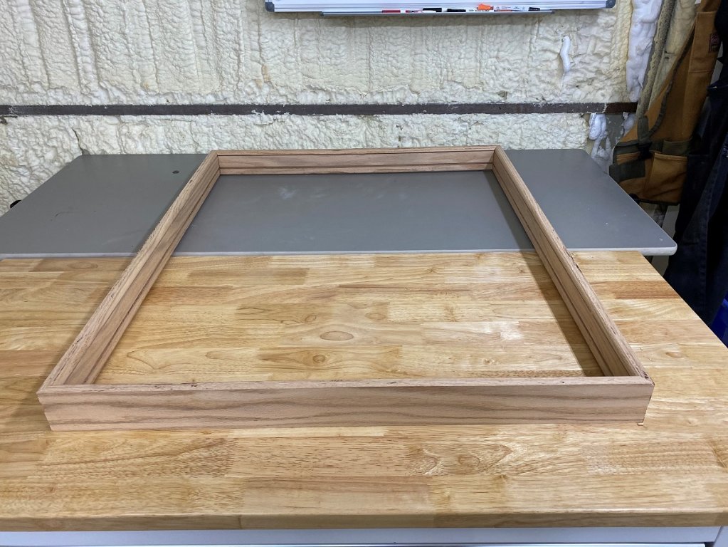

I worked the edges of the four sides of the frame that were adjacent to the dado for the glass, rolling the edge to a pleasant shape. This is NOT done with a special bit in the router but by hand and eye. I will touch up any uneven spots with a sanding block, and really, only I will see the difference unless some other woodworker is critiquing my work hanging on the wall. ;)
08 working the pieces.jpg (160.38 KiB) Viewed 5067 times
I took my time, made light passes letting the sharp plane do the work. If you force it, or try to muscle the old planes they tend to dig in. The blade is barely protruding from the mouth of the plane. I start with the plane angled 45 degrees off the flat sides and make a couple shaving passes, then angle back one way or the other on each consecutive pass, until the shape is done.
09 all four done.jpg (205.56 KiB) Viewed 5067 times
It may be a bit hard to see here, but I think they turned out well. Now I will have to sharpen the card scrapers and get busy smoothing the inside and outside faces. Final smoothing will be done with a sanding block, but if the card scraper does it's job, there will be very little to sand.

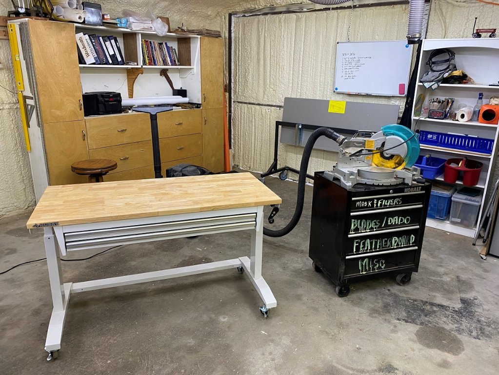

Since we have some time, I thought you might like a tour of the new shop, sorta. I will turn to the right, making a complete turn. Feel free to ask questions.
11 shop tour 1.jpg (212.98 KiB) Viewed 5067 times
12 shop tour 2.jpg (205.8 KiB) Viewed 5067 times
13 shop tour 3.jpg (202.83 KiB) Viewed 5067 times
14 shop tour 4.jpg (222.52 KiB) Viewed 5067 times
15 shop tour 5.jpg (237.2 KiB) Viewed 5067 times
16 shop tour 6.jpg (214.31 KiB) Viewed 5067 times
stepping thru the red door, puts you in the boathouse and storage area, and leads to outside. The big door in the woodshop has been sealed for the winter. I'll cut that door vertically and make a 3' and 6' door that opens like a hinged batwing door in the spring so it can be made to seal better and not leak. As the side rolling door it is now it was a sieve. Spray foam stopped that.
17 boathouse and storage.jpg (191.42 KiB) Viewed 5067 times
The kayaks and trailer, mower, and things like the clamp rack and other large rarely used tools are stored in the boathouse. This side is unheated. I WILL sprayfoam this later as well....
