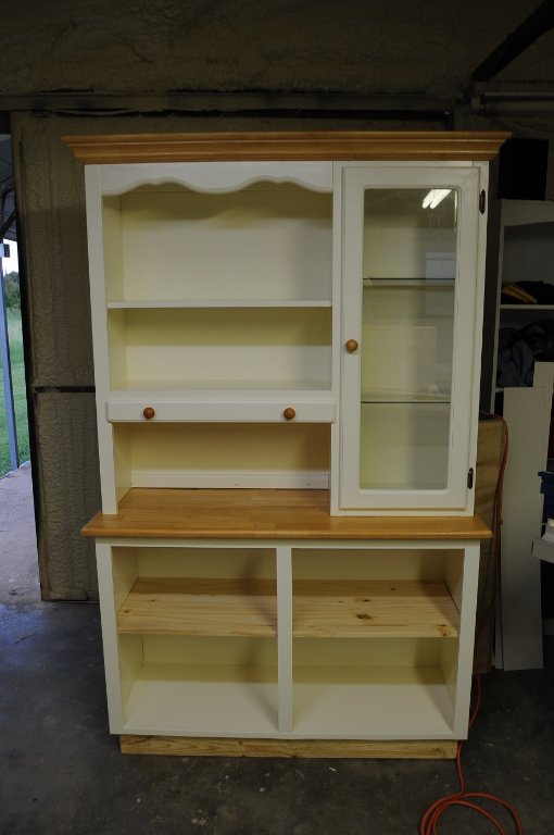

Here is a peek at the restored cabinet HE was hauling to the dump. We replaced the back, removed and discarded the drawers and cabinet doors, and replaced the bottom 4" due to severe water damage. Tina painted it when I finished with my repairs. The front was framed for cabinets and drawers, I removed that and reframed it to accommodate the shelving. She was really happy with the modifications.

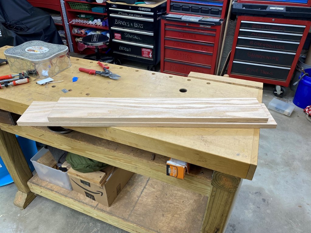

Once the boards were cut to length, I used one for the layout, carefully working out the various measurements for the spacing of the dadoes.
02 cut to length.jpg (176.31 KiB) Viewed 5112 times
I would have a rabbit on the back of the board for the back panel, come in a bit for the mid panel where Miss T would quilt the padded background where the uniform shirt, pants, and socks would be displayed, and then off set from the front, would be the glass. I would use the Dado blade to cut the dados for the rabbit and the mid dado for the quarter inch luan back and mid panels, then the table saw 3/32" blade to cut the dado for the glass. I will cut these on both sides of the two boards I have cut to the 30 and 36 inch lengths, then rip them up the middle as it's safer to work with the wider boards.

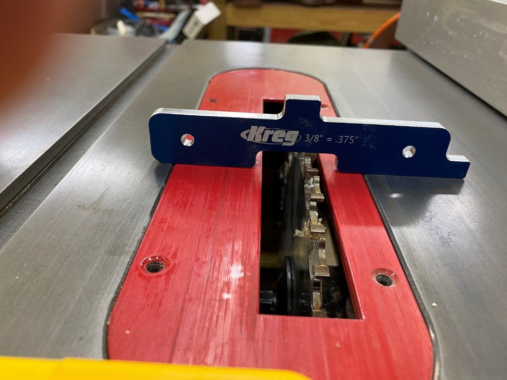

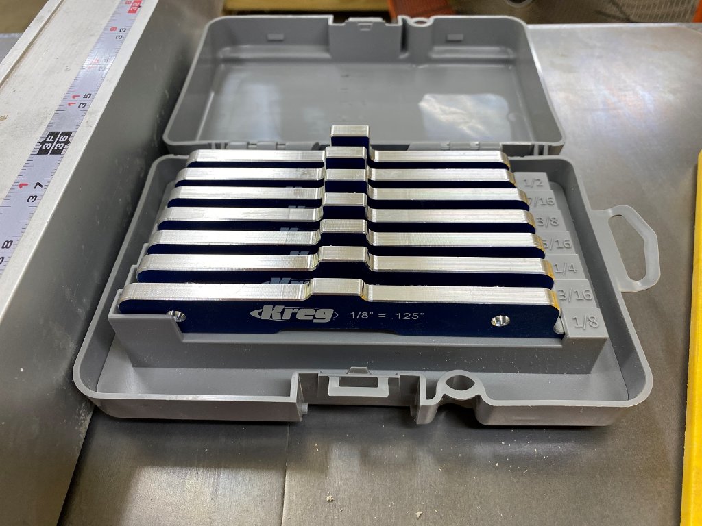

I will make two passes for each pair of dados on each board, one pass at 1/4" depth and another at the final depth at 3/8 inch. That makes for a cleaner cut and it's easier to cut the dados in the harder woods this way. Oak counts as a harder wood. To set the depth for the pass I use the Kreg setup bars.
03 kreg setup bars.jpg (130.71 KiB) Viewed 5112 times

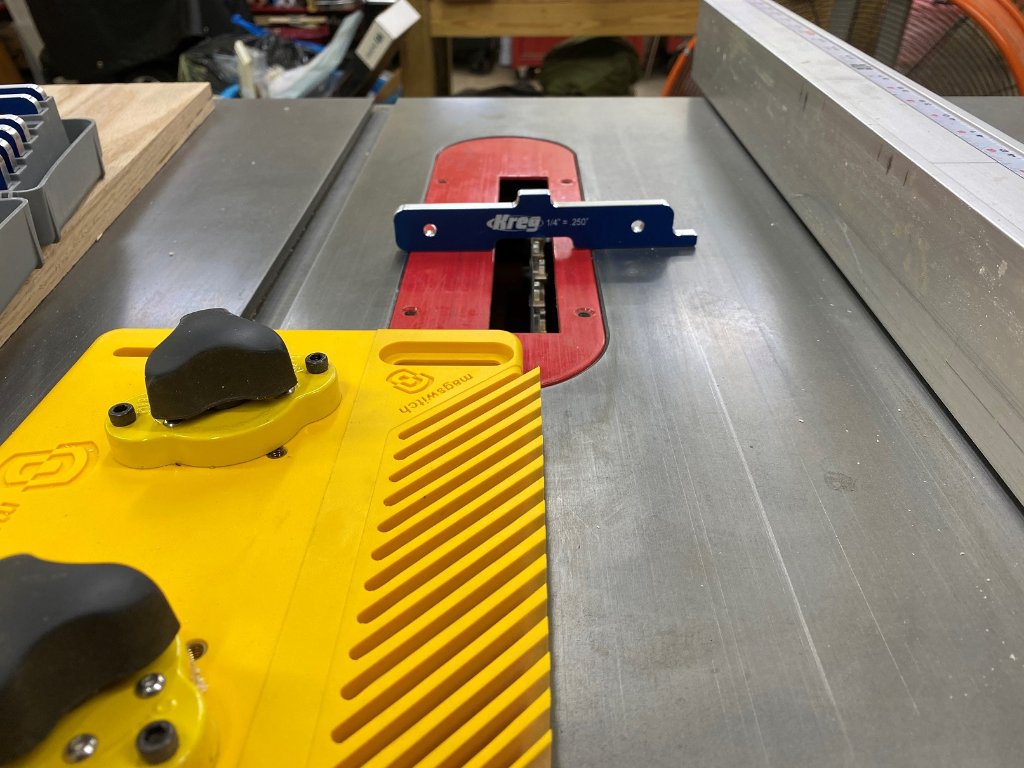

These are really helpful tools in the shop and useful three ways. You can measure the height of the router bit, saw blades etc, the depth of a cut, or the distance off a fence by the thickness of the bar.
04 set depth.jpg (125.94 KiB) Viewed 5112 times

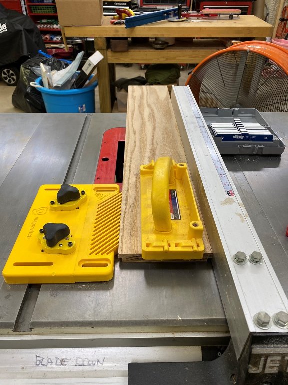

I got the table saw setup for passes by setting the depth and the fence distance, then placing a featherboard against the workpiece to insure it stays tight against the fence as I feed it into the blade.
05 setup for passes.jpg (129.92 KiB) Viewed 5112 times
Always safety first, as the table saw can hurt you. This push block has tabs that drop down to grab the back of the piece as you feed the oak across the dado blade. NO fingers or thumbs hanging behind the wood to touch the spinning blades.
06 safety first.jpg (102.78 KiB) Viewed 5112 times

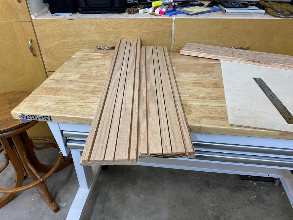

After a number of passes across the two blades, all the cuts were made. They turned out as planned.
07 dados done.jpg (157.72 KiB) Viewed 5112 times

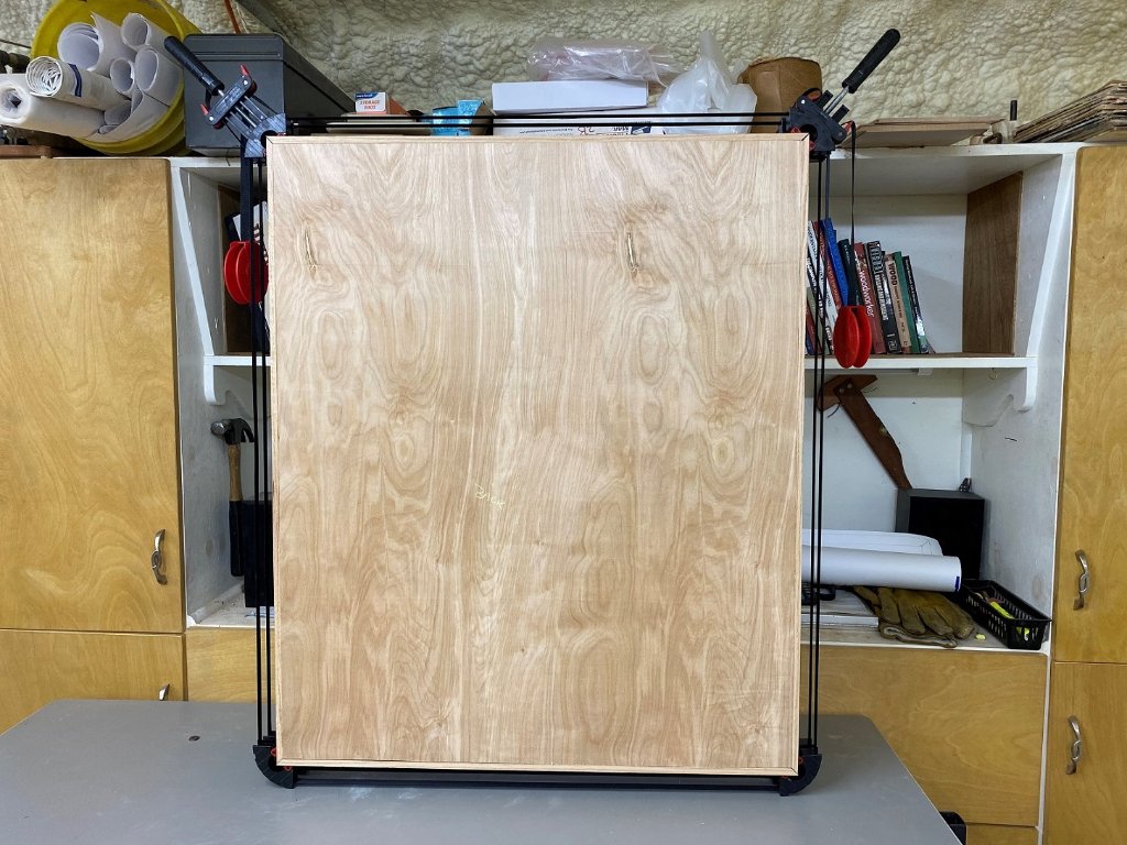

I measured VERY carefully, measured again. Then one last time and set the fence up and ripped them in half. HUGE sigh... I set them aside and cut the back and mid panels. Sweet.
I test fitted the panel to the dado, and it fit. Then it was a matter of marking the length and cutting the 45 degree angles. Whew! Wonders never cease.

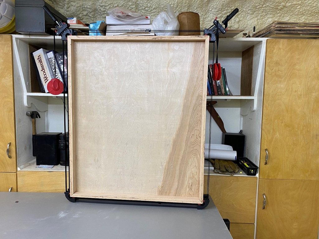

I test fit the frame using band clamps. (Not Band Camp, that's another story...and a great movie.) A front view shows the mid panel in the shadow box.
08 front view.jpg (160.67 KiB) Viewed 5112 times
Rear view shows the rear panel in it's place.
09 back view.jpg (163.2 KiB) Viewed 5112 times

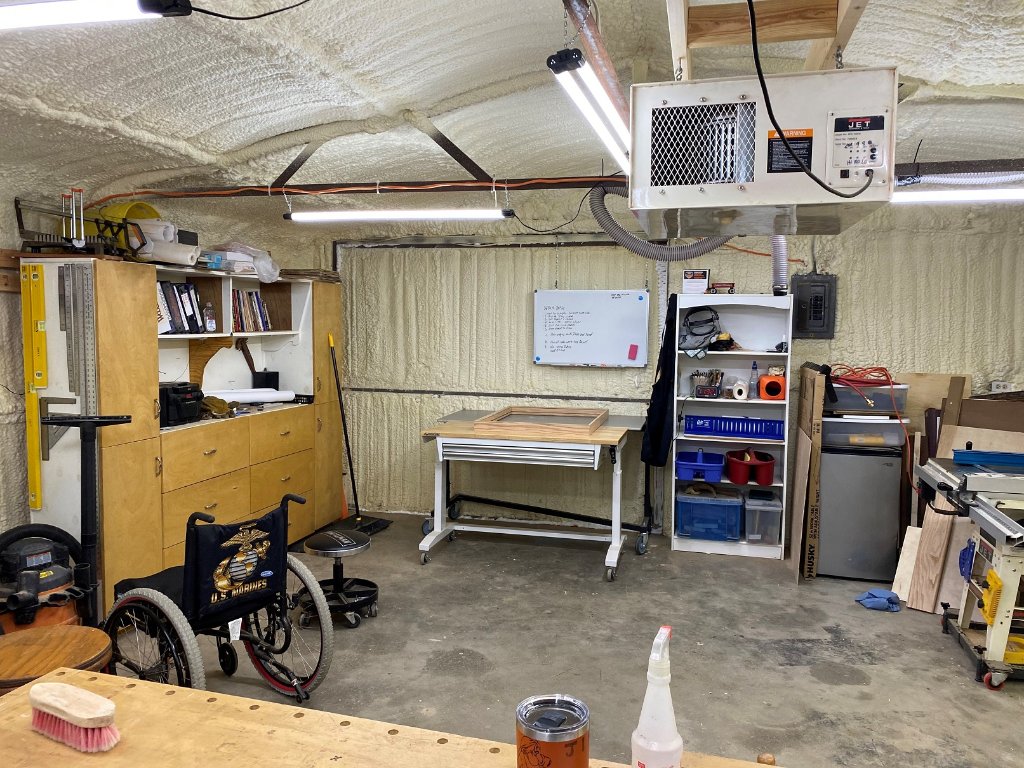

Post by GunnyGene » Mon Nov 23, 2020 9:03 am
I notice you're using a shop vac for dust collection. While better than nothing, have you considered a real dust collection system? I've had one in my shop that evacuates outside the shop for about 20 years. Set it up with a manifold and piping and gates running to all the major tools - TS, band saw, planner, bench sander, miter saw, etc. Makes a world of difference, and not that expensive to set up.
Posts: 7435
Re: A New Project in the New Shop
Post by BrokenolMarine » Mon Nov 23, 2020 11:01 am
Gunny,
Thanks for the input. I use the shop vac on the miter saw, but I have a very nice Jet canister dust collector that has served me well. Your advice IS excellent though. I also have the overhead air filter for the smaller airborne particles.
You can see the Jet Dust Collector in this old thread.
http://henryrifleforums.com/viewtopic.php?f=56&t=7529
I recently added a Shark Guard system to the table saw, which supplements the cabinent dust collection with overhead dust collection coming over the blade guard. I'm loving that, just can't run it using the dado blade.

Excellent! I thought you might have a full up system, but couldn't see it in the pics. I initially had a Penn State bagger, but hated it. It was noisy, takes up a lot of floor space, detracted from the blower efficiency as the bags filled up, and of course emptying the bags was a pain in the rear, so mounted the blower on an outside wall and ditched the bags. Not everyone can blow their dust outside of course, but out here in the woods it's not a concern.
Here's a pic of "Medusa" as I call her ;) . The front comes off so I can clear any clogs at the blower intake, which happens a lot if I'm using the planer.
Anyway, for anyone else contemplating a woodshop, here's some info on how to set up a good system:
https://www.woodmagazine.com/workshop/d ... ion?page=1

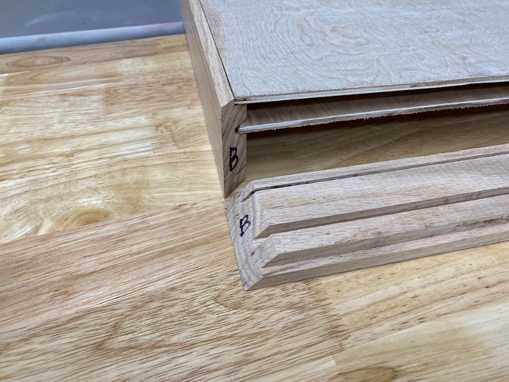

Once I had the clamps apart, I methodically disassembled the display case, and MARKED the individual parts in an area where the mark would NOT disappear during sanding or finishing. This is NOT always possible, and sometimes you have to use painters tape and move the marks then reaffix them. You'll see some pictures where the piece is laying on the bench with the tape square stuck beside it.
03 label the parts.jpg (179.97 KiB) Viewed 4469 times
During finishing, the area where these marks are will be covered with painters tape to keep the finish off as glue will not stick to the oiled surface. This will keep these marks safe and allow the proper fit when the frame is reassembled.

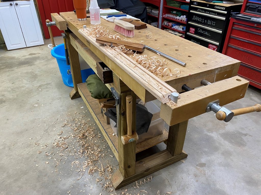

The next thing to do is prepare to use the molding planes. I have a drawer with a dozen or so antique molding planes I got from Lee Valley. I love these things, and use them whenever I can instead of a router. Less noise, less mess, and pride in using the hand tools ... Plus I love the sound they make when properly set up.... a soft whisk.
04 molding planes.jpg (151.07 KiB) Viewed 4468 times

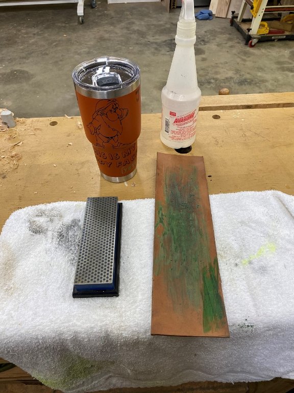

The first step is to sharpen the old iron in the plane you have chosen... I just sharpen the flat side. As long as you haven't dinged up the off side, that's all it takes. I don't have to use the waterstones like I would on the regular planes and chisels, the diamond stone and leather strop gets the job done.
05 before you start.jpg (104.31 KiB) Viewed 4468 times
What? My Yeti Cup? A gift from my Wife and Daughter for the shop.... it says, "This is my Happy Face." My Grandkids call me "Grumpy."
06 grumpy yeti.jpg (80.14 KiB) Viewed 4468 times
Once the plane was tuned, I make a few passes on a scrap of the same wood the frame is made from, made some adjustments, then made a few more passes. Stropped the iron, and we were ready to go.
07 testing.jpg (155.16 KiB) Viewed 4468 times
Posts: 7435
Post by BrokenolMarine » Wed Nov 25, 2020 3:24 pm
I worked the edges of the four sides of the frame that were adjacent to the dado for the glass, rolling the edge to a pleasant shape. This is NOT done with a special bit in the router but by hand and eye. I will touch up any uneven spots with a sanding block, and really, only I will see the difference unless some other woodworker is critiquing my work hanging on the wall. ;)
08 working the pieces.jpg (160.38 KiB) Viewed 4468 times
I took my time, made light passes letting the sharp plane do the work. If you force it, or try to muscle the old planes they tend to dig in. The blade is barely protruding from the mouth of the plane. I start with the plane angled 45 degrees off the flat sides and make a couple shaving passes, then angle back one way or the other on each consecutive pass, until the shape is done.
09 all four done.jpg (205.56 KiB) Viewed 4468 times
It may be a bit hard to see here, but I think they turned out well. Now I will have to sharpen the card scrapers and get busy smoothing the inside and outside faces. Final smoothing will be done with a sanding block, but if the card scraper does it's job, there will be very little to sand.
10 can you see the result.jpg (162.36 KiB) Viewed 4468 times

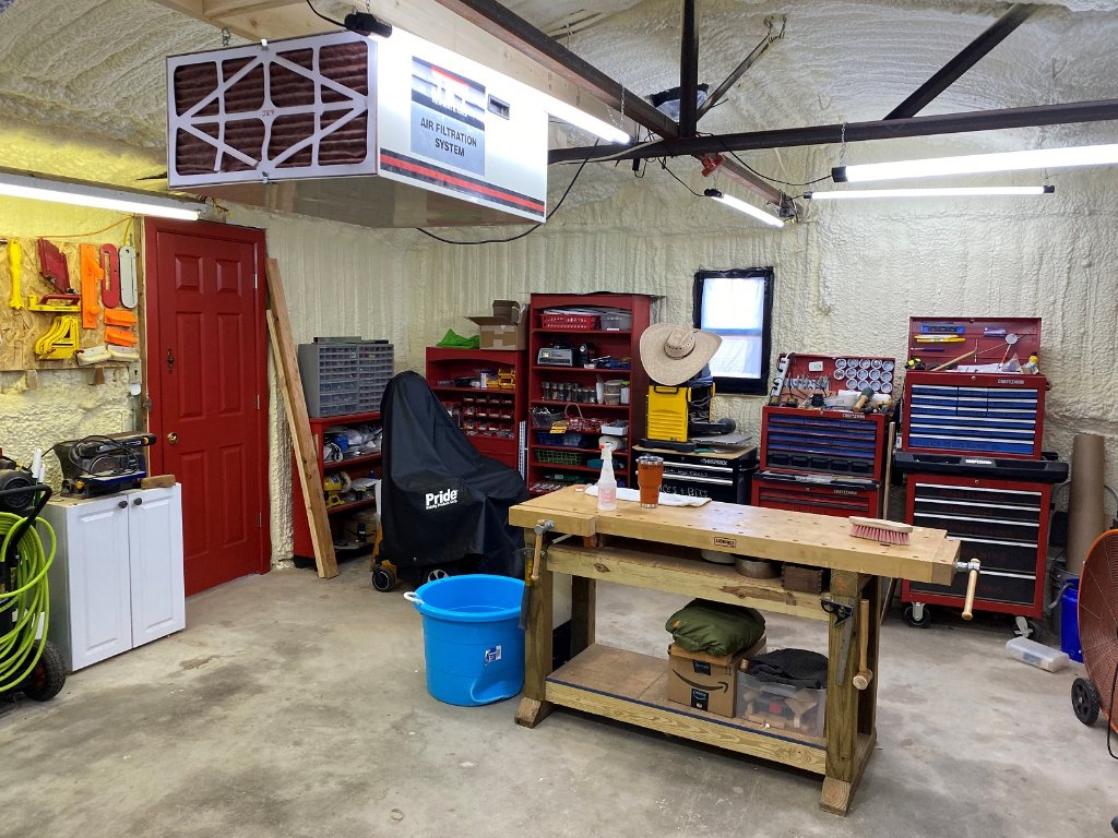

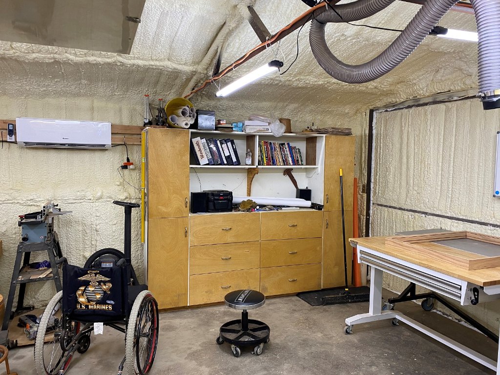

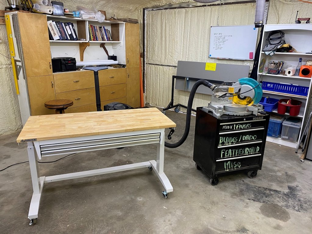

Since we have some time, I thought you might like a tour of the new shop, sorta. I will turn to the right, making a complete turn. Feel free to ask questions.
11 shop tour 1.jpg (212.98 KiB) Viewed 4468 times
12 shop tour 2.jpg (205.8 KiB) Viewed 4468 times
13 shop tour 3.jpg (202.83 KiB) Viewed 4468 times
14 shop tour 4.jpg (222.52 KiB) Viewed 4468 times
15 shop tour 5.jpg (237.2 KiB) Viewed 4468 times
16 shop tour 6.jpg (214.31 KiB) Viewed 4468 times

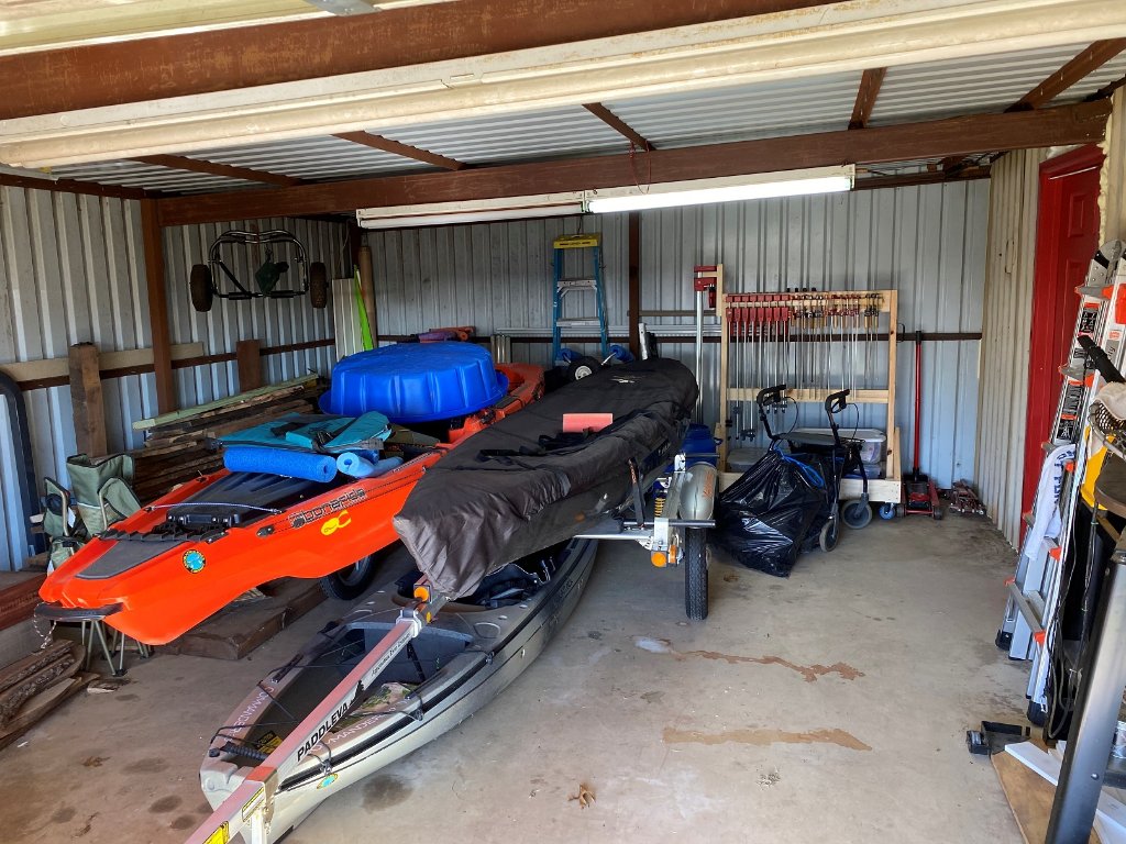

stepping thru the red door, puts you in the boathouse and storage area, and leads to outside. The big door in the woodshop has been sealed for the winter. I'll cut that door vertically and make a 3' and 6' door that opens like a hinged batwing door in the spring so it can be made to seal better and not leak. As the side rolling door it is now it was a sieve. Spray foam stopped that.
17 boathouse and storage.jpg (191.42 KiB) Viewed 4468 times
The kayaks and trailer, mower, and things like the clamp rack and other large rarely used tools are stored in the boathouse. This side is unheated. I WILL sprayfoam this later as well....
