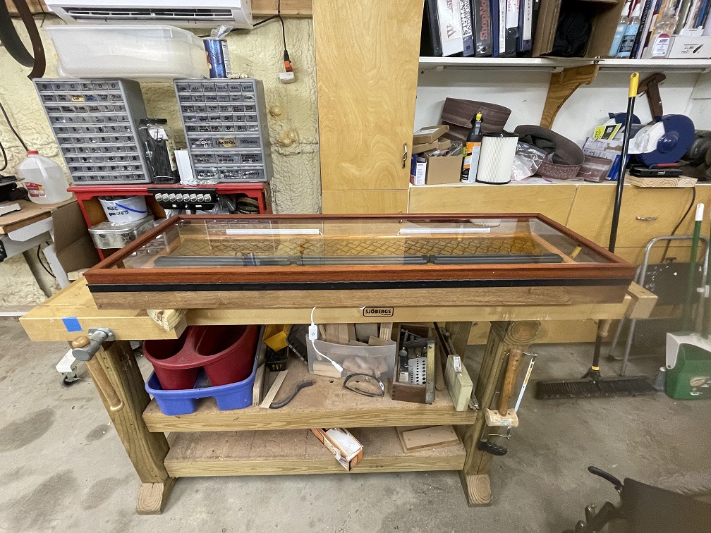

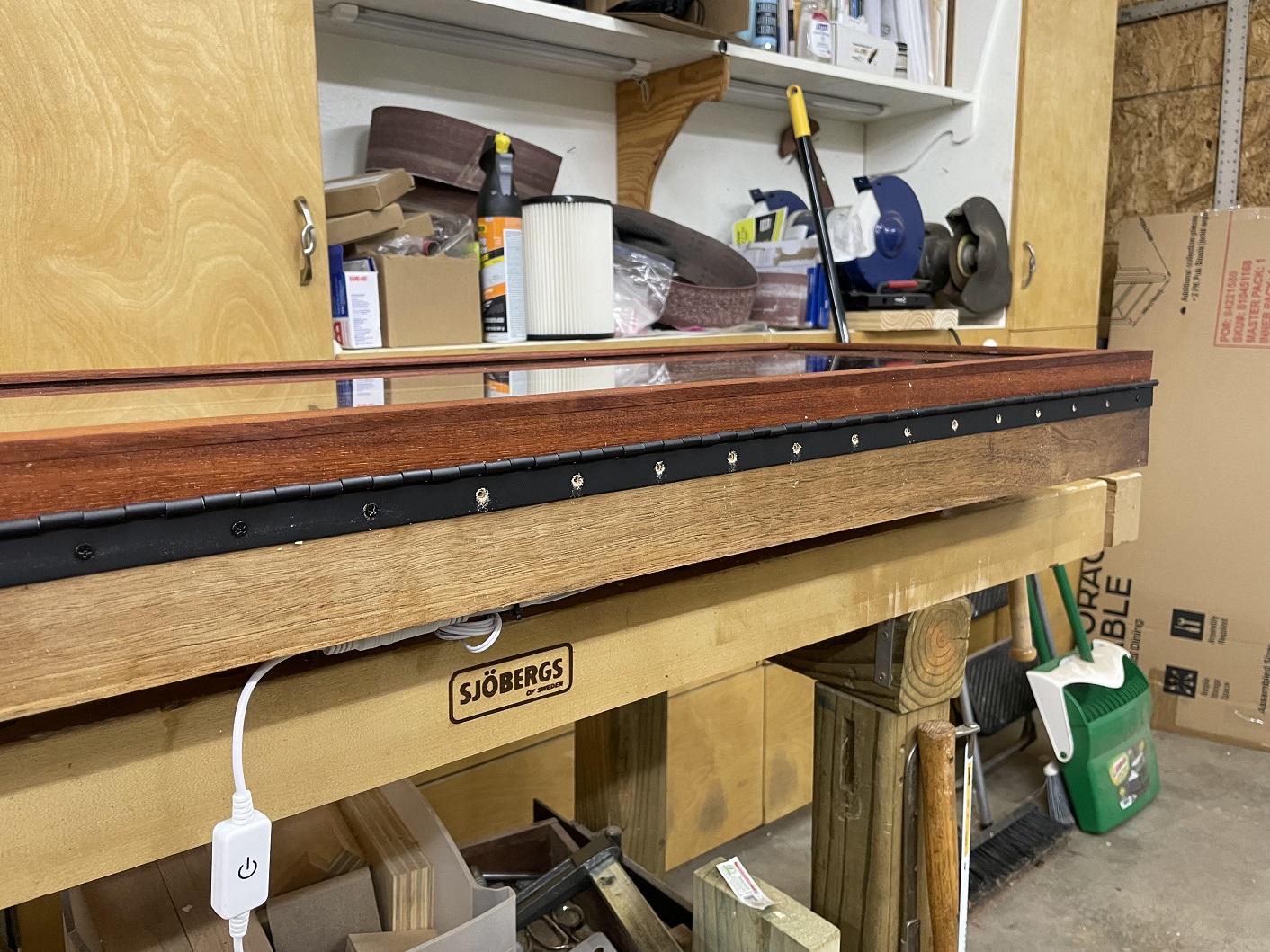

Went out this morning to attach the hinge to the case itself which will secure the top to the shadow box portion. First step was to center the hinge and put ONE screw in the center to insure it didn't move. Drilled that pilot hole and then put the screw in. Then repeated the process for a screw on each far end. Once that was done, I center punched all the holes so I could pre-drill all the remaining holes.
105 center punch holes.jpg (348.93 KiB) Viewed 3965 times
By pre-drilling the holes, the screws go in so much easier and it reduces the chance of both the split wood or the sheared head, as does the waxing of the screws prior to installation. You can also use bar soap. A great use for the old slivers left over that no one wants to use in the bath or shower. Just stick the tip of the screw into the sliver and install. Make sure you clean the surface before applying finish as the wax or soap could affect the finish if you don't.
106 pilot holes make screws go in easier.jpg (563.82 KiB) Viewed 3965 times
Slow controlled installation using the torque set drill as before, and the installation of the hinge was done. Smooth as silk. Now we can move forward toward completion. 8-)

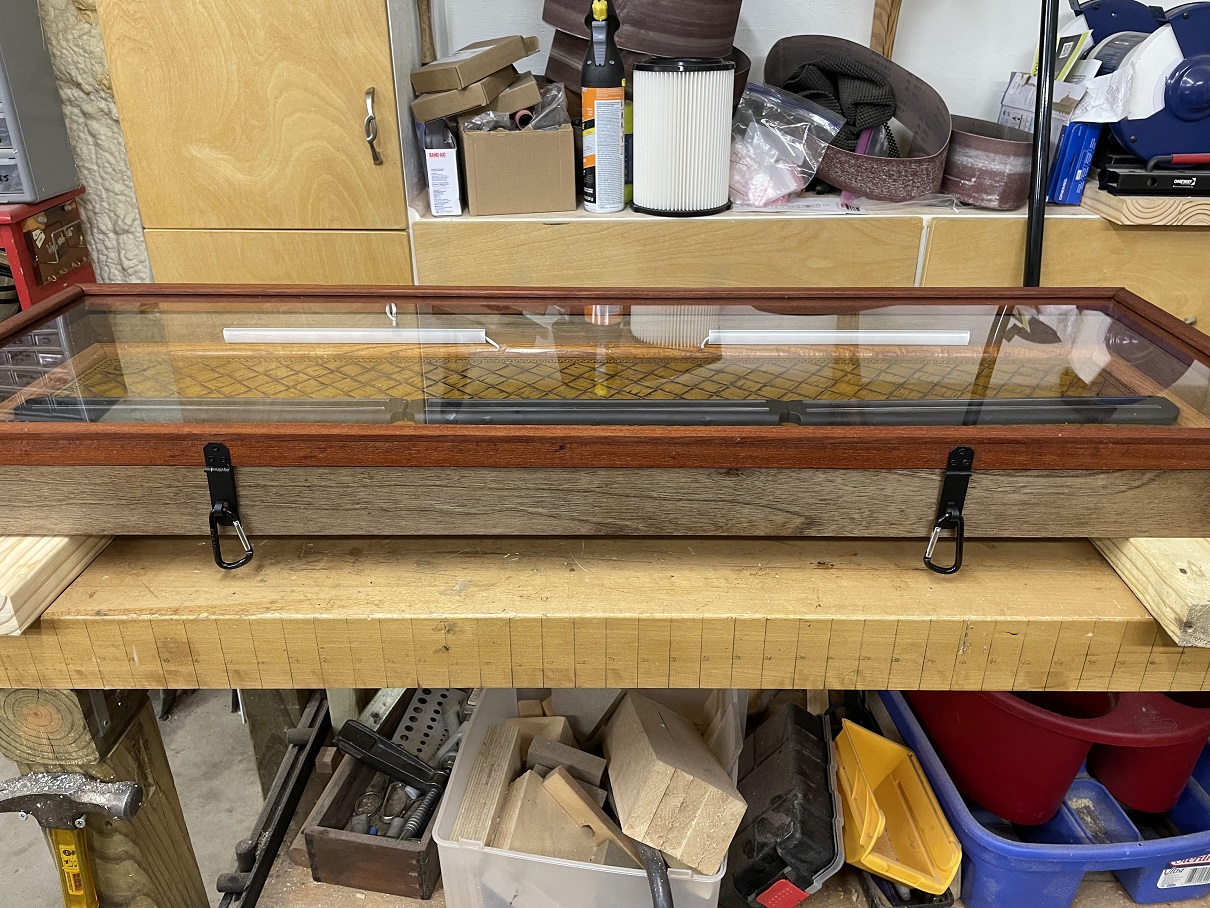

Got out to the shop afterwards, and was able to get the latches installed for the top edge of the case top. Went very smooth. Have had plenty of time to plan. ;) I measured a foot in from both sides, and marked the positions, and installed the hinged portions of the latch, standard tactic I always use. Taped depth on the bit, and torqued driver. Then came getting the exact position for the loop for the latch. This is always tricky, but of course, I have a trick. Form a double sided tape with blue painters tape. (There it is again, my blue tape.) 8-) Put it on the loop, and insert it in the hinged side of the latch and fold it over onto the case side. Press hard. Tah Dah.... Using a centering punch, mark the center of the two holes, then remove the loop and the tape, then drill. Install the loop.
108 centering the latch.jpg (487.78 KiB) Viewed 3900 times
Both are installed and fit just right. I could use locks, but no need. I just used small carabiners to insure they don't pop open and let the front of the display fall open and break the glass once it's on the wall. :shock:
109 both installed.jpg (498.09 KiB) Viewed 3900 times
Flipped over to the back, they won't be seen anyway.

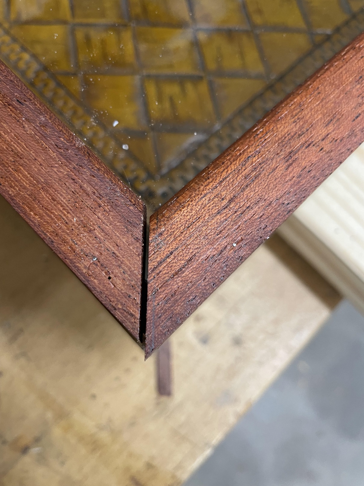

The next task for this session was taking care of something that was bugging me. A gap. No, not the clothing store, though that is not on the top of MY shopping destinations. :? This gap. Don't know how it happened, I must have been tired, or something slipped.
110 ugly gap.jpg (626.72 KiB) Viewed 3900 times
First, I took a scrap piece of the trim I made and cut a thin slice. :twisted: Not thin enough, so I cut another. STILL not thin enough. ONE more try. Bingo, it worked.
111 cut plug.jpg (463.58 KiB) Viewed 3900 times
I spread some glue on both sides, and tapped it in carefully, (it's really thin,) with a rawhide mallet. While the glue is still wet, I carefully sanded it flush. This meant the sawdust that filled any remaining gaps, was glued into place. :o
112 glued in.jpg (555.5 KiB) Viewed 3900 times
I spent the next thirty minutes cleaning up and putting away, then stained the repair to match. Wow, it actually matches. I did have to cheat a bit. I came back in the house, pulled up the thread and looked. I had to read back thru and find out WHICH Watco I used on this frame. (Um...Golden Oak.) So, it matched.

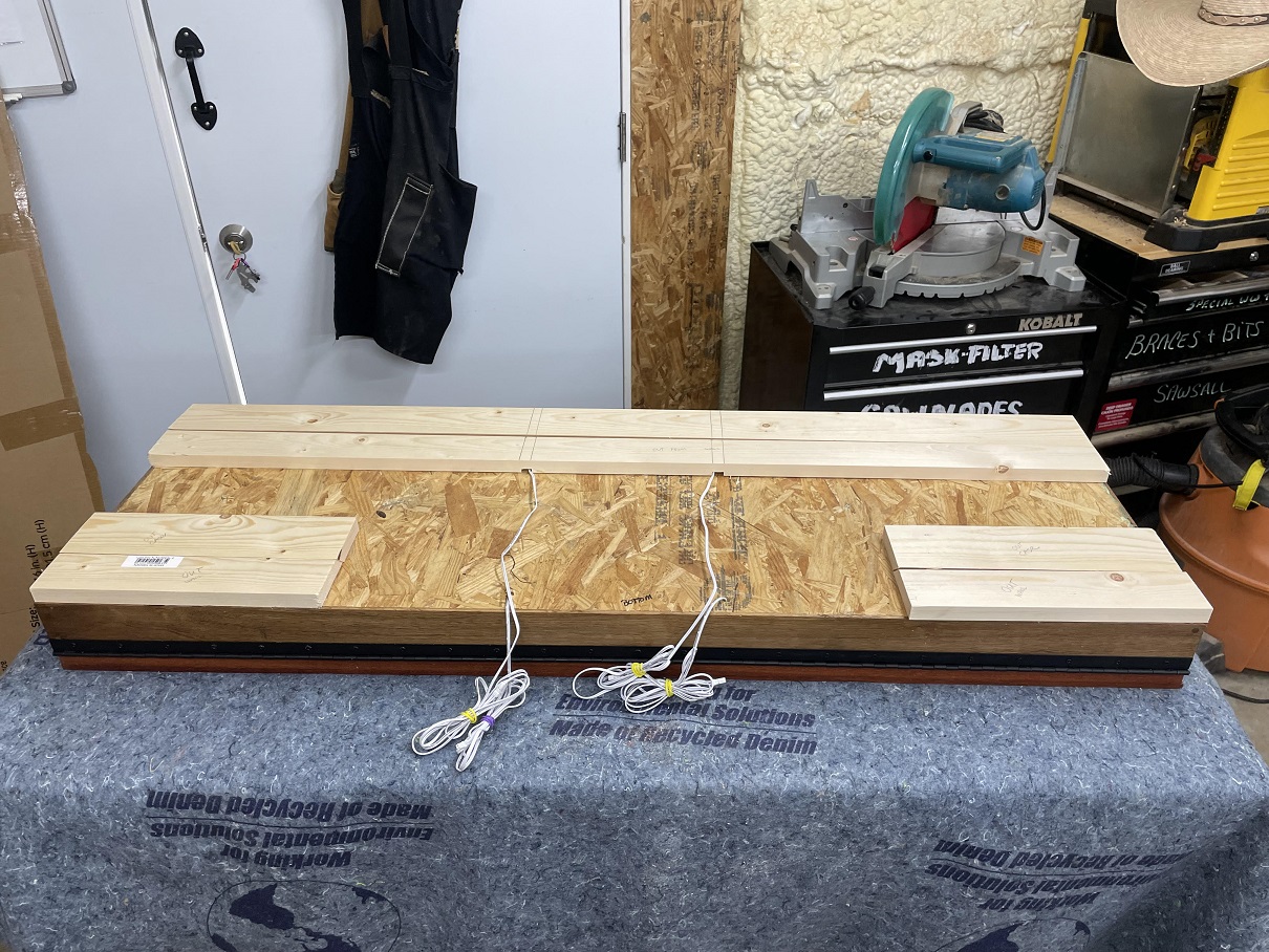

One last session today. It was a long one, but just one pic. I set up the table saw, had to change to a smaller diameter blade so I could angle it to 45 degrees and run the two 6' boards thru to cut the 45 degree angle on the edge of each. Then I cut a 4' piece off each, leaving two two foot sections. Those were cut into four one foot sections. The four foot sections had two dados cut across to allow wiring to sneak under their respective faces that would touch the back of the case. I test fitted them to the case, but haven't attached them to the case or the wall yet. Tomorrow. I spent WAY too much time on my feet.
114 cleats.jpg (464.97 KiB) Viewed 3898 times
Tomorrow I'll mount the three pieces that go on the case, ON the case, and then mount the wall pieces on the wall. I have to organize the wiring on the back and secure it so it won't be pinched, you know, neaten it up. 8-) TOMORROW.
