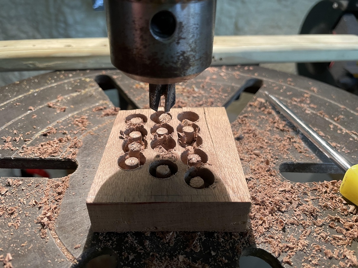

After a good break, I was back out to remove the clamps, and put that stuff away. Time to reinforce the glue up. My first step was to take a saved scrap from the cutting of the sides and using a 1/4" plug cutter, I cut a dozen plugs and set them aside.
70 plugs cut.jpg (453.83 KiB) Viewed 4201 times

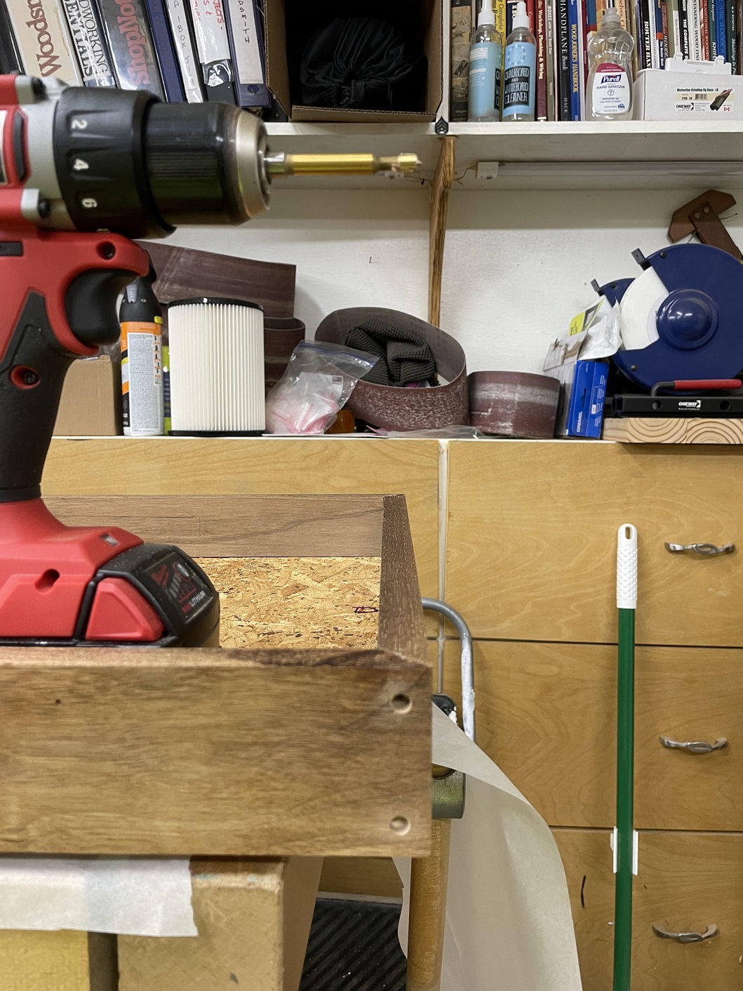

Next I decided where I wanted to countersink the holes and using a mini square, marked all eight holes. It's likely no one will notice, but I will. I want to be consistent. Miss T says I'm just anal. :roll: Using a Forstner bit, I countersunk all eight holes, then with the proper bit, drilled the holes for the finish nails.
71 countersunk.jpg (493.33 KiB) Viewed 4201 times

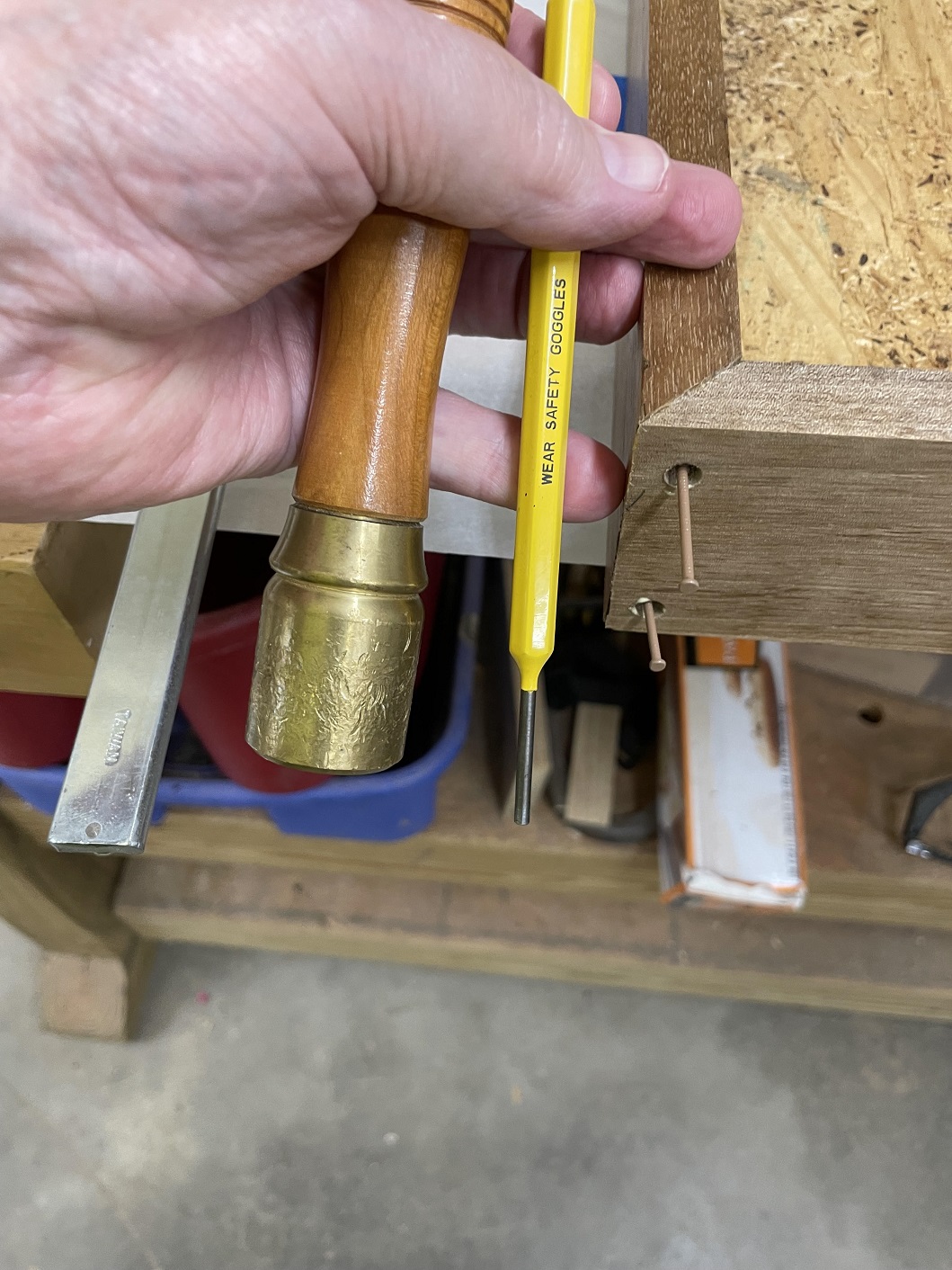

Most would use a hammer to set the nails, but it's hard to remove a hammer dent if you miss. I use my brass mallet, and a punch and a LOT of small taps to seat the nails, which I dip in wood glue first. This helps hold the joints tight. Slowly and carefully I work my way thru all eight holes seating the finish nails.
72 nailed.jpg (435.24 KiB) Viewed 4201 times

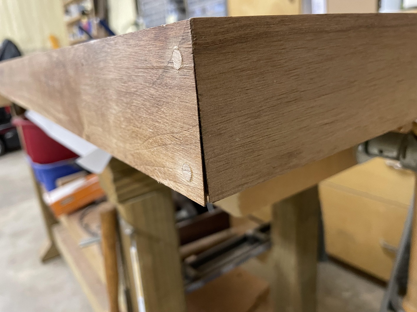

Using a nail, I set glue around the inside of the countersink, and then place a plug in each countersink. These are the plugs I cut earlier from the scrap left from the original board the sides were made from. Won't be perfect, but close. I tap the plugs in snug with a rawhide mallet and leave them for the glue to set.
73 plugged.jpg (476.43 KiB) Viewed 4201 times

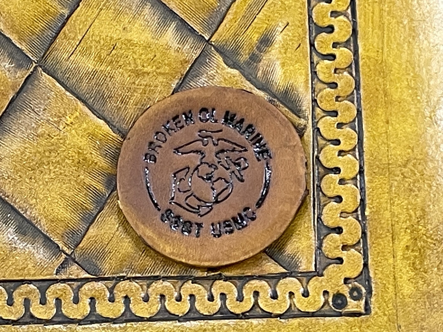

While the glue sets, I use the new Stamp I ordered to make a new maker's mark for the leather panel. I play with the stamp, making three or four new discs to cover the old stamp on the panel. I settle on this one, and dye and antique it. I will cement it over the old one on the panel when a final finish is applied.
74 new makers mark.jpg (660.16 KiB) Viewed 4201 times

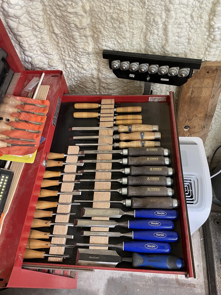

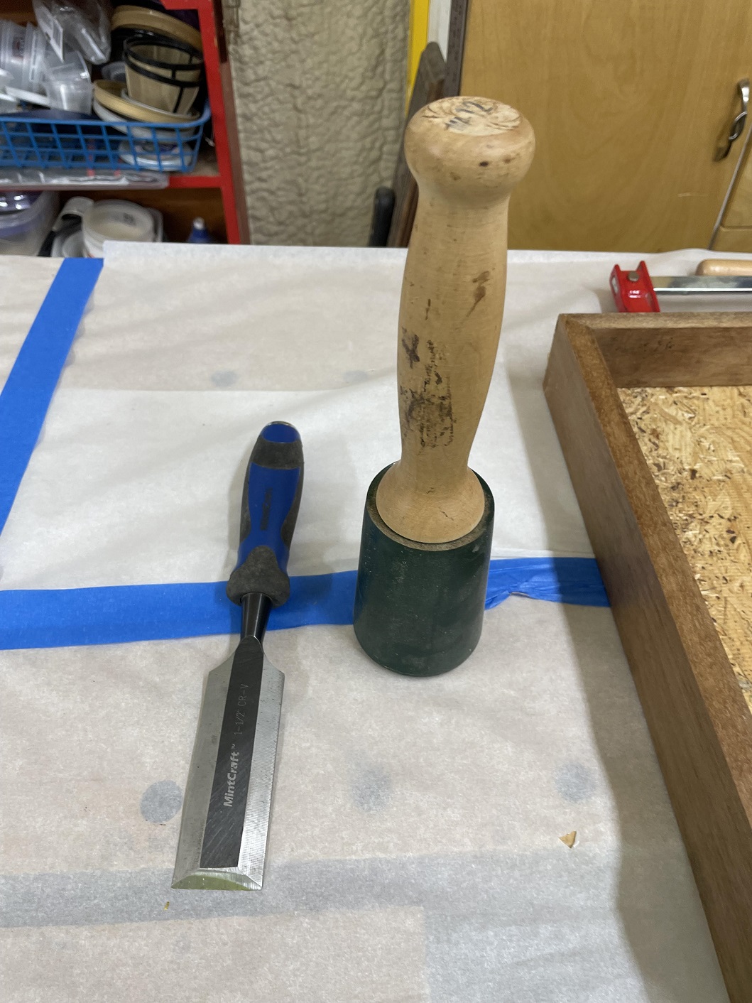

The Glue has dried. Time to flush cut the plugs, first to choose a chisel. I keep things neat and the chisels sharp, by keeping them in their place.
75 choose a chisel.jpg (373.36 KiB) Viewed 4201 times
A wide flat chisel, and my chisel mallet will do the job.
76 chisel and mallet.jpg (412.64 KiB) Viewed 4201 times

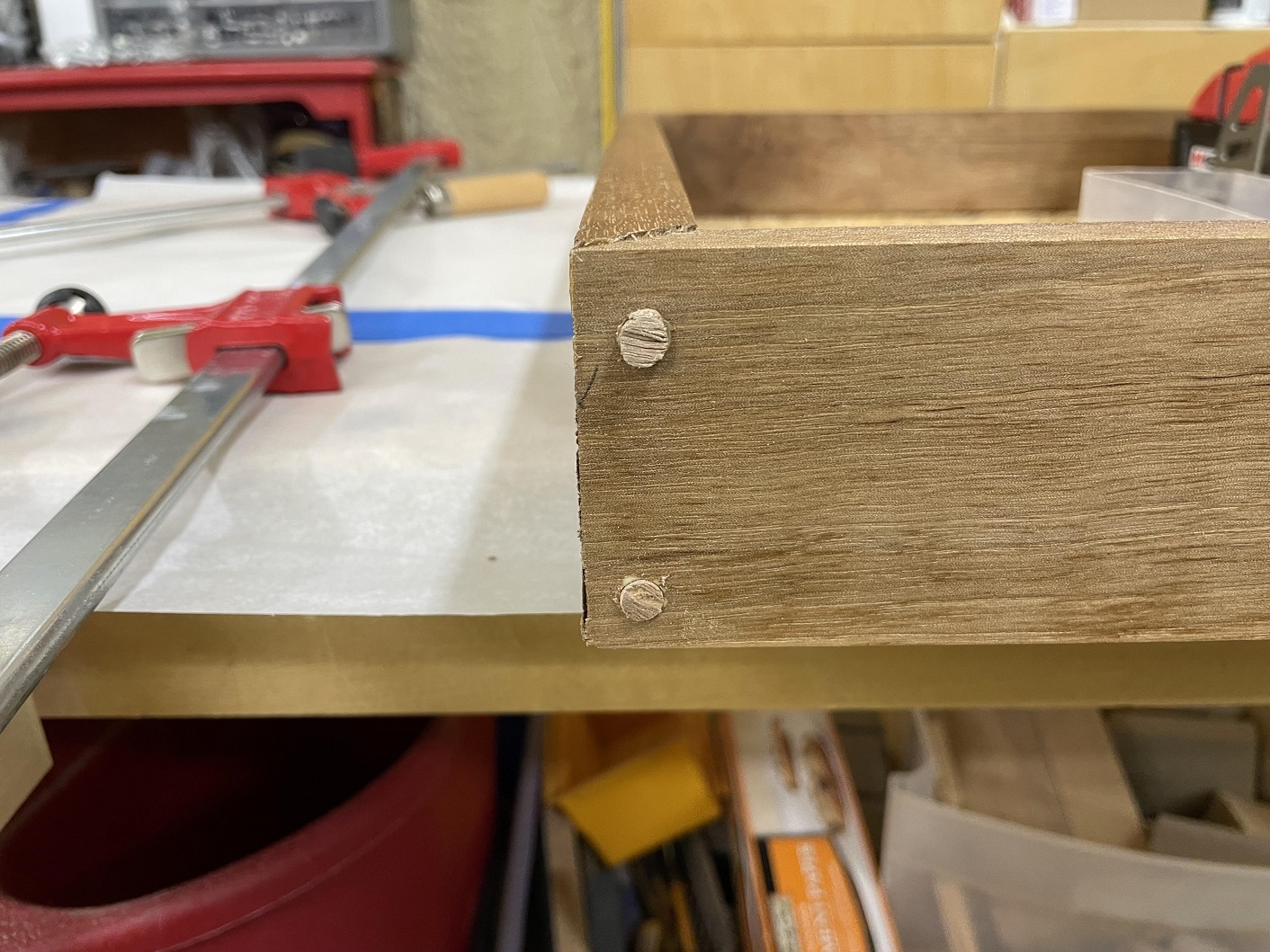

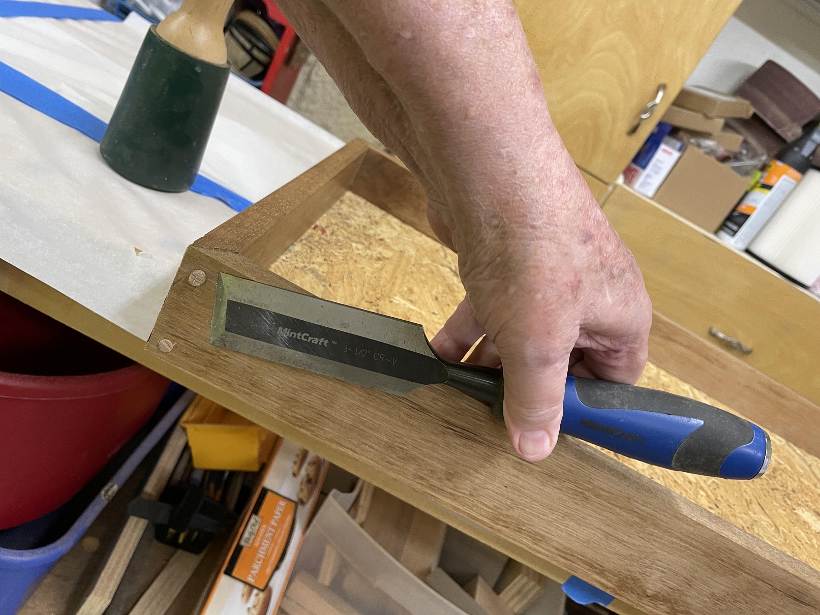

To insure a flush cut, the chisel rides flat on the side of the case and cuts with the grain of the plug. Prepared to cut..
77 prepared to trim.jpg (605.54 KiB) Viewed 4201 times
A light smooth strike. Too hard and the plug could break. I repeat the process with all eight plugs and BOOM. Flush cuts.
78 all flush cut.jpg (432 KiB) Viewed 4201 times
Touch all eight plugs with Watco Oil and they are close to matching. After waxing they will be closer. If they don't match exactly, they will be ACCENTS. :lol: Yeah, I planned it that way... (If asked.)
79 touched with oil.jpg (488.94 KiB) Viewed 4201 times

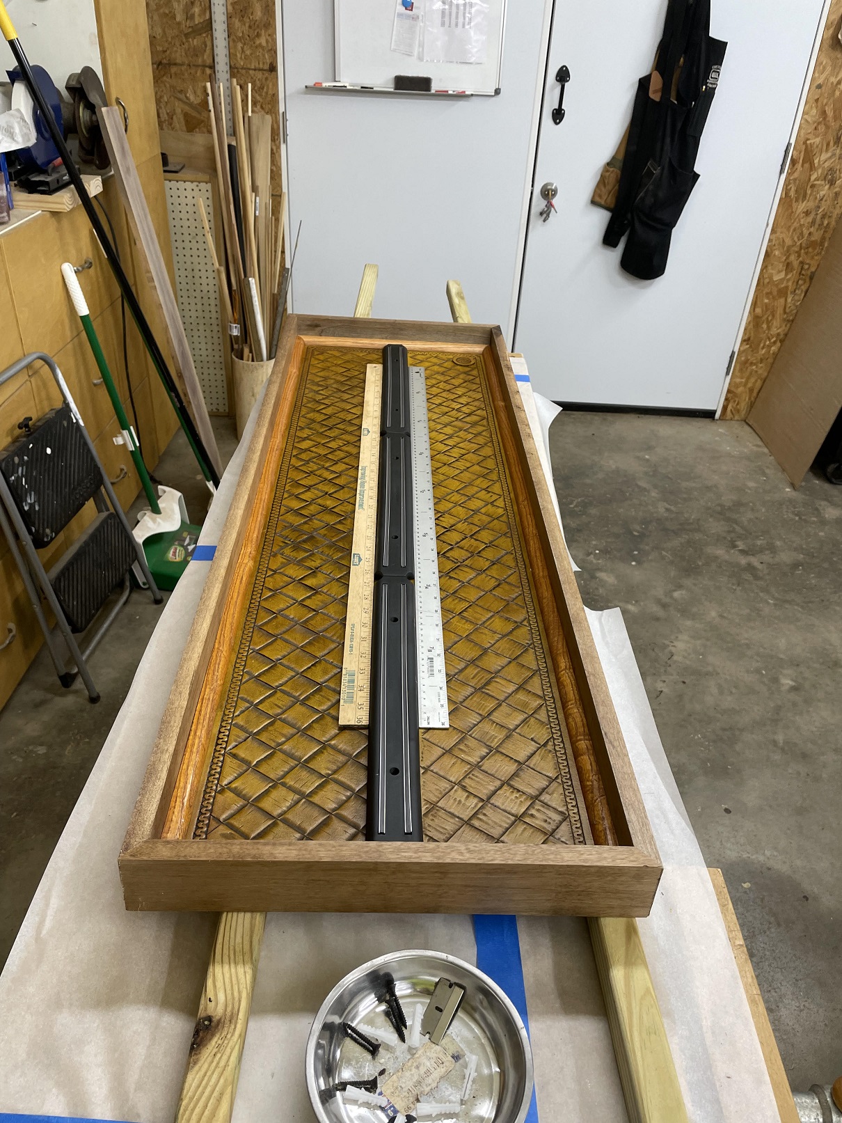

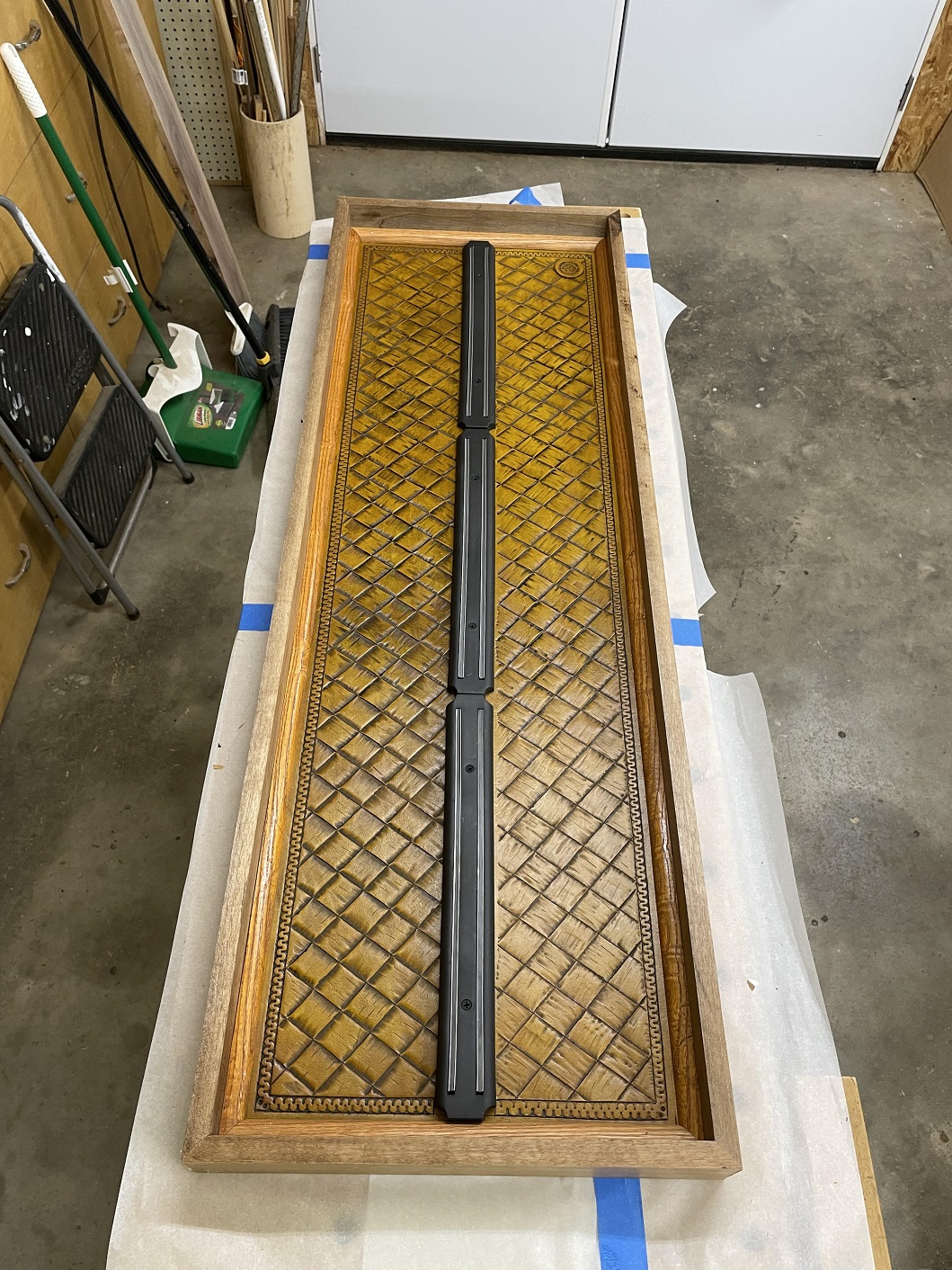

After the logo was cemented on place, I installed the panel and the quarter round trim. Used the brad nailer to secure it, but didn't glue the trim to the leather, just in case. :roll: It was time to install the magnets. I used two three foot rules to insure they were in alignment with one another and lined them up on the marks on the leather and got busy.
I set the case on a pair of 2x2s, knowing there was a chance the screw could come thru the bottom, slightly. :?
Carefully, one at a time I got to it.
80 started on magnets.jpg (689.96 KiB) Viewed 4187 times

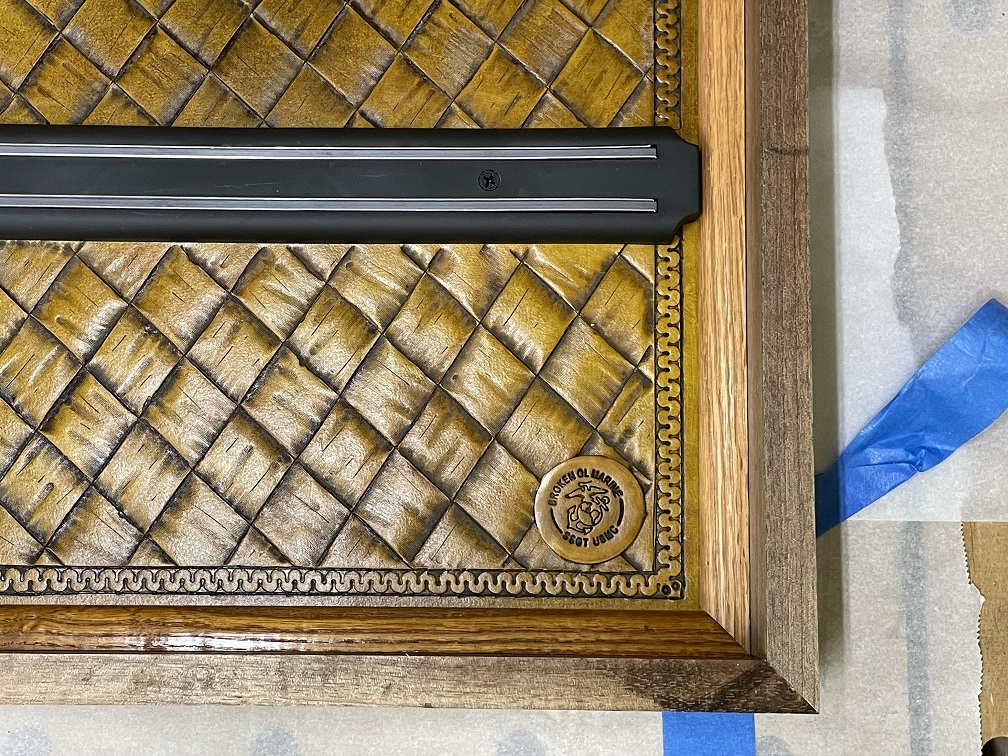

With patience, and a steady hand, it came out fine. Three of the screws did come out the bottom, about 1/16th inch. Dremel and a cutoff wheel took care of that in a couple minutes.
81 Looks good.jpg (664.91 KiB) Viewed 4187 times
The new logo looks good as well.
82 new logo in place.jpg (449.14 KiB) Viewed 4187 times

Why the new makers mark? Did I miss something?
Wow, just wow! The finished look of the leather is fantastic as is the entire project. The magnets look great, I was wondering how that would come out but it works just fine.
Posts: 7370
Re: Display Case
Post by BrokenolMarine » Sun Oct 06, 2024 10:28 am
Sun Oct 06, 2024 9:44 am
The old maker's mark was just shy of 1/2 inch in size overall and most couldn't read the "BrokenOlMarine" above the Emblem. I had been planning for some time to get a new stamp. At the suggestion of someone on my leatherworking forum, I checked out Steel Stamps Inc. The new one is 1-3/16". the impression is much cleaner, easier to read, and steel rather than brass. Will outlive me. :lol:

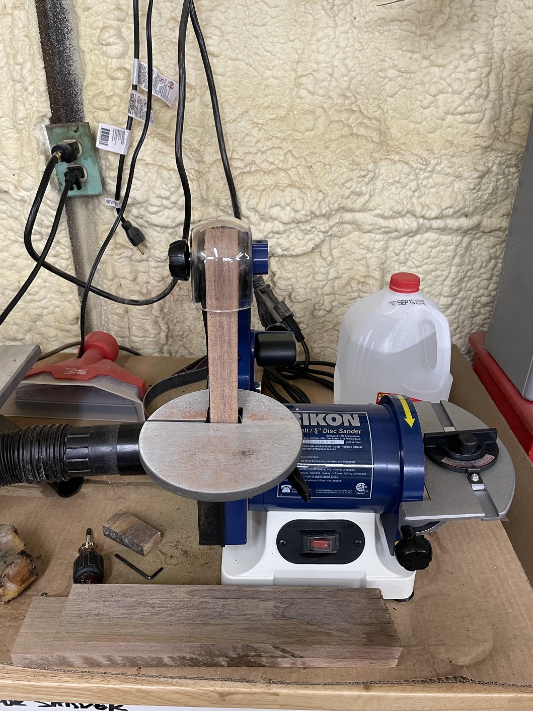

Next, I used the new desktop 1 x 30 with the platten to sand it and get rid of those cut burns from the table saw, the chrry is a hard wood and I was ripping a piece seven feet long. :roll:
84 sander.jpg (642.35 KiB) Viewed 4151 times

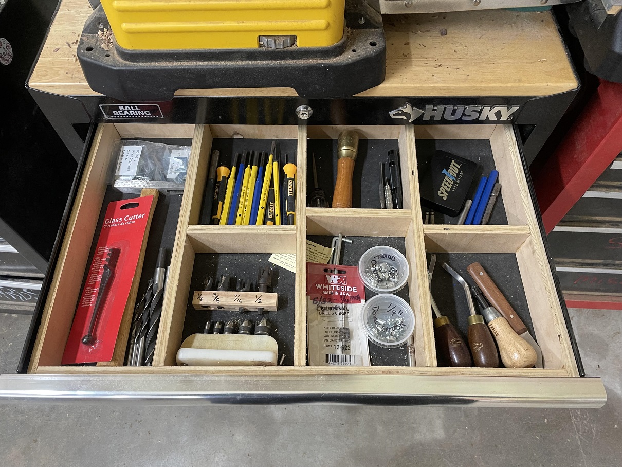

After she was all glued up, I dipped into the special tools drawer to repeat the setup from the case...
85 special tools drawer.jpg (442.62 KiB) Viewed 4150 times

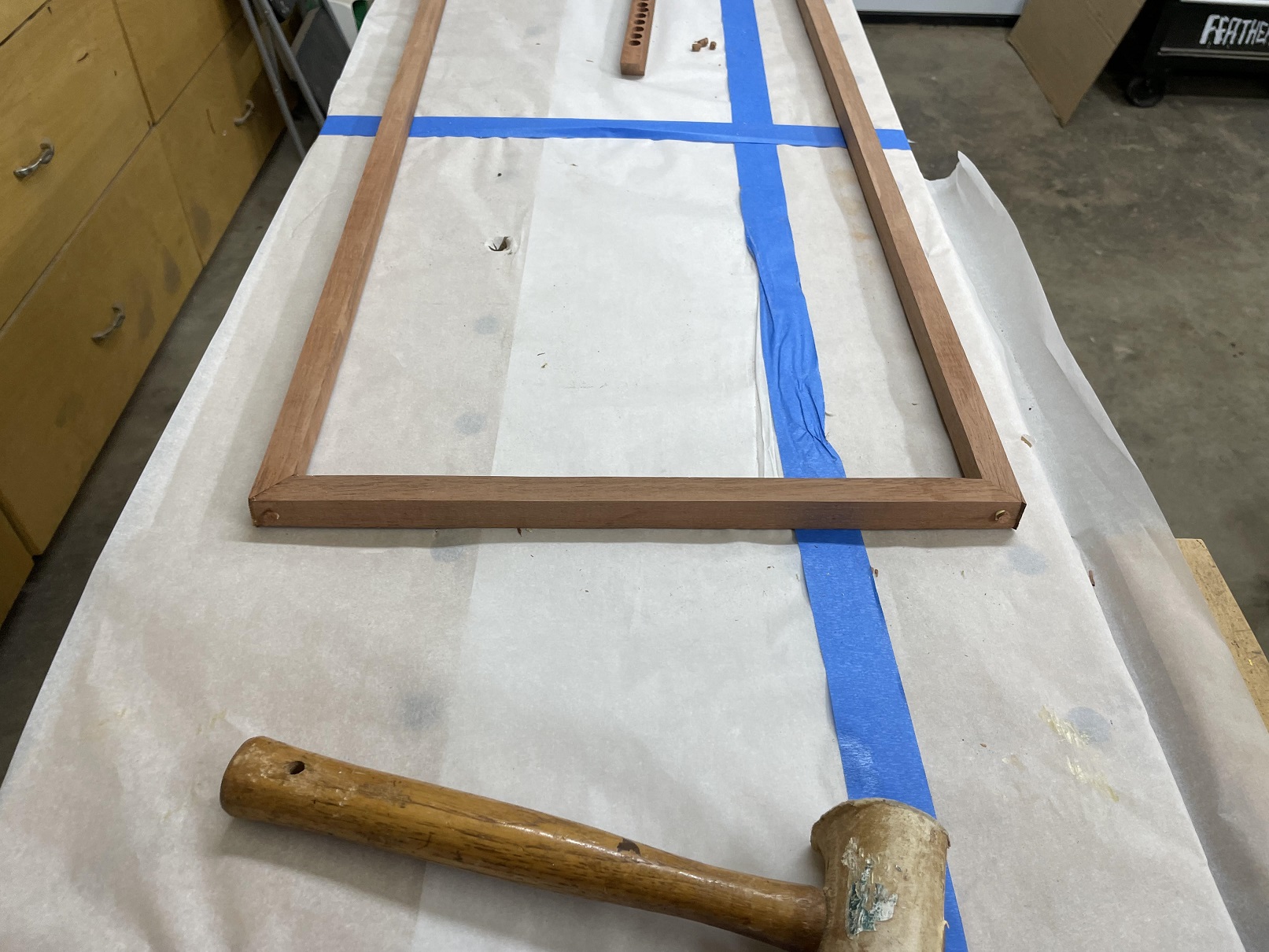

Chose the best of the plugs and with a dash of Tite bond II wood glue, set the four plugs.
88 plugged.jpg (497.34 KiB) Viewed 4150 times
Tomorrow I'll take a sharp chisel and cut them flush. Tomorrow is also the day to shape the frame then cut the plexi to fit. :roll: That will be a pucker factor cut. $45 a sheet... (sigh)
