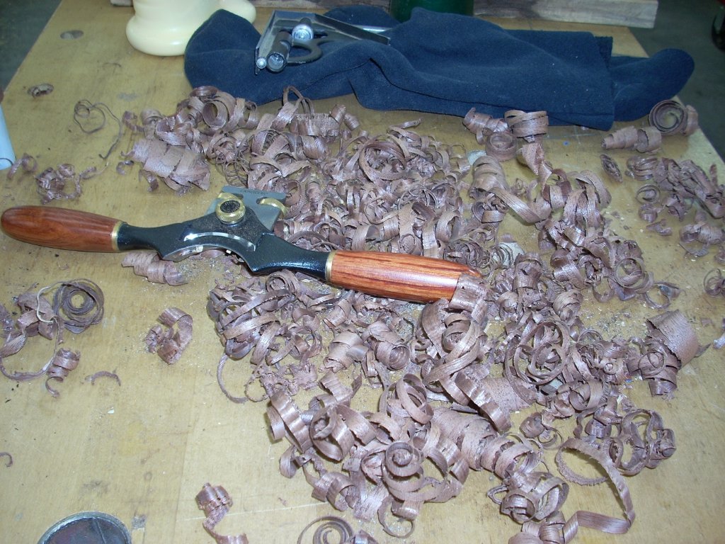

Today's work was on the EXTRA rail, which will become the handle and will reside at the top of the chest... between the ends at the top of the "coffin" as Miss T has taken to calling the shape.
I used a spokeshave to start turning the rail into a comfortable shaped to hold. Faster, and much easier with a router table, but LOTS noisier and dust everywhere. The only sound in the shop with the spokeshave is the WHISP of the blade... which I like.
01 spoke shave.jpg (245.07 KiB) Viewed 5849 times

Enjoy the feel of hand tools. As you say they are much quieter and give me the feel of personal contact with the wood. Also if you run a piece through a router table or a table saw and it is set a bit deep you are done, can't put it back on. With a hand plane or spoke shave you can work your way to the line and proper fit checking as you go. Very pleasant.
Nice curls, good sharp tool. Looking forward to the project coming together.

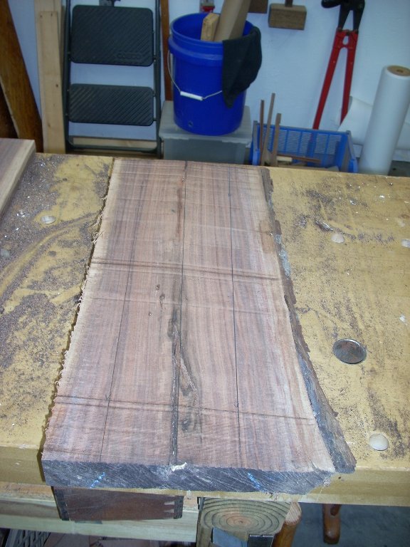

I had gotten tired by the time I cut these slabs and had NOT done a very good job, so IT cost me. The grain was NICE.
01 rough slabs.jpg (135.01 KiB) Viewed 5801 times
BUT, you get lazy now... you pay later, as you will see. The slabs I cut six months ago... were NOT flat like the ones I started out cutting, they were "slightly" warped.
(Slightly warped like slightly pregnant.) :?
02 a little warped.jpg (111.96 KiB) Viewed 5801 times

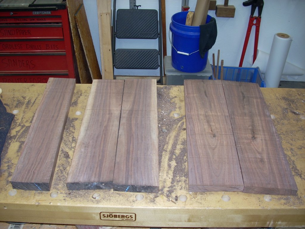

This meant a LOT of work. So, first I cut the two inch slabs into bookmatched slabs after first trimming them into squared edges... a must for bookmatching on the bandsaw.
Then I measured the center of both ends, struck a line and cut VERY carefully to the line thru the slab. THIS gave me a flat straight side.
03 bookmatched.jpg (182.83 KiB) Viewed 5801 times
BUT, I still had panels that were too thick to use as the winged edge doors I had envisioned hanging from the center panel. I measured off a half inch from the flat side and ran back across the bandsaw, staying to the outside of the 1/2 inch line. Then I ran all four panels thru the planer, getting nice smooth flat panels that would work once jointed and glued at 8" wide. Doors for the two sides. The center panel was also trimmed and planned to 5/8"
04 trimmed.jpg (148.53 KiB) Viewed 5801 times

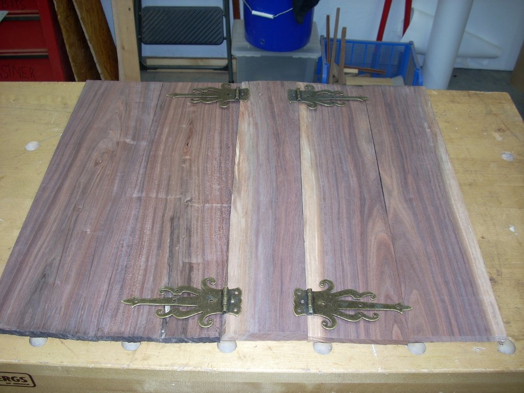

This is an idea of what I envision, but the wing doors will angle down about 45 degrees to meet the 12" sides. Following the coffin sides. ;)
05 concept.jpg (172.91 KiB) Viewed 5801 times
I may... MAY... put a maple trim piece on each end with a lip under the edge to strengthen the panels, and a maple brace under the doors at the hinge point. I'll use some of the highly figured spalted pieces I have saved, which should really pop against the walnut and serve as both supports and accents. I'll fiddle with it during the next steps, and see if:
a) it looks good
b) it might be needed.

Post by markiver54 » Sat Jun 01, 2019 10:58 am
Tell Miss T, I like her choice of hinges. :)
Posts: 7360
Re: A Project For Miss T
Post by BrokenolMarine » Sat Jun 01, 2019 11:16 am
I have to find FORTY mini screws to match. :evil:
Posts: 11007
Post by markiver54 » Sat Jun 01, 2019 11:25 am
That might be a bit challenging to find ones with the right patina. I'm sure they're out there though. ;)
