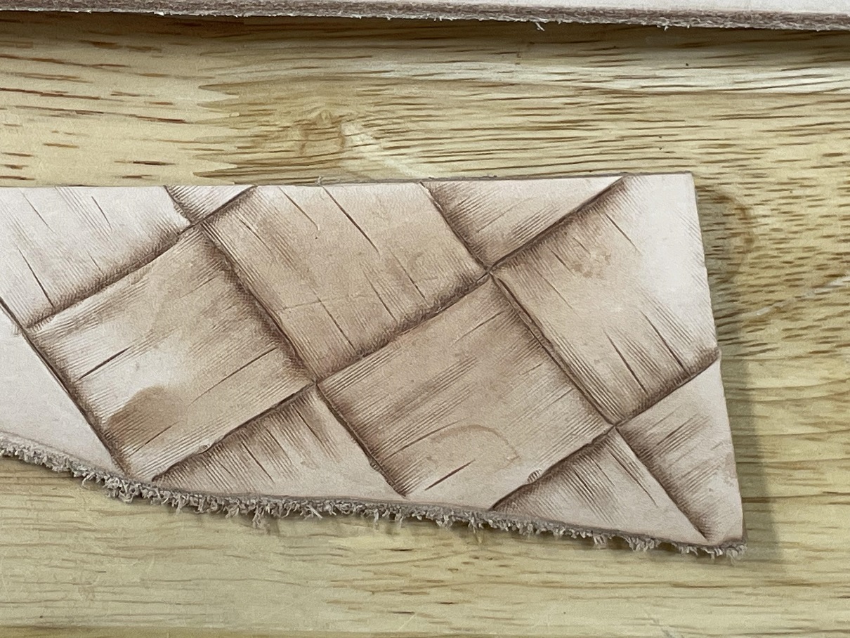

I watched the lined shoeprint beveling section again this morning, and after coffee, went out to start. I looked at all the work I had done so far and thought, I need to give this a try first. I selected a scrap piece from the bucket and quickly tooled it to the same condition as the large panel, then taking the footprint bevel, started the shading. ;) It actually went well. I was pleased with the results, and added the accent cuts too.
40 practice scrap.jpg (442.99 KiB) Viewed 2492 times

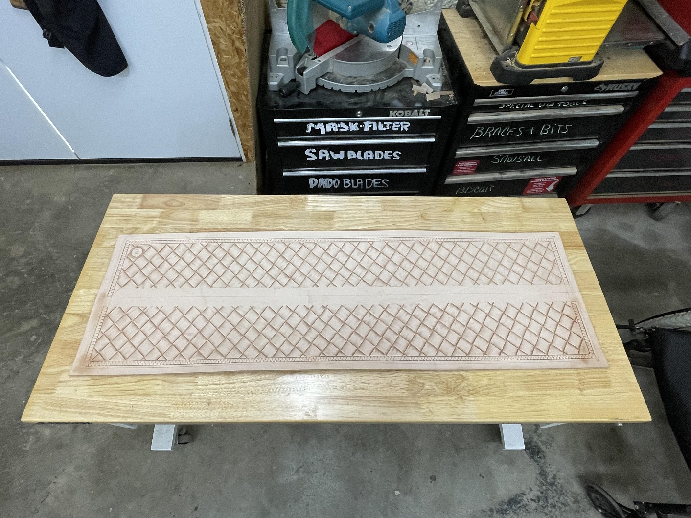

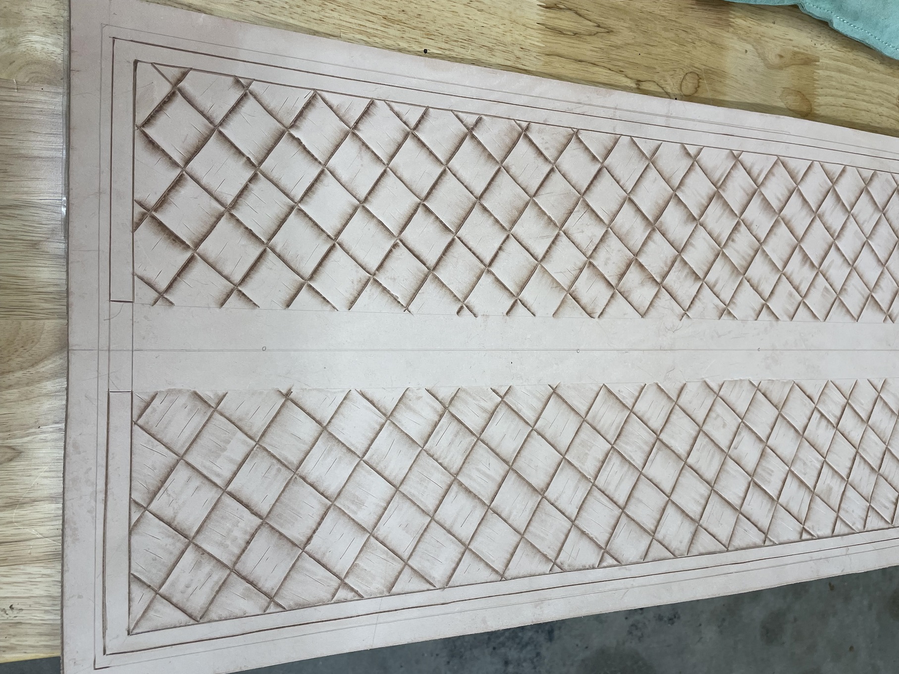

Comfortable now, I started on the large panel and took my time. One thing I learned, it's slow going. There are about thirty five columns on each side, and in the hour or so of tooling before I had to stop, I knocked out ten. NOT going to push and make a mistake or end up having to take a couple day's break because I didn't listen to the body... arthur tells me when to stop and rest. :lol:
41 started on the panel.jpg (481.28 KiB) Viewed 2492 times
The newly tooled section is on the left, you should be able to see the difference, and I think it's coming along well. In the long run, it will be worth the pain, especially once the border is added.

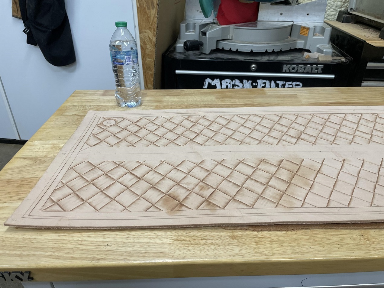

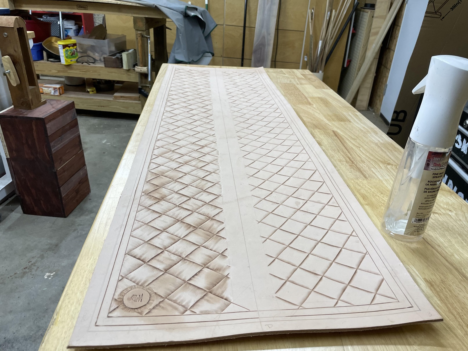

Last long session for the evening. I got the side finished and my Maker's Mark done... since it's on that side. ;) There were a couple dings in the edge, but I'll clean those up before applying the dyes and the finish.
43 makers mark.jpg (522.49 KiB) Viewed 2482 times
This was a lot of work over the course of the day, but as you can see comparing the two sides, it really brings it to life.

Here is a closer look, sorta, at the finished tooling. Tomorrow, I'll make the accent cuts on this side, then start on the other side. I WON'T be adding dye/stains until I tool the borders.
45 better look.jpg (580.02 KiB) Viewed 2482 times

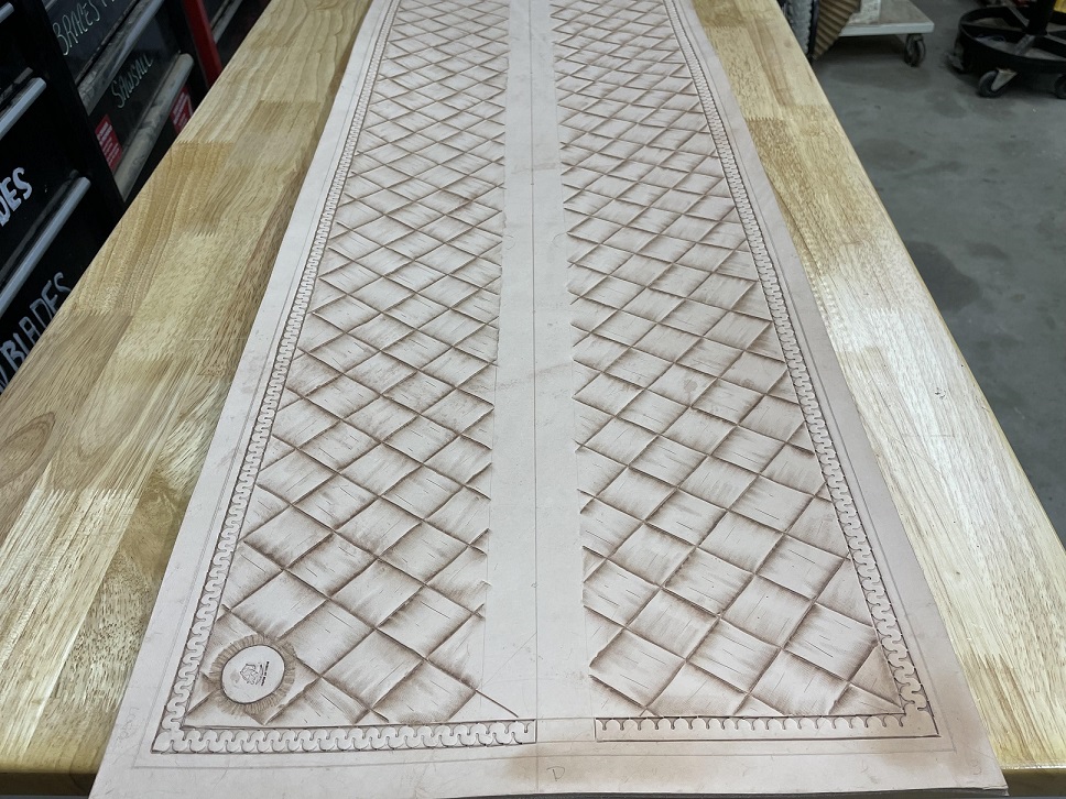

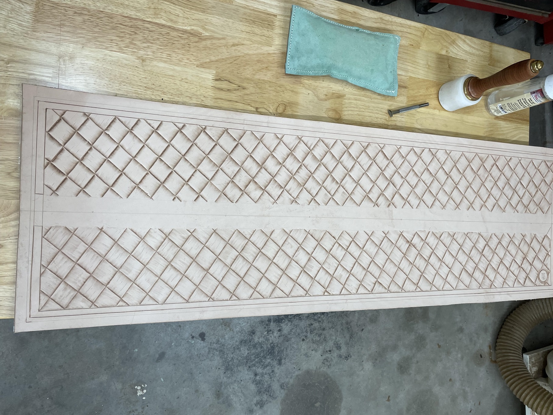

Long(ish) session this morning. I finished the shader work and did the accent cuts on both sides. The internal tooling is done. :) I may find a block here or there than needs individual attention later, to clean up it's look, but for the most part, it's done.
47 internal tooling done.jpg (900.15 KiB) Viewed 2452 times
All I can say is THAT was a bunch of work. Below is a bit closer look. The one side looks a bit darker because it's still wet from the tooling. They match when they dry.
48 close up.jpg (913.91 KiB) Viewed 2452 times

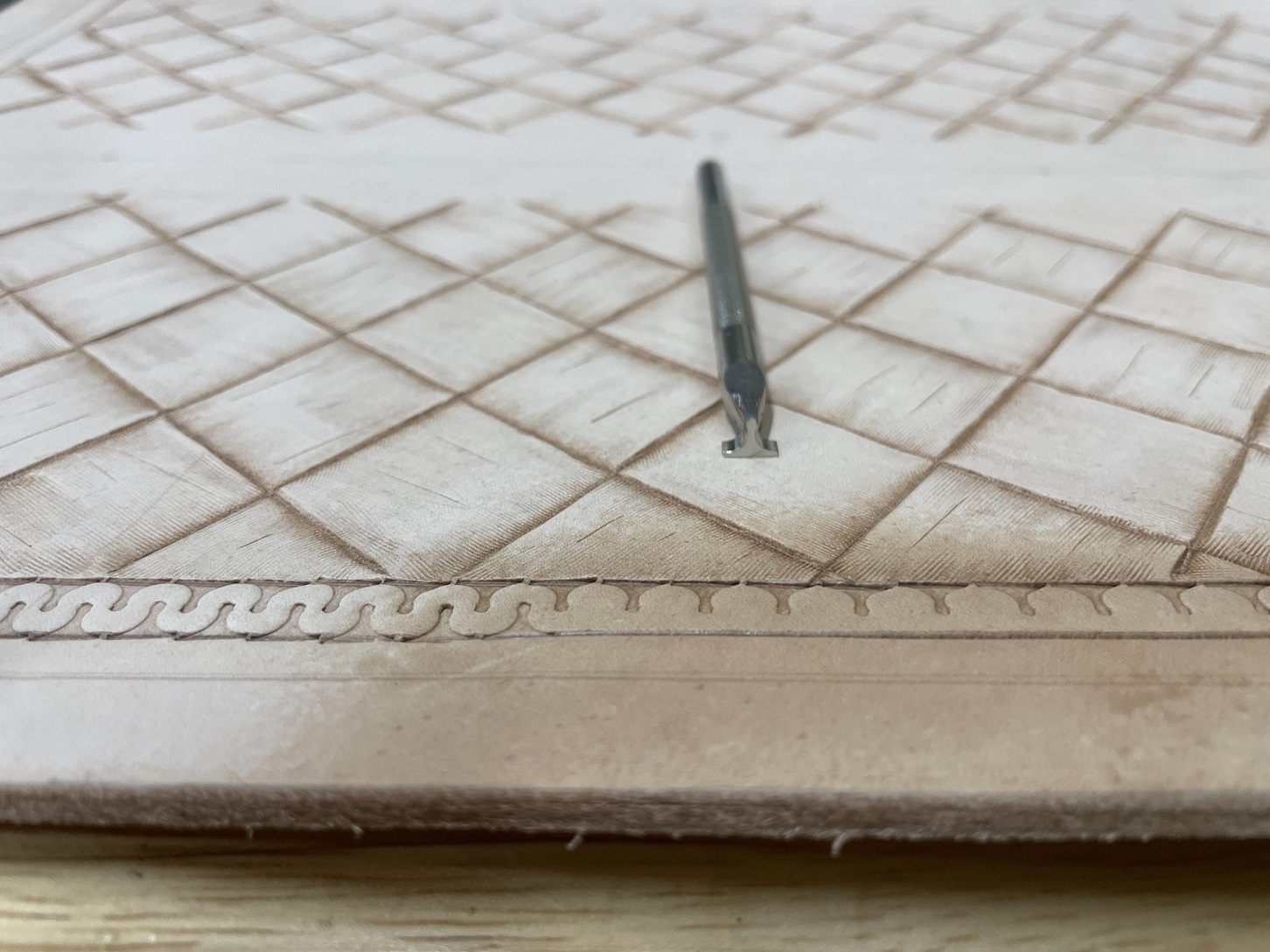

Back out for an afternoon session to tool the borders. The serpentine borders just requires one tool, and it's a slow and steady process. You tool one edge with the tool, placing the design down the edge, then offset by half on the other edge, and end up with the cool border. This is how you begin.
49 beginning serpentine border.jpg (412.73 KiB) Viewed 2449 times
Placement is everything. The back edge of the tool must be square, the width of your tooling window must work, and when you begin the second side, you must center the point on the loop on the other side. I finished the first side and it was looking good, slow and steady paid off.

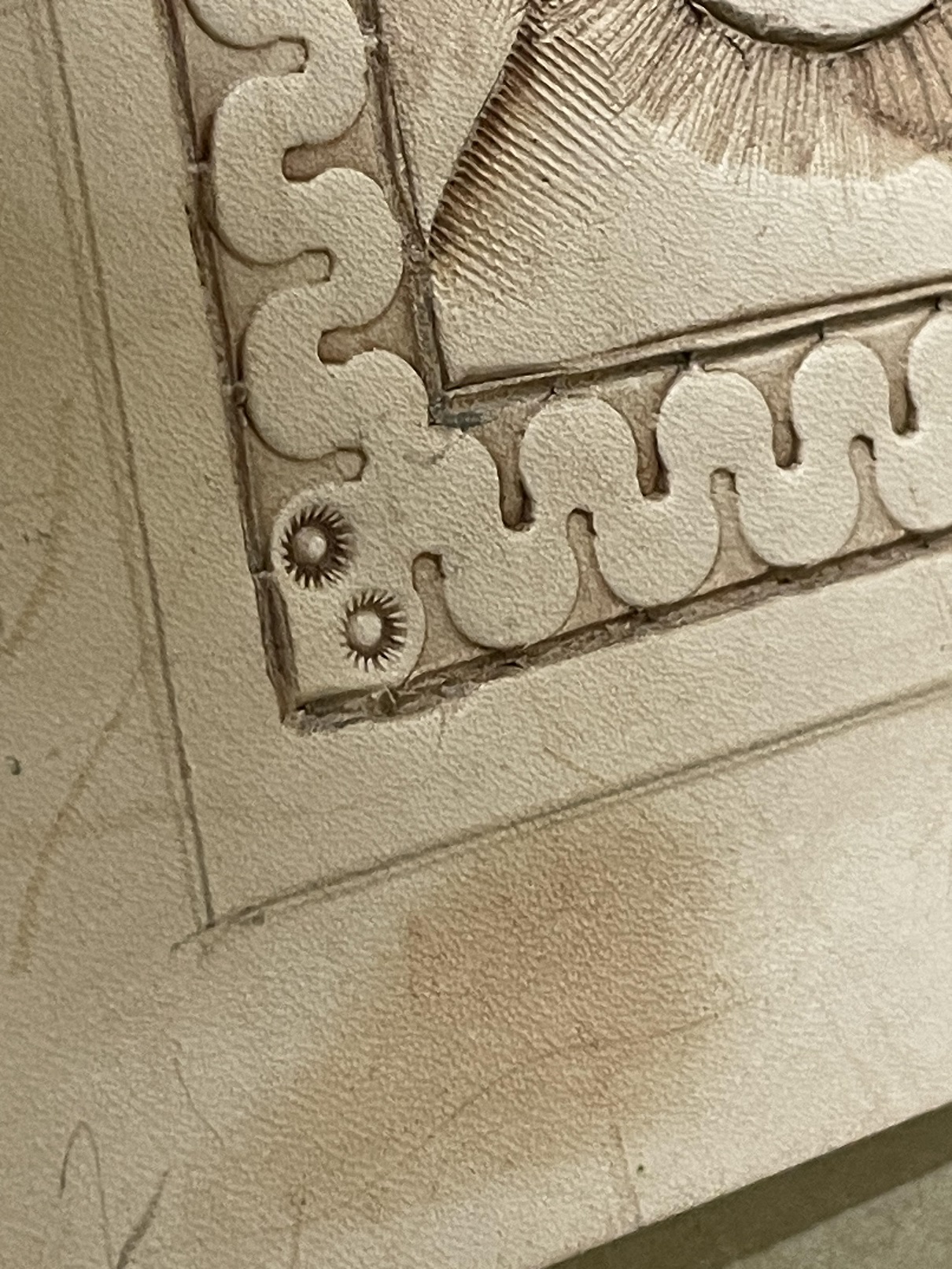

Out for an evening session. Used the Stylus and got rid of the tics, then before dyeing the panel, I added one more thing, a little personal touch to the Serpentine Pattern. I always thought the pattern's corners looked like a snakehead, so I ADD eyes. :lol: I like the effect. It is called a Serpent (ine) pattern after all.
54 A little personal touch.jpg (656.04 KiB) Viewed 2445 times

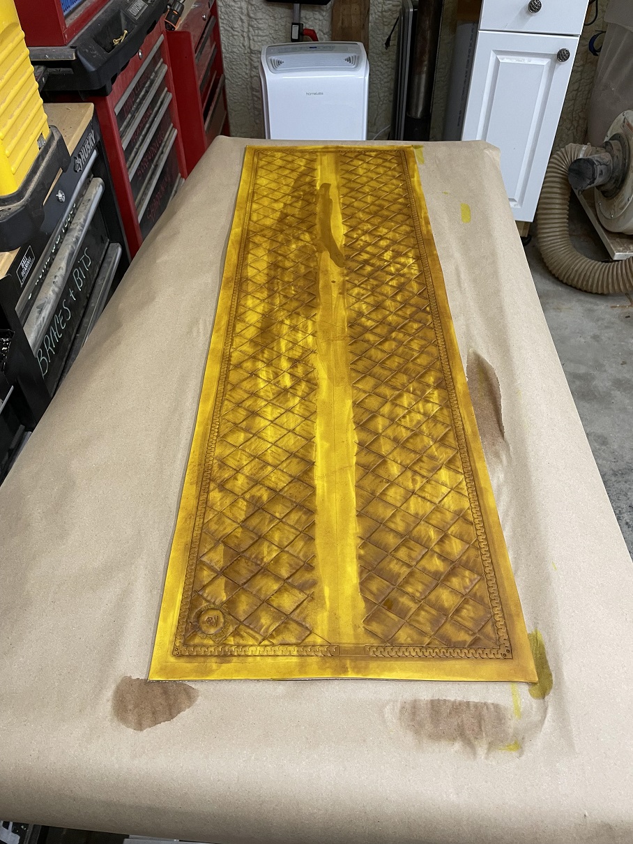

After covering the work table, I dyed the panel yellow for a base. JUST a base, a lot of folks HATE that yellow, but it's JUST the base. Once it's antiqued, then treated with the Natural Watco Oil, it's toned down and gives a rich glow to the project. It should look good behind the knives.
55 yellow dye.jpg (465.57 KiB) Viewed 2445 times
