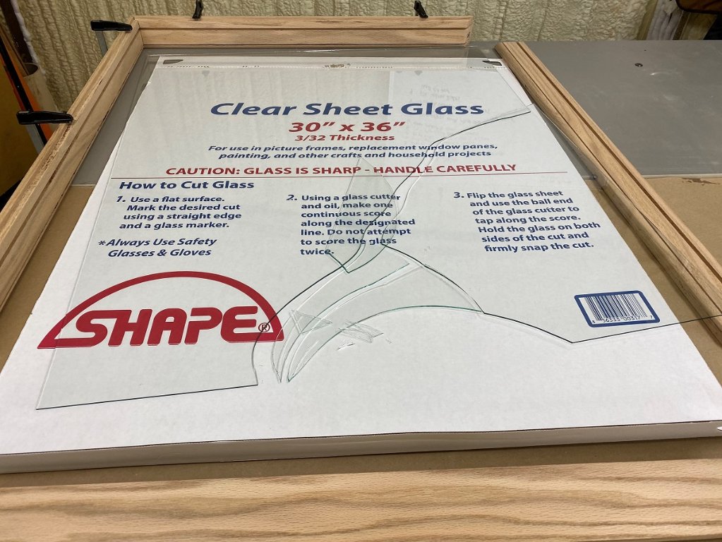

In the picture you can see how I have clamped the top and side pieces to the work table to form a corner and have the second side ready. The dado we are using is the lower dado, 1/4" off the table and the cardboard is padding the table. I am trying my best to reduce any strain or chance of damaging or stressing the glass.
Then, as I was inserting it in that lower dado in the layout.... BOOM...
04 boom.jpg (165.22 KiB) Viewed 4760 times

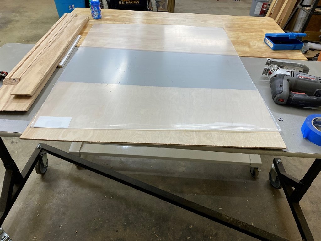

and set about prepping the Plexi for a cut. If it had been glass, I would have set up the table saw, and cut the top and bottom frame piece dados a bit deeper to absorb the extra length, but... it's plexi. I can cut that. It just takes CAREFUL cuts.

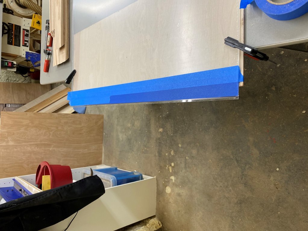

I marked the glass with a permanent marker, then added an extra layer of protection to the sheet with painters tape. Wouldn't want to scratch the glass below the jigsaw.
03 prepped to cut.jpg (123.17 KiB) Viewed 4751 times
Some folks will make the cut with the bandsaw, but on larger sheets it's too easy to let the sheet bind and CRACK, you are out another $40. I prefer this route. I placed a piece of luane under the edge of the plexi, then clamped it firmly to the table. If it shifts and the moving jigsaw blade binds. CRACK... you are out another $40. Seeing a theme here? I got out the jigsaw and set that up.
04 jigsaw.jpg (137.69 KiB) Viewed 4751 times
I chose a medium fine blade with room to clear the debris, and turned the saw down to the lowest speed... plus I was EASY on the trigger as well. Cutting too fast MELTS the plastic rather than just cutting it and the melted plastic recools in nasty rolled edges. Cleaning them up sometimes causes the plexi to CRACK... and .... well, you know.
I puckered up, and made the cut, following the line of the tape, and keeping pressure on the saw, but not too much. I cut steadily, but NOT too fast. Don't want to melt, I let the blade do the work. In the end, I got a nice clean cut.

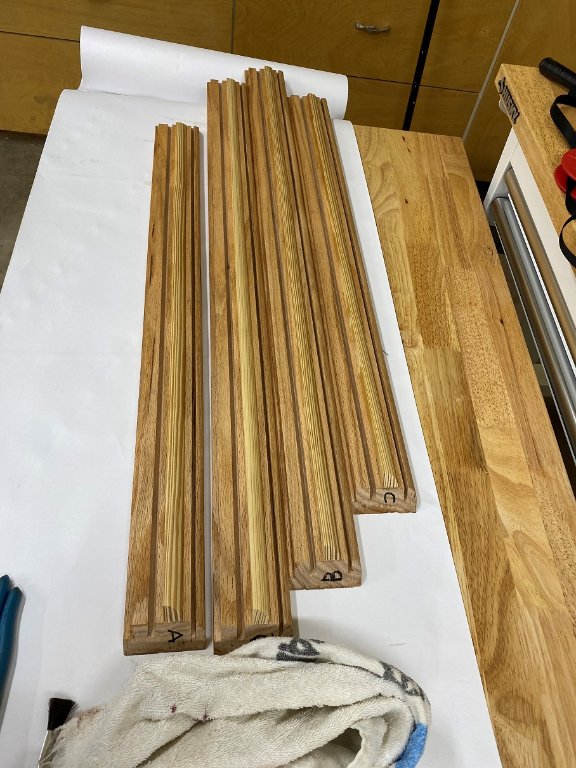

The first step was to tape off the joints. You want to keep any and all solvents off the joints so that you will get a good glue up when the time comes. I use painters tape and cut an oversized piece, then rub the edges and trim them with an exacto knife.
06 joint protectection.jpg (104.41 KiB) Viewed 4750 times
You may get some bleed around the edges but the bulk of the area will stay free of stain or (if you are using it, varnish,) and you can count on a sollid connection between your joints. I took my time and protected all eight ends.
07 all taped.jpg (125.89 KiB) Viewed 4750 times

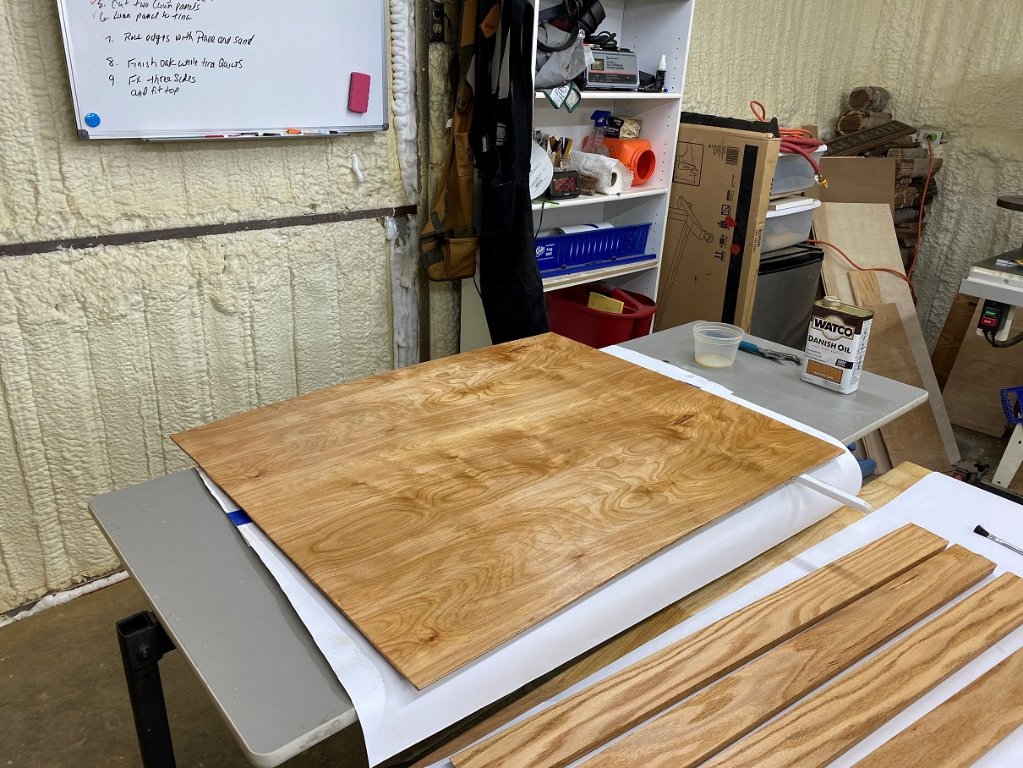

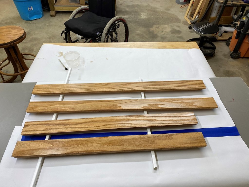

Next I gloved up and coated all four frame pieces with two coats of Golden Oak Watco and set them to drying. The pale area on the frame pieces is actually a reflection of the overhead LED "Daylight" lights. Those pups are bright. In the back panel pic below you can see the colors are even.
08 watco oil.jpg (131.7 KiB) Viewed 4750 times
The last item for today was the back panel. The "show" side got two generous coats of oil, while the inside got a single coat of watco. It won't ever be seen, unless the owner pulls the center panel to rework the display, but watco penetrates and protects the wood, reduces the chance of cracking from drying out. So, a coat to the inside of the back panel as well. With this hanging on the wall, no one will see that I stained and waxed the back... but I'll know.
09 back panel.jpg (197.35 KiB) Viewed 4750 times
