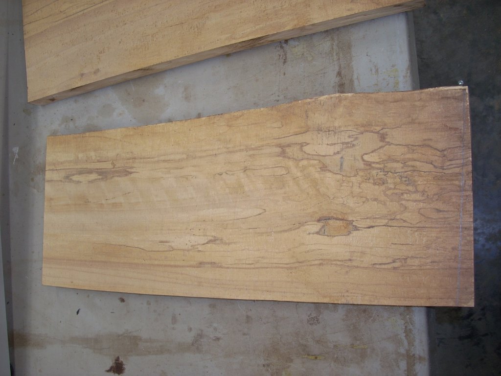

Worked yesterday, including a long session processing the slab Miss T chose for the ends of the chest. When I got it into the shop, it turned out to be...
Highly figured spalted maple. :shock: I'll have pics up and a detailed processing narrative later today. :lol:

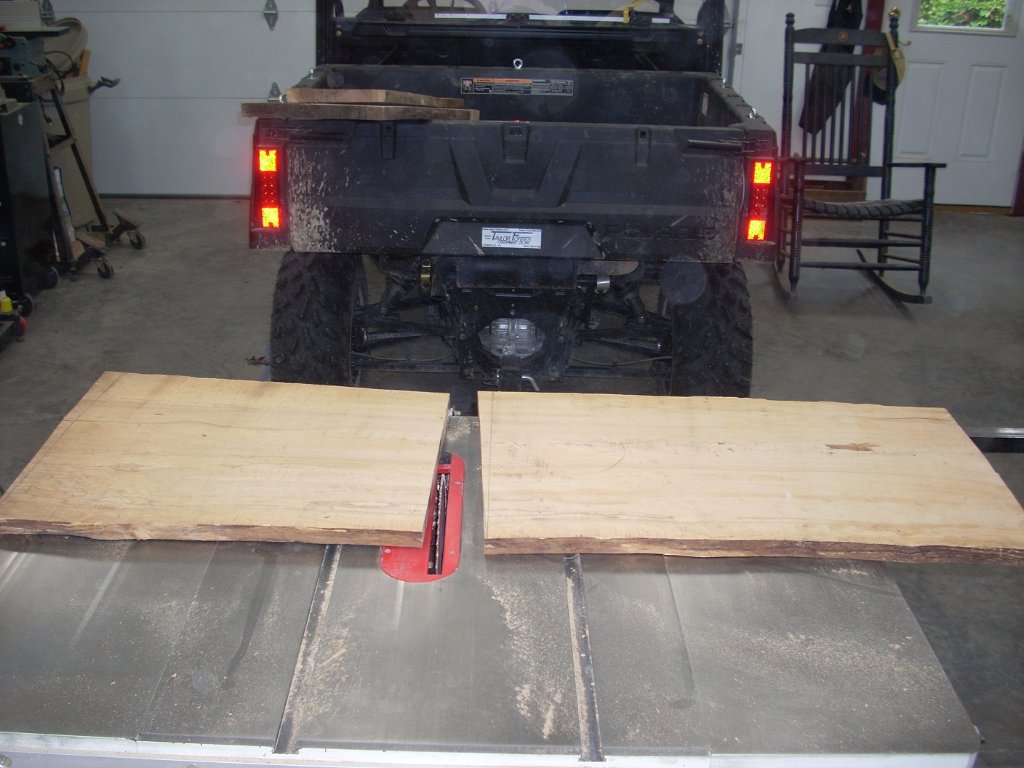

I spent the last couple days working on the project, and though Miss T thought she had pulled a couple slabs of walnut from the barn, once I cleaned the dust and grime of ten years or so of storage... it turned out to be nicely grained spaulted maple. :D Since I was going to do the end panels first, I used a square to mark a reference on one end with the nicest grain, and trimmed that off, then cut off a piece 19 inches long.
01 first cut.jpg (158.96 KiB) Viewed 3797 times

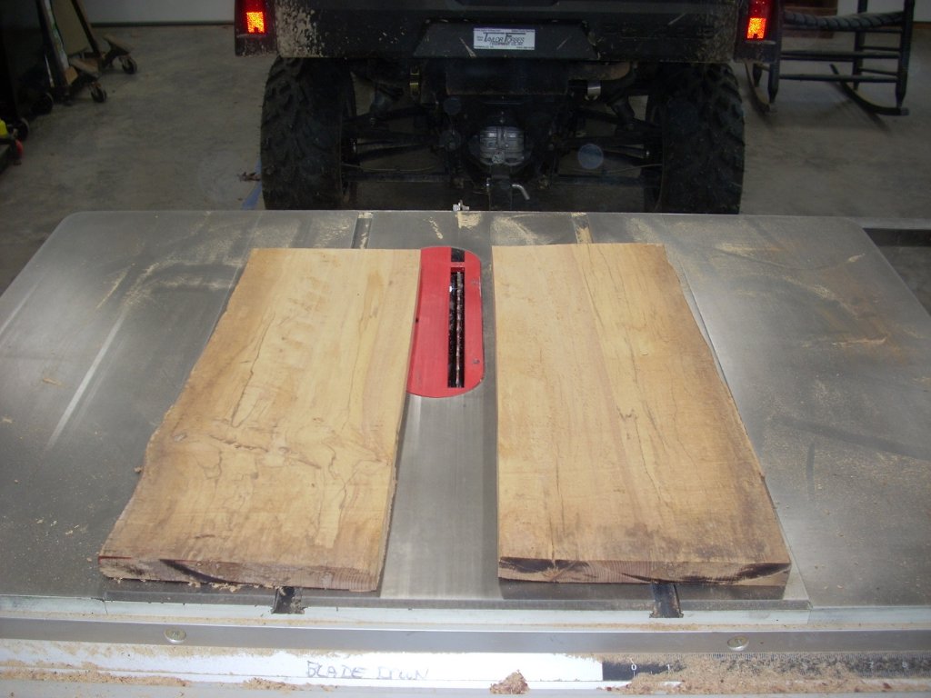

Checking it carefully, i determined it was badly bowed, and would need some correction. More than I thought my shoulders were up to with a hand plane. Sadly. So, I ripped it in half.
02 rip cut.jpg (148.04 KiB) Viewed 3797 times
This would make it much easier to bookmatch on the bandsaw. (Or so I thought... I later ended up ripping each half again.)

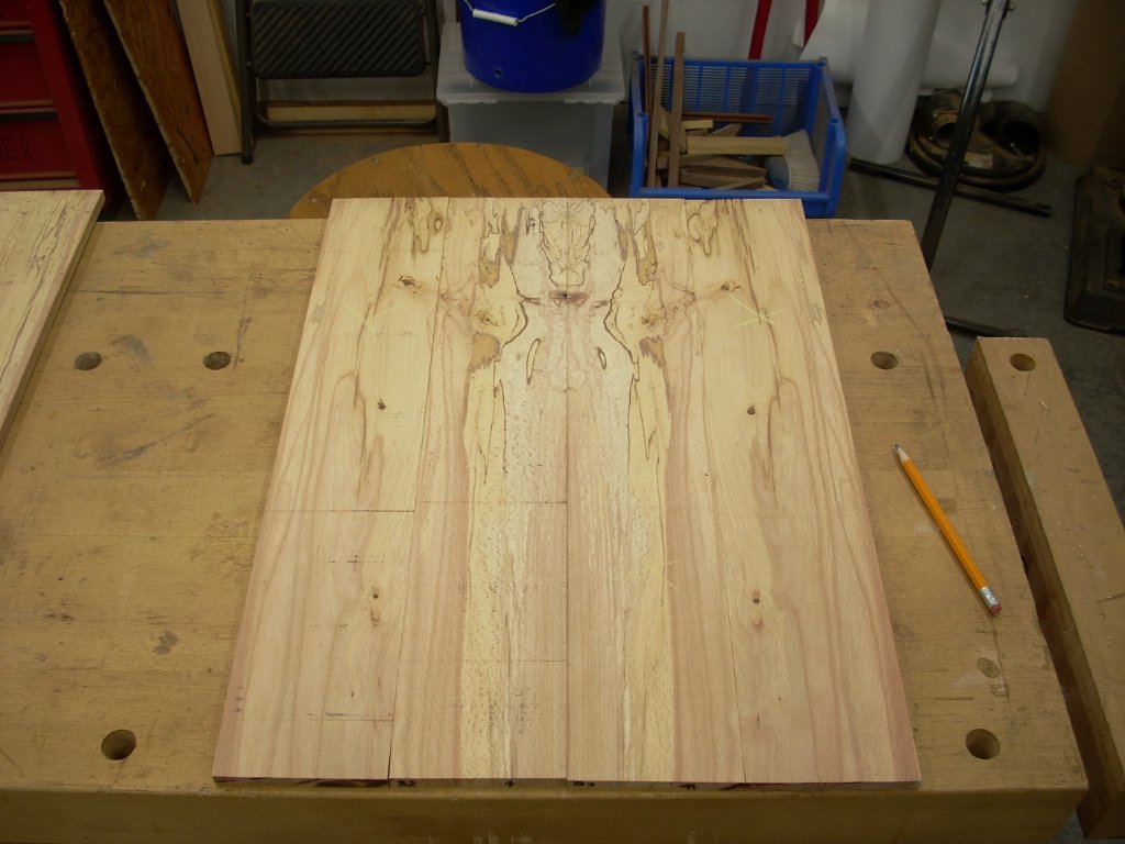

Look at the grain in this piece... beautiful.
03 nice spaulting.jpg (145.33 KiB) Viewed 3797 times

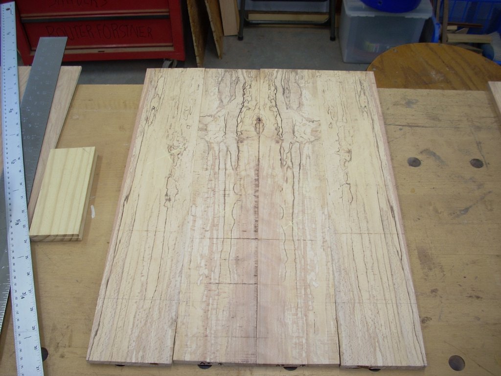

Here are the end panels awaiting glue up. They are approximately 16" x 20" at this point.
04 end one.jpg (166.83 KiB) Viewed 3797 times
05 end two.jpg (152.33 KiB) Viewed 3797 times
After they are glued up, they will be cut to shape and set aside for sanding.

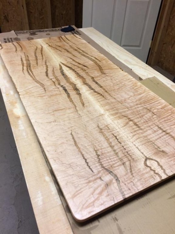

This is our coffee table top before he assembled it
