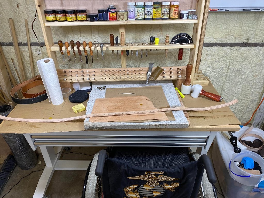

I got the text from the Kid, the strap needs to be 55". :? Do I have a piece of decent leather that long? Before I start that project, there is something I have been meaning to do to my BENCH for a decade. NOW is the time to do it. I clamped my five foot rule to the top of the bench and used the square to mark inch reference lines down the front edge. As exact as I can get them, but not perfect. If I need exact, I'll still measure, but when rough is good enough, this will be there. Then I put two coats of clear poly over the layout to protect it. Will come in really handy when checking the layout of large sides of leather. ;)

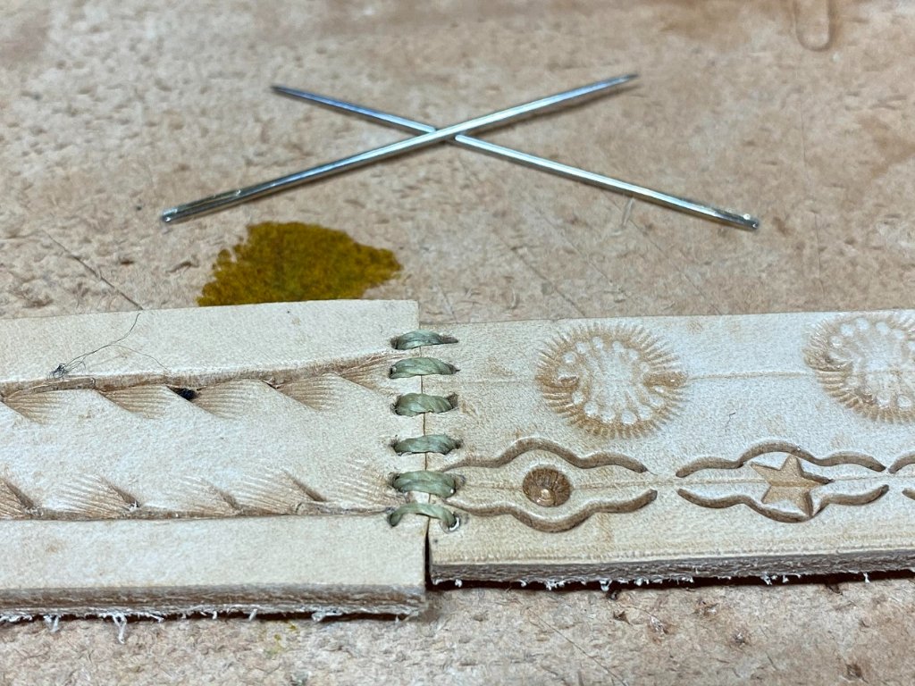

I didn't think I would have a single strip long enough for a one piece strap, so I rewatched the videos on various stitches. The X stitch has a straight bar on the back that looks good and is a very strong "Butt" stitch. I used scraps to practice that. It worked out very well. It was too late to start on the project and I wasn't up to it that evening anyway, but would be ready the next day. Good progress. I had also worked on sketches for a 22 ammo belt pouch. ;)

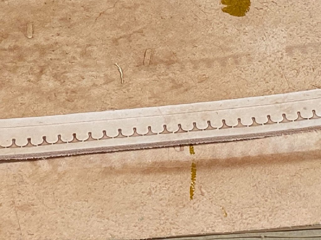

I used the dividers to mark a 3/8 wide area down the center and got busy. Four stamps per inch, times sixty inches. Two hundred and forty stamps. Oh, per side. Slow and steady would be the rule here.
04 one piece.jpg (201.52 KiB) Viewed 12955 times

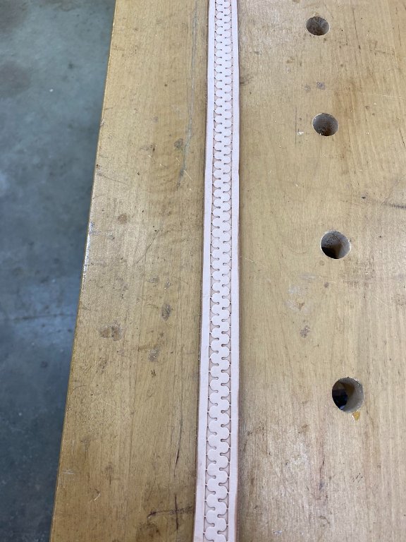

I worked my way slow and easy down the one side and by the time I was at the end, my hands and neck and shoulders told me it was time for a break. Lunch, brunch, snack, or nap. Call it what you will... just take one.
05 slow and easy.jpg (145.3 KiB) Viewed 12955 times

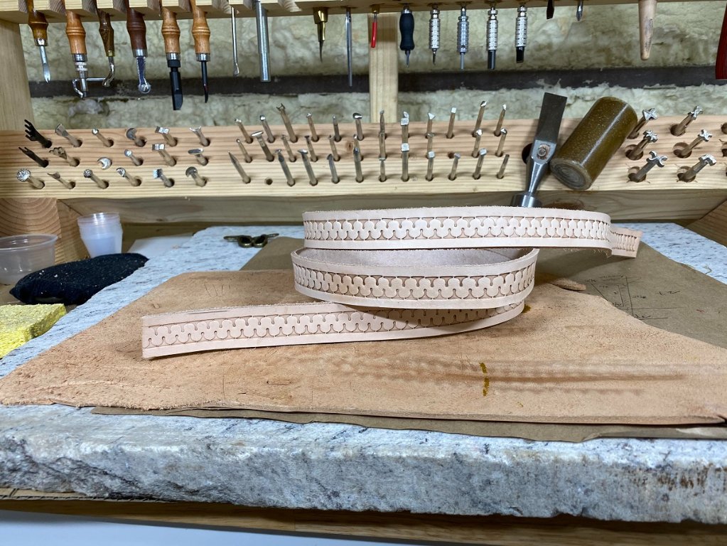

I came back out after lunch and a movie, and finished up by coming back down the other side. Coming down the other side you align the point of the stamp centered in the existing pattern and the base with your reference line and stamp. Repeat. Two Hundred and forty times. ;)
06 done.jpg (202.29 KiB) Viewed 12955 times

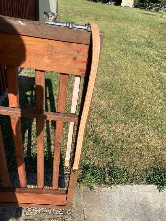

14 completed.jpg (149.14 KiB) Viewed 12948 times
The snaps hook into the D Rings sewn into the back of the pouch and she wears the strap diagonally across the body with the pouch on her left hip.
