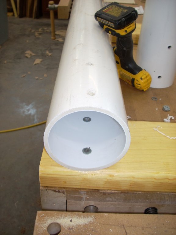

Miss Tina had picked up the 6" pvc pipe for me and I set it aside until I had time to make use of it. I got that window yesterday and cut it in half, which would give me plenty of room to work with wide cutting boards or serving trays, or things I needed to glue at an angle. First step was to drill the holes to screw the pipe to a base to hold them steady. I have seen them with individual bases, or on single. I decided to space them about 12" apart and go with the single spaced base.

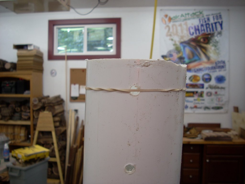

I drilled a top hole large enough to admit a screwdriver. The lower hole just needed to pass thru a screw. :) Then came the issue. I didn't have a bit long enough to go thru the pvc and hit the bottom of the pipe. :o What to do here. The pipe was too thick to drive a spike thru without cracking and I don't have a torch. (I thought of heating a rod and melting thru.) Then I saw the bag of rubber bands on the shelf. :P

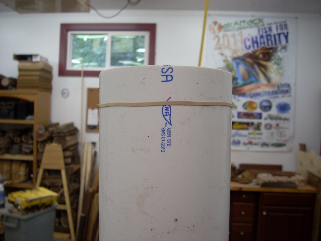

I put a rubber band around the pipe and leveled it as best I could. NO bolt would pass thru, and it needn't be perfect alignment. I was just going to have to screw the dang thing down. I used the rubber band as a guide, turned the top hole to 6 o'clock on the base and used the band to find the alignment on the bottom. Boom, drill the screw hole.
01 mark the front.jpg (112.04 KiB) Viewed 5306 times
02 rotate to the back.jpg (112.46 KiB) Viewed 5306 times

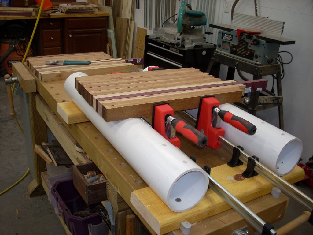

Once all the holes were drilled, I aligned the pipes on the bases and squaring them up with the bases and the workbench, screwed them down. Worked like a champ.
03 screw down.jpg (89.58 KiB) Viewed 5306 times

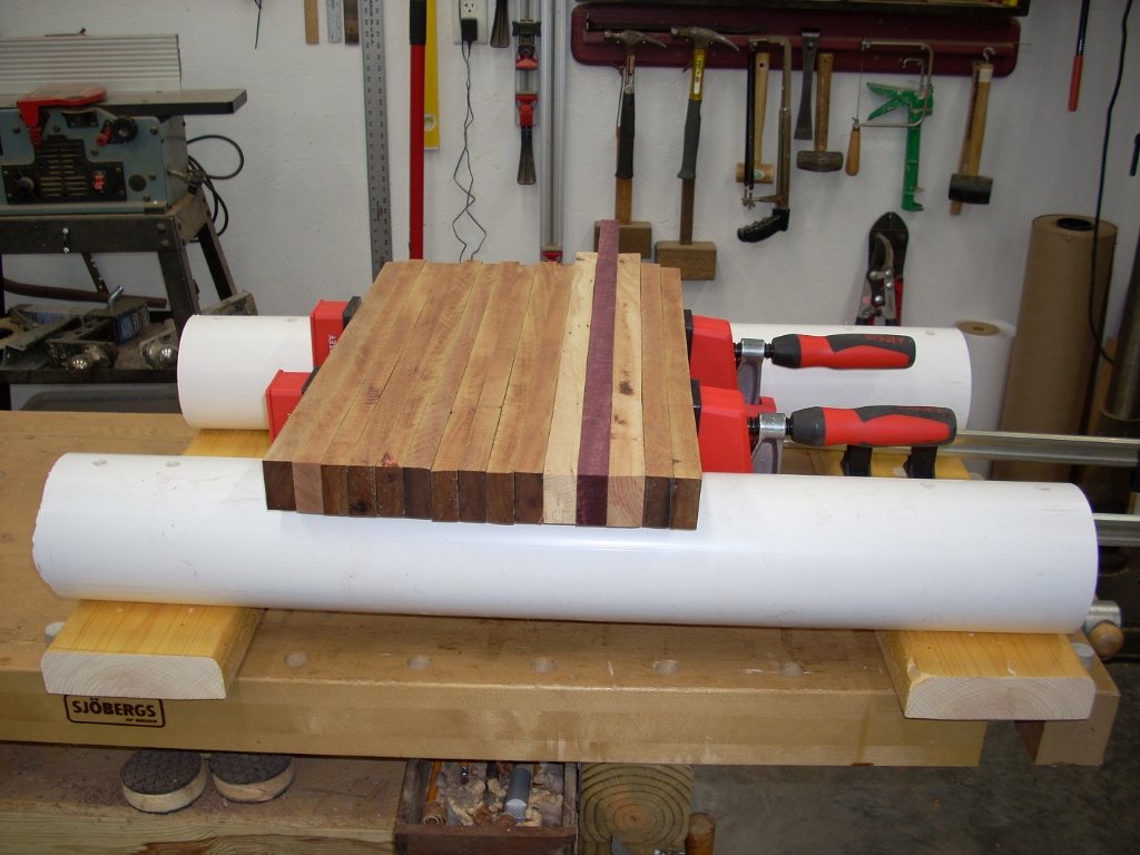

This is only a mock up as the components for the next two cutting boards have NOT been properly prepared, but as you can see, you can slide the segments along the PVC to align, then slip clamps easily under the components of the cutting board and tighten. Then you can place clamps over the top and do the same while they are held perfectly level. You can also place cauls above and below and clamp those in place, then lift the complete assembly off and set aside moving to the next project, wiping away any glue and starting fresh. No need for paper or protection.
04 clamp down and use.jpg (166.93 KiB) Viewed 5306 times
05 side view.jpg (153.7 KiB) Viewed 5306 times

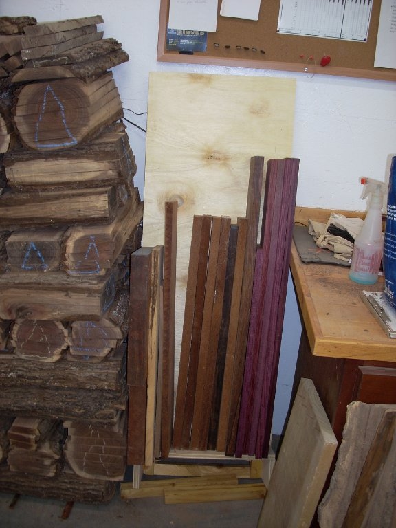

I had been concerned for a while that some of the more valuable wood standing in the slot between the workbench and the cabinet may be at risk might be damaged by warping and the idea for a rack to protect it had been pinging in my head for a while. Miss Tina brought an easel frame I had made for her to use as a display when she took things to her craft shows and said she no longer needed it, so I disassembled that and made the rack I had in my head.
The rack is angled back at about 20 degrees and fully supports the wood on the bottom and back, and the woods support one another side to side. No chance to warp. ;)
The woods you see in the picture are all exotics that will call you big bucks at woodcraft. Cocobola, Purpleheart, Curly Cherry, Black Cherry, Australian Lacewood, etc. Last thing I wanted was for the wood to warp from leaning over too long. The rack will support the wood and keep it stable. The other woods not IN the rack are off cuts or woods I will use quickly, or woods cut recently and NOT planed or straight yet. :)
06 wood rack.jpg (120.22 KiB) Viewed 5306 times
07 in use.jpg (125.35 KiB) Viewed 5306 times
