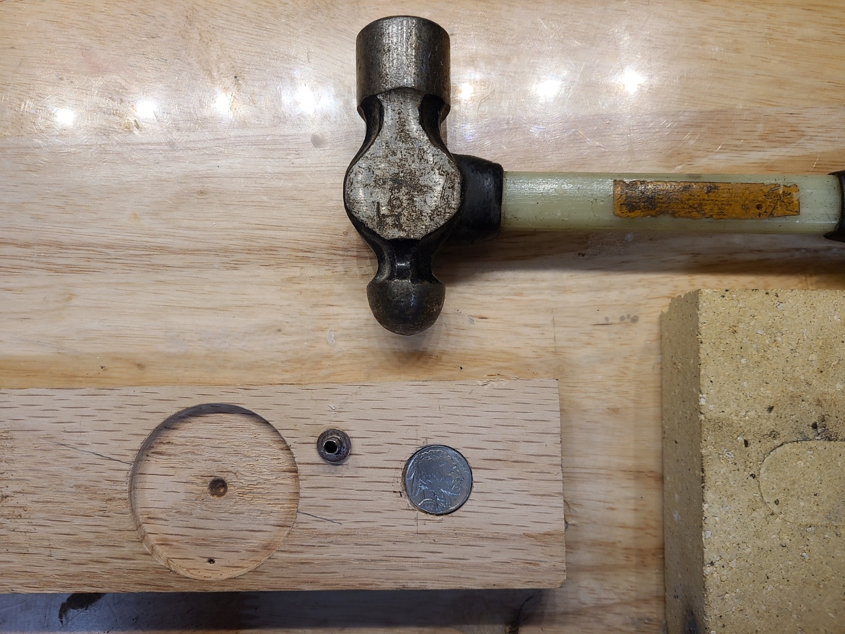

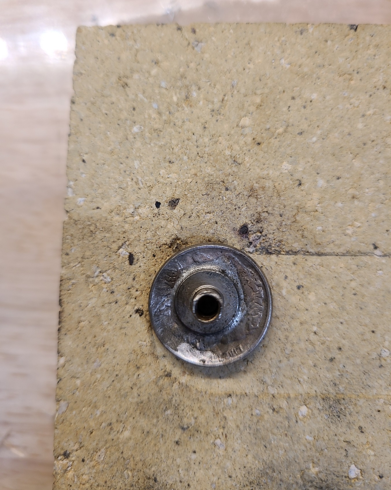

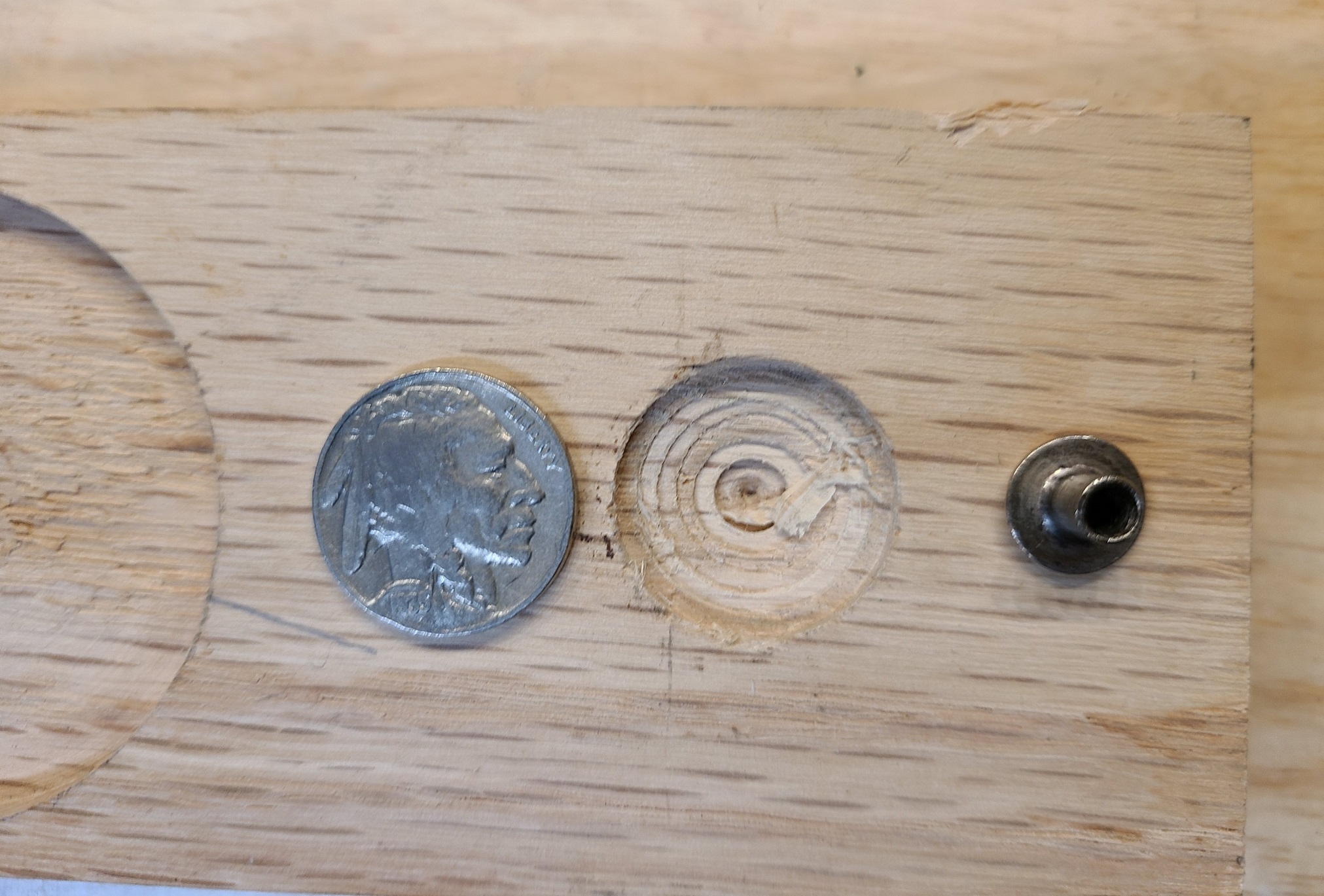

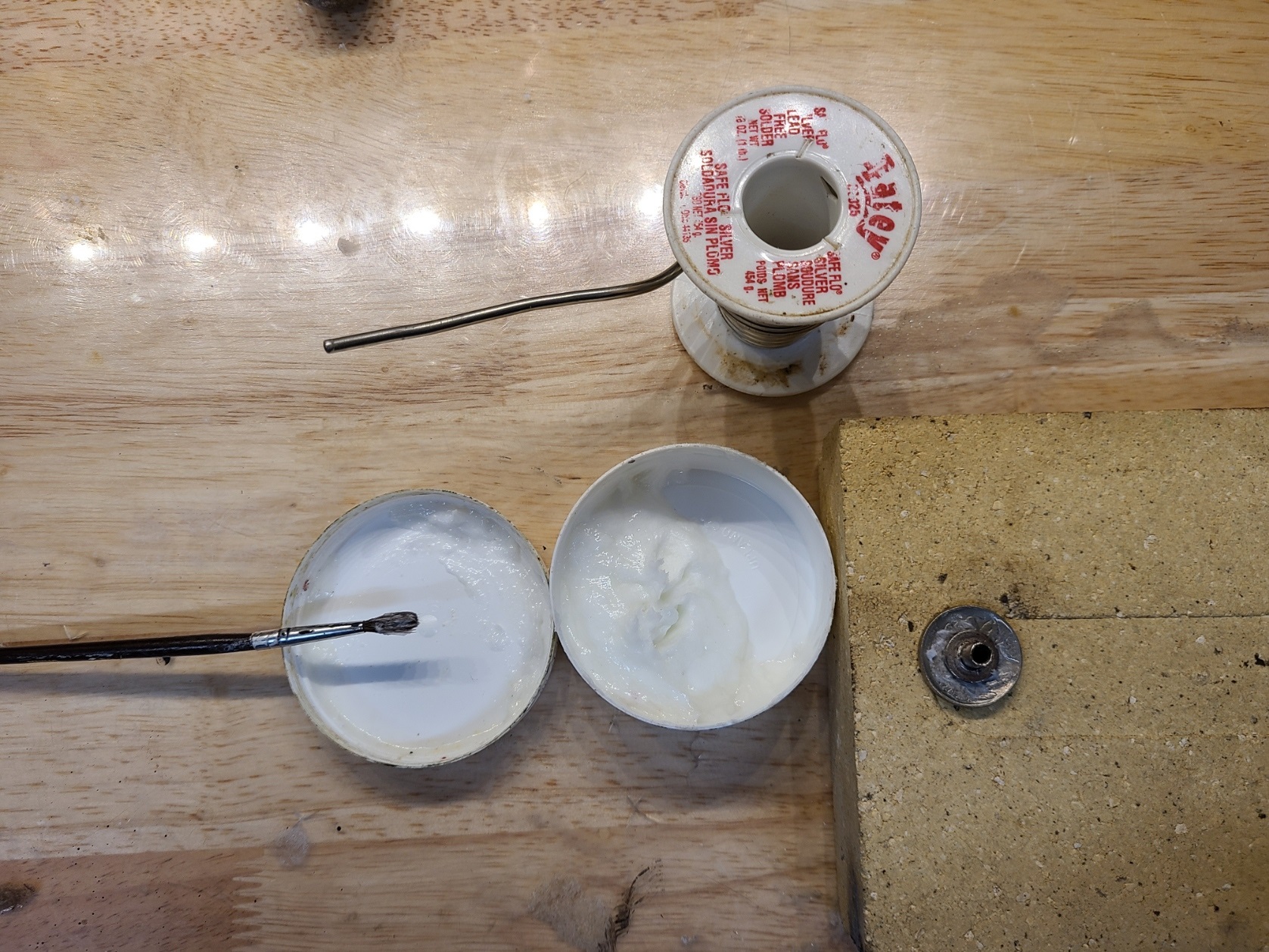

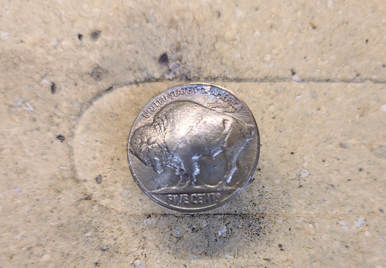

First, I put the nickel in a wooden block which I have made a depression in with Forstner bits. Then I use a ball peen hammer put it on the nickel and hit the hammer with another hammer while wearing safety glasses. Then I take the concave nickel and put it on a fire brick and flux the nickel and female face of the chicago screw. Center it on the nickel and use silver solder with a fine tip map/oxy tourch let it cool. Then take a wire SST brush and clean it up. To make snaps use the same process except place the male end on the nickel. You can use this process for just about anything from copper to SST.

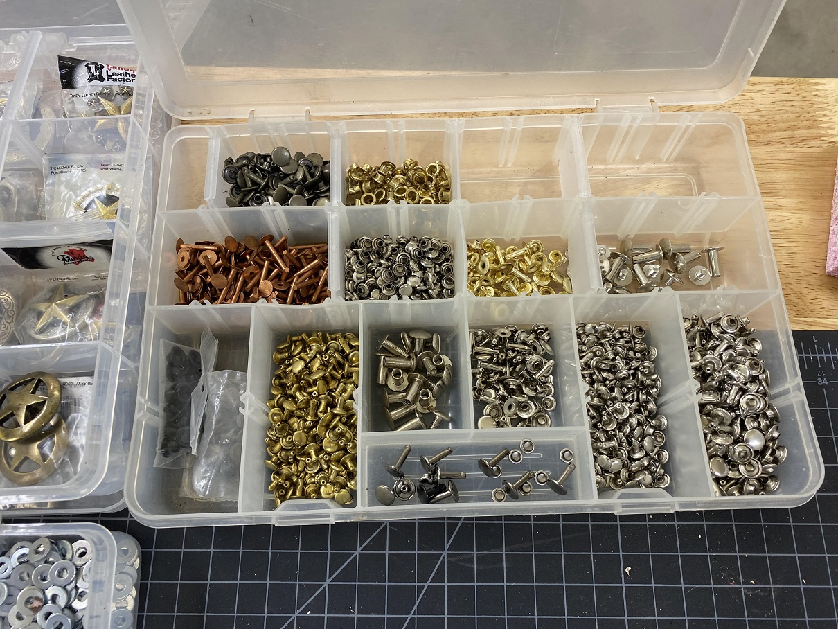

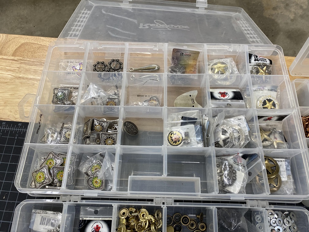

Thanks for the tip. I was lucky enough to come across some leather accessories at a surplus store, and made an offer on three trays. The seller was trying to sell the items individually. He could have eventually, but... it would have taken years. I managed to buy all three trays for $100. Anyone who has bought these things knows the value. Any one of the trays far exceeded that $100. Much of the content was still in the packages, and I only cut them open and sorted them to get some organization. The conchos alone were worth twice what I paid.
I also found rivet and snap setting tools mixed in with the rest.
I have used a lot of the snaps and rivets, and used the jeweled accents on a pouch for the granddaughter and a sheath for the wife.

I have done other items the same way. If doing coins make sure the depression is the same size as the coin and to the depression, you need. I found forstner bits make a great graduated hole. I also have an arbor press that works great for larger coins. I made several half rounds by cutting large bearings in half which makes a perfect divot. I made a silver dollar belt buckle for a guy and wish I had a picture.
