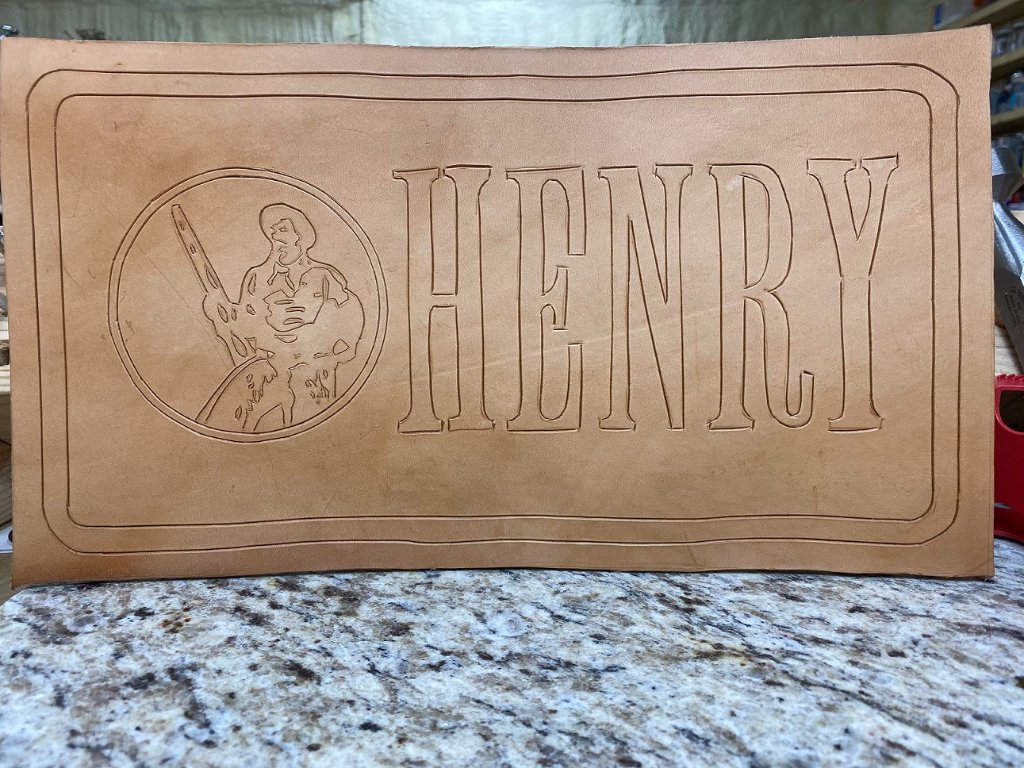

Out in the shop this afternoon for an hour or so, and transferred the stencil to the new leather. This time I found an 8 ounce piece. (Heavy leather, like holster grade.) I cut it 7-1/2" by 13" so you'll have an idea how much bigger the new stencil is. I took my time and was as careful in the transfer as I was in the tracing. I also used the compass for the border of the logo as I did before.
A closer look at the logo, now that it's cut in. This let's us see the details of the logo in the outline. You can "see" it's a cowboy, a hint of a cowboy, but the effect of the cowboy will depend a lot on the shading brought out by the carving and stamping in the leather. Wish me luck here.
I was very careful as well in outlining the border here. This time, rather than square corners, I rounded them, as if they were laid out with a lariat.
I hope it looks good once it's tooled in with the rope effect. We'll soon see.

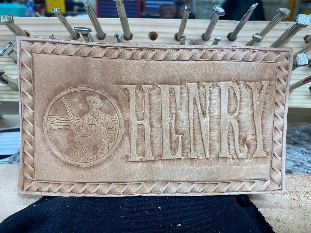

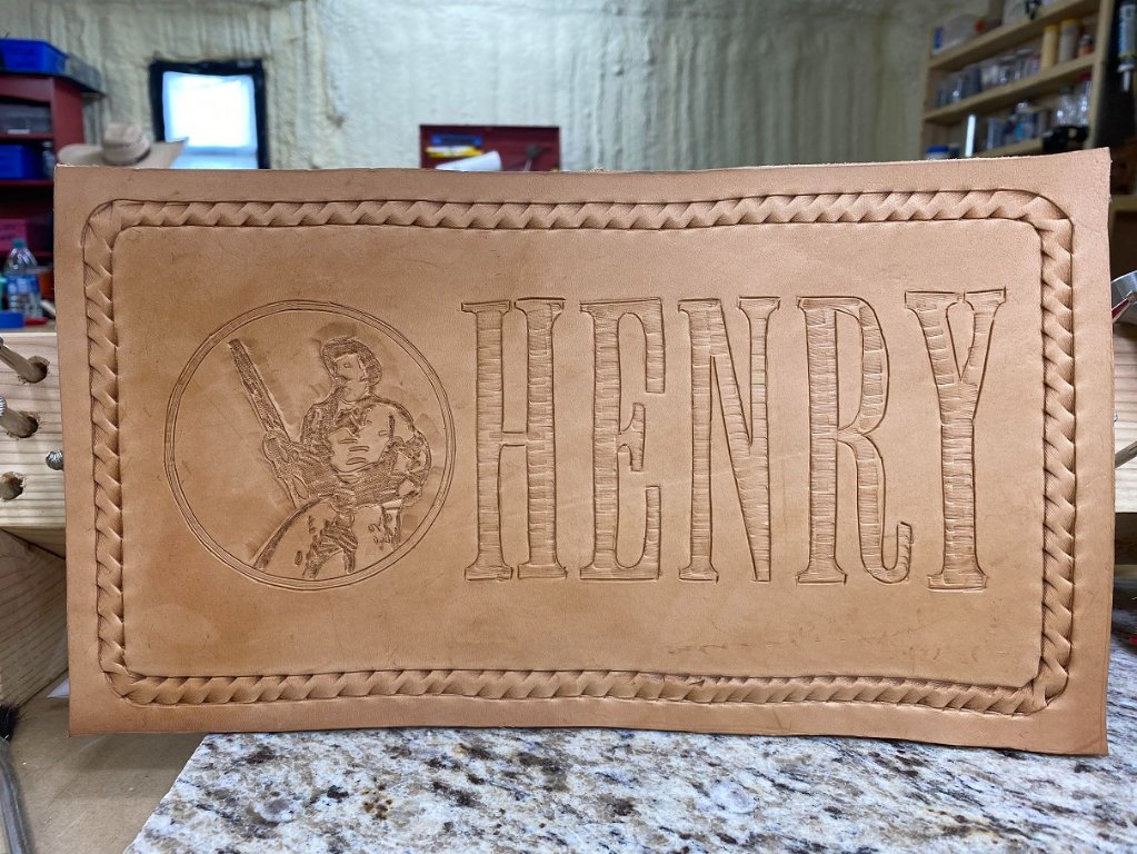

Got back out to the shop to work on the project this afternoon. Raining all day, nothing else to do. I cut in the lettering on the HENRY, and the border for the logo... SLOWLY and carefully not to ruin the arc. Then I cut in the border around the edges where the "rope' will go. Looks good. ;)
I began the stamping and shading. This time I was negative stamping, stamping the background to bring UP the foreground. I used the color sample to know which areas to stamp back for accent. LOTS of black. I have the overnight to think this over. Do I do the orange wash again? I'm thinking yes, but a lighter wash. Just a touch. I can also do a black wash to accent the "black" areas. I plan to finish this in a natural oil, no stain. We'll see how that works.
I'm thinking the rope border works well.

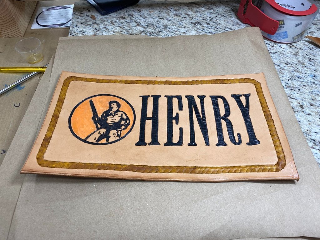

A couple hours this evening in the shop. Paint accents done. I am not ashamed to say my butt was a bit puckered. A slip, paint in the wrong place and I would have been starting over, or rethinking how this thing would have been finished. You can't remove paint as far as I know. :shock: There are some MINOR slips, but no drips or dribbles like on some other practice pieces I just turned around and tossed. :twisted:
I'll let this paint dry overnight and then apply a natural clear finish, or maybe a yellow dye, then a finish. I want to try a watco oil finish, but I have yet to apply watco oil over painted leather. I might have to paint a sample and try it FIRST... I would :cry: if I tried it here and all the paint ran. :P
I was going to wash the rope, but when I mixed the yellow wash, I couldn't get a tint I liked... so... nope.

Back in the shop this afternoon. I had snuck out last night just before bed and painted a test sample to check the staying power of the paint against the Watco Natural Oil. I cut a rope pattern in the sample pattern this afternoon before testing, just because.
Sample paint was stable, even when I rubbed off the oil. :D Then I thought, I should have tried dying the rope with yellow dye rather than painting. Duh.. :shock: :? So, I cut a sample rope pattern again, and dyed it yellow, then coated IT with watco to see how IT looked. I was pleased as punch with the look ...
... you know that meant I had to CAREFULLY stain the rope border on the piece before applying the Watco oil. Slowly I worked my way around the border, inch by inch, ridge by ridge in the border, the pucker factor was high. I got 'er done. Larry the Cable Guy would have been proud. :P
It was time. I applied a good coat of Watco and let it soak in. There were a couple spots along the edge of the leather that didn't darken, but I have a solution in mind. They could have been caused by several things that I know I can avoid in the future, or they could be leather defects. :roll: Still looks pretty darn good. I have a plan or three for this piece. Don't guess I have to burn it. ;)
