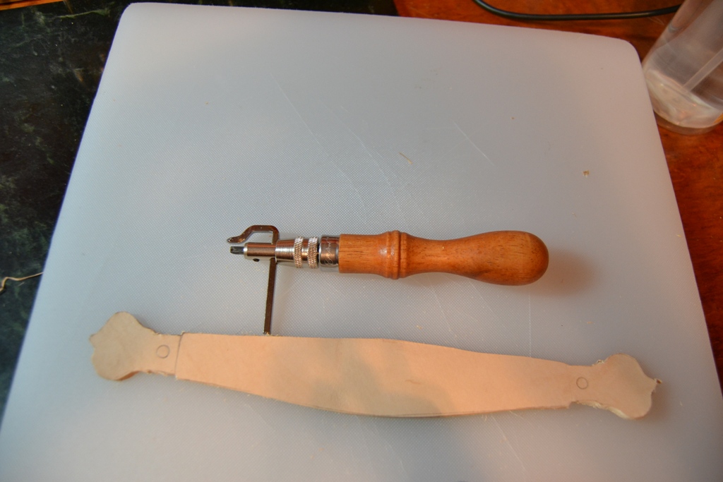

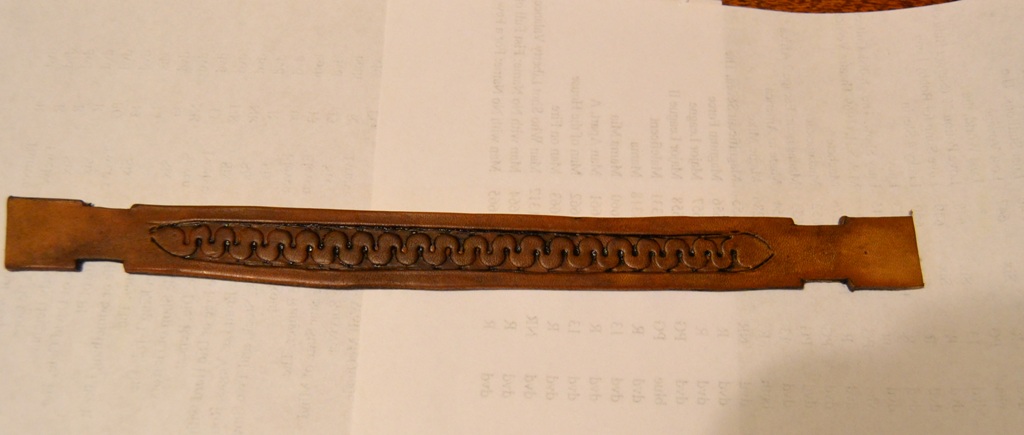

I needed a break from the woodshop, and there was something I had been thinking of working on for the last month or so. I needed a handle for a project I completed a good while ago and the one I ordered was too small so I didn't install it. Now that I have been attempting to do some leather work, I should give it a shot huh?
Here is the original handle. Beautiful Rich Leather.
01 original too small.jpg (234.77 KiB) Viewed 7988 times
Sad part is, that it's too dang short. My fat hands are too wide to fit in the dang thing and pick up the item it's made to fit. :cry:
As you can see in the picture, I am adding about two inches to the length. That should accommodate my fat (wide) hands.
This tool is called a stitching groover. As the name suggests, a couple passes will cut a groove the stitches sit down in when you stitch the project.
Stitching on this project are for looks and to make the edges stronger. We aren't stitching anything together.

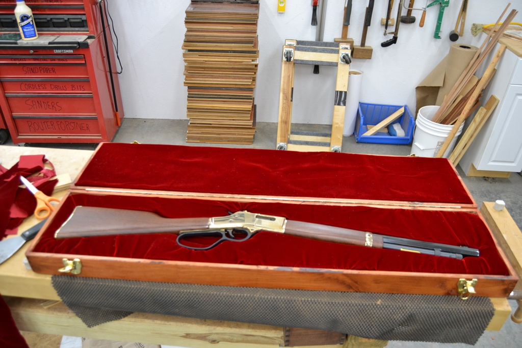

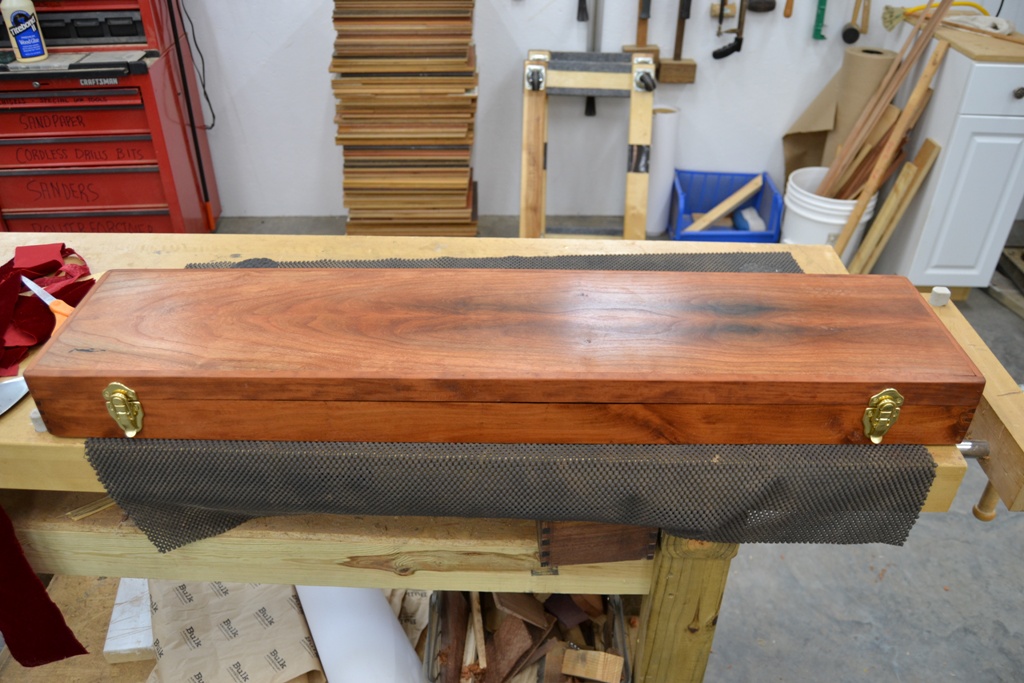

What? What is the handle FOR?
This guy.....
and it closes.jpg (271.47 KiB) Viewed 7988 times
It's done.jpg (256.36 KiB) Viewed 7988 times

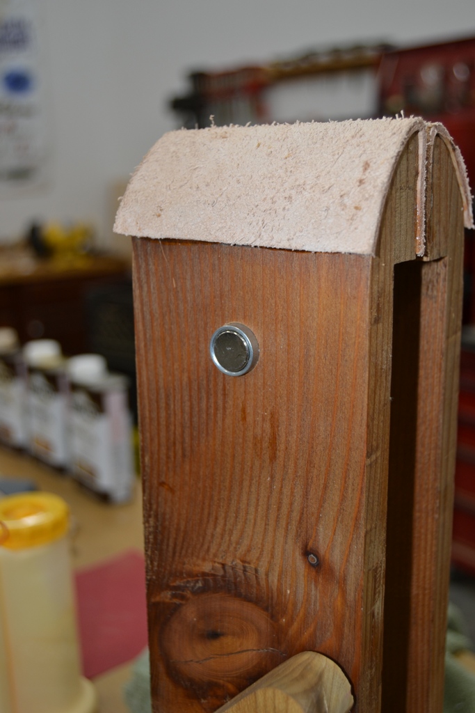

I did get out to the shop this morning and make the mod to the Stitching / Lacing pony. I let the magnets sit a bit proud intentionally, so that it will be easier to grab the needles.

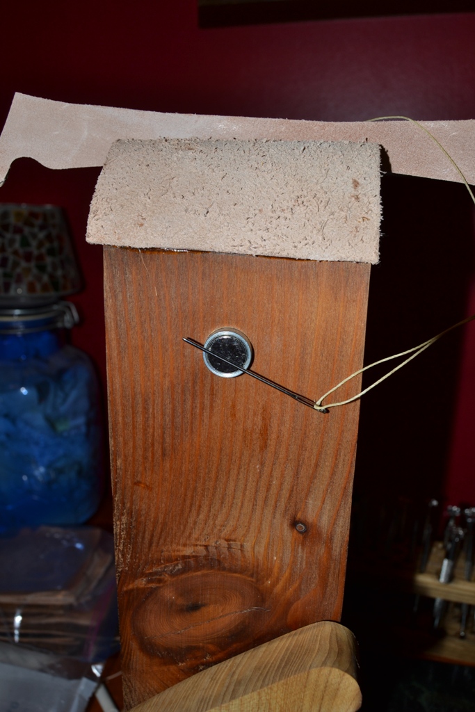

As you can see, the magnet will hold the needle and thread exactly where and how you place it. A problem the old way, when you let it dangle, when the thread started to get short, the weight of the needle would cause it to fall off the thread and get lost in the carpet, bounce under things, or worse. This had secondary problems such as inappropriate language or wasted time. Old Grumpy Marines don't have time to waste, who knows how much we have left. :lol:

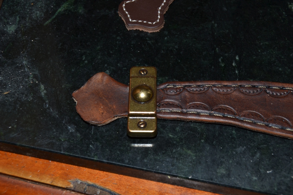

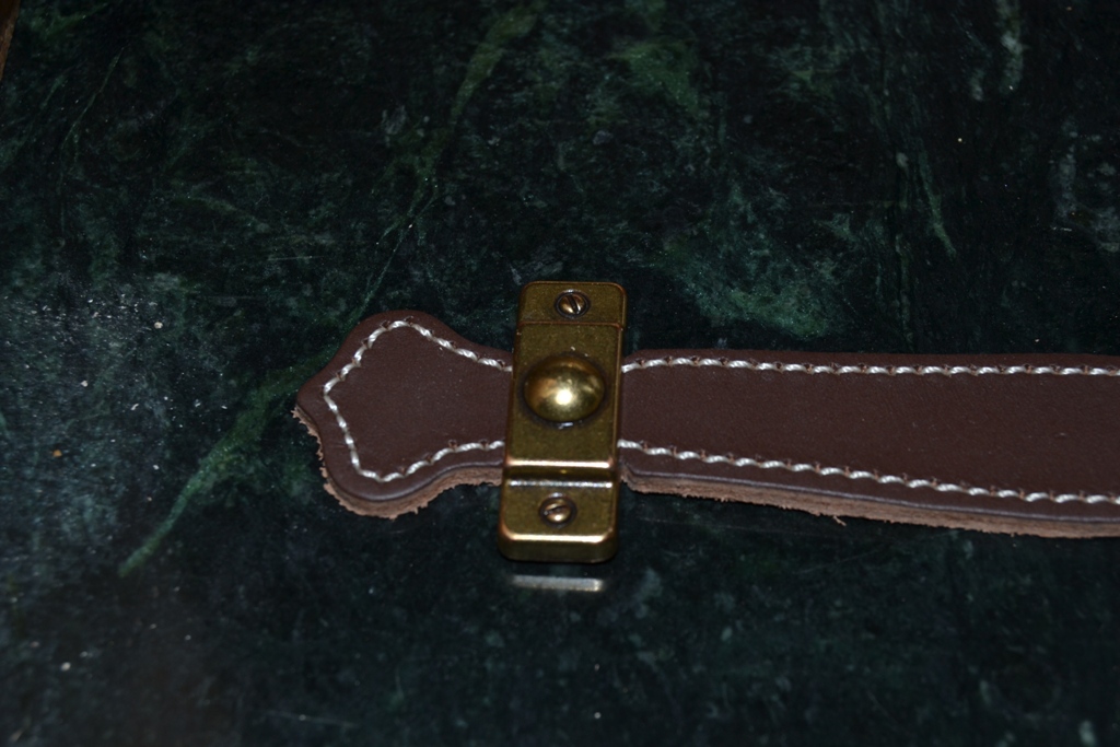

Here is a peek at the actual bracket that will hold the handle in place. The screw will come from inside the gun case and screw into the bracket. I show it on both the old and new leather, and as you can see, the un-dyed stitching looks much better, at least in my opinion. I'll wait until I have dyed the NEW handle to stitch it up. Yup, I'll cut a new one and do 'er up this evening. Meh... nothing else to do in the evenings unless I want to watch movies or tv... What's the fun in that?
bracket on new handle.jpg (319.01 KiB) Viewed 7980 times
bracket on old handle.jpg (274.39 KiB) Viewed 7980 times

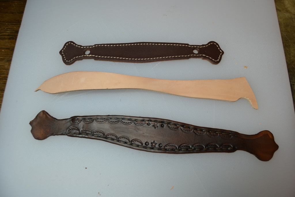

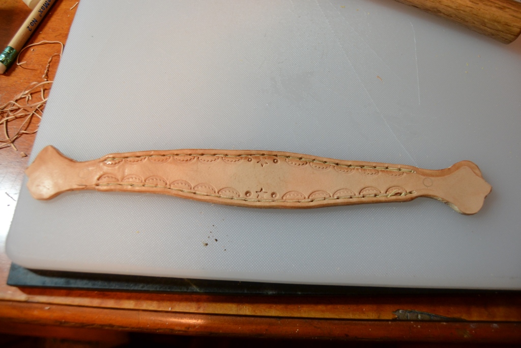

I took that second try at the handle. A new style (shape) to the leather portion and a new design to the decoration. This design is called the "Running W" or "Carlos" border... I like it a lot.
Second Try.jpg (128.89 KiB) Viewed 7977 times
I haven't done the stitching yet, will wait for the dye to dry. Once I get the stitching done, I'll add the Mink Oil and see how it turns out. If it's a looker, I'll consider adding it to the gun case. Since the gun case doesn't get used and is just for display... :roll: ... it's academic.

I like your second handle best, the one with the crescents and stars.

I like the first one better also. Great job. Wish I could do stuff like that.

Thanks guys, i'll probably redo the first style then, with more care during the layout, cutting out, and of course, stitching after the dying stage of the project. I also noted that the stitching was done proud on the original piece, rather than recessed in the normal groove. The groove normally protects the stitching in hard wear areas. Placing it proud draws attention, accenting it more, a good thing when the stitching is mostly a decorative touch.
