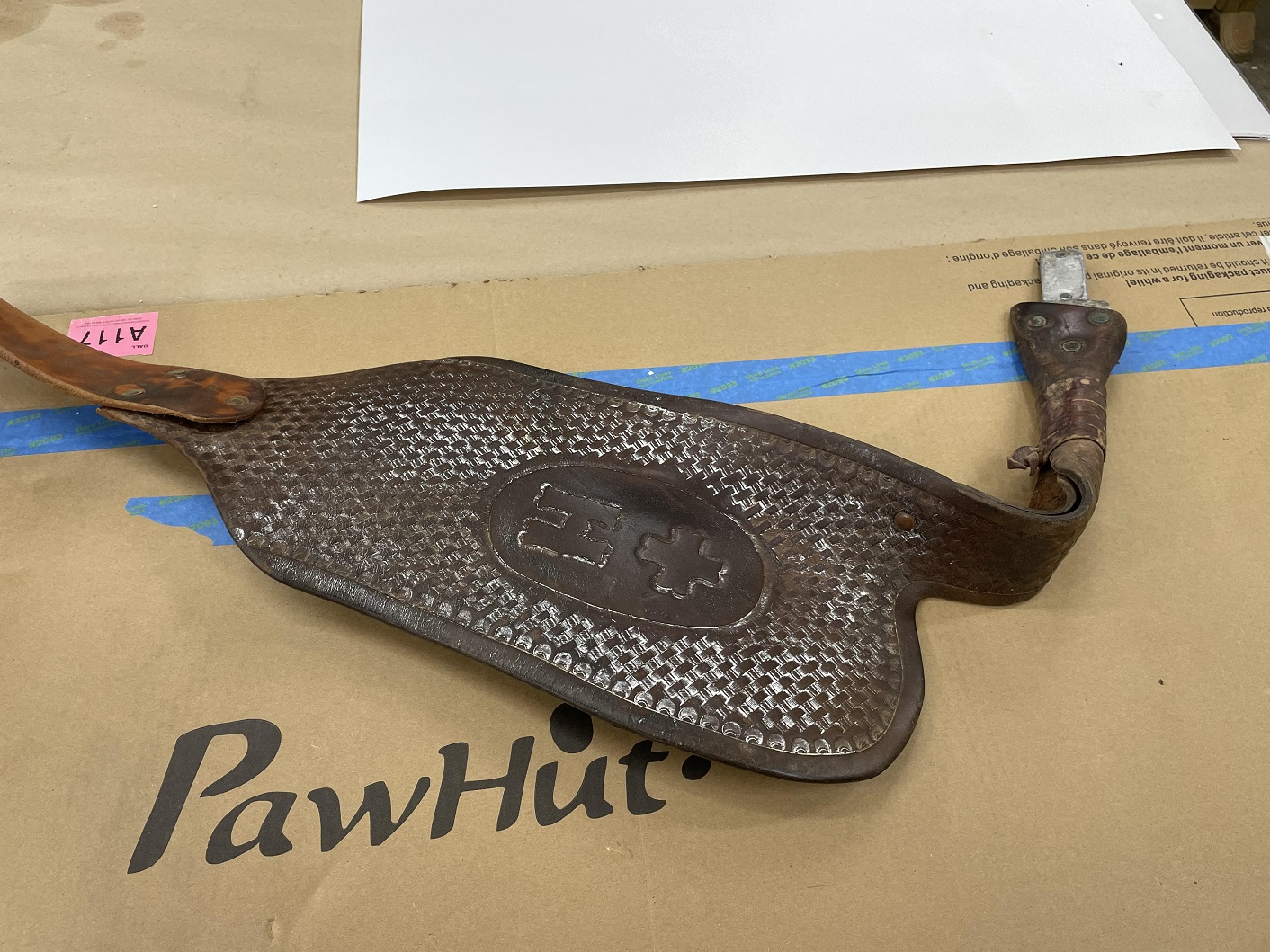

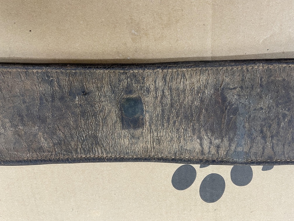

My daughter was up for Christmas, the week after Christmas and dropped a project on me. Seems a friend of hers had a favorite saddle that she had worn out the fenders on. Now, I'm not a horse person, but I do make some stuff out of leather, as some of you know. Belts, holsters, knife sheaths... so she brought the fenders up to me. Seems that Saddles have fenders... they hang off the side of the saddle and the stirrup straps are attached to them. This pair was worn pretty badly.
03 old fender.jpg (536.32 KiB) Viewed 35 times

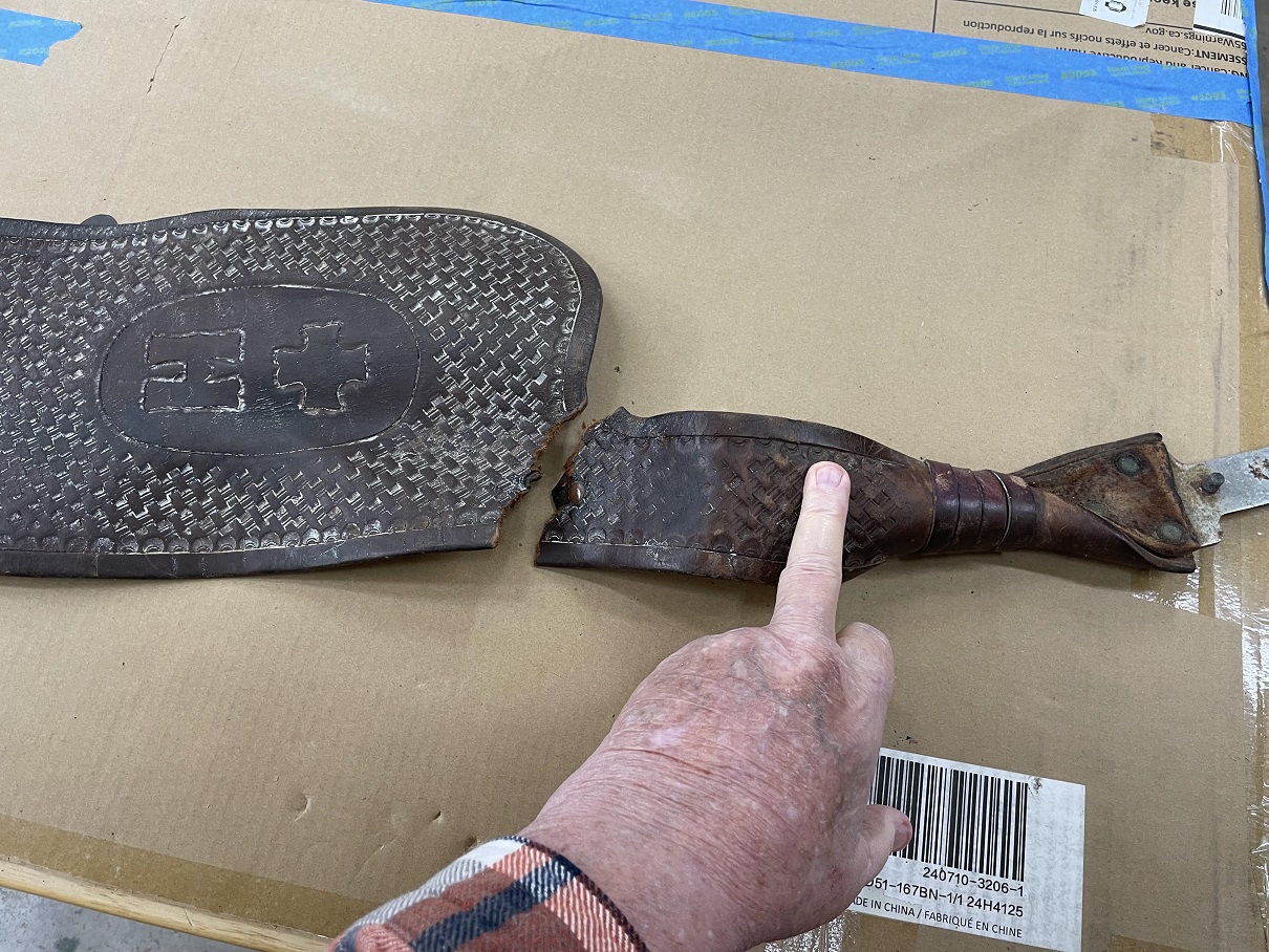

The other side was worn OUT. It had broken.

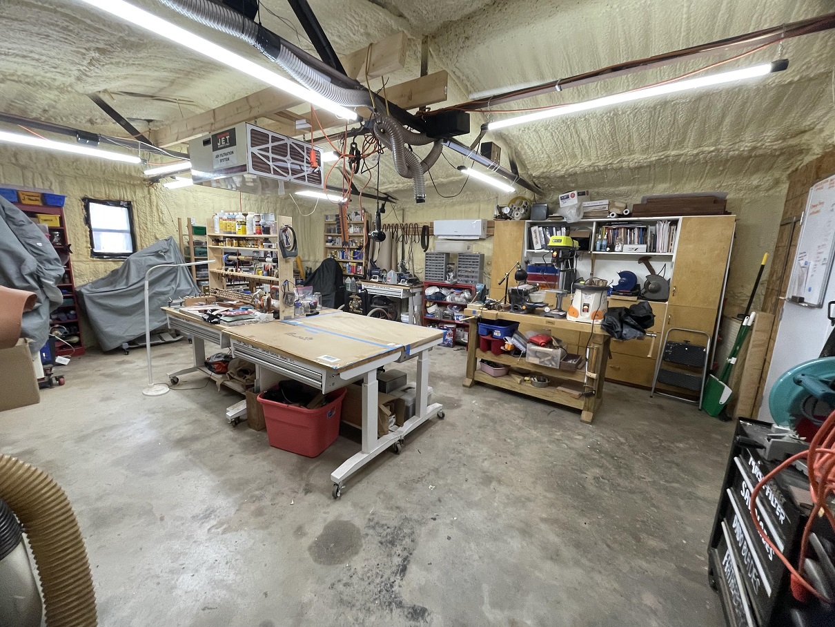

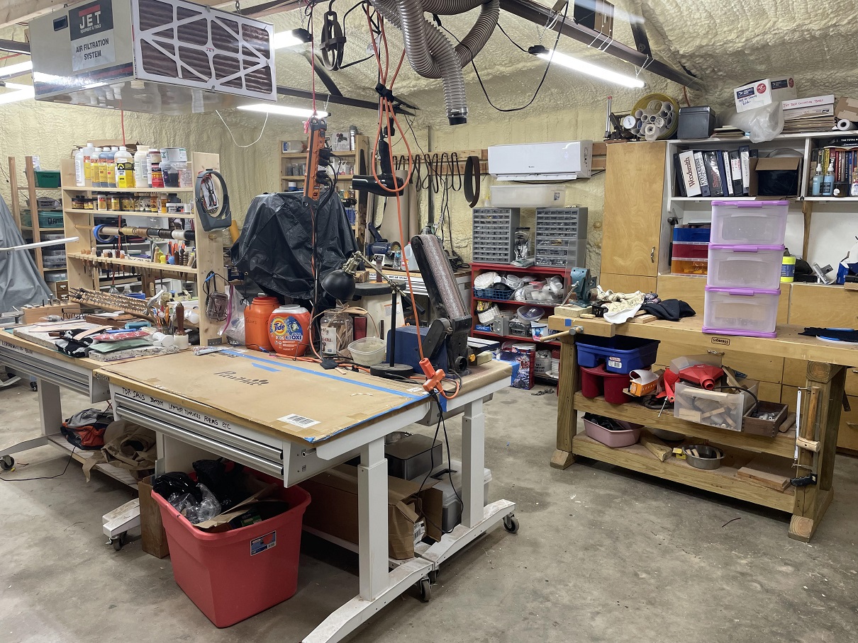

Then I had to rearrange my shop a tad to make the room to work larger projects... in leather.... I started with the shop looking like it always did...
01 the shop.jpg (529.49 KiB) Viewed 35 times
I cleaned off the off side finishing bench of the bench top drill press, oscillating sander, and belt sander used to shape the knives, for now. They went onto the woodworking bench. Then cleaned both the benchtops. The finishing benchtop and the cutting benchtop.
02 rearranged.jpg (501.35 KiB) Viewed 35 times
Ready to start the next step....

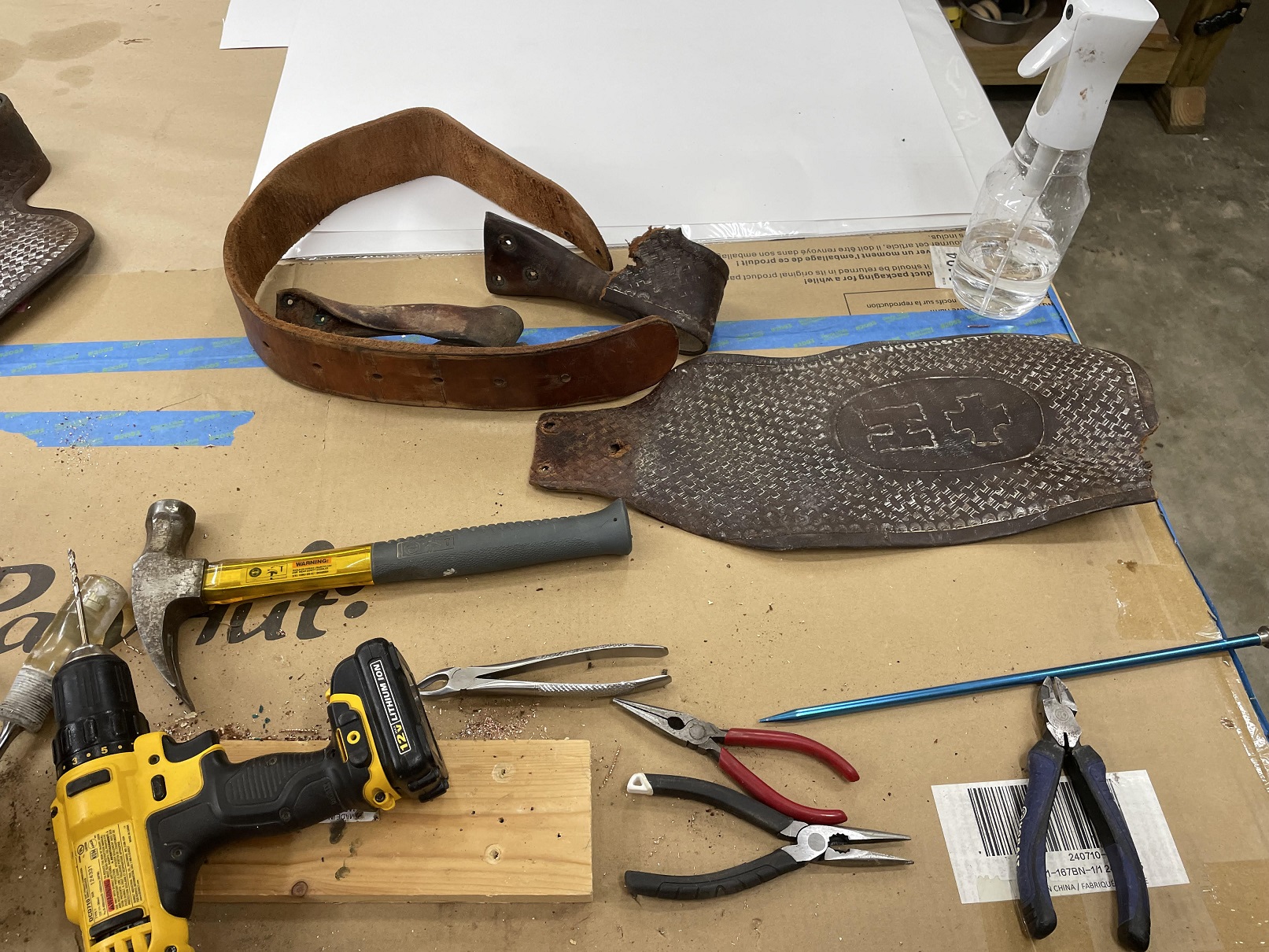

The next step would be to Johnny Five the Fenders. "Awww, Disassemble." :o
Yup, It all has to come apart, the hardware is reusable, and unless I slip removing the rivets, the stirrup straps will get reused. The rest is too beat up and worn.
The Fenders themselves you have seen, but drilling the rivets to remove the various straps will have to go slow and steady. Hammer, punch, Dental Extraction Pliers made for pulling teeth work great on rivets.
After about two hours of careful work, we have pieces and parts. I have one side all disassembled.
11 Disassembled.jpg (712.79 KiB) Viewed 33 times

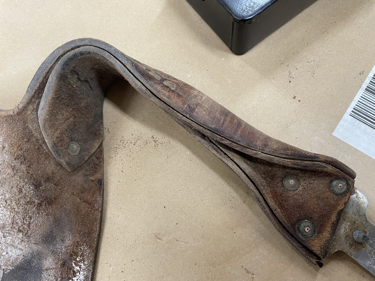

I'll leave the one side fully assembled until the project is completed, to use as a reference for the build, at least until I need the hardware and the stirrup strap. ;) The one belly strap will need a D ring added. This will be a PITA as I'll have to cut back the stitching to remove the rivet, replace the D-Ring, and restitch by hand the area cut back. This is a lined belly band.

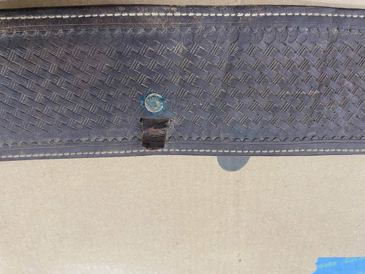

Step one is to punch the rivets with the centering punch prior to drilling so that the Stirrup Strap isn't damaged, and the drill doesn't tear up the Fender making it unusable as a template. otherwise, I could CUT out the hardware and toss the rest. :lol: That would be LOTS easier. :twisted:
12 punched.jpg (507.01 KiB) Viewed 7 times

Almost forgot, a long view of the Fender in the clamp. You can see why it might have been fun to try and clamp something that kept trying to twist, with just two hands. Hold 'er flat, position to board, work the clamps... tighten... :evil:
14 long view clamped.jpg (554.02 KiB) Viewed 7 times
