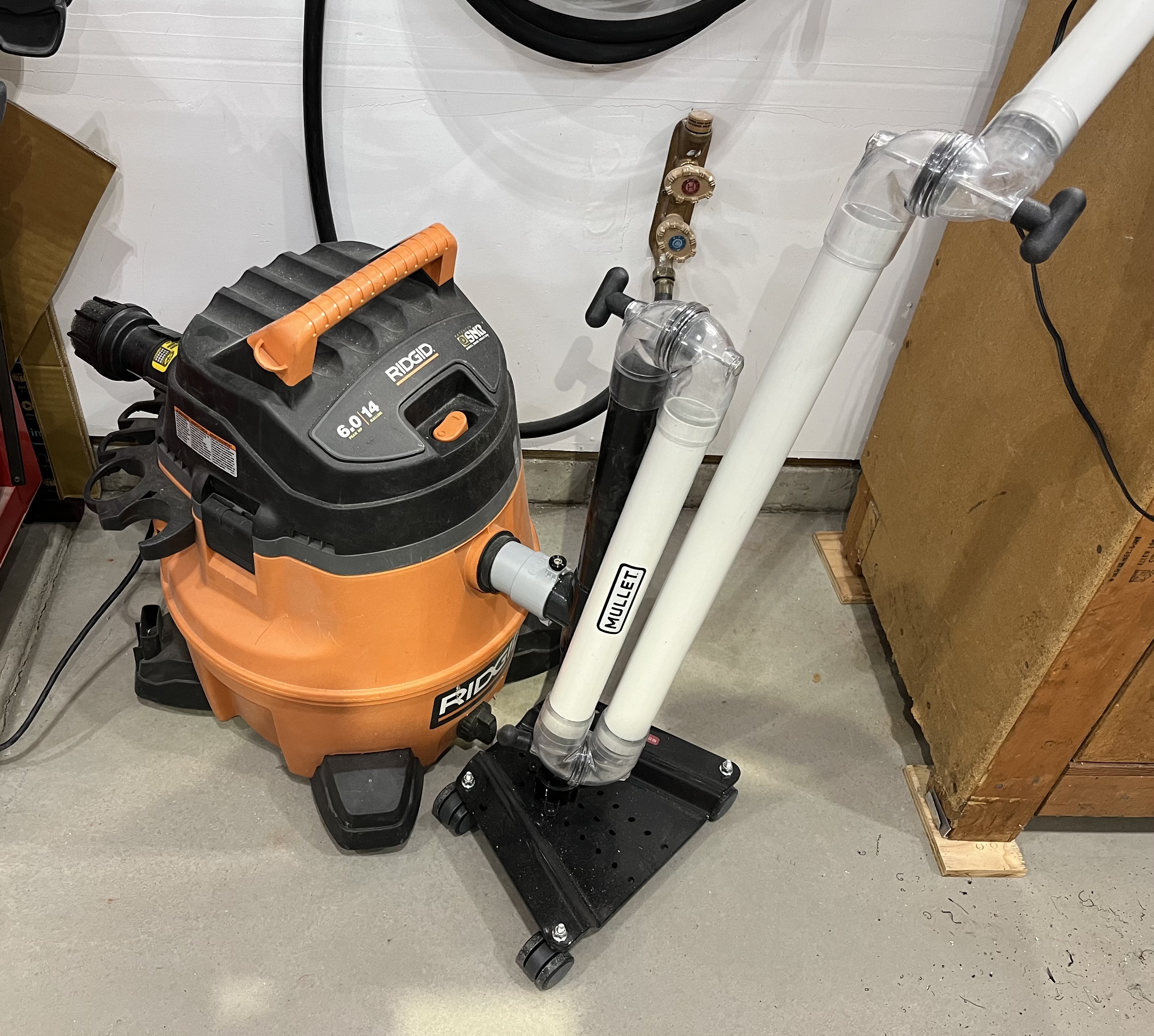

Re: Any lathe experts? How can I stop “static cling” when milling plastics?
Just guessing here, but it looks like you have a regular shop size dust collector with 4" ducting to various tools. If that's the case why not just run a smaller hose (say 2") from that as (Sherline suggested) to a suction head instead of buying a small roll around shop vac to do the job? I also think that a small vac filter would clog up very quickly and stop sucking.John E Davies wrote: ↑Mon Nov 06, 2023 9:16 pm“ What you are experiencing with the static electric Acetal chips and dust is common. The same thing happens on our full size machines in our shop. Your best bet would be to buy a small (quieter) shop vac and make an adjustable mount for the suction end that you can place near the cutting area. Then the shop vac will suck up most of the chips as they are coming off of the cutter.”
so sayith Sherline, and the word was good.
John Davies
Spokane WA
I have a full size dust collector 2hp motor (about 1350cfm) that is ducted via a home made manifold to various shop tools, with blast gates to direct the airflow as needed, and a couple ports with smaller hoses for the kind of thing you are dealing with. My setup exhausts outside the shop so I don't need to worry about filter clogging and subsequent drop in airflow at all.

This is a new setup, but expensive and I hope I can get it working well. I like the portability, for example I can use it inside the house when drilling or cutting sheet rock. For lathe turnings the smooth pipes should be less prone to clogging than a small shop vac flex hose..
And you can hang the small hose vertically.
https://mullettools.com/
