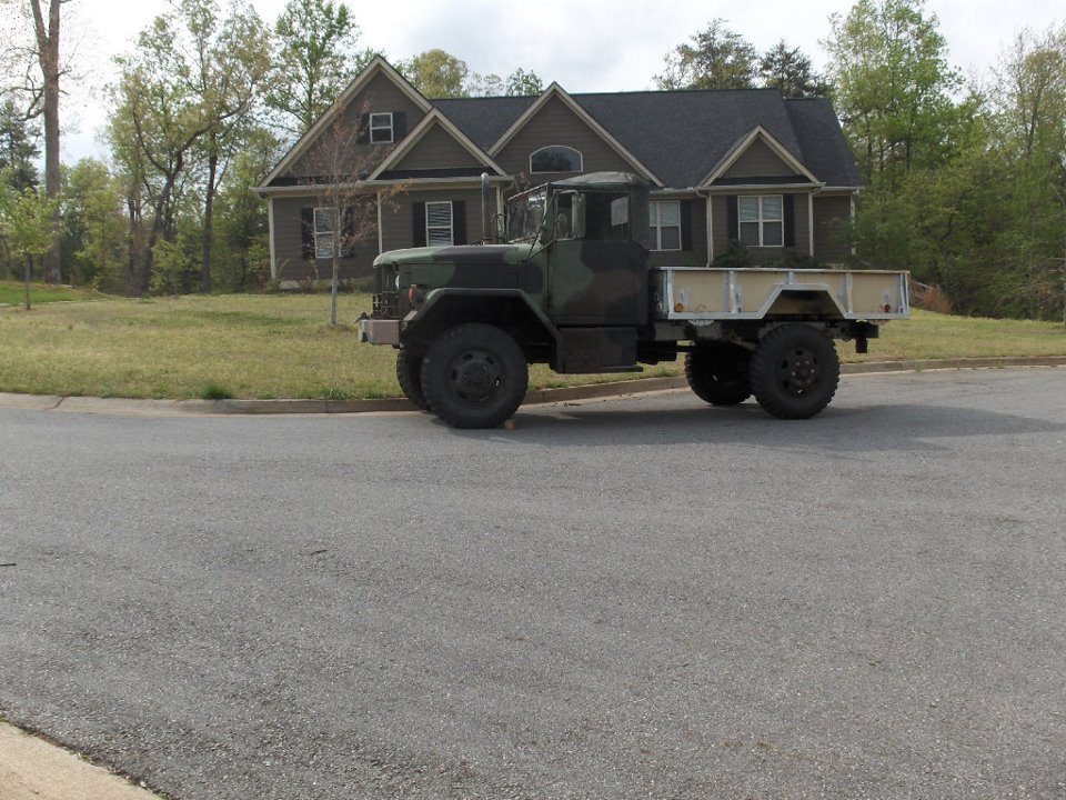

Well, he came home looking like this:
1. the begining.jpg (163.49 KiB) Viewed 7022 times
... then I did some of this:
... and then THIS happened:
2. Finish.jpg (392.32 KiB) Viewed 7022 times

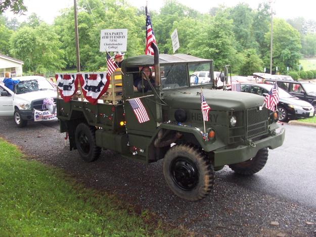

Henry is a 1968 M35a2 Deuce and a Half. He went in the US Army 2 years before I did. I bought him about ten years ago when they were relatively cheap. I cut 4 feet off his back end, got rid of one of the rear axles, 6 rear tires built a rear suspension for him and even painted him in the privacy and comfort of my own back yard, all by myself, in a little less than a month.
I think of Henry as my old army mule and I love him to death. He's named after an old New Riders Of The Purple Sage tune, about some fella who makes a wild run down to Mexico back in the day. I call him that because he is big, green and hilarious. For a long time he was my daily driver, I put over 20,000 miles on him until I had both knees done and and rotator cuffs overhauled in both shoulders. I never put a drop of diesel fuel in him, Henry runs on any petroleum product ... including old motor oil, atf, 90 wt gear lube ... some airport gave me 300 gallons of out of date JP4 that I use for thinning the heavy stuff. Henry has a top speed of just over 60 MPH and gives me 13 to 15 MPG's ... no matter how fast I go or how much we're hauling. We've been just about everywhere, camping, bike runs whatever.
Henry has been in a number of parades ... he likes to blow his airhorn at kids and pretty girls (I don't think Henry has ever seen a gal he didn't think was pretty) and LOVES it when they wave back.

aaaawwwww shucks ... 'tweren't nothing. I did the whole thing with a Harbor Freight engine hoist, a 1/2 ton chain hoist, some lengths of chain and line, a couple jack stands and various hand tools. The hardest part was aligning the bed from an M-105 trailer in such a way that the cab - bed spacing was correct and the rear tires were centered under the bed's wheel arches. I spent the better part of 3 days and plumb wore out 2 Stanley Powerlock 25-Foot by 1-Inch Measuring Tapes getting that all worked out and lined up. Not to mention the sleepless nights. :shock:
The best part of the whole thing was the cost. I bought the truck from a guy up in West Virginia for $1,500. As I remember the M-105 trailer that donated the bed cost about $500. I don't recall all the miscellaneous expenses, but call it $500.
I sold some of the take-off on ebay, and what I didn't sell I took over to the local scrap yard and cashed it in.
By the time he was painted and sitting out in front of the house, looking pretty, my total out-of-pocket was about $800.

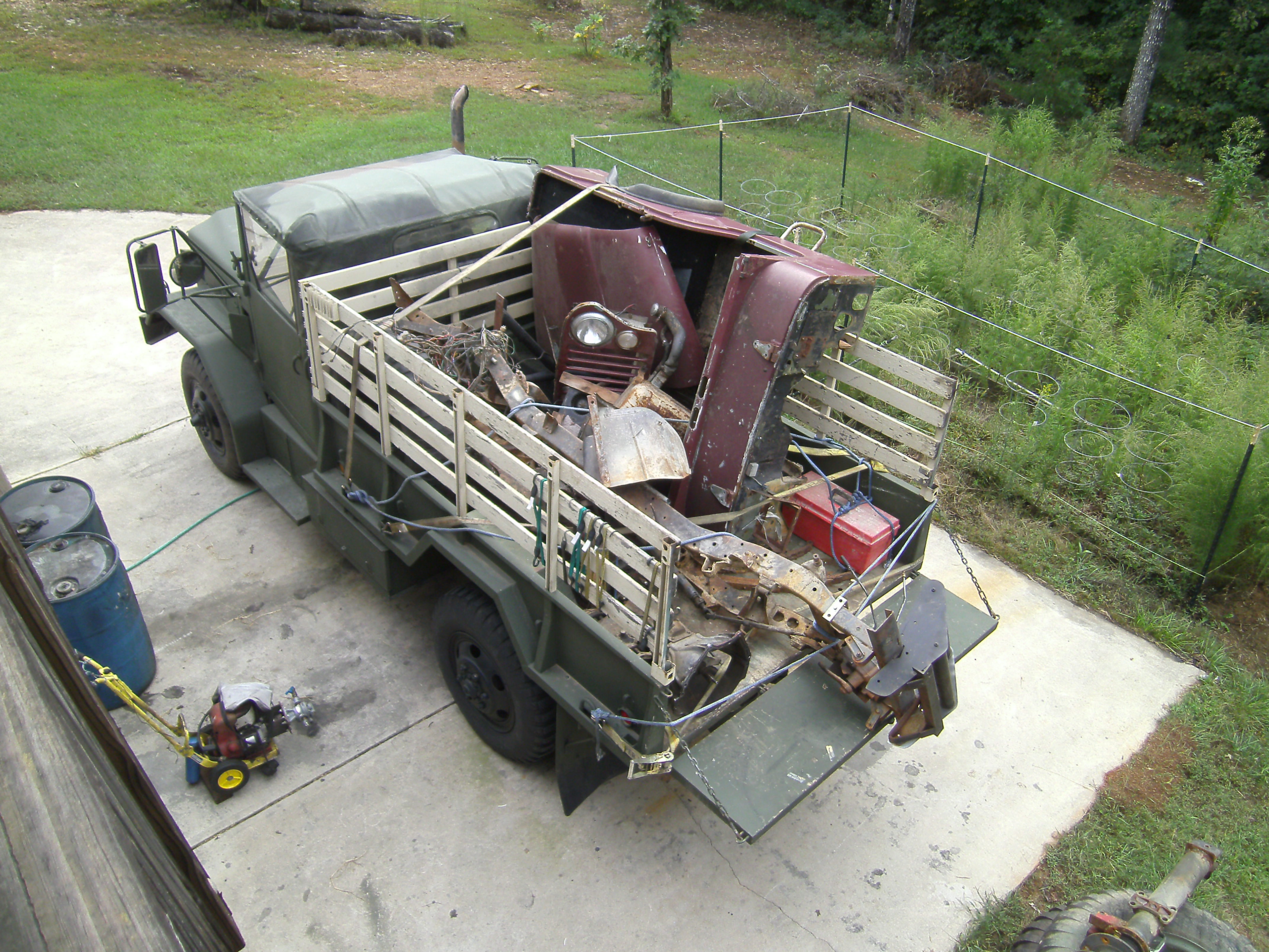

8. Hauling Jeep.JPG (2.12 MiB) Viewed 6978 times
Henry ain't never refused a load. I took the axle and spindle from that M-105 trailer, cut it in half, welded some angle iron on it and mounted it on the bed. Then I took the hydraulic ram and lifting arm from that Harbor Freight engine hoist ... and made Henry a bed hoist. I'm not sure what those tires weight, but its a lot.
