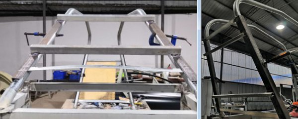

Per Mark BEX --

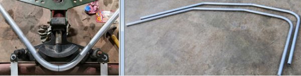

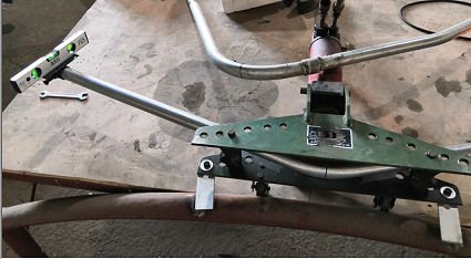

After a surprising amount of time to 'get it right', I feel I have nailed the side roll bars.
Though they look simple, the design affects related areas, the chassis, front and rear seating, even the fuel tank for which I do not want to make a bespoke fuel tank. The pickup, fuel level sender, pump and electrics all are specific to the engine, so I am very keen to use the original fuel tank.
Very pleased I have taught myself over the years to be able to bend even 100 degree bends in a pipe bender, which many say it can't be done without crushing or wrinkling the tube ...
Because all 3 bends are on the same plane, I can use a little jig to hold a spirit level so all 3 bends really are on the flat plane. I also welded some tabs to a bench, and bolted the bender solid, only took me about 10 years to finally get around to it
- 210918 001 bending chage and final design 001.jpg (26.67 KiB) Viewed 3163 times
- 210918 001 bending chage and final design 002.jpg (22.84 KiB) Viewed 3163 times

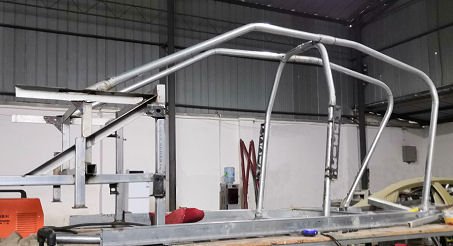

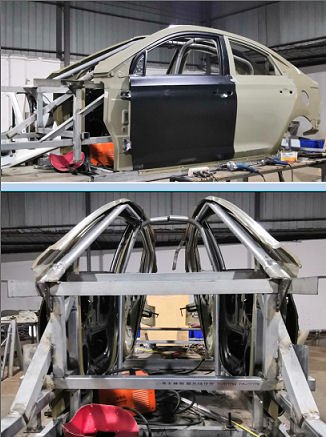

Per Mark BEX ....

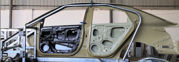

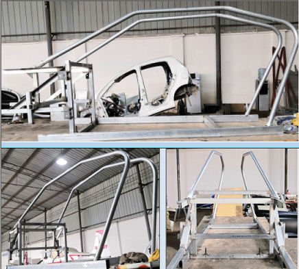

I had to lock the rear door into place with a couple of plates and rivets (red arrows), to line up the bodywork.
I am quite surprised how strong it all is, I was still expected flex, but it's remarkably solid considering there is little lateral support.
Roll bars looking good, it actually fits better than I hoped for after I locked the rear door into place, and peripheral items fitting as they should. Very happy about the '3 bends only' aspect of it.
- 210920 001 fitting back doors and roll cage 001.jpg (42.38 KiB) Viewed 3156 times
- 210920 001 fitting back doors and roll cage 002.jpg (34.92 KiB) Viewed 3156 times

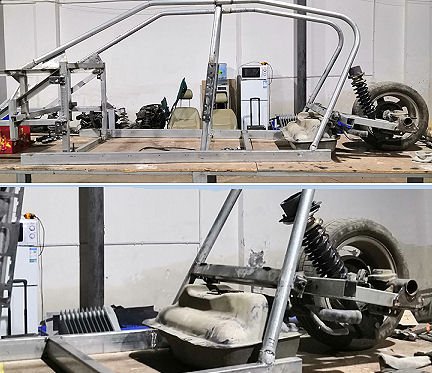

Per Mark BEX :
Wow, these side roll bars really took some effort, yet look very simple, but their importance, and getting them right, is quite important to a number of aspects of the total design.
As you can see I have literally regressed back to where I was a few weeks with the build, but now ready to shoot forward again at rapid speed now that many critical mounting hard points have been simplified.
- 210925 001 production level roll bars 001.jpg (48.91 KiB) Viewed 3020 times

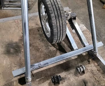

Re: Elio Type Vehicle Resurection --- AKA the BEX
Per Mark BEX :
This was a tough one. I fiddled for hours this morning surrounding how I was going to locate the roll bars in place, as they are literally 2 bent poles standing completely unsupported, other than some 2" long larger tubes the ends sit in that are welded to the chassis to locate their 'feet', for want of a better word.
I imagined all sorts of apparatus bolted to the bench, gauged off nodes on the chassis, and then simplicity struck me ...
I made 2 very simple 'floating jigs' from some angle iron that simply clamp to the front downtubes, and rear downtubes, that simply square everything up, took me most of the day to figure out the jigs that only took me a half hour to make, and they work brilliantly
Might be a bit hard to tell what you're looking at here
- 210926 001 production roll bar jags 001.jpg (35.81 KiB) Viewed 2992 times
- 210926 001 production roll bar jags 002.jpg (13.24 KiB) Viewed 2992 times

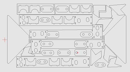

Per Mark BEX :
Laser cutting some door hinge mounts tomorrow, trying a system that will self jig their position, and just spent hours doing the nesting, bit like a jigsaw puzzle

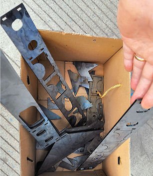

And a box of laser'ed bits ..

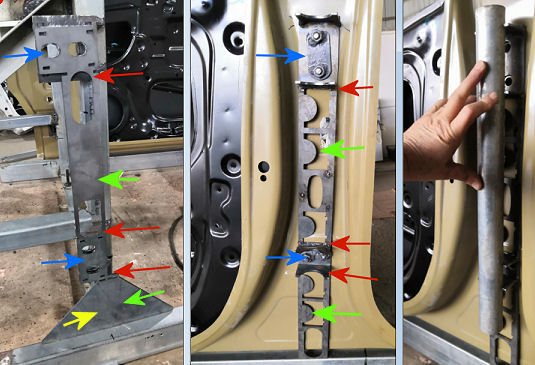

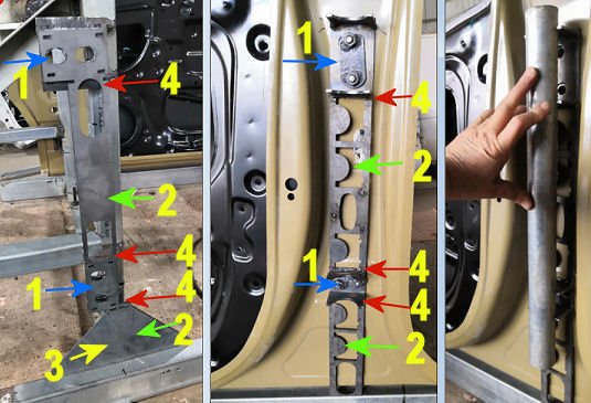

Per Mark BEX ----

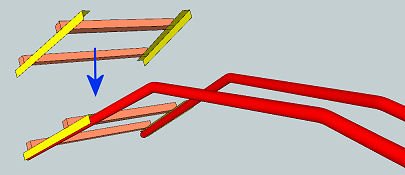

Now let's see if I can explain this:
The upper and lower door hinge mounting flanges, need to be at their respective 'X' heights for the doors to be located at the right heights, to fit and align into the door hole openings, obviously.
So instead of measuring, marking and manually locating where the separate mounting flanges, blue arrows, go on the respective vertical tubes, I have simply laser cut them out in one piece (for front and for rear doors) to automatically determine the heights.
This may have involved too much waste material, green arrows, bu I was quite successful in using most of that waste area for the various mounting brackets and nut flanges as you can see by the shapes that have been cut out of the waste area.
In addition, I also have large gussets, yellow arrow, for the front vertical tubes.
The red arrows indicate where I will cut the waste steel off later, merely leaving the hinge mount flanges at the correct heights and spacings.
- 211001 001 fitting door mounts 001.jpg (53.66 KiB) Viewed 2871 times
- JEBar
- Town Marshal / Deputy Admin
- Posts: 20447
- Location: central NC

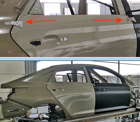

A clarification Per Mark BEX ---
A gentleman mentioned he was colourblind, if so hope this helps ..
So instead of measuring, marking and manually locating where the separate mounting flanges, #1 arrows, go on their respective vertical tubes, I have simply laser cut them out in one piece (for front and for rear doors) to automatically determine the heights.
This may have involved too much waste material, #2 arrows, but I was quite successful in using most of that waste area for the various mounting brackets and nut flanges as you can see by the shapes that have been cut out of the waste area.
In addition, I also have large gussets, #3 arrow, for the front vertical tubes.
The #4 arrows indicate where I will cut the waste steel off later, merely leaving the hinge mount flanges at the correct heights and spacings.
- 211001 001 fitting door mounts 002.jpg (55.71 KiB) Viewed 2613 times

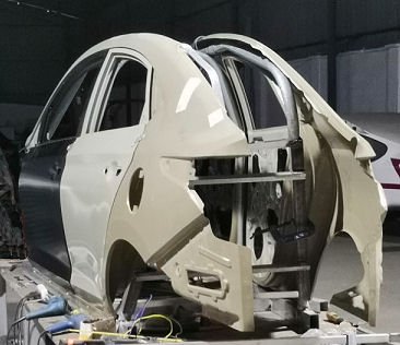

Per Mark BEX --
.. and a day later, primary structure welded into place, and back to bare bones again.
Probably Start fitting up the rear wheel and suspension tomorrow now I have somewhere solid to affix it to.
- 211005 001 primary structure welded into place 001.jpg (27.12 KiB) Viewed 2576 times

Per Mark BEX ---
Next up is the rear swingarm. Today I ground off the old pivot bushes as they will have to be relocated.
I will eventually have a much nicer looking swingarm later, but this mule will do the job for the moment.
Things will be a bit slow over the next week, I have decided to cut my factory into 60/40 so I only keep the 60% and halve the rent (I have a good landlord) and the 40% can be rented out, so I have to organize everything I have stored from the other end, sort it, figure where it will go, throw out junk, and clean up at the same time. I will be doing this over the next week.
- 211006 001 rear swing arm 001.jpg (34.08 KiB) Viewed 2561 times

Per Mark BEX ---
So getting back to the action, back up on the bench and the rear swingarm fitted up, and the fuel tank positioned accordingly.
Bonus is after the move, the exciting new background decor, that includes my microwave and fridge, water cooler and lunchtime seating.
I'm quite fond of the '3 bend' side roll bars, will give an open version a sleek look I think
- 211012 001 swing arm and gas tank installed 001.jpg (51.7 KiB) Viewed 2510 times
