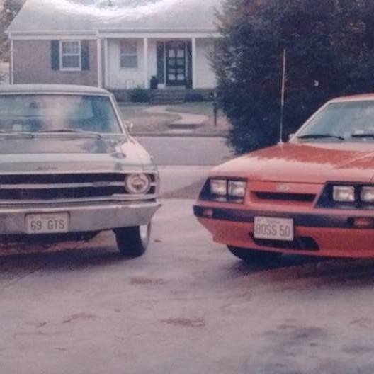

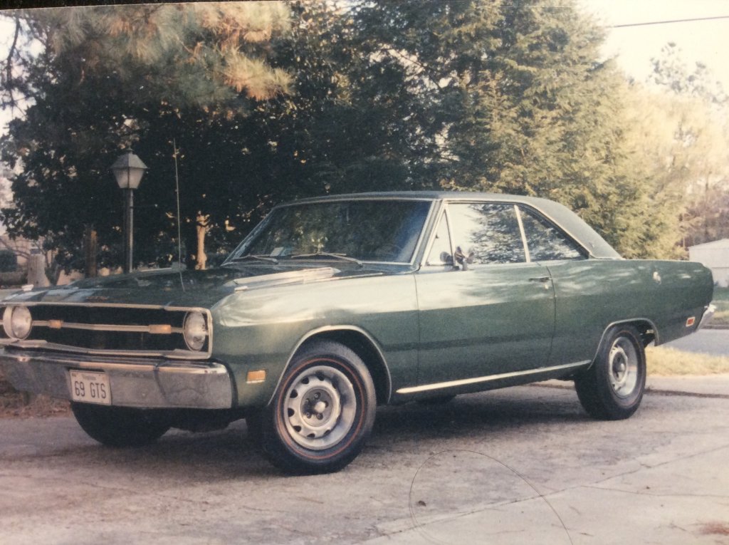

Yep I had this one thru late 70's and up until 1990 and should have kept it. Story goes that my wife spotted it for sale sitting under a pine tree in a trailer park while on her way to work. Had the original 340 with a 4 speed and 3.23 8 3/4 posi rear and original paint with the white stripe around trunk. $500 bucks later I drove it home and this in late 1976. Over the years it was my daily driver until 1980 when we moved into new home and I would keep it in the garage while I had another daily driver.
Built up a nice 340 with a new block which was the Chrysler Race X block I got a deal on. Also included the new Chrysler W-2 race cylinder heads that were used in NASCAR on the 355 race engines and also drag race setups. Chrysler had a special sale on them for several months to move them....like $75 bucks a head!!! Of course you had to get the special rockers and shaft assembly to go with them but at a great price too. Included a very good pair of the factory HP exhaust manifolds as well. Had headers before but wanted to be "stock appearing".
Converted it to a 727 TorqFlite 3sp auto with Street Hemi convertor and a 3.91 gear with A body factory super/stock leaf springs... It ran very well!
Yep should have hung on to it but got top dollar for it back in 1990.

Nice sleeper Forty. With that plain exterior and the motor, tranny and gears I’m sure you embarrassed many a muscle car driver. Nice looking redlines on the subtle rims. :D
